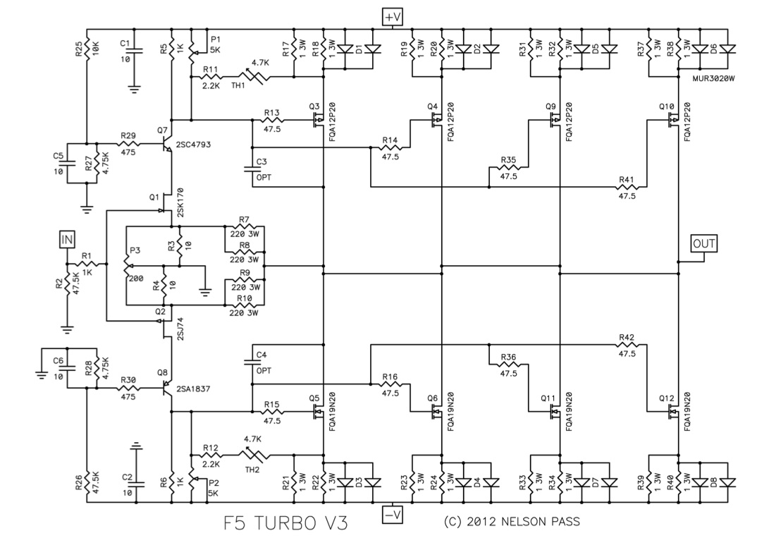

Nelsons original article and schematics, please read this for the best information concerning this amp - http://www.firstwatt.com/pdf/art_f5_turbo.pdf
Schematic
Please Read — The PCB numbering has been rationalized to match the part numbers and placement on this schematic (The F5Tv3 from Nelson’s article)
You can build any version of the amp from this article, or have multiple outputs, use the Cascode or not, etc… But when referencing the silkscreen to the schematic, remember to use this one.
Please have this printed out in front of you when you are stuffing the PCB.
There is one error in this schematic - R26 should be 10K
Also, in my opinion, C3 and C4, labeled here as ‘OPT’, are required for stability from destructive oscillation. This is a very high bandwidth design and those caps help protect it from ultrasonic HF oscillation. Use 1000pF. Also, if oscillation is a problem for your build, increase the value of the gate resistors (R13 -16 and similar) any value from 47.5R to 680R will work and sound fine, the higher the value the more damping occurs.

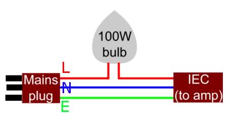

IF you don’t have a Variac, you must build a lightbulb mains lead.
(see notes for mains lead below)

Lightbulb Mains lead notes -
If the bulb ever turn on and stays bright, you probably have a short.
Normal operation when turning on a cold amp will have the bulb glow bright for a second or two, then dim, perhaps off. (this is the capacitors charging, then full)
As you increase the bias of the amp the bulb will glow brighter, and this is linear with the bias amount. A fully biased amp can get the bulb to glow very bright.
You cannot set full bias with the bulb in place - as it increases the bulb will glow more, limiting the voltage to the amp and all the readings will be wrong compared to when the bulb lead is out.
You can, however, set the initial bias with the bulb in place. Start the procedure, turn the pots until something happens, and set, at maximum, 0.1V across the source resistors and zero offset. Getting the pots started this way is a good idea. Remember, this is with a reduced voltage, and the pots will make the circuit draw MUCH more bias when the normal mains lead in used. Expect to measure 0.2V or more with a normal cord. Continue biasing in small steps, always trying to keep the offset near zero.

Jim,
The resistors for the voltage dividers to the bases of the cascode transistors are in error on the schematic, as shown, in that they differ on each rail. I found all 4.7k or all 10k work fine with pre-load 32 volt rails (or close to 32V).
Steve
Steve
R25:R27 seem to be in the correct ratio and give ~9V Vds on the upper jFET.Jim,
Steve
R26:R28 do seem odd. They end up giving <3Vds on the lower jFET.
Equal values (1:1 ratio) will give >15Vds on the jFETs.
depends on the supply rail voltage.
Pmax = Vpk^2 / Rload / 2
where Vk ~ Vsupply minus 3 to 5V of drop through the amplifier.
For +-35Vdc and 6ohms we get
[35-5]^2 / 6 / 2 ~ 75W into 6ohms. But that could be in ClassA or ClassAB depending on the value you set for the output bias current.
regarding R25-28. this is depending on rail voltage and desired J-fet voltage.
if they all are 4.7K or all are 10K. the result will be the same. about 1/2 of the rail voltage.
calculation will be:
rail voltage/(R26+R28)*R28=cascode voltage.
AudioSan,
What is the ideal or allowable range of voltages to the base of the cascoding transistors. That is, using a volt meter, what voltage would we like to see at the base of these devices after making in through the voltage divider and R29 or R30? I have read 9 volts, 15 volts, 17 volts. I'm sure there is a range, but I wasn't sure what is generally recommended. Thanks in advance.
I'd say at least 10 up to 30v where NP runs the V2. Going to 10V gives the jfets room to breathe and supposedly they sound better with higher Vds. Just watch the dissipation.
