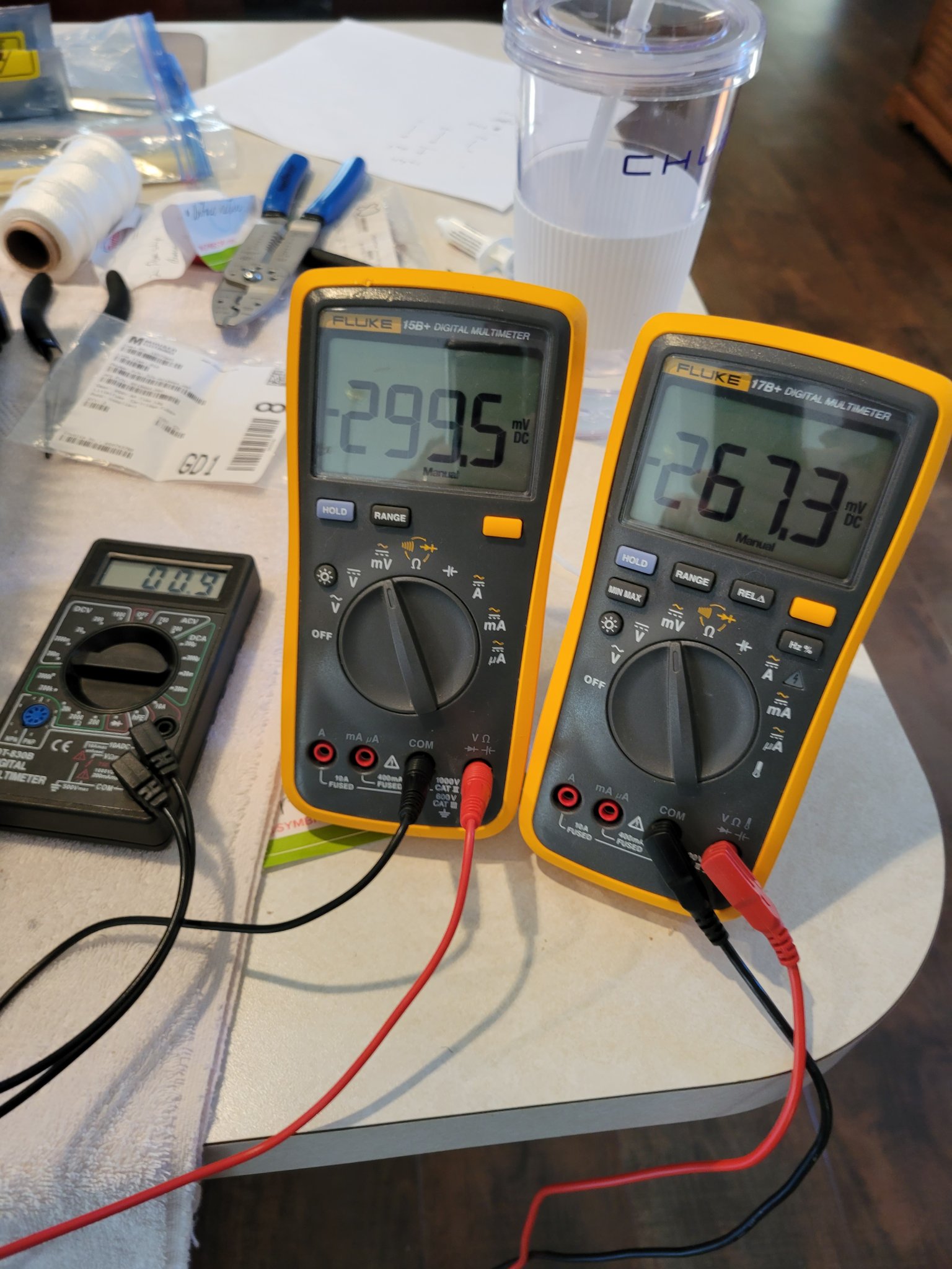

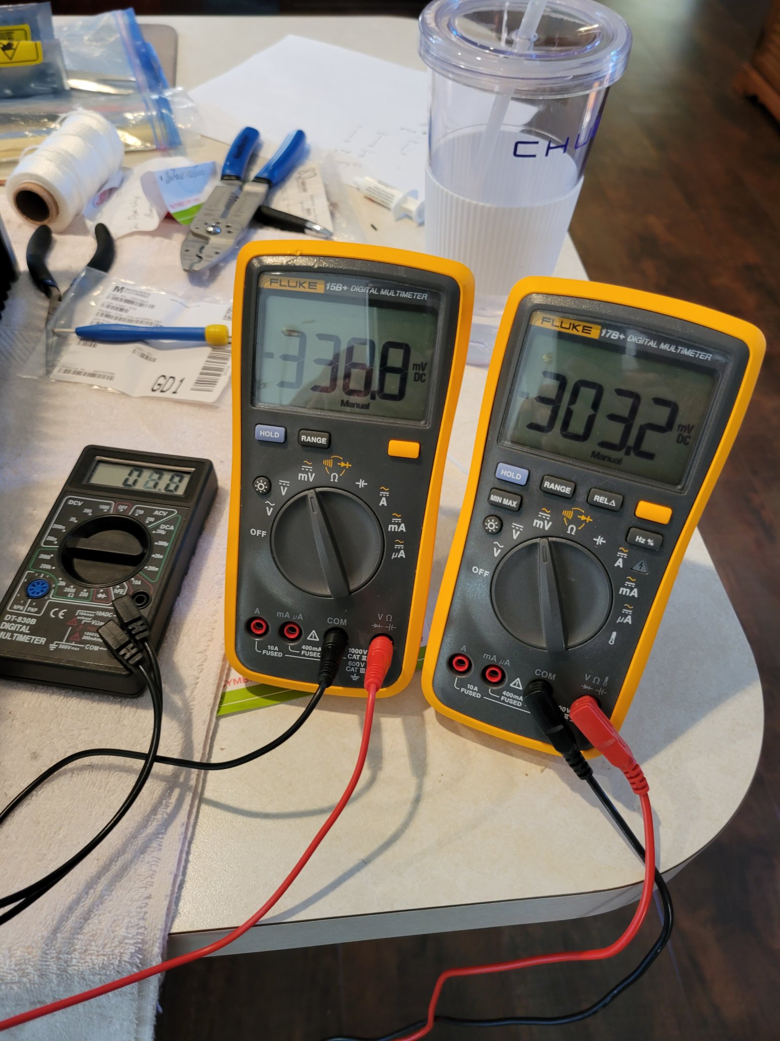

I'm hoping someone will chime in re: the overall imbalance. However, what you might do in the interim is to take the schematic and note voltages at various key points as comparisons between left and right channels. It may not be the best or most direct way to get to the root cause, but it'll get you started.

Anyway, I'm going to replace the JFETs and the smoked MOSFET and bias it up again. I was actually able to listen to it for a short time, and I have to say the sound was authoritative.
OK, cooking the left channel. Music may be imminent.

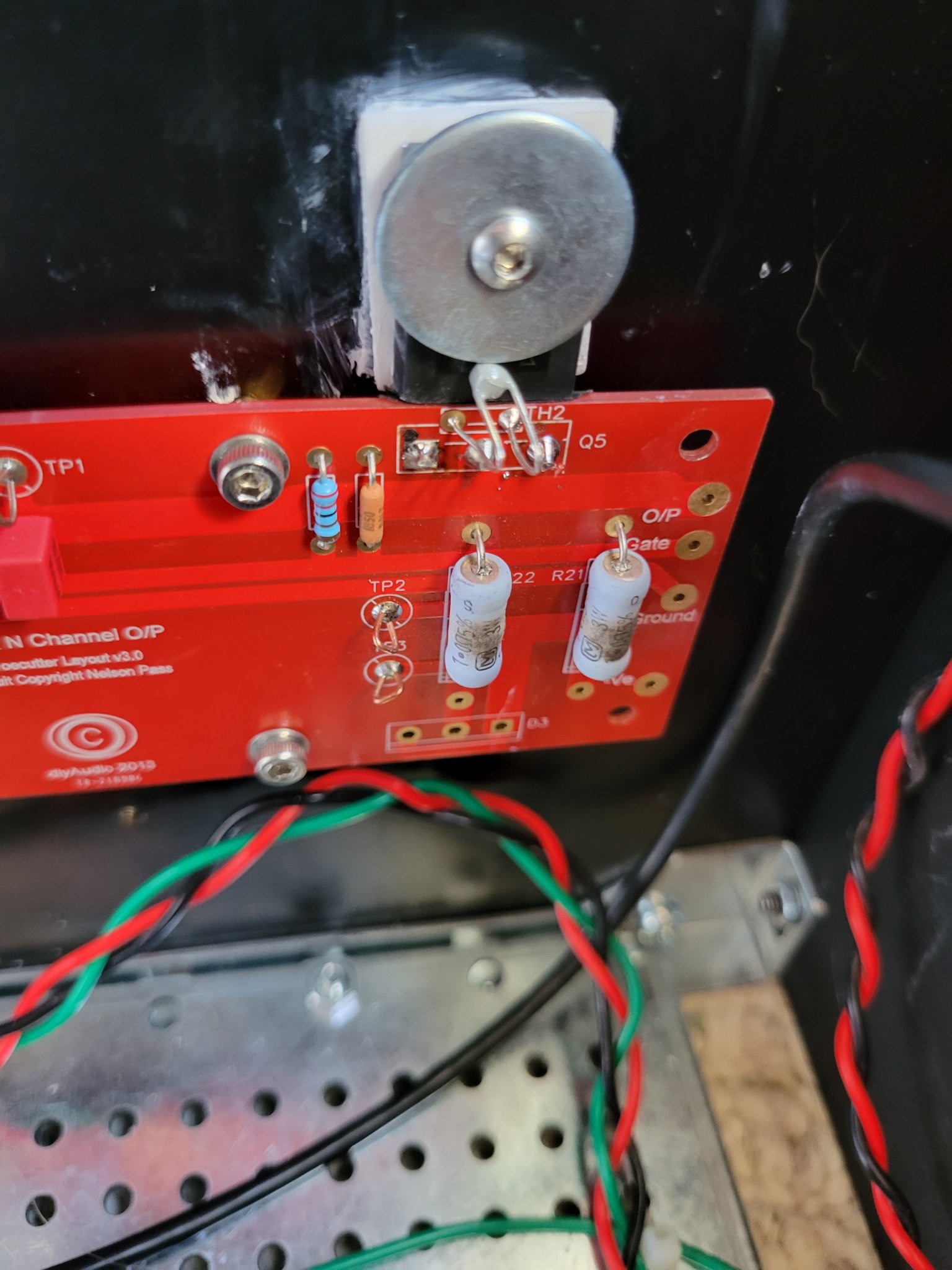

well that stinks. I would certainly get some taller standoffs.

I like having this kit handy. Kind of expensive for a what amounts to a cheap item per project but after having it around, I wouldn't hesitate to reorder it again when some of the sizes run out. Having it has saved a lot of time on projects. I also use the insulators that you are using.

If you are still having trouble, I would recommend checking the back of your PCB for leads that might be grounding to your heatsink. Your standoffs do look rather short, thus increasing the likelihood that something is poking from the back of the board. I did this trick with an ACA build some time ago, took a while to track it down because everything else looked great.
Have you verified that the power supply is functioning properly for the channel that is giving your trouble?
