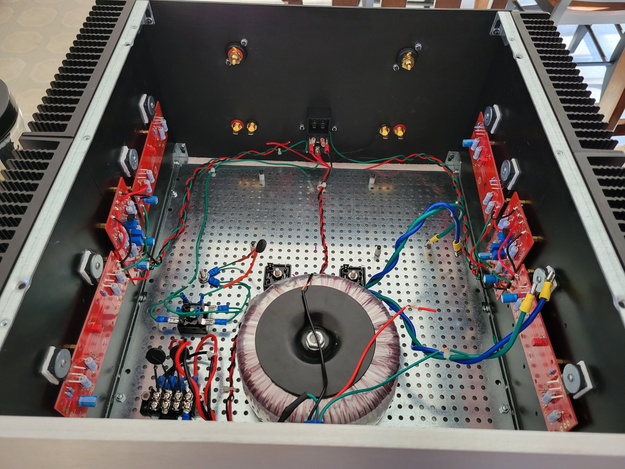

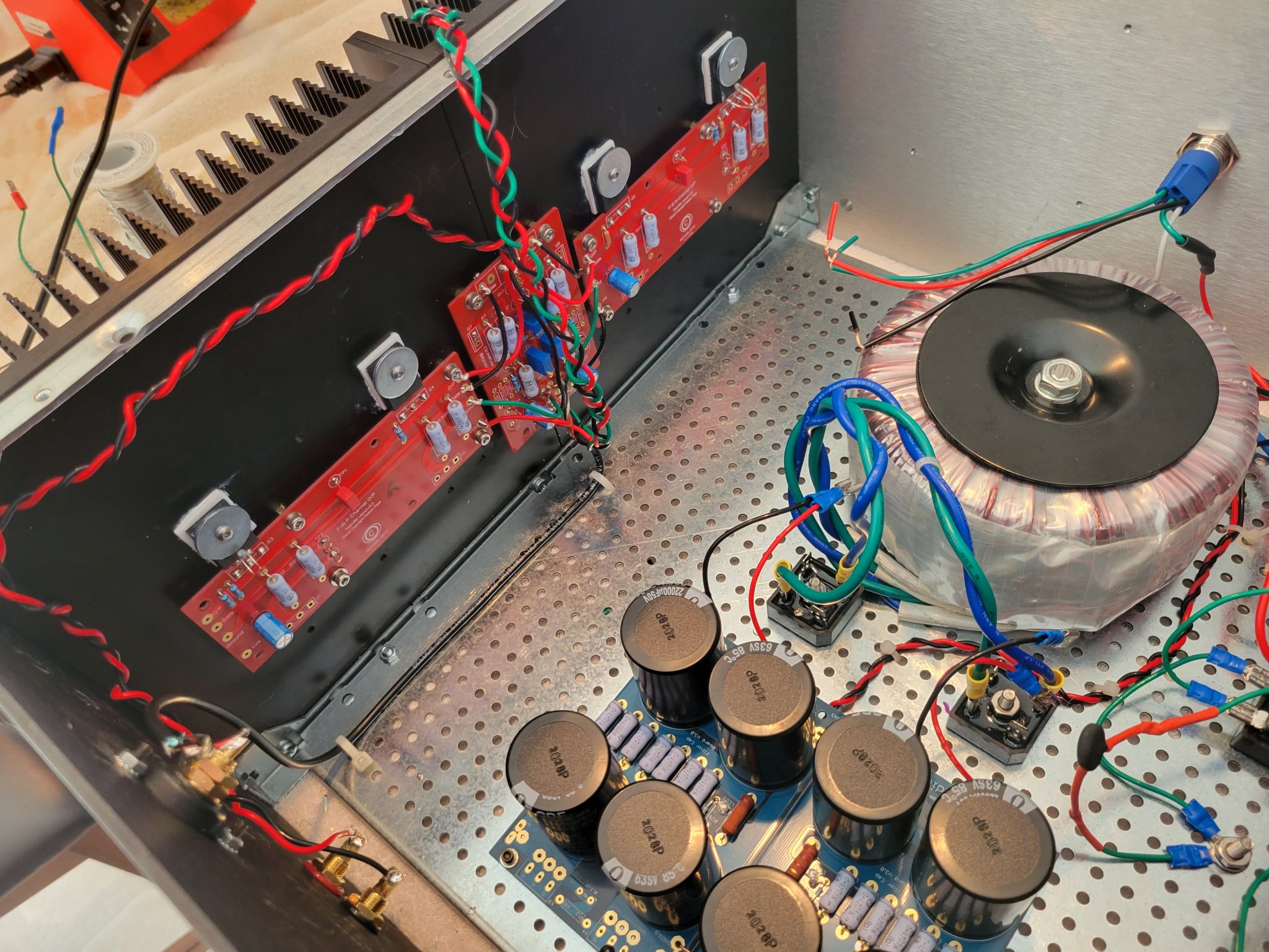

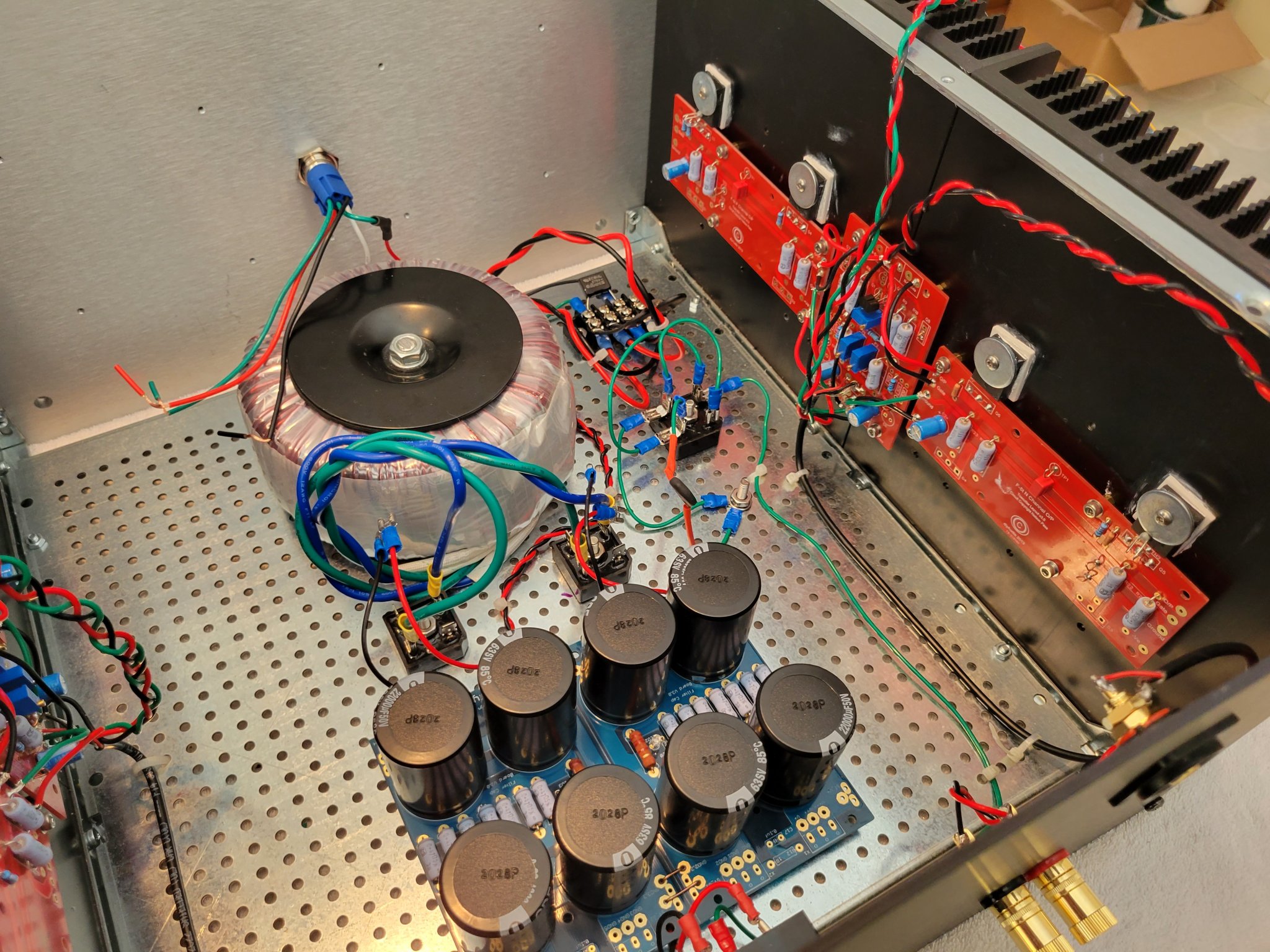

Work continued all morning on this build, and my fingers are sore! Next steps are to:
- Test the power supply on a dim bulb
- Connect the power supply to the boards
- Add the thermistors and solder the mosfets to the boards
- Wire the inputs and outputs
- Start biasing.
Pass DIY Addict
Joined 2000

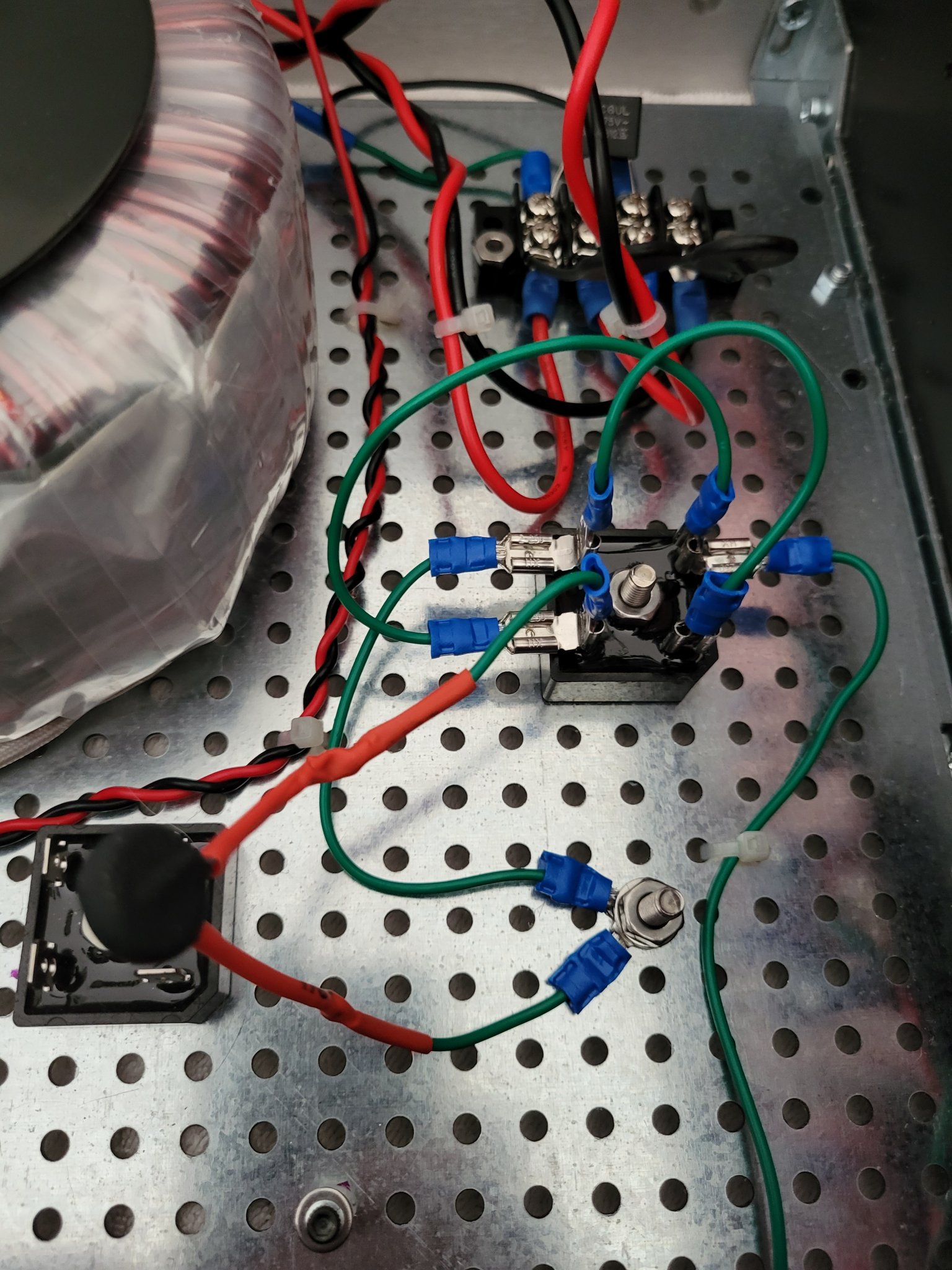

I spent another full morning on it. Power supply fired up fine except the LED on the negative side was backward, fixed that. Inputs and outputs are wired, everything screwed down, MOSFETs soldered. The only thing to do is connect the PS to boards and bias it up.

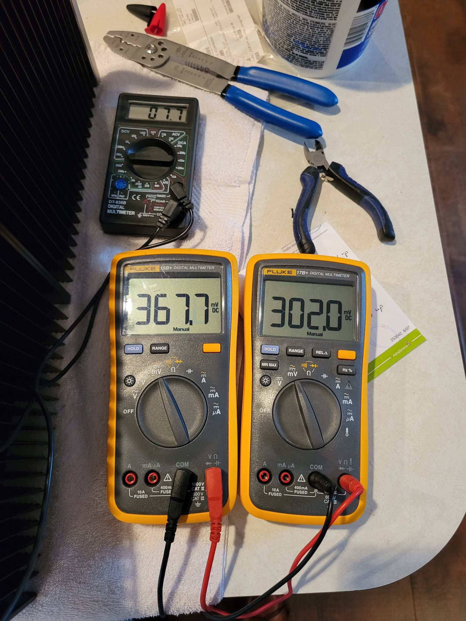

Checked the PS with a DBT, then with right channel boards connected, bulb went out right away. Right channel is now cooking at 300mV with the lid on. Heatsink temp is rising into the 90s F.
After a 20 minute cook, bias is stable around 290mV, DC offset is 6.6mV, and heatsinks are at 107F. Taking it to 350mV now and after cooking again I'll do final adjustment and connect the other channel to power.

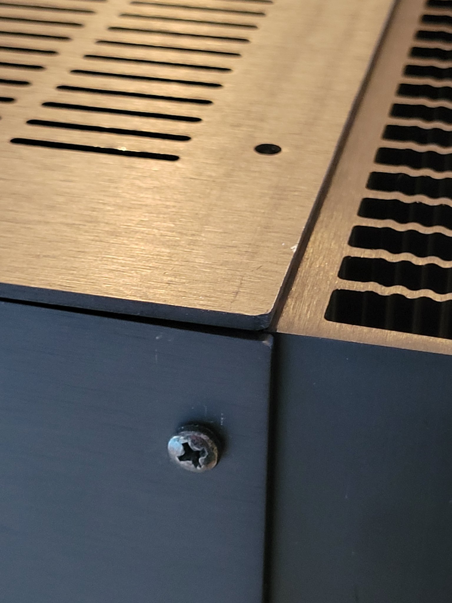

final screw tightening goes when everything is aligned
higher level of alignment precision for Modushop cases would more likely induce more problems during assembly , than benefits
and it'll cost more
in fact, from engineering point of view, pretty much every detail on Modu cases is perfect - things which can be made better are ........ irrelevant
and it'll cost more
OK, so loosen everything then line up the holes on the top&bottom. I haven't had to do that with the other Modushop cases.final screw tightening goes when everything is aligned
and it'll cost more
