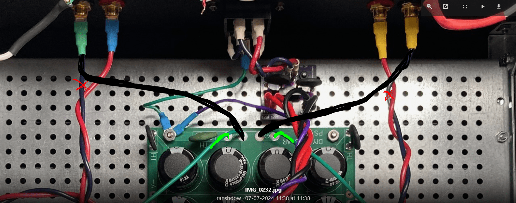

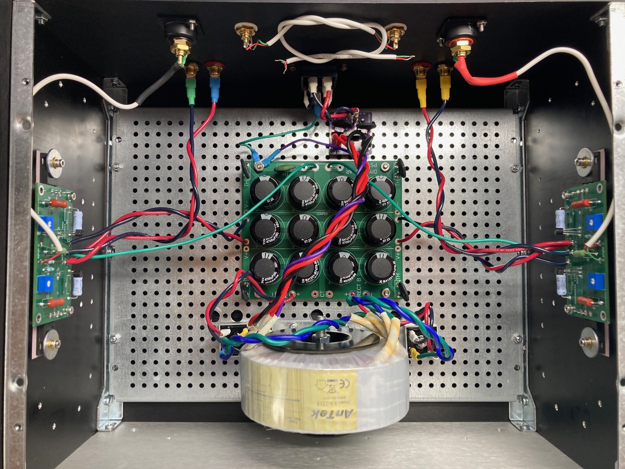

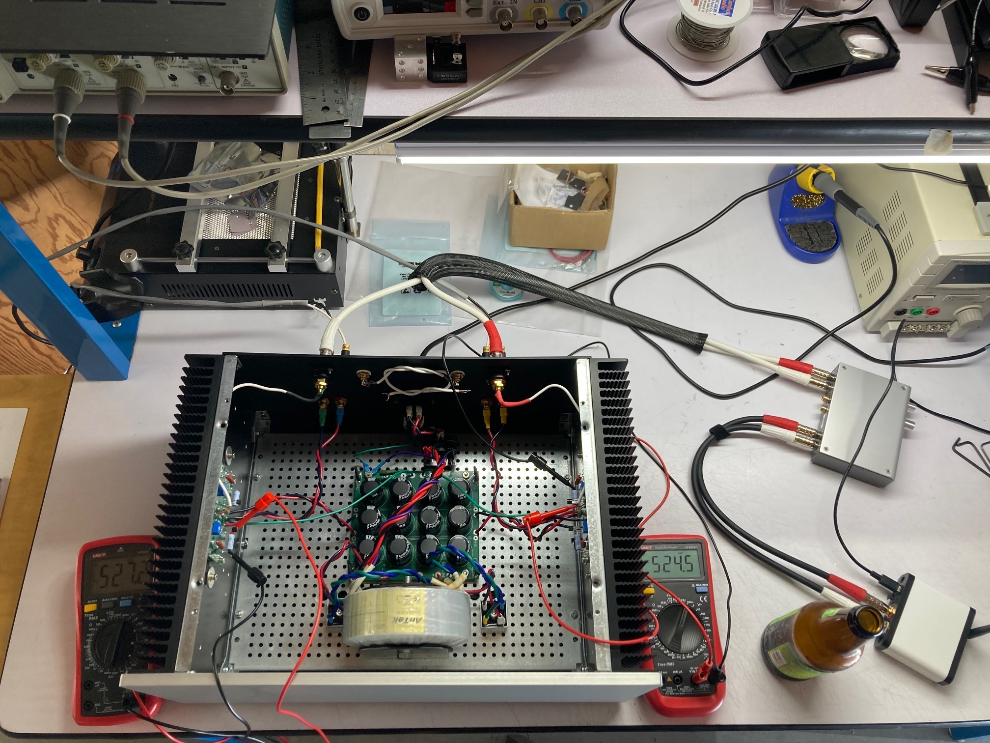

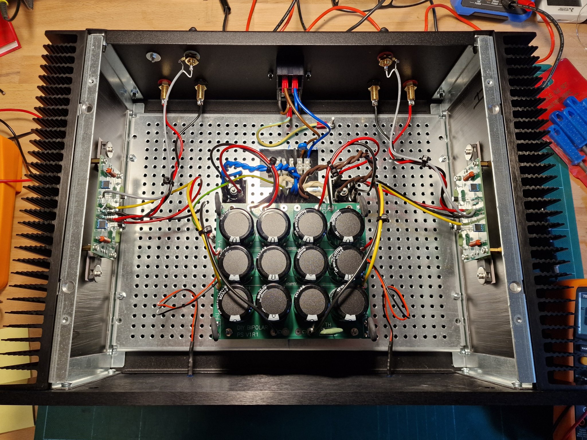

I don't like monoblocks. They're ungainly, wires everywhere. I built my F5m that way initially only out of expediency & always intended to put it in a single chassis, but got restless waiting for others to enable my dream of a fancy custom 3U, so. In the 4U Deluxe it went, this time with Papa's intended power supply & a single Antek AS-2218 for transformation duty. Don't mind the wiring, I don't like to solder & I'm prone to re-use partial connectors I have laying around.
I built this power supply with the "matched" CL-60 thermistors I've talked about earlier, also out of expediency (or laziness). I wasn't sure this would work, but it did, the rails are 24Vish, the bias holds stable at 1.1A to 1.2A & the DC offset is <10mV cold to hot, both channels. Good enough for the main system.
The first records played were some blues- Howlin' Wolf (live in Europe, 1964, something I picked up in the Seattle airport), then Lightnin' Hopkins Blues In My Bottle, a record I know well. I've learned to love the way my 2-ways sound when slapped around by an amp with control, like an Aleph Classic, so I was hoping for bass presence, if not outright control. Those first two records were promising, considering how distracting the treble was at first. Bright, forward, clear detailed compared to the Aleph, but plenty enough bass, in a kind of 70's way. Interesting to me too that in my system, it almost sounds now like there's a transformer in the signal path. I don't know what that means yet.
Tonight was Jethro Tull's Stand Up, then a couple of Moody Blues records I acquired but hadn't yet listened to. The verdict holds, the F5m has quite a bit of bass control. This is a very good amp for me.

Some suggestions, which may or may not help, but is good practice:
  • uncouple the signal input and speaker output wires
  • tightly twist the speaker out wires and locate them to the bottom of the chassis and side wall of chassis
  • locate the signal input wires toward the top of the chassis and side wall of the chassis
  • tightly twist the AC power wires from IEC to connector block
  • tightly twist the DC wires from bridge rectifiers to power supply board
  • tightly twist the V+ V- Gnd wires from PS board to amplifier boards, locating the wires toward the front of the chassis, away from the speaker and input wires
- rotate the power transformer to see if there is a quieter position
