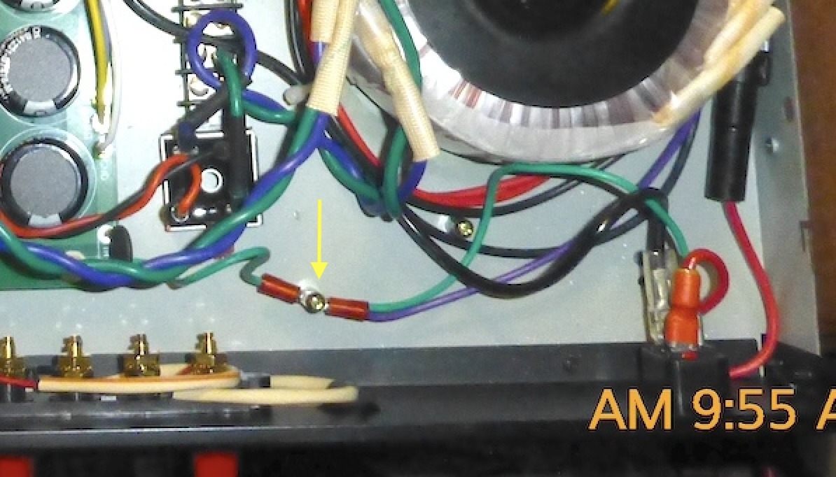

The Circuit Ground to Chassis Connection....
These days I make that connection at the very input of the power amp. The reason is that unwanted power supply currents can flow between equipment due to the huge loop area. Mostly innocuous magnetic fields can also cause significant noise currents if the loop has not been minimized.
Thanks for this comment, William. If I understand your point, a corrective action I could take might be to dress the green wire between the star ground point (yellow arrow) and the IEC inlet by placing it against the chassis floor, rather than allowing it to loop upward as it is now?

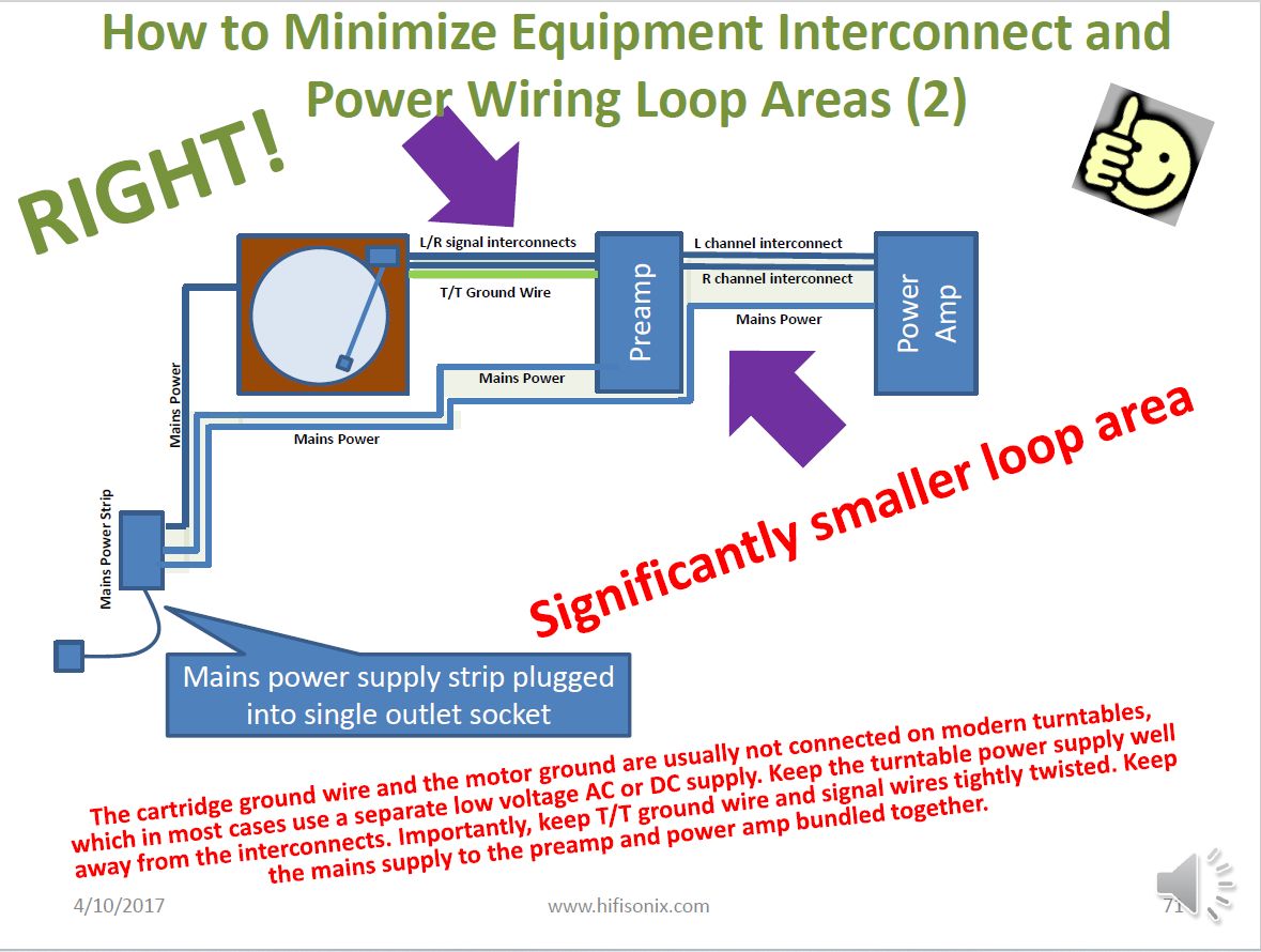

Grounding of equipment within a system is also important.
The most important thing about ground is that all equipment in a system is at the same ground potential. To do that all equipment should be have zero voltage differential between their respective grounds. The easiest way to achieve that is to plug all equipment within a system into one wall AC outlet. Use a power bar if necessary. Also keep the power cords together as far as possible to reduce loop areas.
diyAudio member Bonsai (Andrew Russell) has information on the subject: https://hifisonix.com/wp-content/uploads/2019/02/Ground-Loops.pdf
