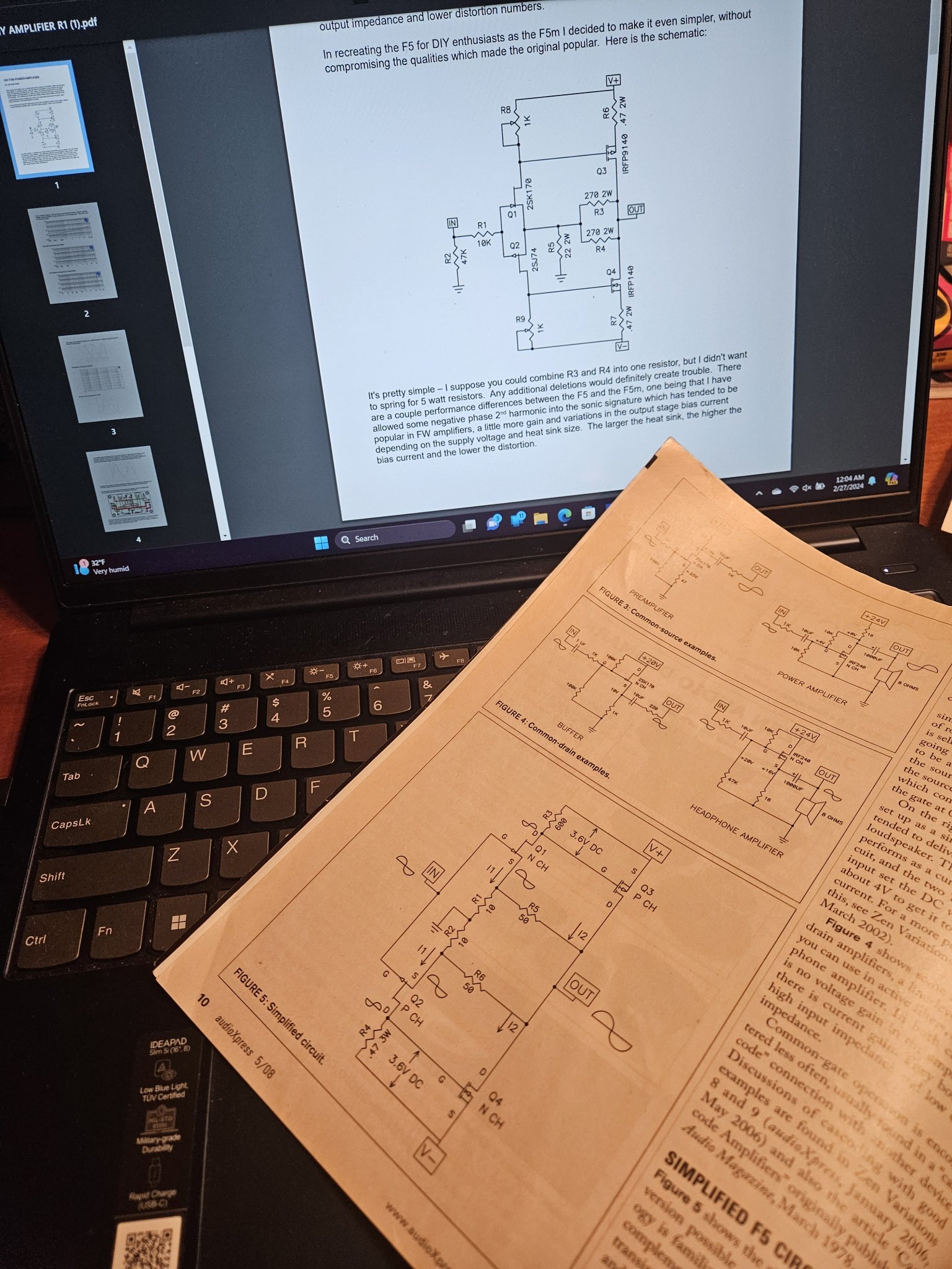

The F5m (no longer) contains degeneration of the input jFETs - in contrast to the circuit of post #70 and the classis F5 in general.
All that remain around the midtpoint of the input stage is the (ground reference?) resistor R5, which I assume is the very source of the bias toward 2nd rather than 3rd hamonic distortion selected by Mr. Pass.
How a single resistor to ground - in an otherwise symmetric circuit - can move the bias in an asymmetric direction (=> equal harmonics) I haven't grasped yet...🙄

I pulled out the May 2008 issue of audioXpress a few days ago and figure 5: simplified circuit caught my eye... 16 years of F5 variations brought nearly full circle, back to that one simple image. How very fitting.

R5 provides degeneration, and as such affects the load line.Thanks william2001.

Perfectly possible to make it assymetric, for example in the unequal matching of input devices, or source degen of the output devices (less likely here) 🙂Thanks william2001.
