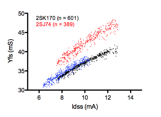

do you know that k170/j74 will always need any Rs difference to equalise their gm?
do you know if the builder will substitute another pair of jFETs?
Not for all k170/j74, no. But may be for the ones I use.do you know that k170/j74 will always need any Rs difference to equalise their gm?
Yes - he won't 😉do you know if the builder will substitute another pair of jFETs?
In any case, I get your point. Thanks.
Sven
If you have Idss-matched K170/J74 (which is what I think Spencer sells) they will never have the same gm. If the J74 are degenerated they may achieve equal gm and even equal Idss if well selected as shown in the figure I have attached (blue are the 5R1 degenerated J74).

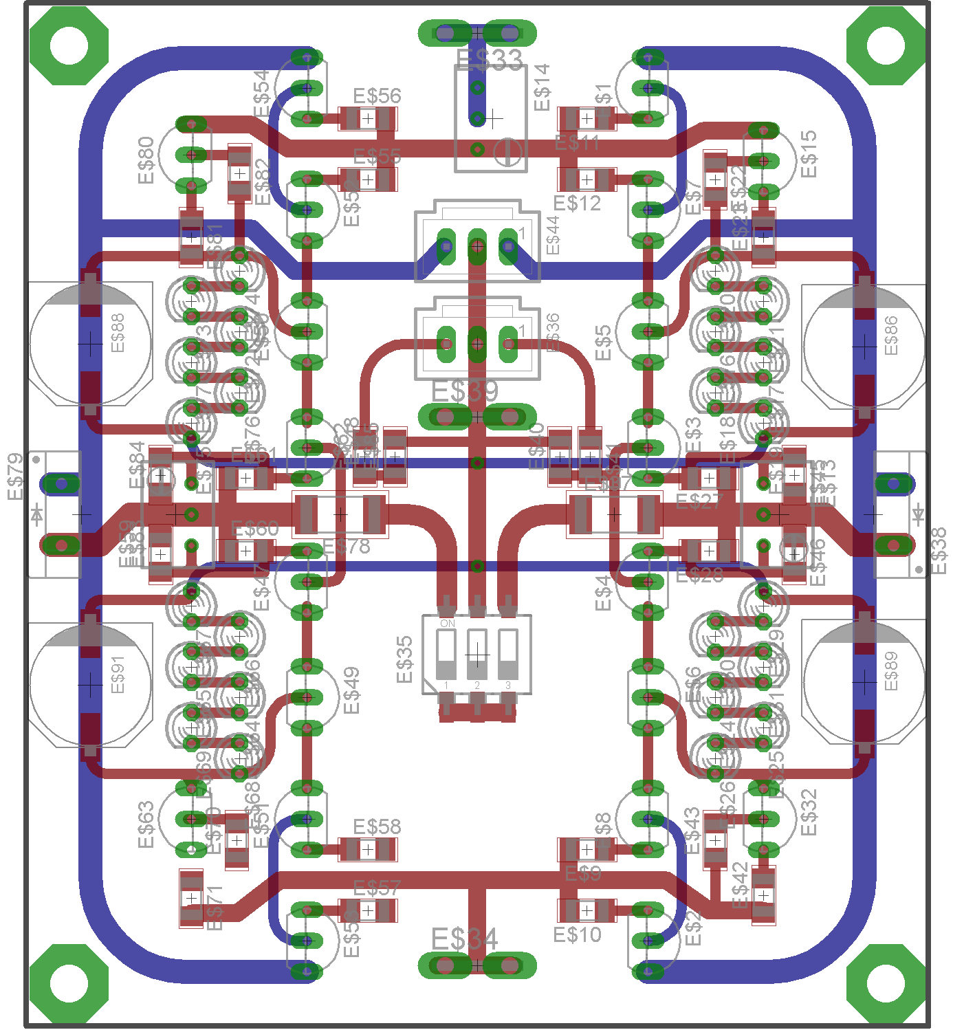

It's easy to change the board to whatever you like. Would raise the cost per set a bit however (~ EUR 1.50 @ an order volume of 25 sets)
It's easyto change the board to whatever you like. Would raise the cost per set a bit however (~ EUR 1.50 @ an order volume of 25 sets)
Whatever I like😱

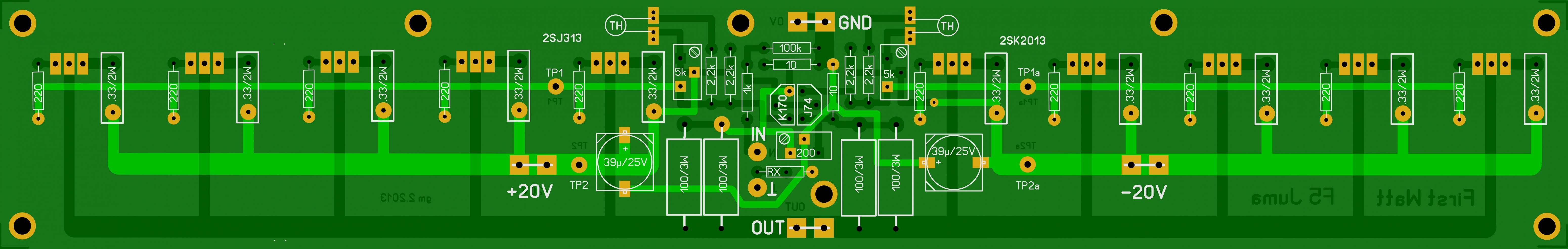

I would really like the best of both Pass's, EUVL's and Juma's worlds😀
An EUVL style F5X PCB with Juma's modifications including provisions for 4 parallel K2013/J313 in place of each K1530/J201😎
I know only few are interested in balanced audio gear and I know it is a lot of mosfets (16 of each), but as you might have noted I have plenty of these🙂
I would be happy to share manufacture cost if somebody was to design such a PCB (top quality - of course!). Actually, I would even add a curve traced NNNNNNNNNNNNNNNNPPPPPPPPPPPPPPPP-set of K2013/J313 and a degeneration matched NNNNPPPP-set of K170/J74..............
Of course getting to 25 boards might be a problem🙁
If I could get the FETs somewhere I'd build one and buy another 5 sets of PCBs just to support the project. 😀😀😀

I think I have matched 2SK2013, 2SJ313, 2SK170 and 2SJ74 enough for 25+ amps (50 PCBs.....)
I just need a first-class circuit and PCB design🙄
But remember this would not be a Turbo. I think it would deliver an amazing "First Watt" and above that have power line an ordinary F5.....
But then some of us are after better - not more😉
