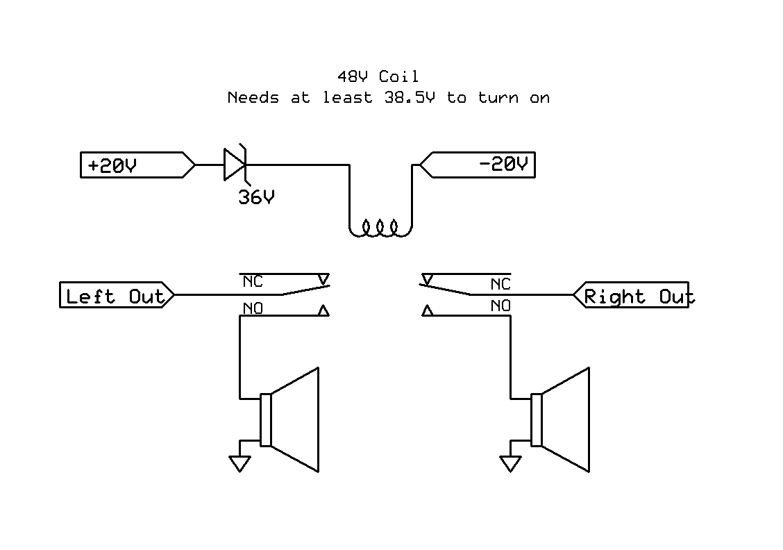

Output protection
I am gathering the parts to build this amp. I plan on using 2 switchers to get the +/- 20V. I'm not interested in getting into the switch vs linear debate. I'll let you know how it sounds😀
But I am concerned about what happens if one of the rails gives way. It is sure to destroy the speakers.
So I was thinking about some very crude speaker protection.
Basically a 48V relay sits between the output of the amp and the speaker. The coil needs to see near 40V to turn on. So if a rail blows, the relay coil de-energizes and disconnects signal to speaker.
Thoughts?

I wire my indicator LED that way.
Across both rails with a Zener + resistor dropper.
The closer the Zener voltage to the rail voltage the more quickly the LED dims as the rail voltage drops.
But A nice idea.
How can it be applied to a "normal" speaker delay relay?
But A nice idea.
Well, I think a capacitor can be added in there to create a slower delayed start. So that could create more of a slower "normal" speaker delay relay.
But that would also slow down the speaker protection in case of rail failure, so it would not suit my particular needs. But I think it can be adapted for different applications.
Also, I should clarify that the zener does set the threshold so that the coil only activates at a certain voltage. But it is also needed to set the deactivation point since most relays activate at 70 or 80% of rated coil voltage, but deactivate, once triggered, at only 10%, which isn't so great for a protection circuit.

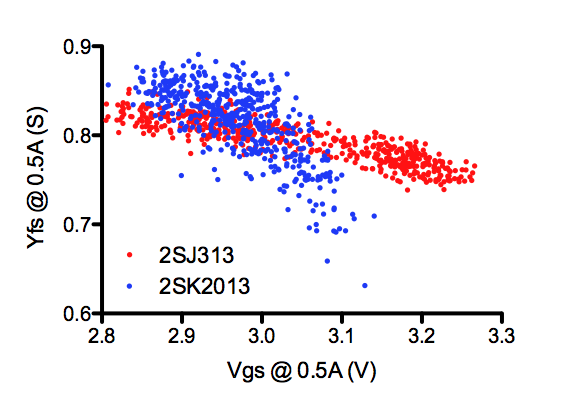

I have acquired and traced a fair number of 2SK2013/2SJ313 in the last period😎
I have attached a plot illustrating the distribution of Vgs and Yfs measured @0.5A and it looks fairly good. In general the devices are remarkably linear in the 0.3-0.9A range and I look very much forward to build a F5/F5X with these😀
The k2013 seem almost random in comparison to the correlation showing for the j313.
Yfs vs Vgs seems to be strongly correlated for the Pchannel.
Is there a science reason for the Pchannel to show this, or is it just chance that the Nchannel are all over the place?
One of the J313 batches I got my on hands are outliers (high Vgs). Everything under control😉
I my hands they are much more linear and homogenous than the K1530/J201 that I have some experience with🙂
I look very much forward to building a F5X-Juma😀
