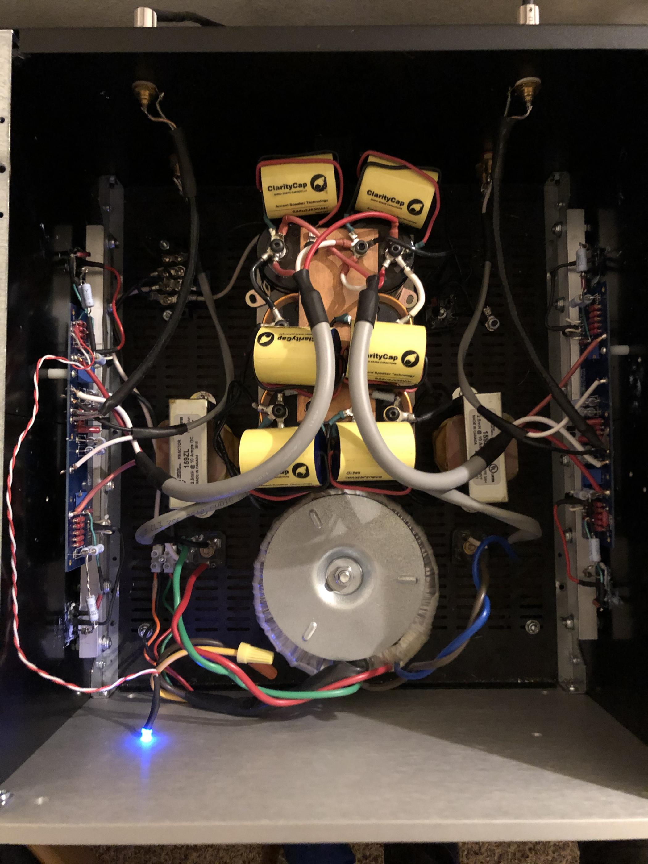

So far it’s been as simple as building a stock F5 and swapping the Toshiba transistors for the Fairchild or IRFP options. Bias is at the recommended 1A3. After digging through the links EUVL shared, I may come up with some other tweaks. That said, I almost hate to touch anything. It’s nearly perfect as-is 🙂

That’s on my to-do list for sure. I’ve been trying to get in habit of replacing trimmers with fixed values when possible. I’m going to let it settle just a bit more, then will make the switch.
Concerning the degeneration resistors on the output parts, the tempco looks pretty reasonable to my untrained eye, so I’m thinking I could drop the values without too much concern for runaway or instability?
Sorry, I meant dual pair per channel. It's a mess, but it sounds good.

I built mine exactly as you described and had terrific results. In fact, I don’t know that changing the drain resistors is absolutely necessary, though the parts will certainly accommodate lower values. I settled on .22R for mine.
