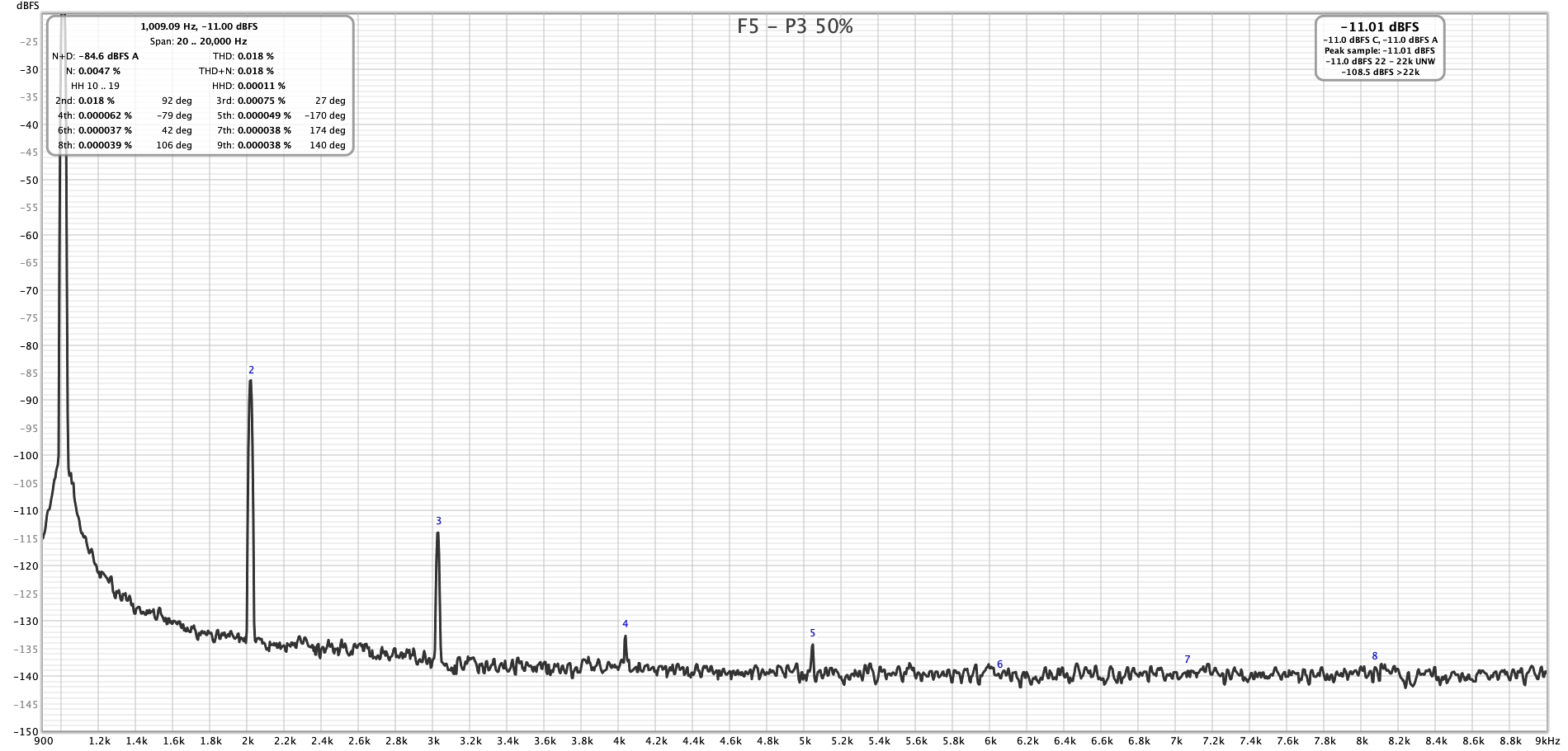

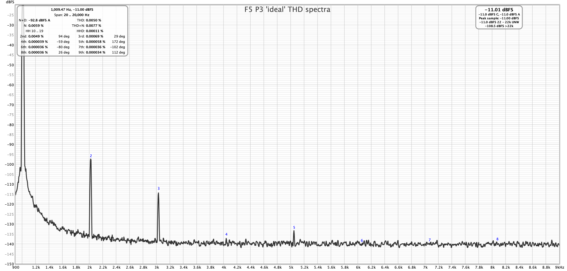

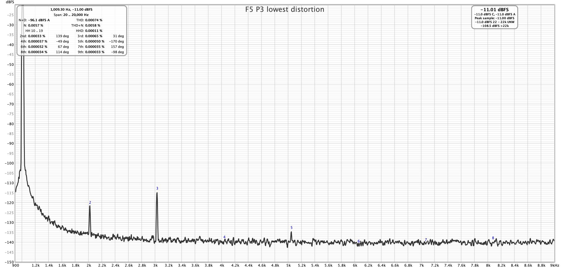

that's just side effect and side issue
my main goal is dominant 2nd, thus I can't care less for absolute symmetry of output parts
My goal is lowest possible distortion, uniform over the audio band.
Just like the Pass Lab X & XA series.
But each to his own.

as I see it**, .8 series is different in that, THD spectra tending to favor 2nd harmonic
though, as you said, everyone is having own preferences
Nelson Pass: Circuit Topology and the End of Science | Stereophile.com
Pass Laboratories XA60.8 monoblock power amplifier | Stereophile.com
well, that's 40W
see my contraptions, they're consistently having 2nd dominant in entire power spectrum
for example , XA252, in all 3 iterations
anyway, it doesn't matter - Papaways are mysterious ones ..........
Of course there are fun tricks that one can play with the Source resistors in the output stages of various Papa amps. Either to get better matching, or better un-matching. The F6 was fun to play with this way.
