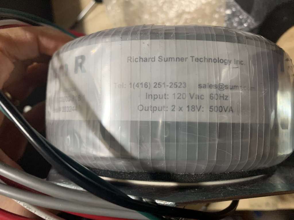

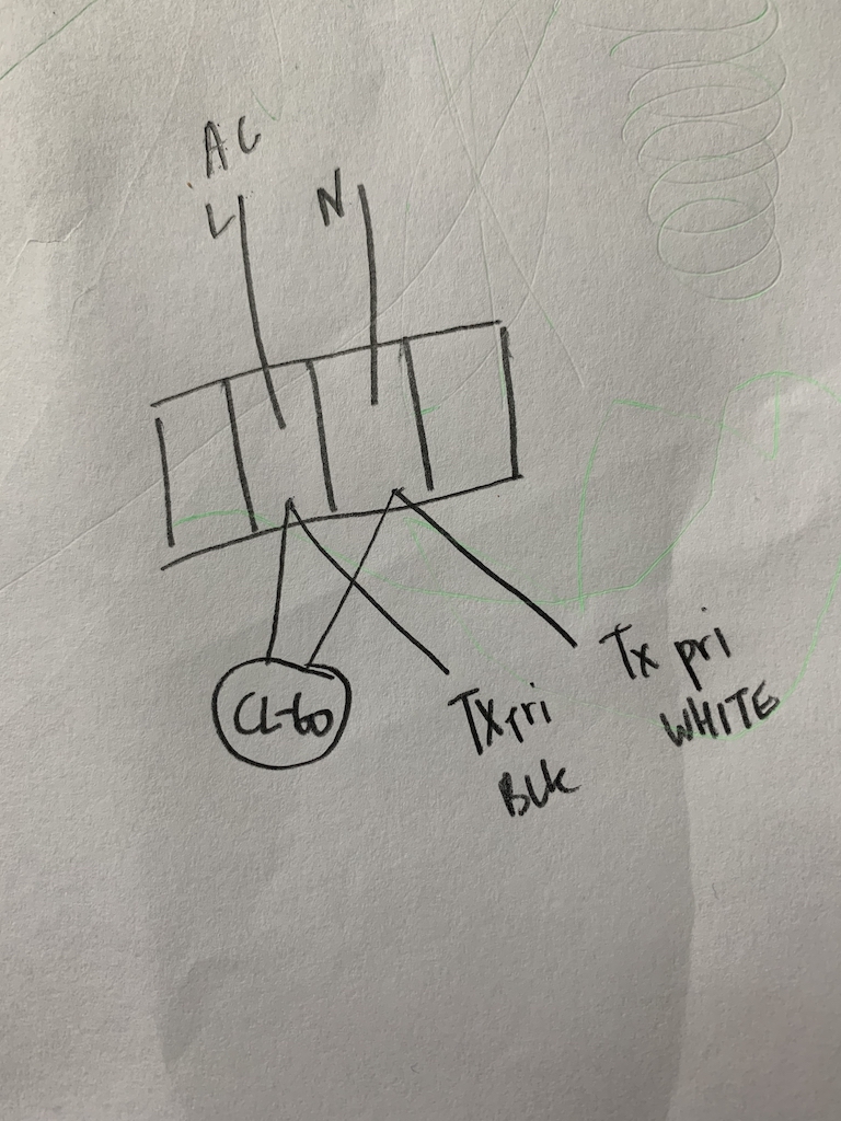

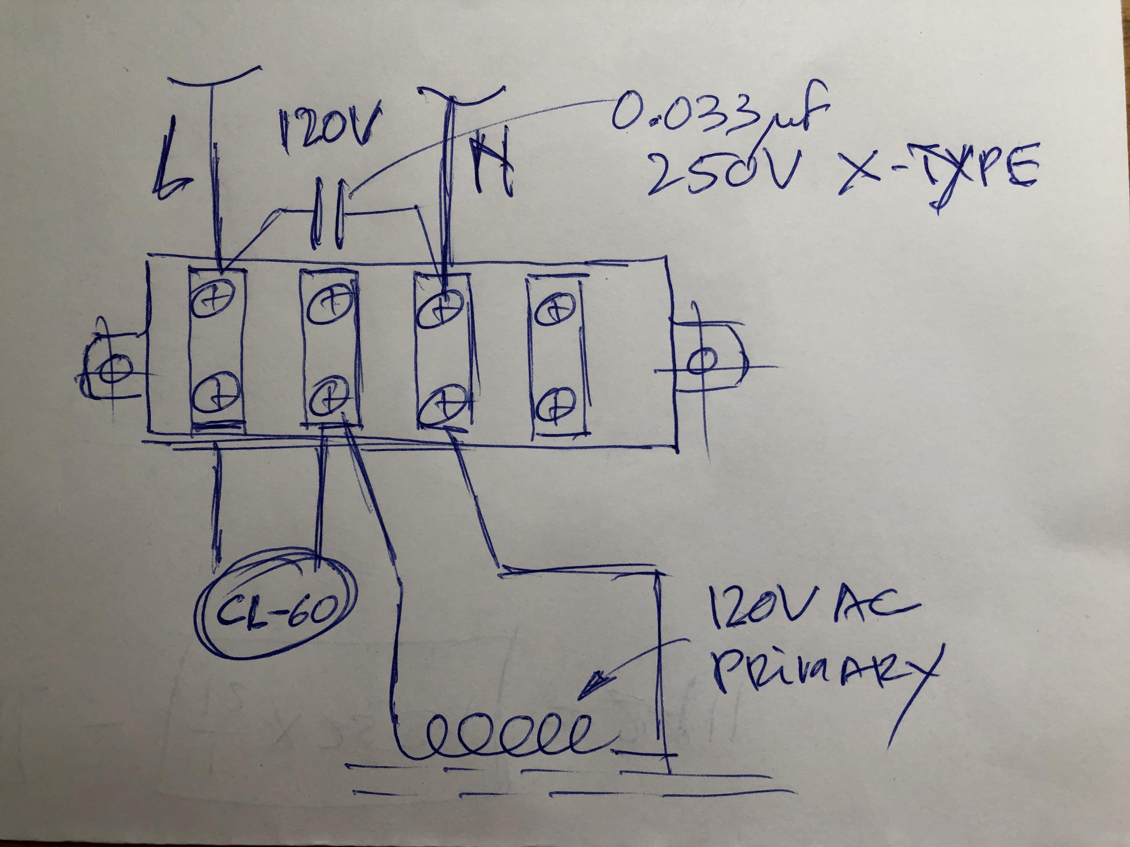

My transformer only has 2 primary leads.
Can someone please advise on the correct wiring for 120V with the 2 CL-60's and and safety cap?
My initial thought is that everything remains the same as the illustrated build guide, except that I connect the leads on the 2 outer terminals.
Yes it is 120V. I purchased it from SumR.
Is the attached sketch correct?
Secondly, I ordered the same PEM as the diyAudio store, but am confused as to why there are 2 fuses. Does this mean that I should use two, 2.5A fuses, or a different value?

There are 2 fuses in that IEC block...
One fuse could be 2.5A slow blow - make sure this one goes on phase
The other could be 5A slow blow - make sure that this one goes on neutral.
If there's a problem, the 2.5A will blow first (that's the theory...), hence, the primary will not be floating at 120V AC 🙂 🙂

The PEM on my F5 has 2 fuses, and I put 2.5A in both. Never knew why it had fuses on both hot and neutral.

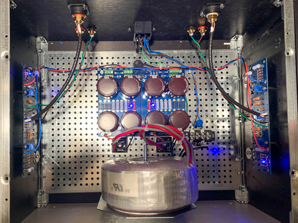

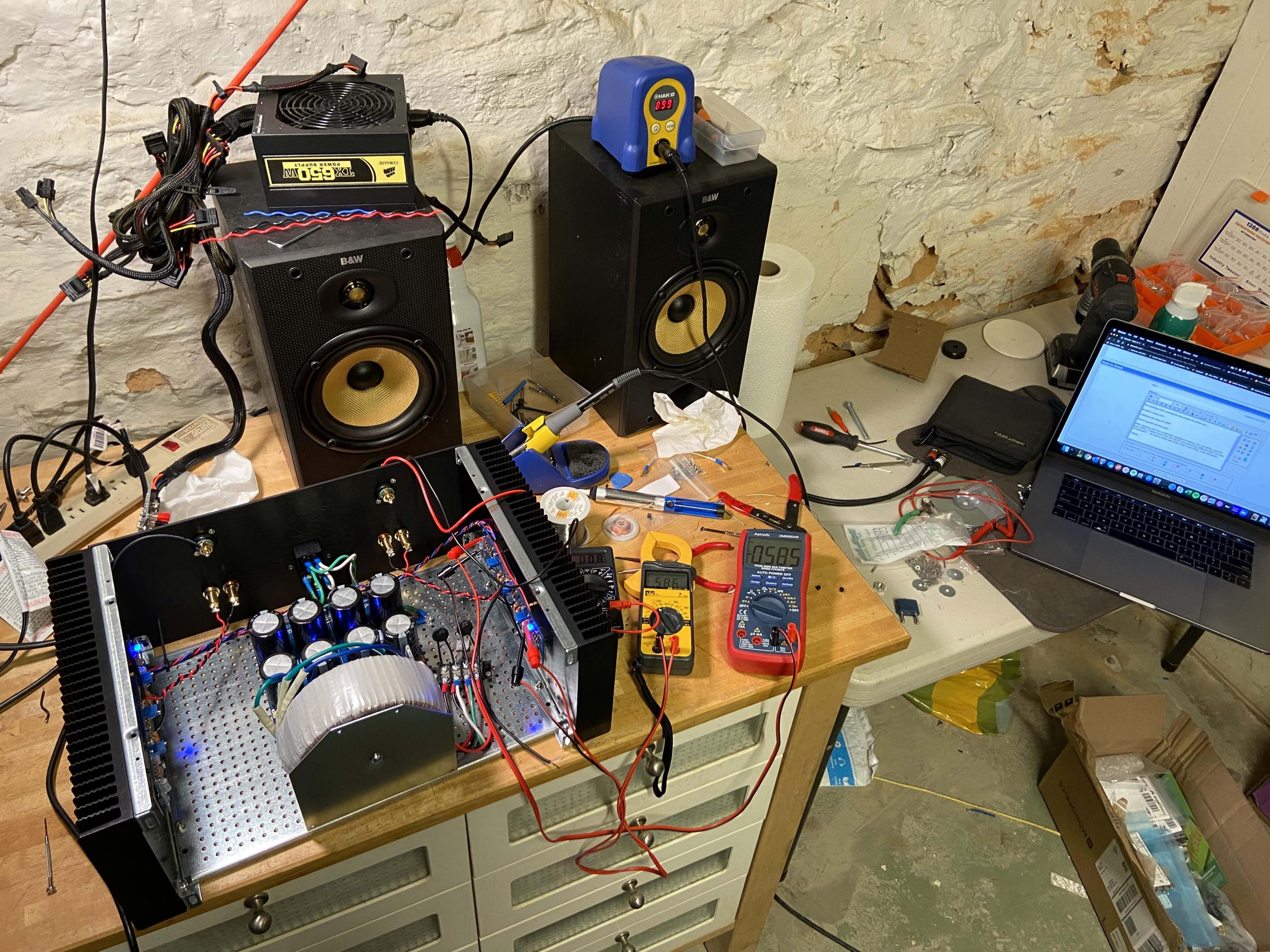

My new JFETs come tomorrow. I'm worried that whatever fried the first ones are going to fry this batch. My plan is to get everything connected and then use my DMM to compare resistances on the known good side to the repaired side before applying any power. See if I can learn to use the diode tester function too.
Why did I buy new JFETs? Couldn't it be one of the other transistors that died?
Anyway... Thanks as always..
-Jesse
Use an antistatic wrist strap when handling FET's; in particular the JFETs.
Diode tester... get a BJT (any BJT -> the ZTX's will do nicely) and try the diode tester -> it will start making sense🙂
You can not test the JFETs with a diode tester, unfortunately...
Wooot!
Ayeeeee!
I'm shaking from waiting for the smoke to come out...
It didn't come out!
I believe we have an AMP!
Thank you for all the help!
After playing with my multimeter resistance setting, the old JFETs, and the new JFETs, I determined that the 2SJ74 was behaving different than it's new counterpart... So that is what was fried. How it got fried.. I do not know..
-Jesse
