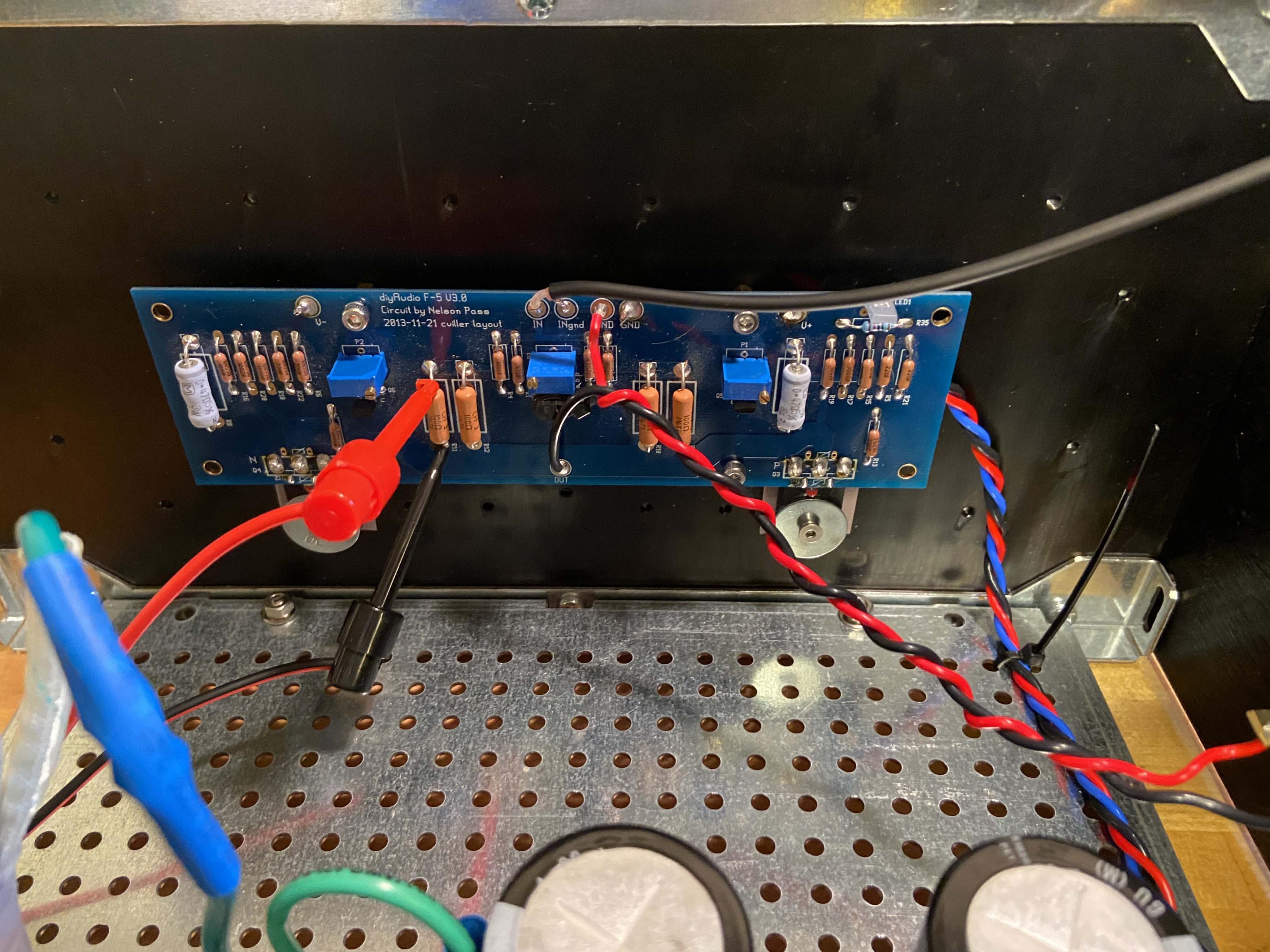

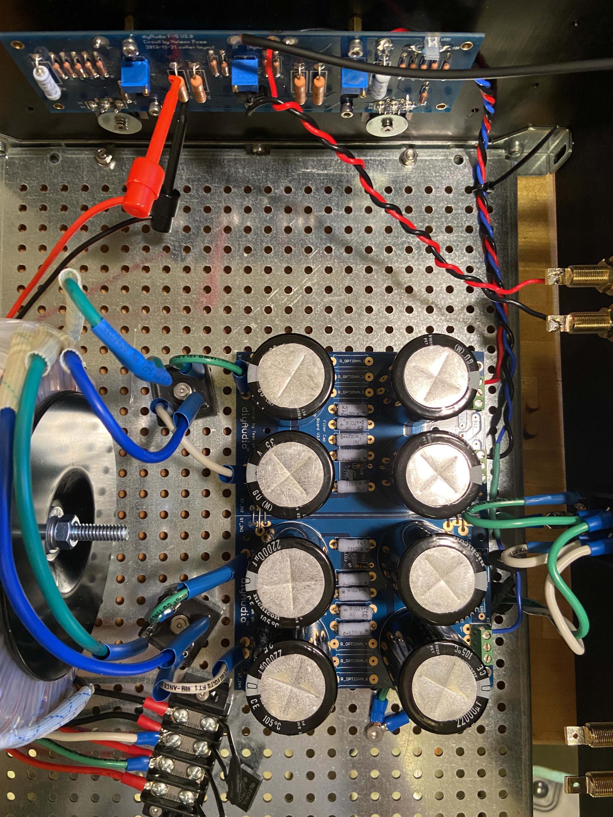

Smoke received. From the two .47 ohm resistors. Was on for about 2 seconds. Saw ~24v from the power supply output before I switched it off. Any ideas? Could I be confused about the orientation of my trimpots? I have them turned all the way counter clockwise except for P3 which I have turned 12.5 turns in.
Thank you for any help! Pics attached. Let me know if there is other info I can provide.

It's the trim pots being the wrong direction.. Just put them All the way clockwise and 75 watt dim bulb went off after a second..

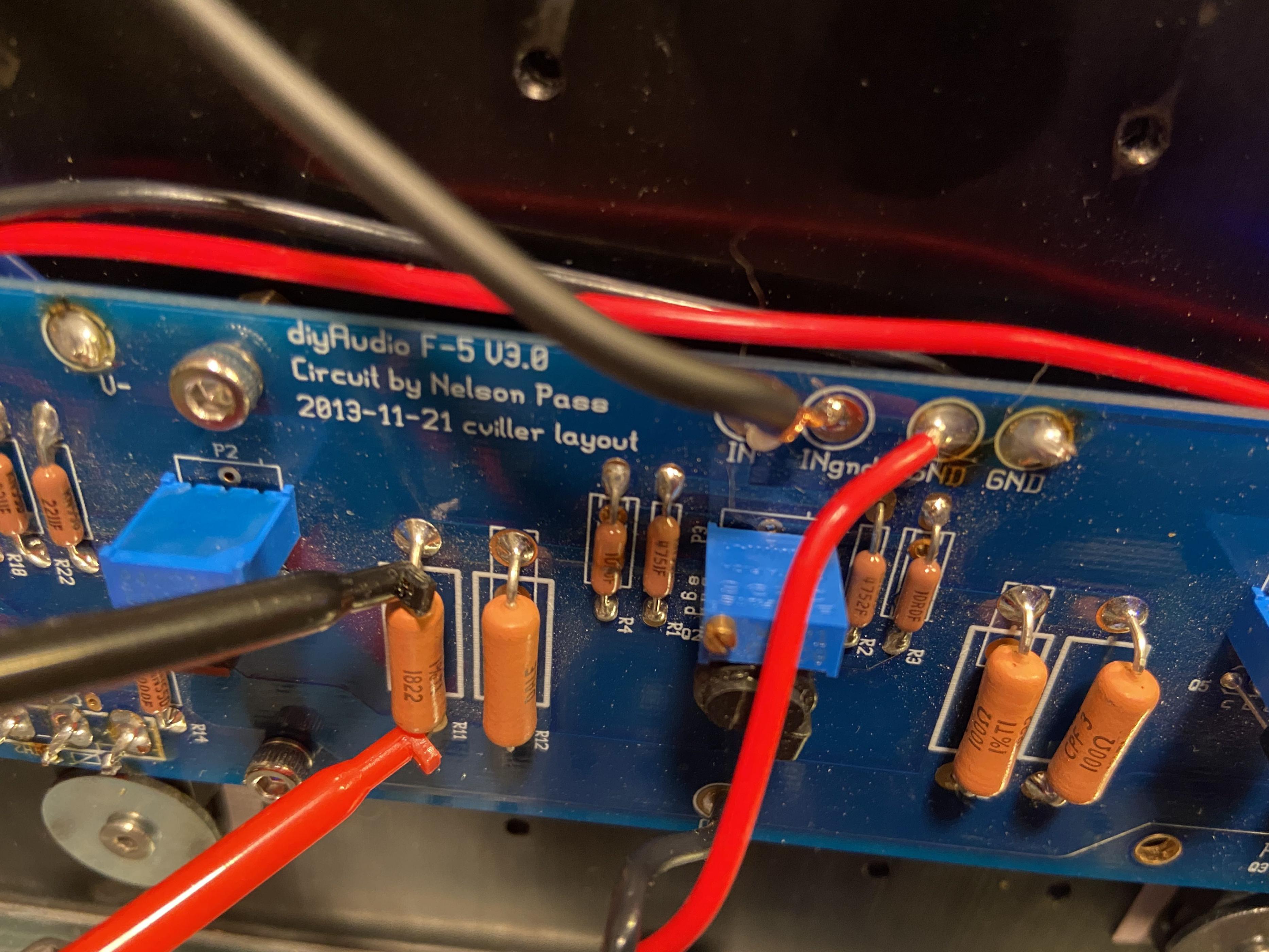

r4 smoked
Sigh. Doing the other side while I wait for new .47ohm resistors... This time R4 smoked during first startup while hooked up to dim bulb tester with 75 watt bulb. Went bright then dim (usually a good sign, right?) but I guess that was enough power to fry the smaller resistors.
Any ideas? Could the DMM probes cause this if i had them in the wrong place?

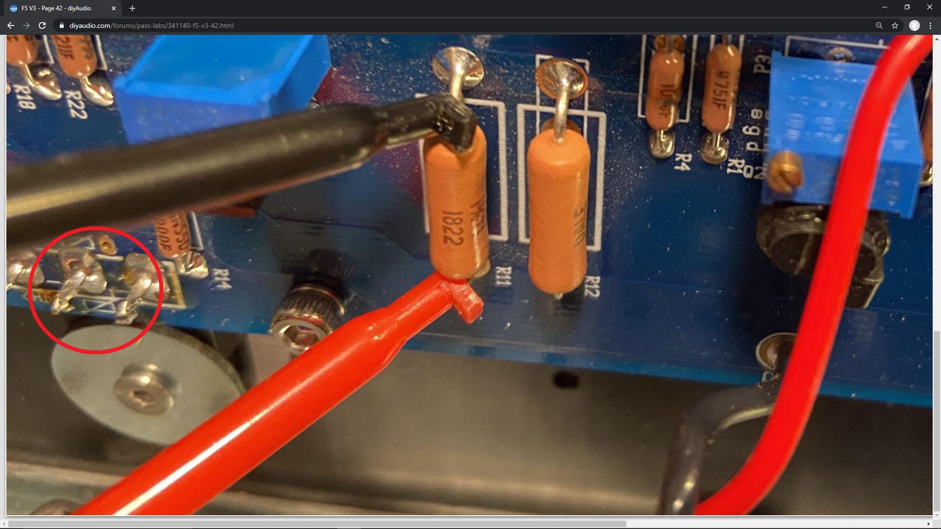

Okay. I see now that Zen Mod's startup instructions (Initial setting of F5 bias--help, please!) from 2011 are for an earlier version of the board. In the earlier version R11 and R12 are the .47ohm 3watt resistors... In version 3 the .47ohm resistors are R7 and R8.. So I guess that's where my probes should be. So the question is, could having my probes on R11 and R12 cause this? I had my probes in the same wrong place on the other side, and despite frying my .47 because of trimpot being turned the wrong way.. R4 did not fry there.
I don't think having the probes across R11/R12 will cause R4 to blow
but I believe R3/R4 may be at risk with large dc offset.
Before power up, did you verify that P1 and P2 are set for minimal resistance?
You can check that by measuring the resistance across R5 and adjust P1 so that
the measured value is small (ideally near zero) (Do the same also with R6 and P2)
I made the mistake of having P1 and P2 set to the wrong extreme on the other side.. They are set correctly on this side.
Could P3's position cause R4 to smoke? It's really close to it.. I'm not 100% that I set P3 half way. Hoping 2SJ74 is okay..

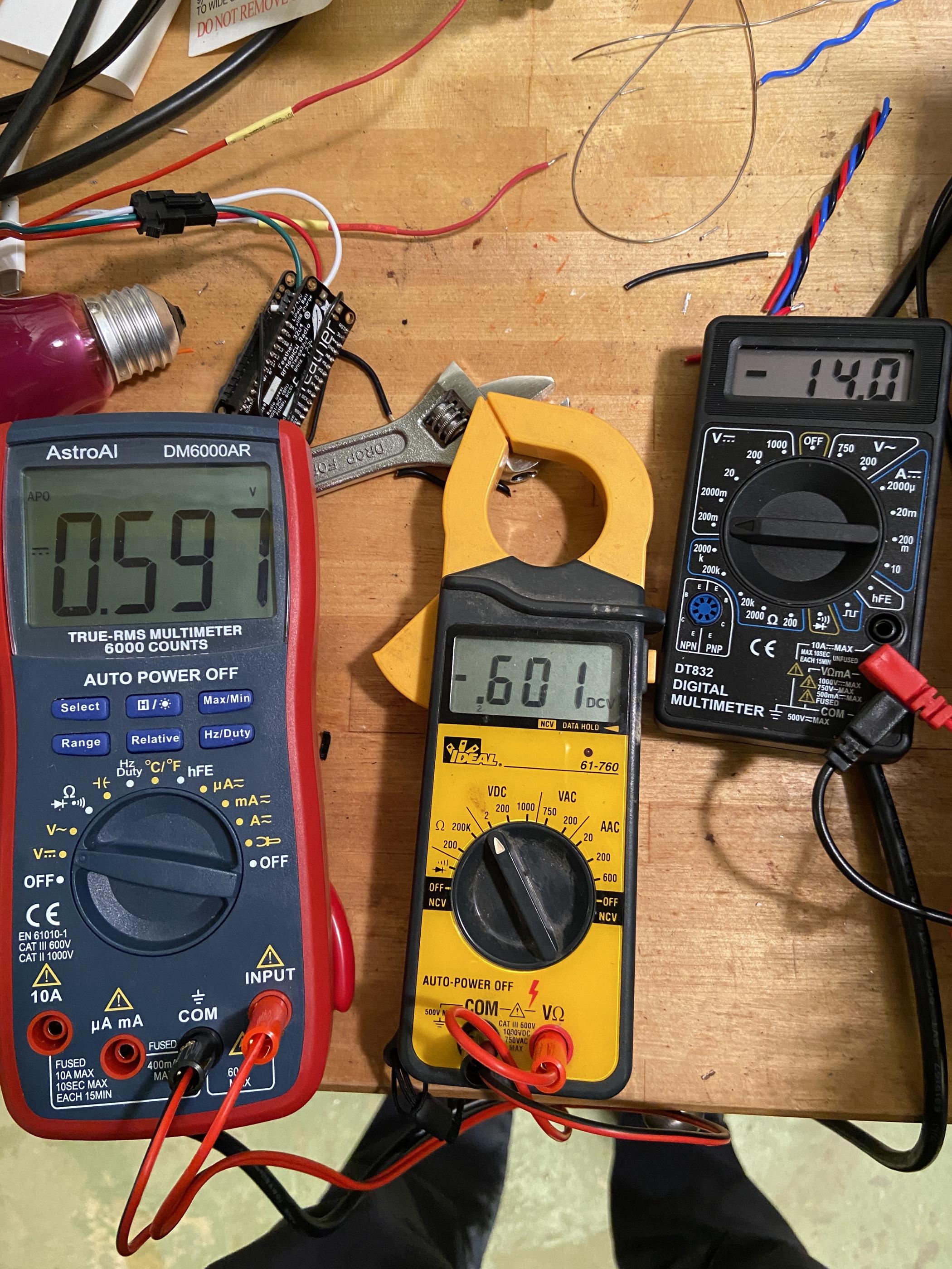

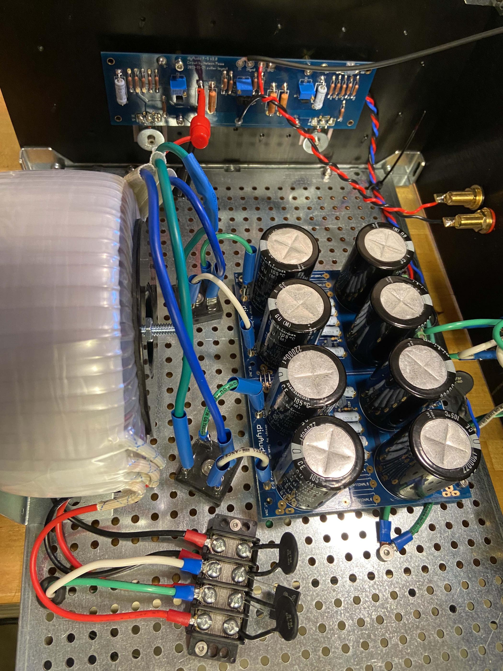

Okay. I think I got one channel doing positive things.. Pic attached.
But the other side is still not happy. I checked all the transistors to make sure they were in the right spots, and as best as I can tell they are... Any ideas at all what could smoke R4? Is it some random grounding that is happening somewhere?
