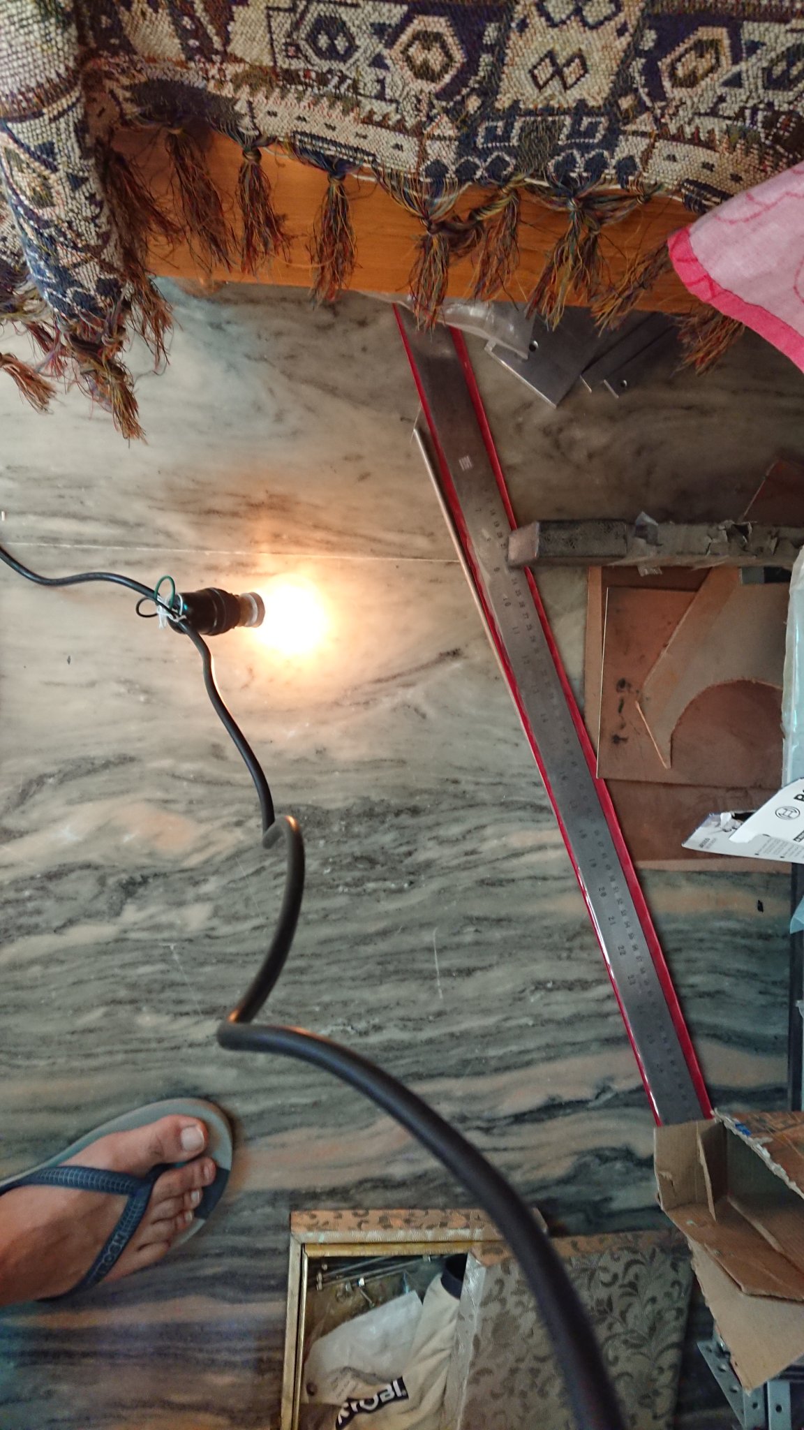

Connected bulb tester and it worked as expected, started bright and then dimming until no light. PSU was/is working fine.
Then started biasing the Amp with bulb tester connected.

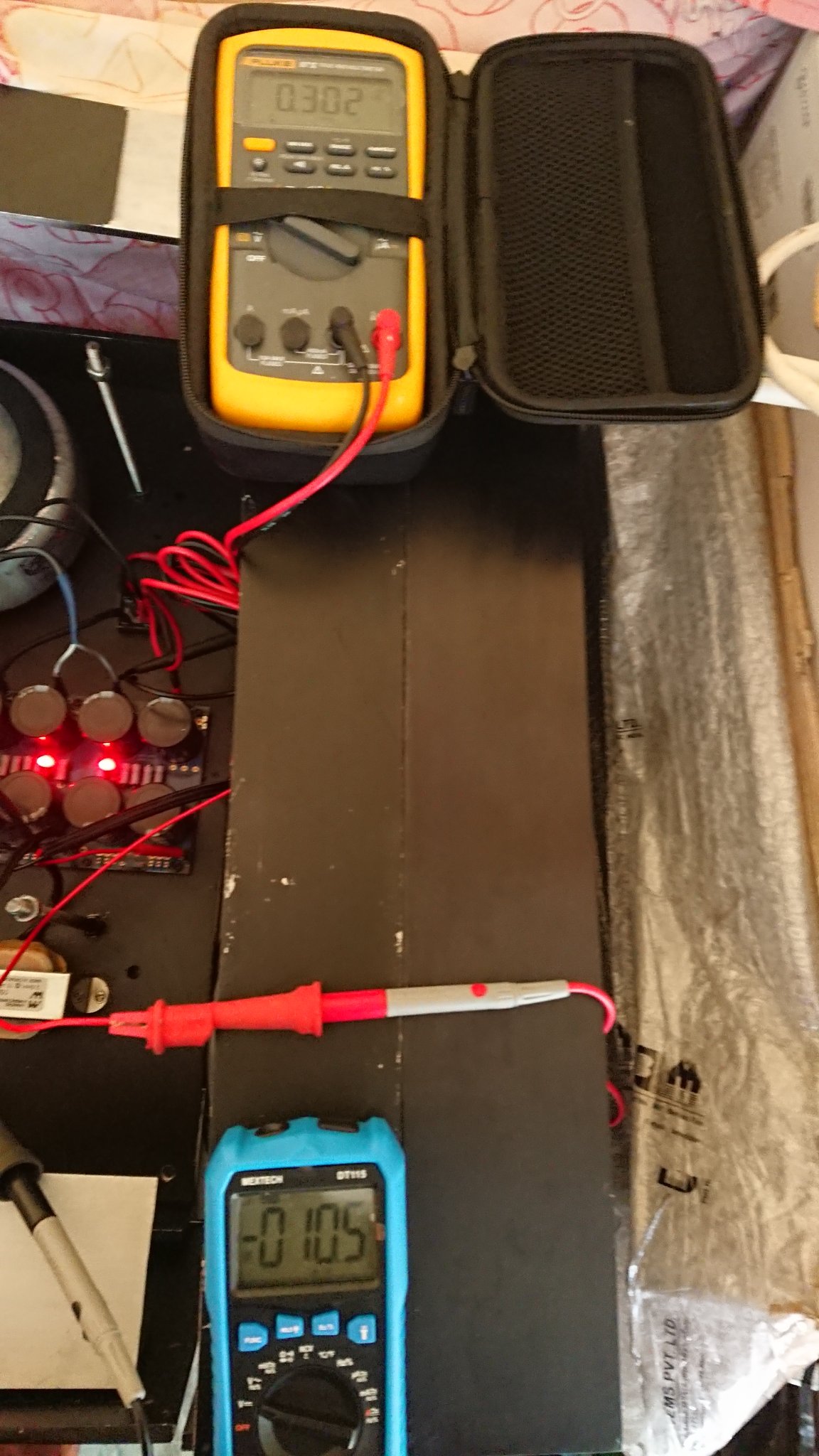

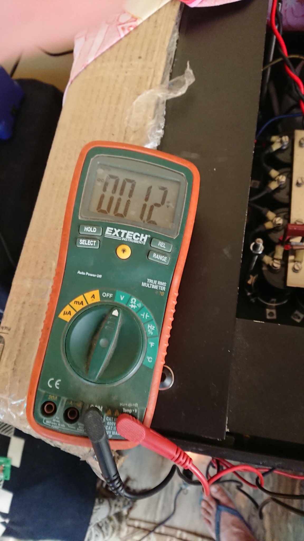

  • Kept doing this until voltage reached around 0.070 V, took pictures.
  • Kept moving trim pots until I reached nearly 0.100 V on the P-Channel, and 0.093 V on the N-Channel. At this point bulb was lit (not the brightest as in attached image).

Hello captJackSparrow,
you can not bias up an amp as long the dim-bulb-tester is connected. You get wrong readings on your DMMs (too low).
You use the dimbulbtester only for first switch-on if there is a short in your new built circuit.
I think you have biased up correctly ( you wrote 0,100 V over P-Mosfet and 0,093 V over N-Mosfet), but you did with the
dimbulbtester already connected - that was the mistake - I think.

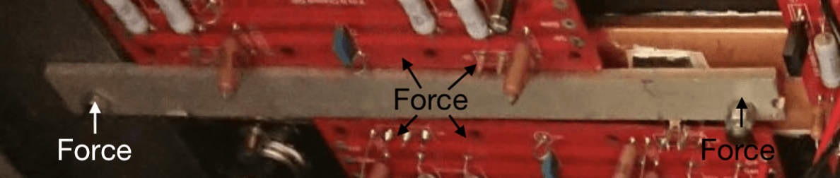

There are basic construction issues here.
The main issue is the retaining heatsink bar and the way it is fitted.
If you think about levers of the first angle; if you tighten the fixings the centre of the bar will lift, due to leverage and cause no cooling to the inner fets as the pressure is removed.
Sort that basic issue out and it might work.
Thank you.
I'll fix that.

@captJackSparrow : Please fix the mounting issue JonSnell pointed out,. You need a few more screws/nuts to ensure uniform and adequate pressure on the mosfets onto the heatsinks. How did you match the mosfets by the way? While you have the output boards off (to work on the mounting bar), please check the bottom of the mosfets for damages. Since you matched the mosfets yourself, you probably have spares and sadly you may need them. 🙁

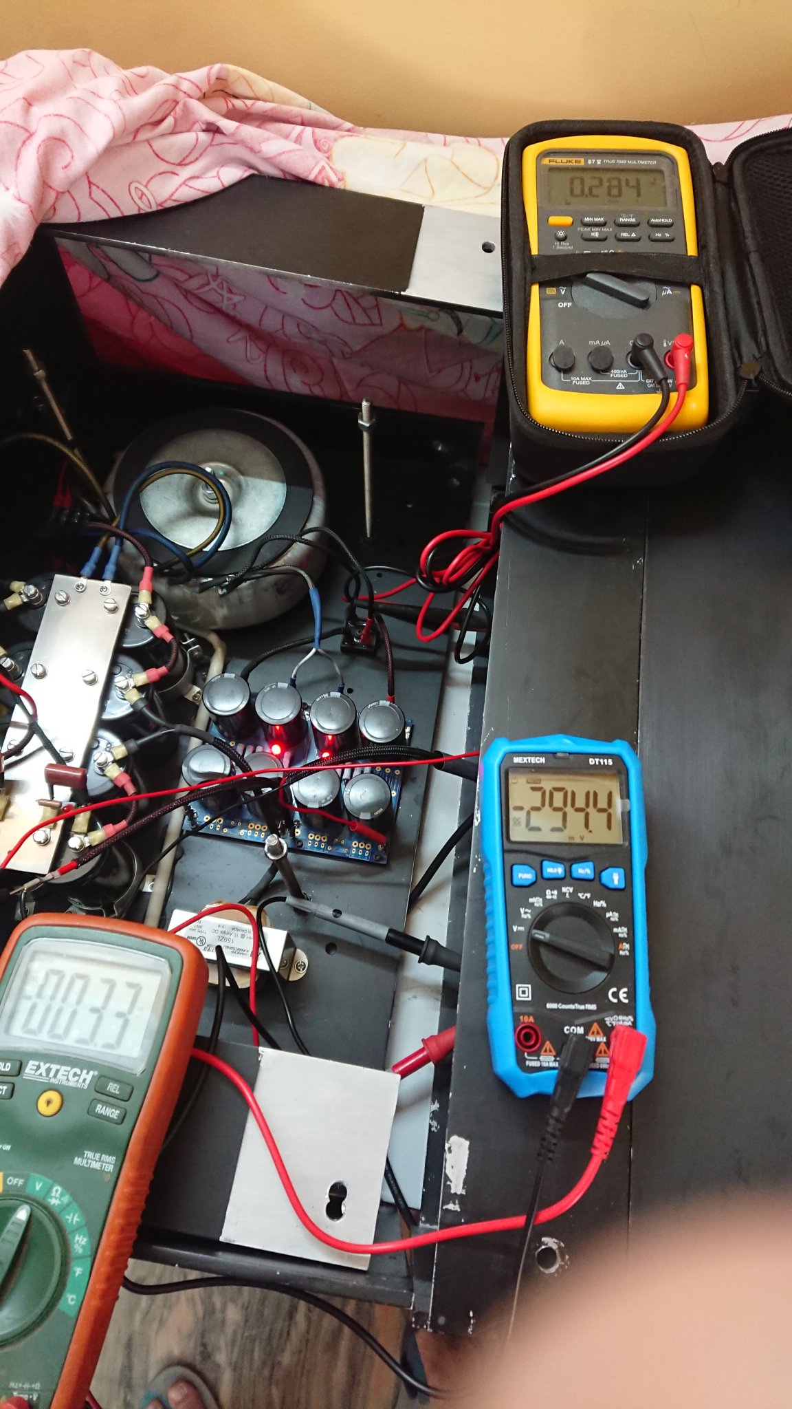

the fluctuating DC-offset at speakeroutput of arround +-10mV is nothing to worry about.
After 30 minutes of warm up - does it still fluctuate? There should be nothing connected to the input (perhaps a short-plug)
and no speaker connected.
You have pretty high railvoltage ( around +- 42 V DC, if I remember right?). Similar as my F5T. I would test it for temperature
at the heatsinks after 30 minutes of warm up (at your bias of 300 mV over one bias -resistor). Temperature of the heatsink should be around 50° C (55° C absolute maximum). If you are below 50° C, then I would go very slightly higher - in small steps.
Let's say to 330 mV over bias-resistor. Let the amp cook for 30 minutes, then measure temperature of your heatsink.
Don't forget, that closing the toplid will also increase your temperature in your amp!
Don't be too fast!!! Patience is your friend - or next repair... 🤔

After 2 Hour of cooking, results( I don't have the lid at present thats why stopped at 300mV)
DC offset started with +30mV and now its - 11mV
Bias voltage started at 0.283mV and now its 0.303mV
Heatsink at 50 C, no air movement at present on my worktable, just blowing air by hand lowers the DC offset. Ambient temp 24 C.
