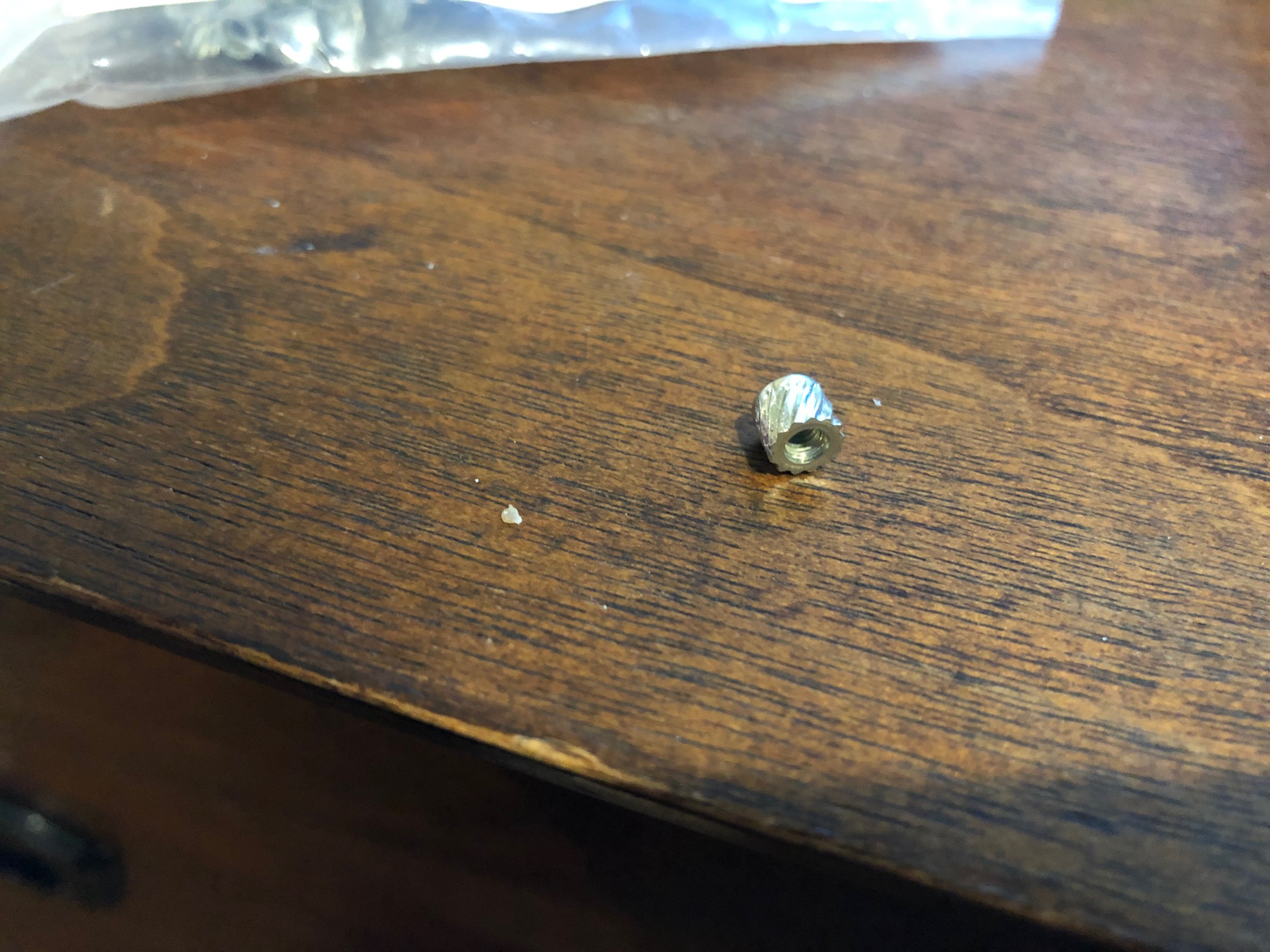

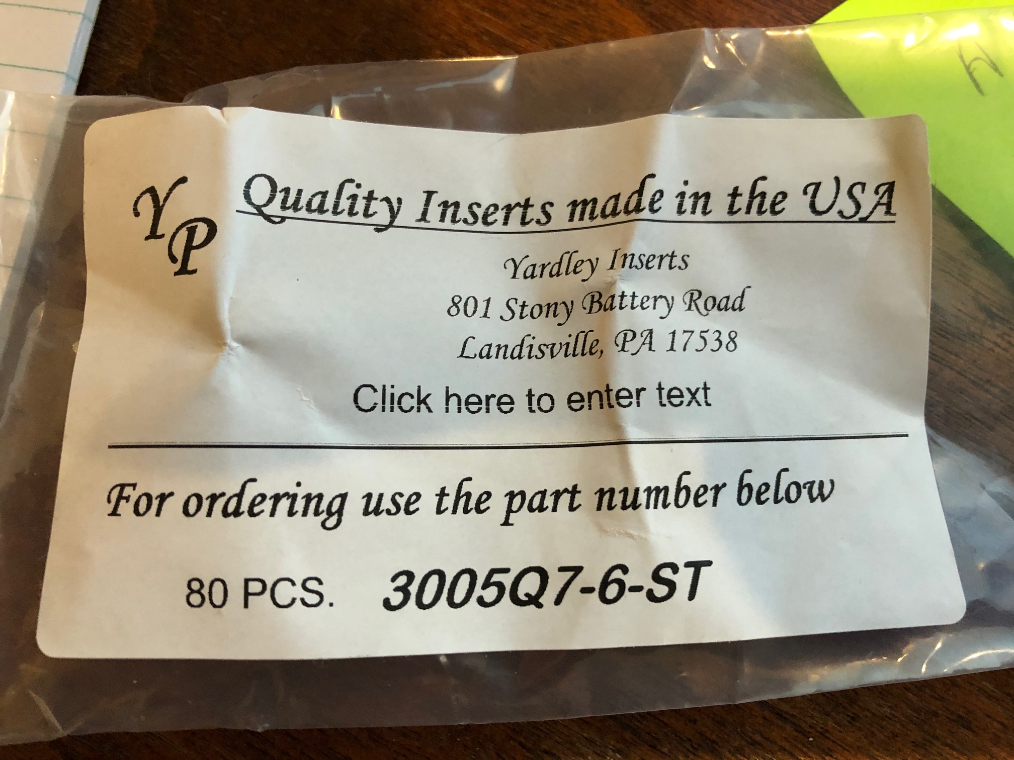

For those that asked, I use the insert because I find it easier to just drill a hole and not worry about tapping it. You can always screw up the tapping, whereas the insert just pops in. I've used them on five amps without problem. It appears I just drilled a too shallow hole on this amp for some reason.
Here are pics of the inserts I use. They are not super cheap, but they work really, really well.

You might be surprised about tapping being pretty easy. I use a Home Depot kit for 6/32 screws. I got the m3 size bits and taps recently for my singing bush build.
I use my cordless drill. The key I learned is use a squirt of wd40 as lubricant, and to take it slow. Tap until the resistance increases, back it off, wipe the swarf off the tap with a paper towel, dip the tap in the little wd40 puddle, tap again. Mosfet heat sink taps end up being 3 sips of the tap on average for me.
I ended up getting at 10 pack of the proper bits for 6/32 taps on Amazon - bench is a mess, so now I just reach for the packet.
