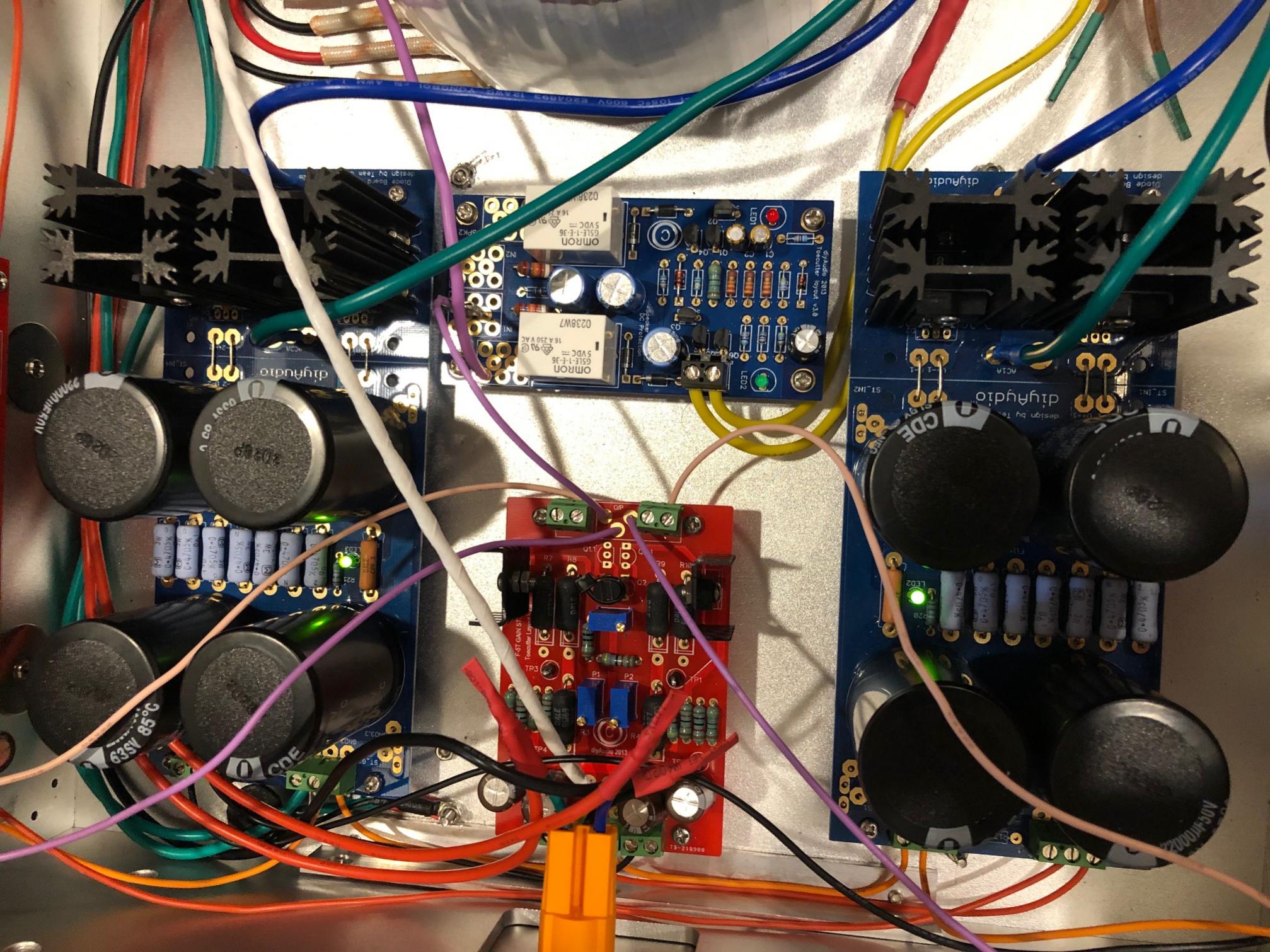

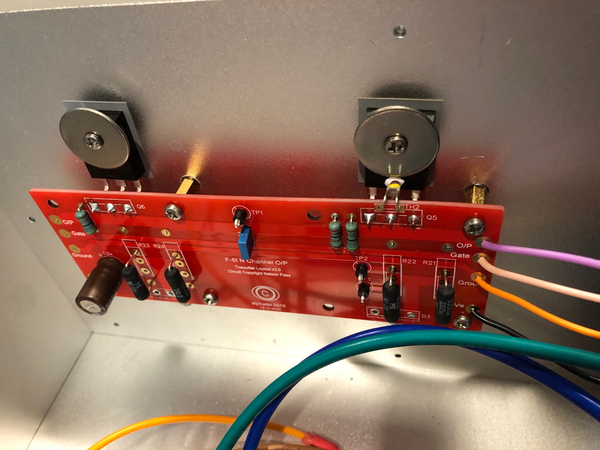

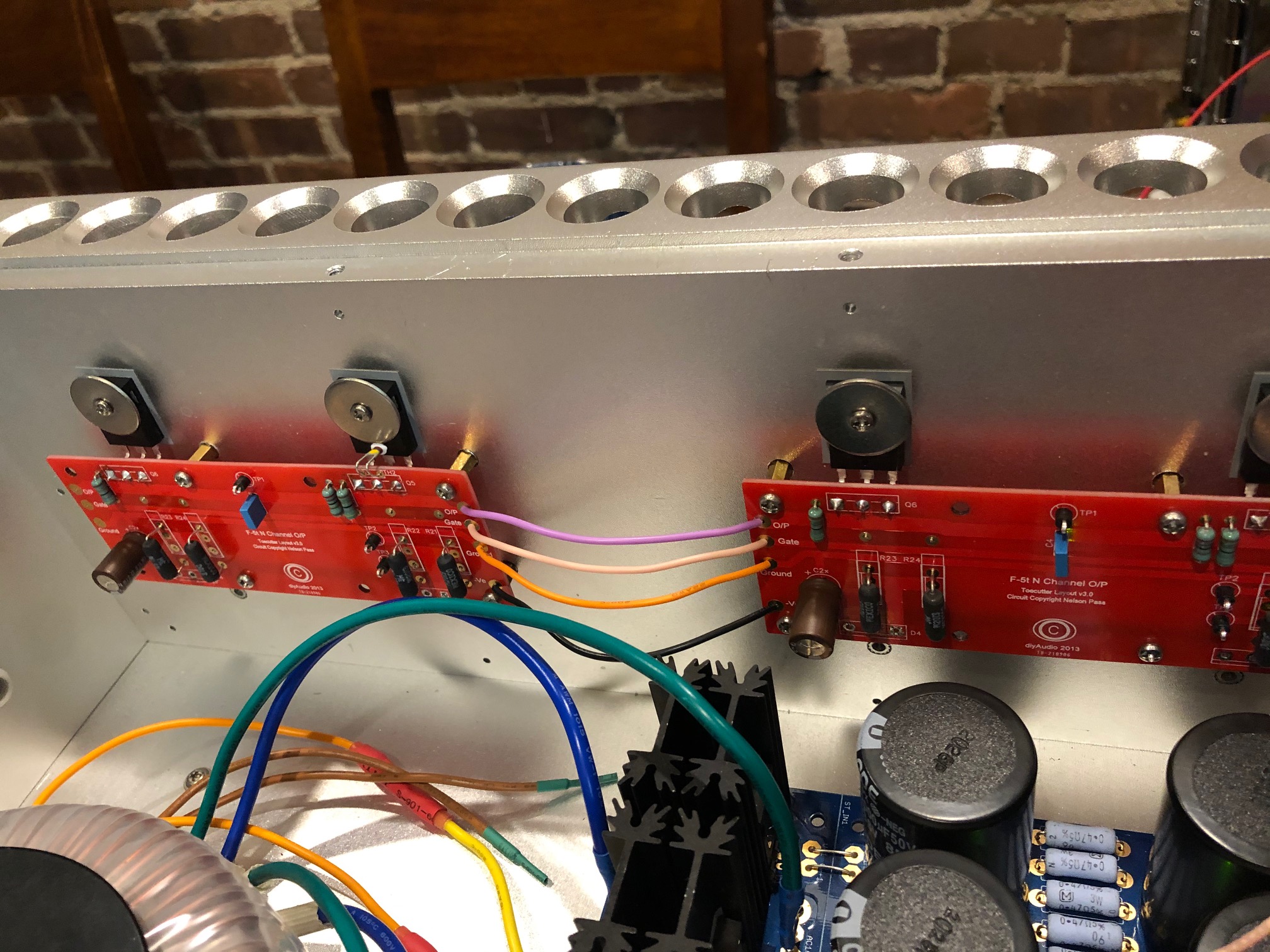

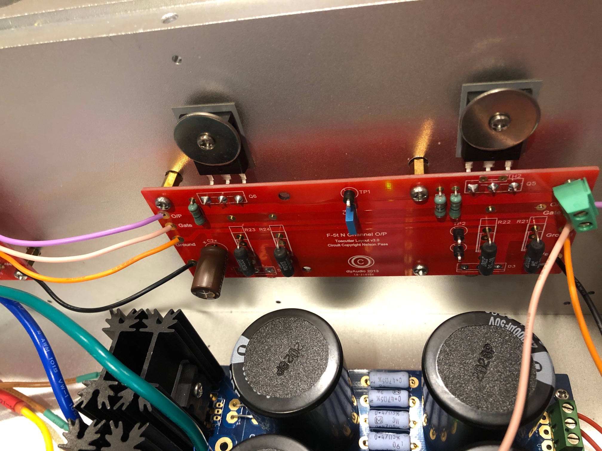

Some pictures are attached.
As you will see, the problem is definitely not the diodes, which I removed on that channel altogether today.
The measurements across the source resistors on the problematic channel are:
108.2mv
54.7mv
41.6mv
43.6mv

Your missing the thermistor on your problem channel, there should be one on each N & P channel PCB.
Good catch! 🙂
Yeah, I have some extras. I am going to remove that one and install a new one on the other board and see if there is any difference. I'm told it doesn't matter which spot you use, but worth a try.

Can you take close ups of the board with the mosfet acting up? Reason I ask is some of the solder joints I see in the pix in post #7 look like they're not flowing through on both sides of the boards. So perhaps solder could use a touch up.
