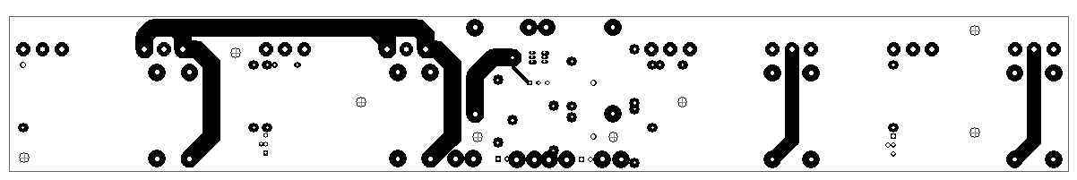

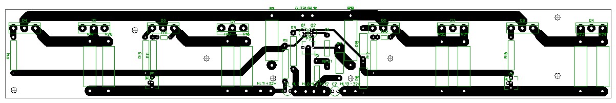

Please let me know if you see any isue with this
Please let me know if you see any major issue with this. I have created it based on layout image posted in this forum.
Component name are same as in F5 Turbo V2 circuit from Nelson Pass.
Thankyou
