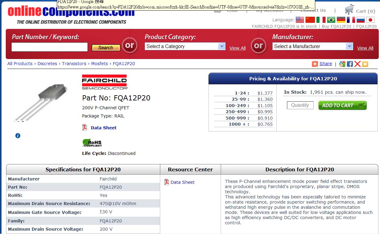

Absolutely. Fairchild doesn't even list it anymore. No stock at Mouser, no stock at Digikey.
