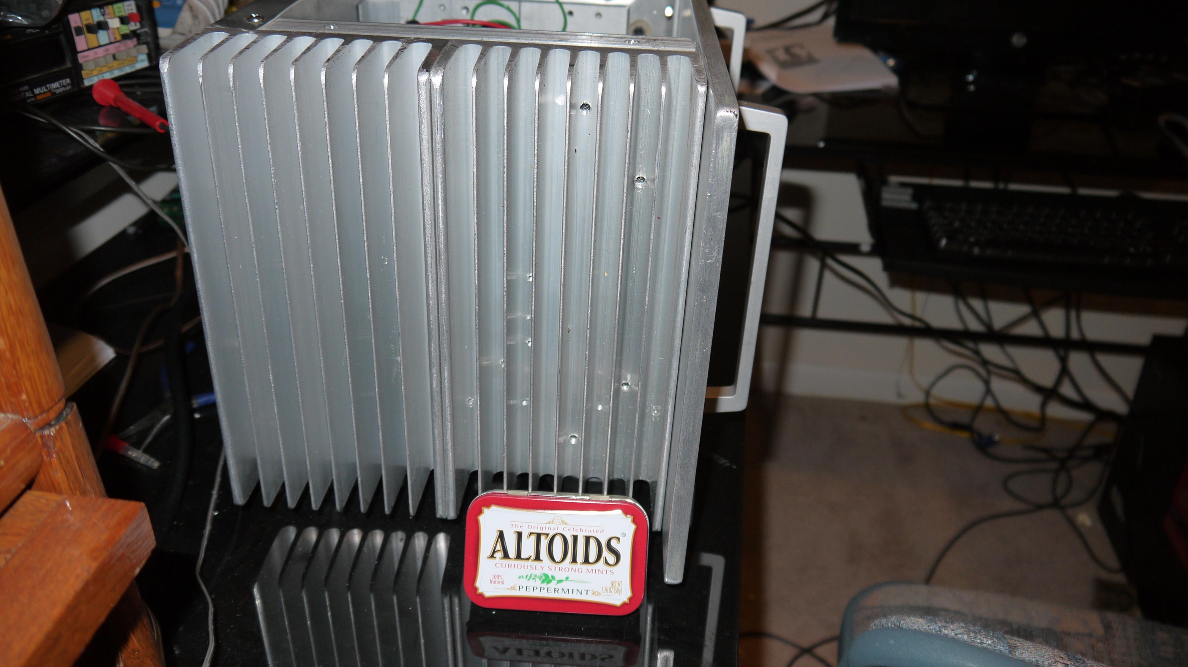

Thank you, I try to keep up with these threads when I can. I am still trying to figure out how to make mono blocks out of the boards I have. Is it acceptable to run equal length wires to the output mosfets? I found 2sj74"s recently at mojotone. Hope they are the real thing. Measured well....

I did see your heat spreader and must admit I was skeptical. I am interested to see what you think when you are cooking with all 8 outputs going. According to the original F5 article I am using for my guide. Each mono block will require about 384 square inches of heat sink. I can't see how I am going to tie all that together with the sinks I have. I will say my F5 runs only warm to the touch with suggested heatsinking.

That is a side view of my F5. Showing one channel worth of sink. The F5T will have 4 times that per channel. So if running wires is a no no, then I will have to buy or design long PCB's like Mr. sachu's. I have a very fine laser thermometer that shows very little difference from top to bottm or side to side in temp.
