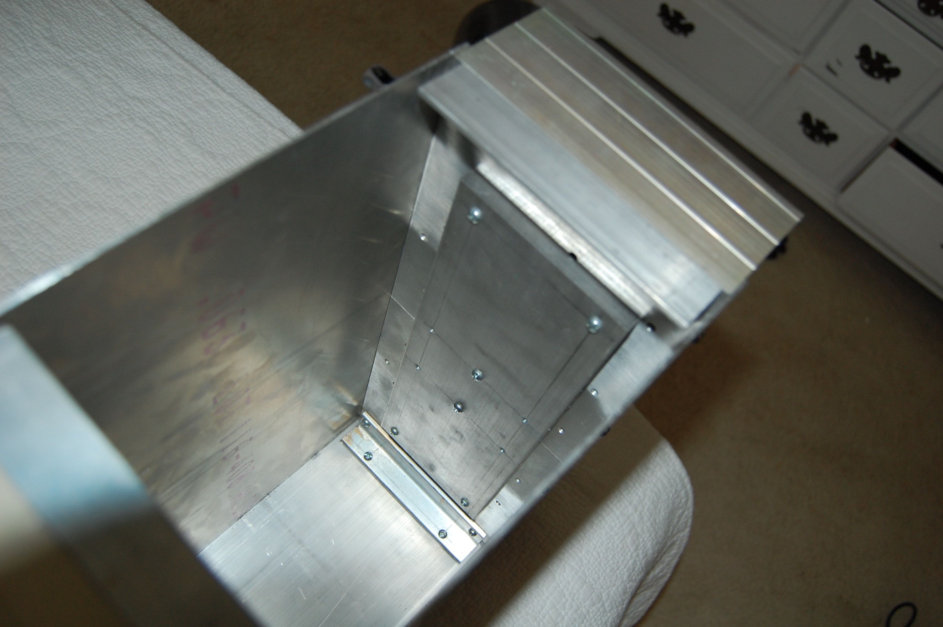

how is the heat at the center? the inner fets is close to the edge.
i also use the same sinks for my F5 with higher bias and dual outputs, and the sinks are hot inthe middle and cold on the ends.

Yep, hot in the center, cold on the ends.
Might do better with the DIYStore heatsink/enclosures. I don't know their prices, but it would be nice to support DIYAUDIO instead of another vendor.

then i must use 2 of the biggest chssis. they also have split sinks, so the problem remains. i have the V3 boards. so i just cut the output boards in half, and get the fets monted more centered on the 2 sinks. a 10mm baseplate only transfers heat well at max 100mm radius.

Are you using a heat spreader ... ? Ok looked .. nope .... !!!

I would definitely use a copper heat spreader for the final iteration. I bought 2 copper plates 1/4" thick, 4" wide and 11" long to complete the project. Probably should have gotten longer pieces, but you get what you can find. Copper is expensive!

Here is what my final build will be in. You can see the aluminum heat spreader. It is 3/8" thick. The pensil line is where the center of the fets will heat. It should maximize the efficiency of the heatsink within my capabilities. I know this will dissipate about 150W, as I have had that much on it. It is starting to push the threshold and depends on room temp, but it does maintain proper temps. I do have a ceiling.
