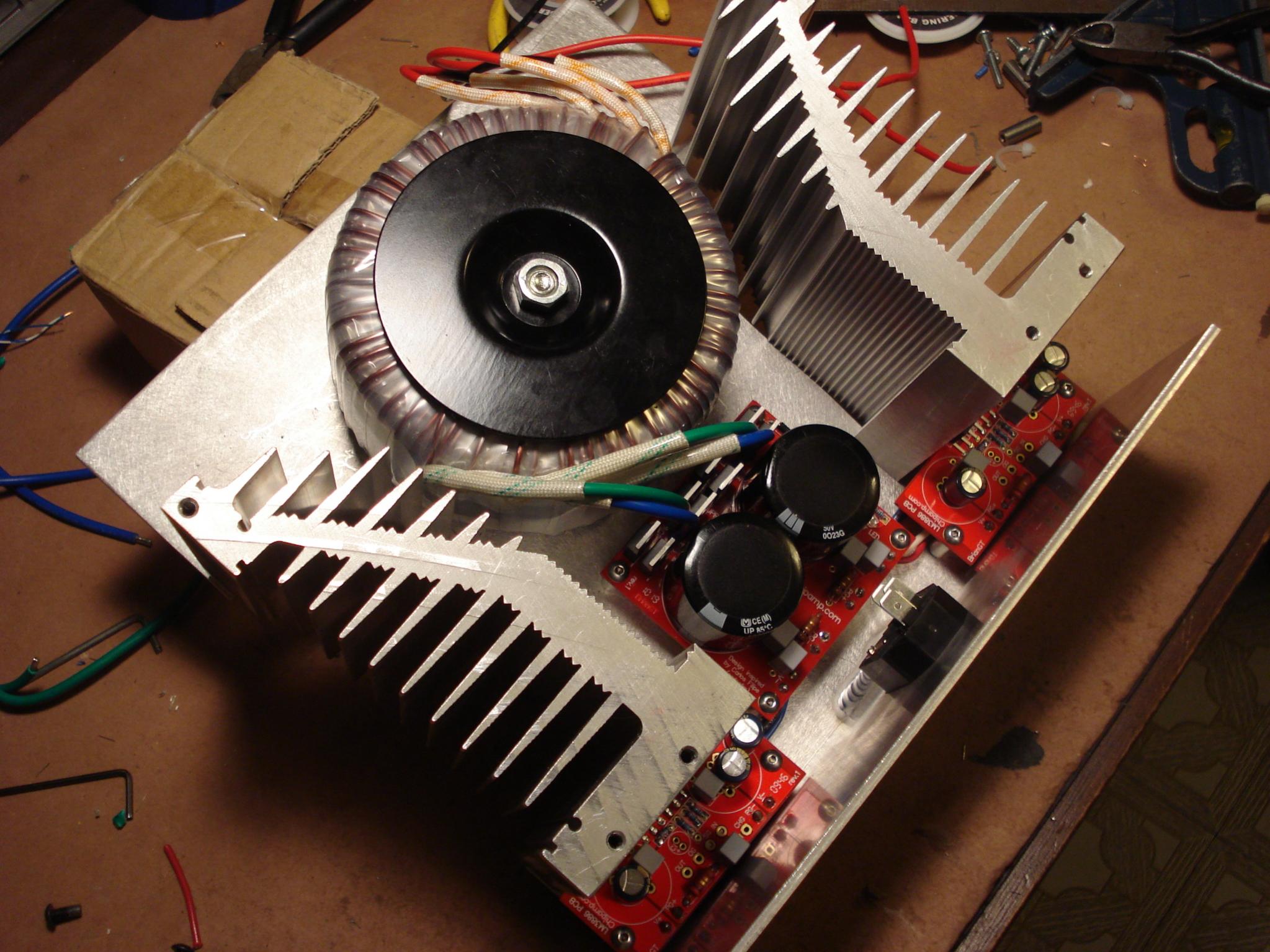

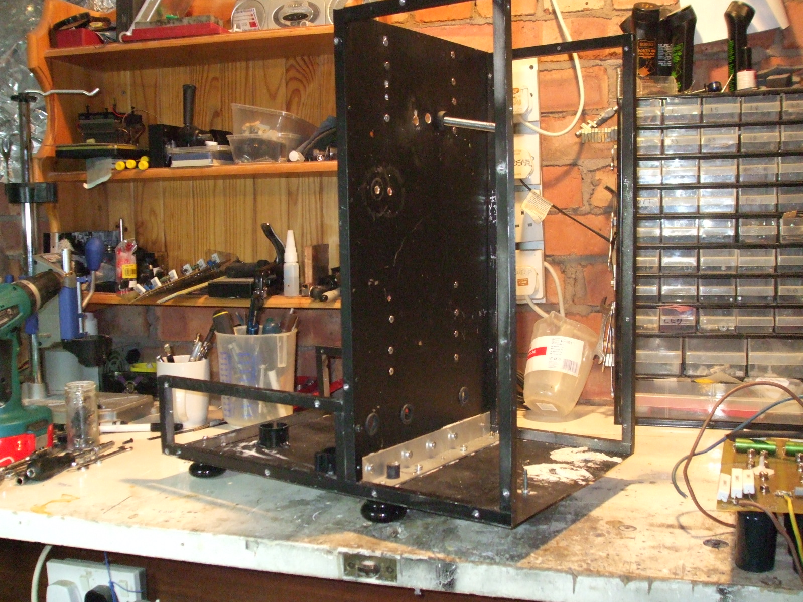

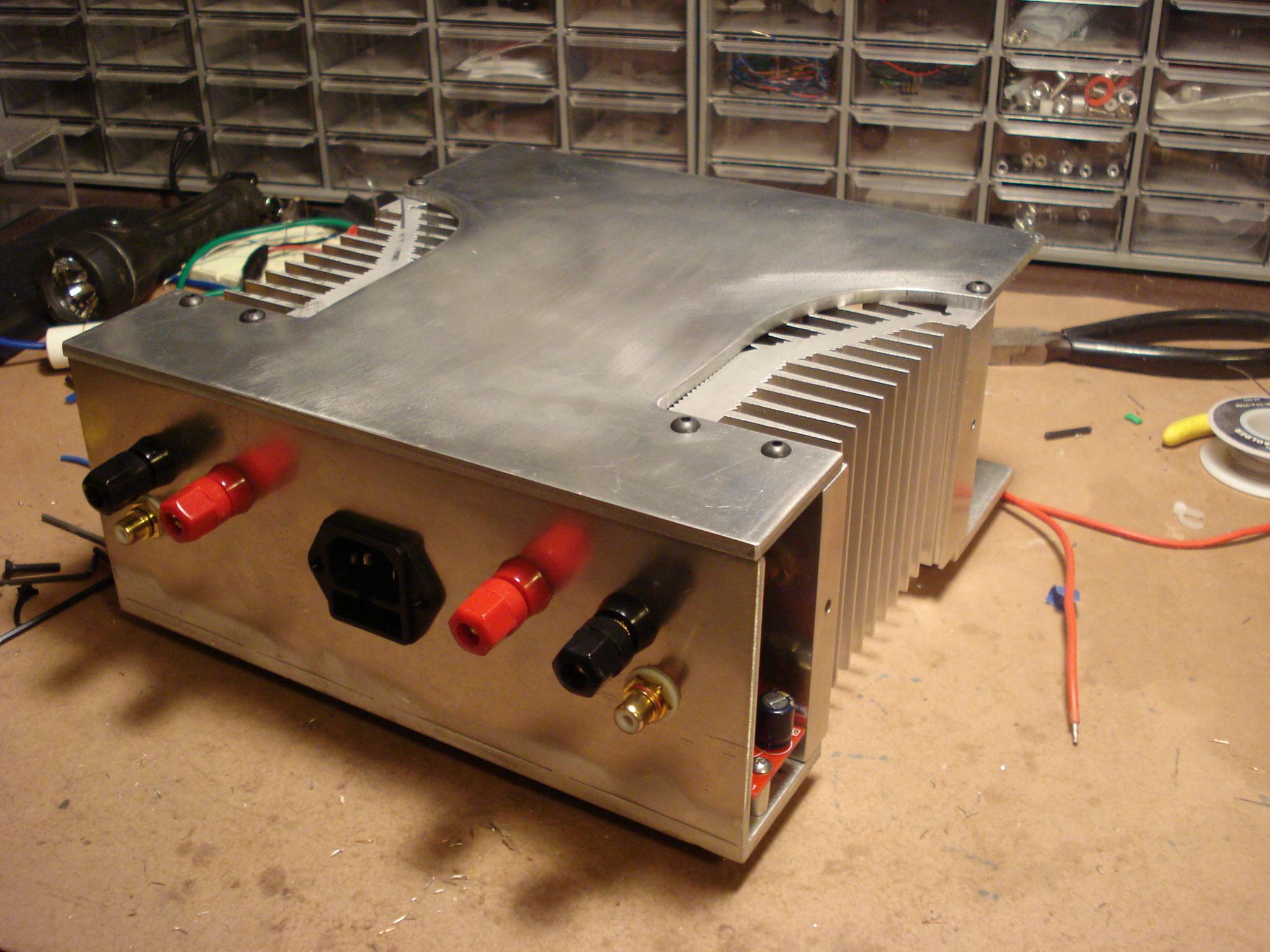

Guys, as someone who's DIY for cases, it's really not that difficult.
The on-going debate is "right on the mark". For an amp with two (left-side and right-side) heatsinks, it's easiest to allow the heatsink dimensions determine the size (depth and height) of the case. Once the heatsink dimensions are known, aluminum sheet/plate can be cut for the base plate, top plate, rear apron and front panel (four pieces). A metal shop with a good metal shear can cut these to size, only for the cost of materials and a "cut charge". We all should be able to drill the holes for the "small stuff" like binding posts, RCA jacks, panel switches. (Admitedly, drilling and tapping blind machine threads into an expensive heatsink can be a little nerve-racking.) A good "water jet" metal shop can cut larger or more exotic shapes like chassis vents, IEC outlet holes, fans, etc, etc. Other shops (like Front Panel Express) can do engraving, if you desire....and shops that do powder coat or anodizing should not be that far away (or are accessible through UPS, FEDEX, and other mail services).
My amp cases are home made, typically using 1/8" or 3/16" T-6061 aluminum.
No reason why you can't DIY a case that looks as good as a commerical unit, and to the specific design you want.
If we GB PCBs, components, transformers, and cases--then aren't we really just putting a "kit" together? (...... in sucn an instance, aren't we becoming KiyAudio'ers, and not DIY'ers?....)

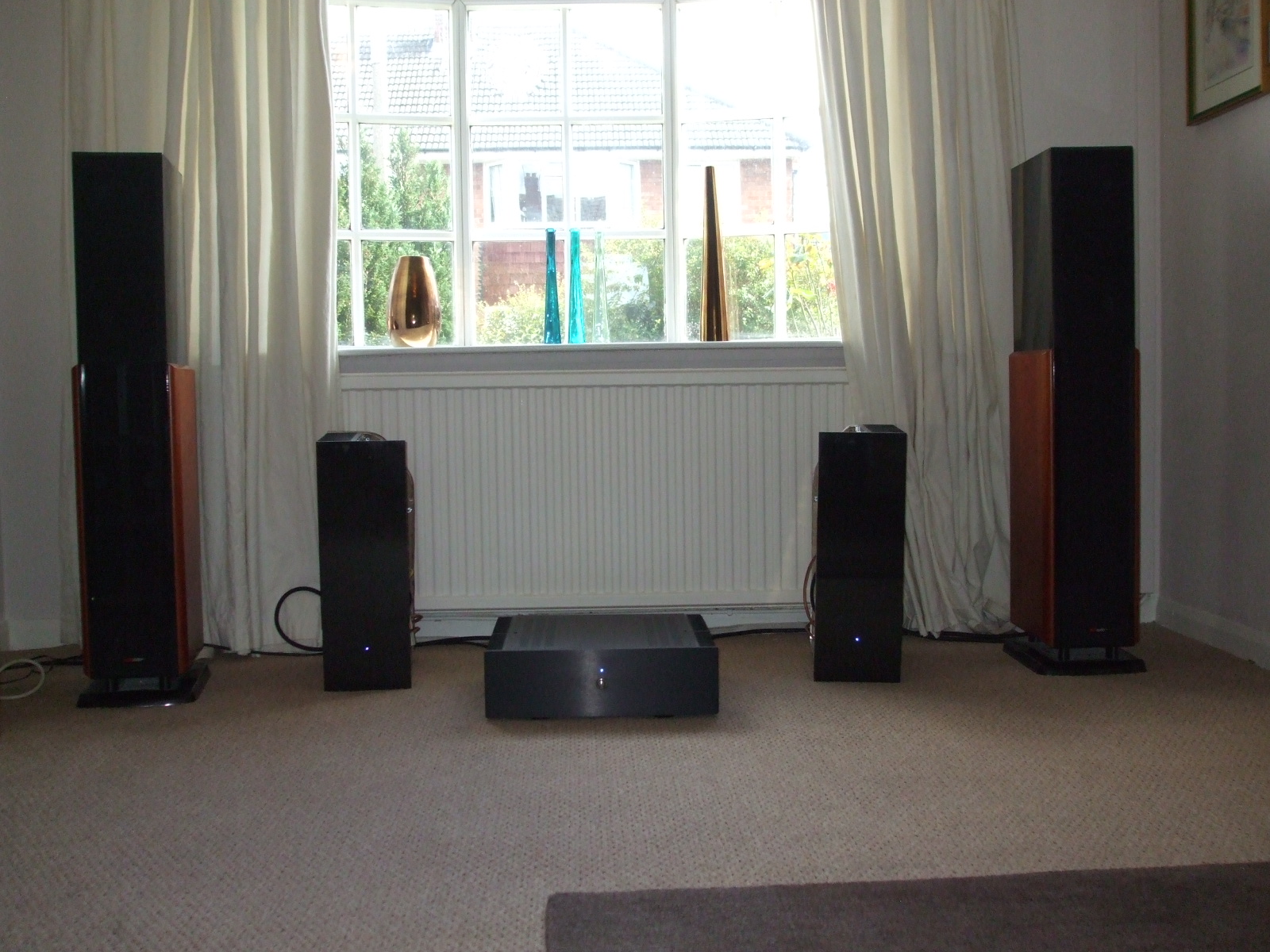

So you shuld refink the limitation of IKEA pretty preetty box with very poor heat dissipation impose and leave free thinking general population decide what best for them.
My room my speakers my ear much different from yours
😀But just thinking you got same to sell so any comment against sisssy voltagge get stumped😀
I bet you're really popular with your neighbours...
What are those speakers?
Never have any problem with neighbours
just changed job 12 hours shift 4 on 4 off just so I could play propper
Love it when I am home during week days and the rest of road is empty.
Actualy neigbours love me a lot loads of could you fix my light bulb and the string bit in the shower does not work (do them for free)
That stop them moaning about 4 in pipe in the car.
And 3 doors down actualy came over saiing how nice It sounds
The speakers are Polk LS15i prety nice 3D stage presentation (mean realy goooooood)
Against points
Bit to much bas (but that in my room)
Low impedence 4 Homs Nominal and only 87dB (that why I need volts and current)
and post sale support at least in UK is realy realy CRAAAAAAAAAP
and this main important part IMO, so would I buy again maybe not
Cremonas quite same sort to make comparison. (saving up for them)
Saiing al that a Krell integrated (400i if I remember) sounded realy sqack
F5 much better (could not realy believe myself how good it is)
