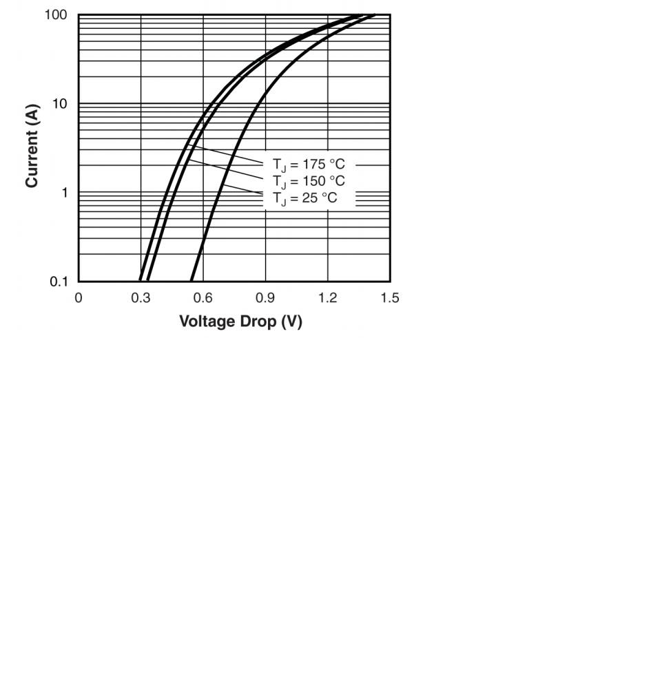

Unlimited by source resistors current
I still have a hard time understanding the operation that allows it to move from idle current over the source resistors to the diodes themselves. Is this determined by the diode behavior and characteristics?
Can someone spell this out for me using simple words, and easy math? 😕😀
I think the diodes don't conduct until a certain voltage is reached. .4 V I think, when they start conducting the output sees a lower resistance path and allows full current without the limitations of the resistor. The resistor is by passed by the diode only when the diode starts conducting. So you can set the idle current with the resistor, but don't go over the diode forward voltage limit (.4 V).
Someone please correct me if I am wrong!
Rush
The direct I/V function of the diode is used to simulate an Rs that diminushes as current increases.
At 20amps Vdrop is about 1V only, as if Rs were 0.05 ohms
The bias is set such as V (Rs) is nearly the threshold where the diode conducts..
Apearent Rs is about 0.47 ohms.
Then, as current increases, apearent Rs diminushes.
As for the maths, not me.
Edit: cross posting
Edit: cross posting
Of course they do, just no reason to show it in a datasheet.

Another area I don't understand is why this stays in Class A. Doesn't the amp quickly shift to Class AB?
The sentence I'm stuck on is "In addition, with Fets you get an output stage that will deliver more Class A power at a given bias figure due to the square law character of the Fets."
The amp does not stay in class A when the diodes are active unless the bias current is greater than 1/2 the current at which the diodes are active.That's an enigma for me too.
So still high bias rules the day.
