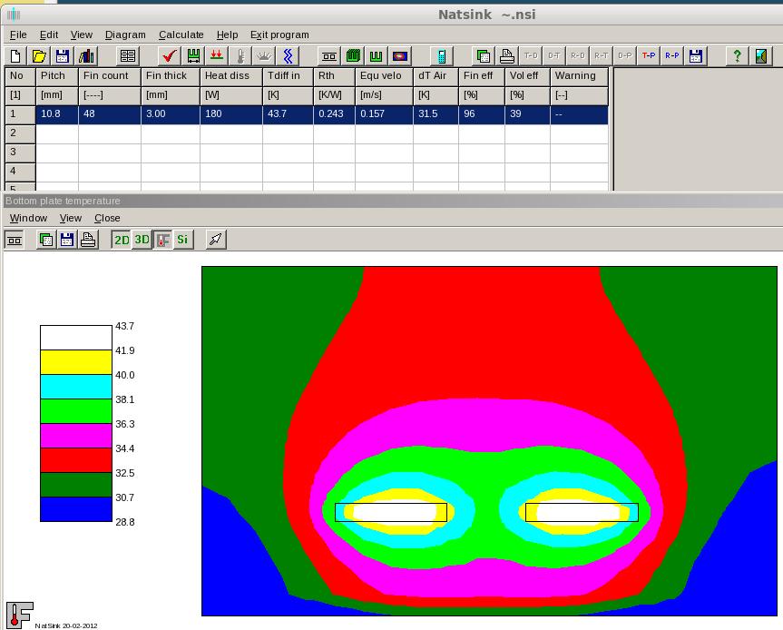

I'd guess you'd need around 1 kva per channel of transformer and two power supply boards. Sounds like a massive project inside one chassis.
going for height
None of my business, but with a 0.30" base plate and 1" fins, that heatsink doesn't deliver beyond a height of 7 inches.
(y'all know it's girth that matters)
The HeatsinkUSA E007 has 2.5 inch fin height, 3/8 inch baseplate.
But I agree that increasing the length (parallel direction of fins) of the heatsink doesn't help much beyond a certain point.
Well it's 16 inchs of girth and 12 inch looks good and fit a lot of caps and transformers ......... 🙂

Here is a simulation using the HeatsinkUSA E007 - 20" wide x 12" long, 48 fins, 180 W dissipation. With natural convection, the C/W is still too high.
I agree, unless you use a fan.20 x12 heatsink is not enuff...... 😕
Here is a simulation using a single HeatsinkUSA E007 12 inches long with an air velocity of .679 m/s. The table show results with other air velocities.
