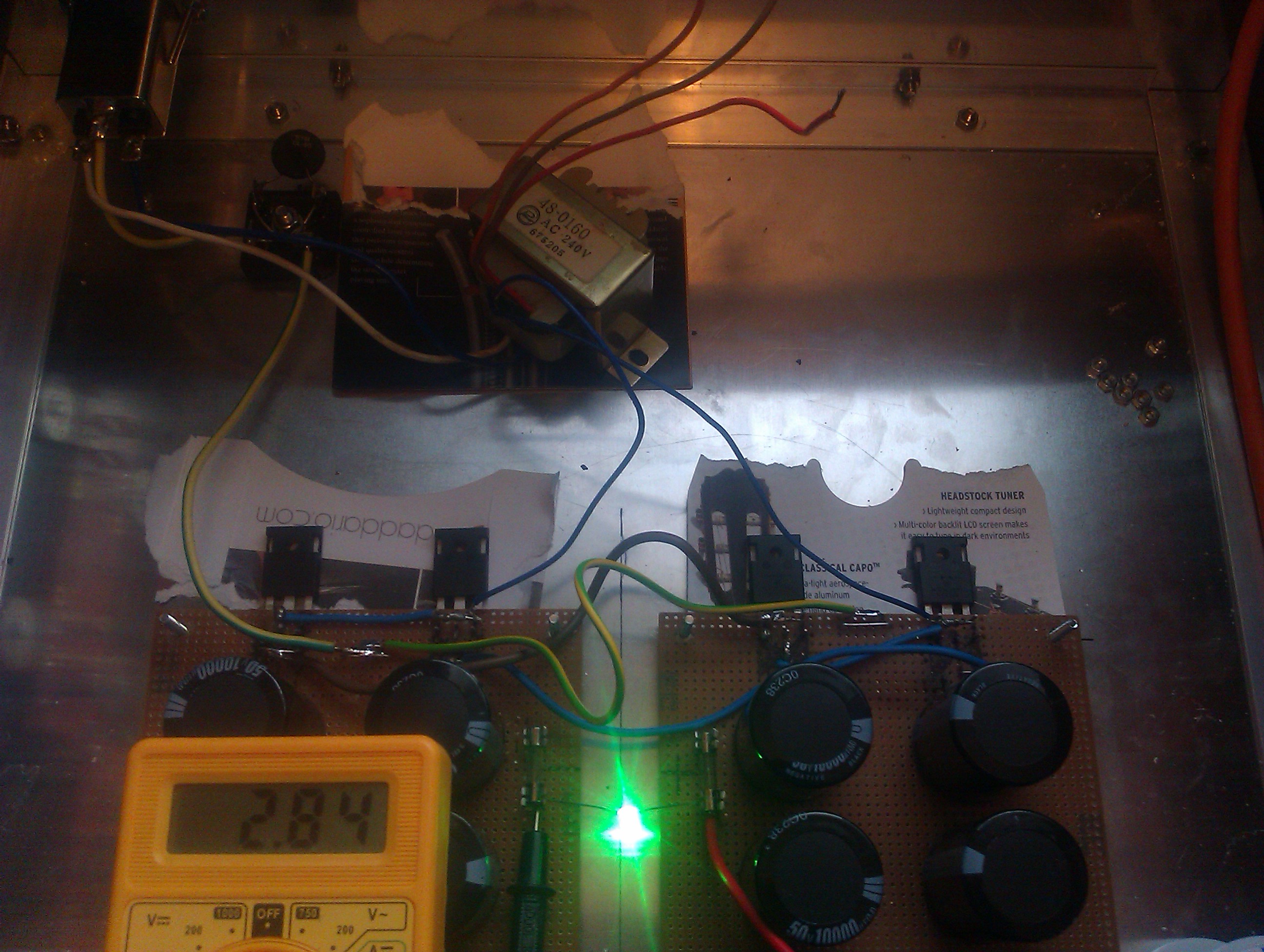

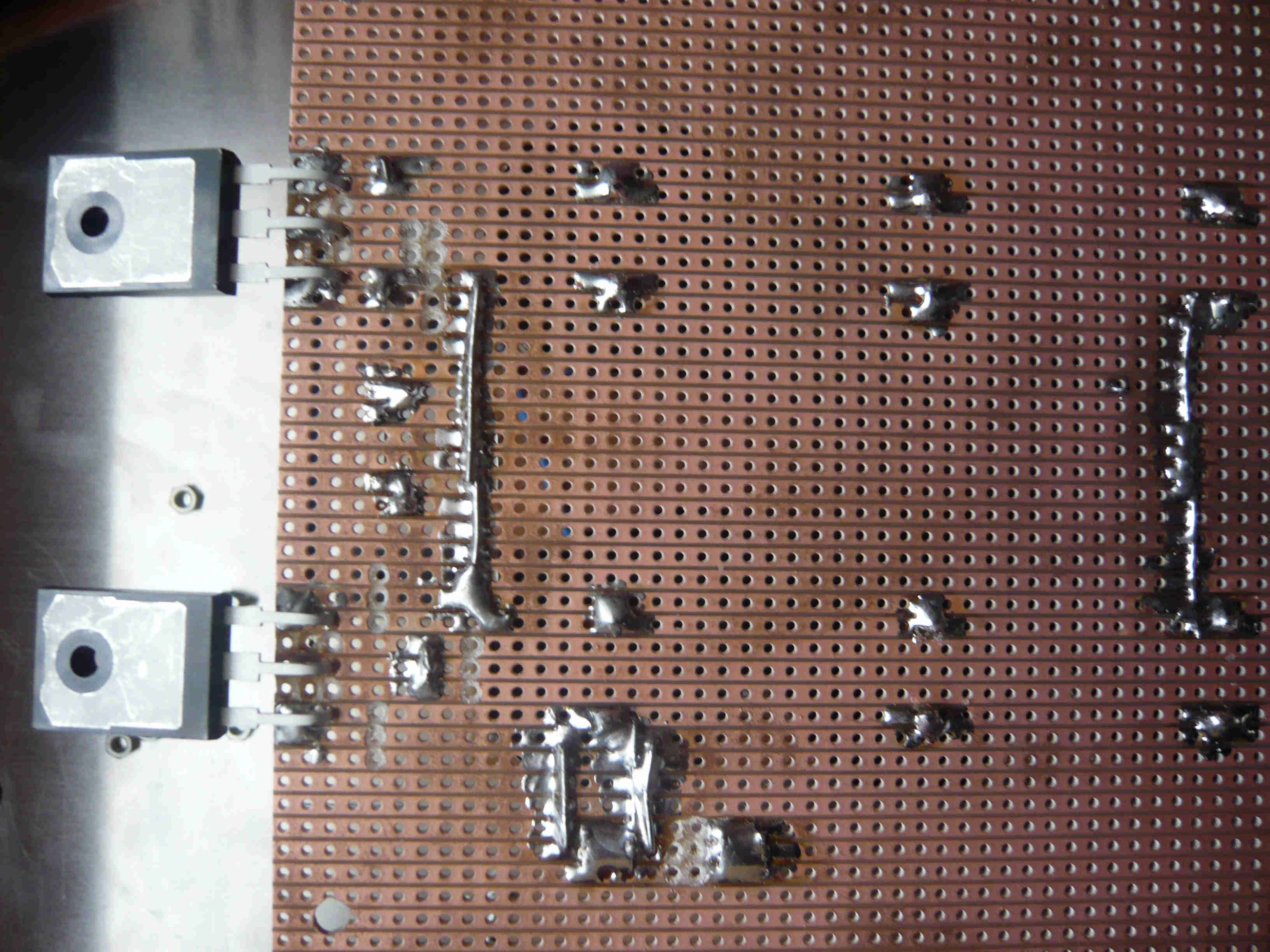

This is my Messy Stripboard wiring, I could have used the Diyaudio power supply boards.
as you see Im using a whole bunch of strips as the ground points.
Its a bit messy but hopefully will be ok!
I don't have a problem with your PSU wiring on veroboard, but then I am not as experienced as the others here.
When I am doing similar stuf I like to double the power traces with "rigid", I mean single core power supply cable like 3x1,5mm2 (AWG 16 ?).
I just strip the insulation off, bend it as needed, tack it down to the veroboard and solder to the caps.
Easy, cheap and good for 16 Amps on european 240V networks.
Your local hardware store should have some cut-offs for 3 x nothing.

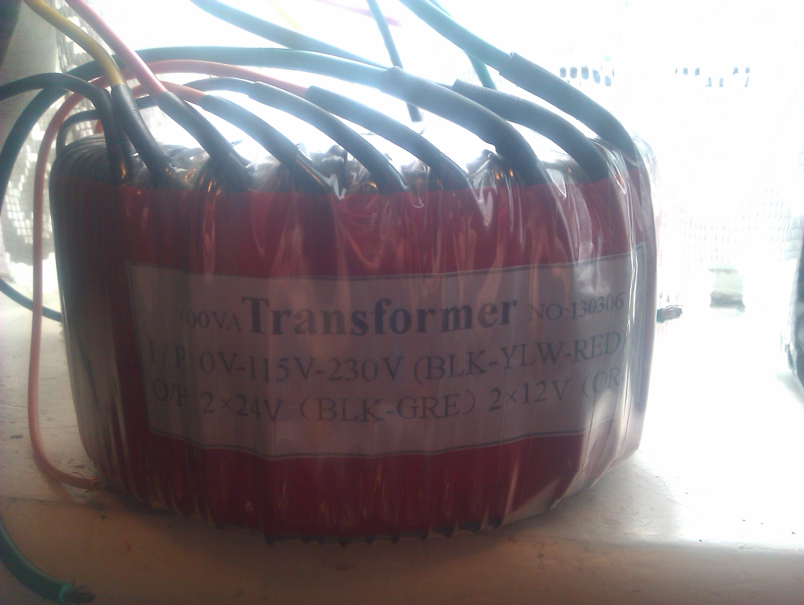

Btw the transformer Im going to use has Primarys as
0v - 115v - 230v
BLK- YLW - RED
So I presume for my 230v I need to use Just Black and Red ? not all 3
so my question realy is does anything have to be done with the 115v wire ?

Yes.
The Yellow is just a center-tap to the primary winding. Just ignore the yellow center-tap and wire as any other transformer with 230V single primary.

Thanks, brilliant just leaves the issue what to do with that thermistor in schematic.
actualy It seems like i can just wire thermistor In series.
Stick it on live lead, downstream of fuse. All it does is limit current at startup to help keep fuses blowing when the caps charge.

Was thinking before, in the PSU... GND doesn't go direct to chassis but goes thru the rectifier etc first.
I have a B1 buffer in the same chassis. its GND goes directly to the Chassis, so If i connect that ground to the F5 which will probably end up happening, would that be a problem ?

you must
"two" audio gnds must be one , isolated from chassis via NTC or diode bridge or whatever other proper way
Inside a conductive Chassis each channel that has it's own dedicated and isolated PSU must have ONE Main Audio Ground.
Any Channels that share a PSU must have ONE Main Audio Ground.

That is how I did my KSA50 clone and it is dead quiet. Hear nothing with my ear to the speaker.
One audio ground per channel with it's own PSU, these are then connected via loop breaker circuit (bridge/CL60) to the chassis, which is connected to the safety earth.
