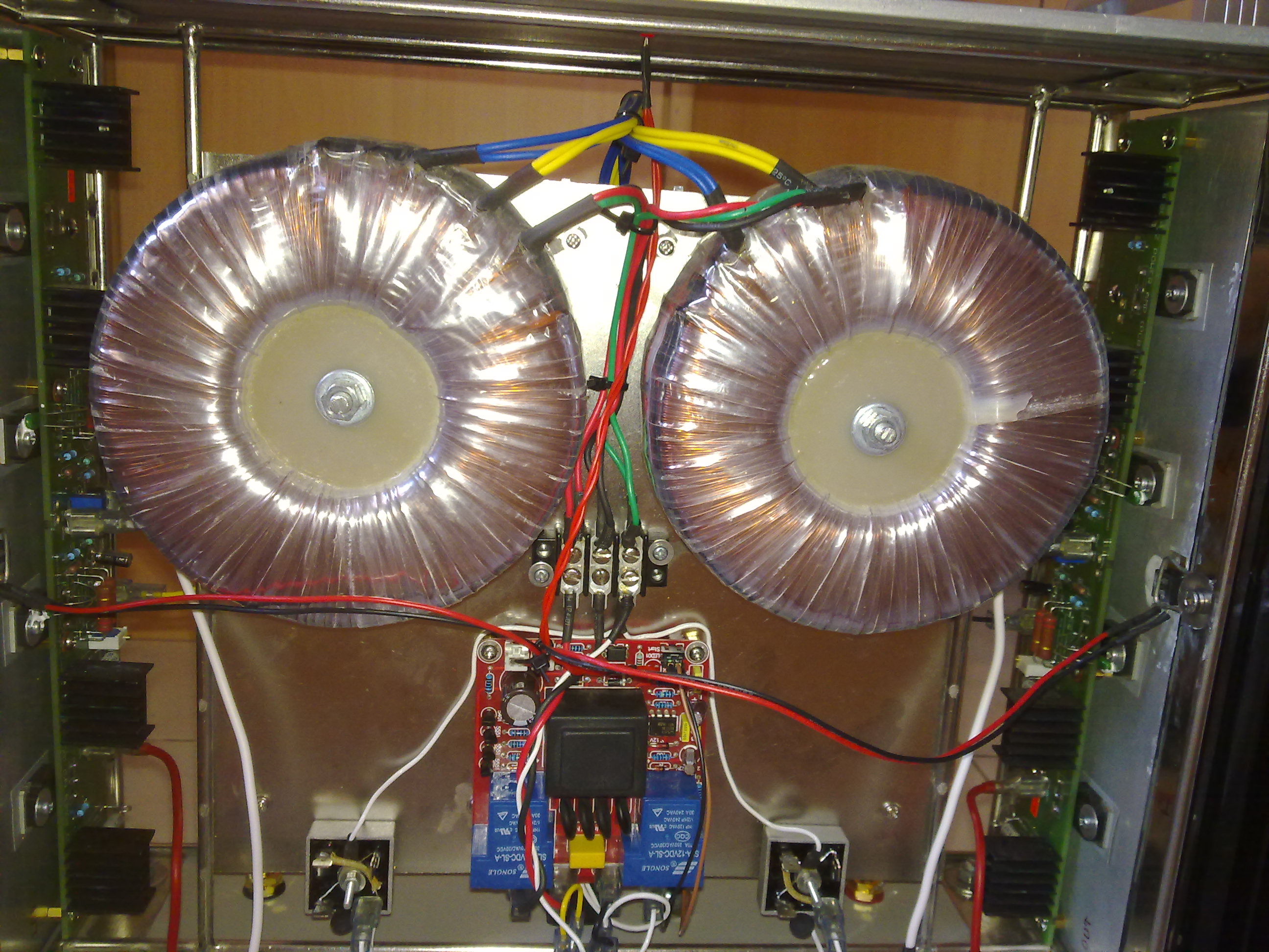

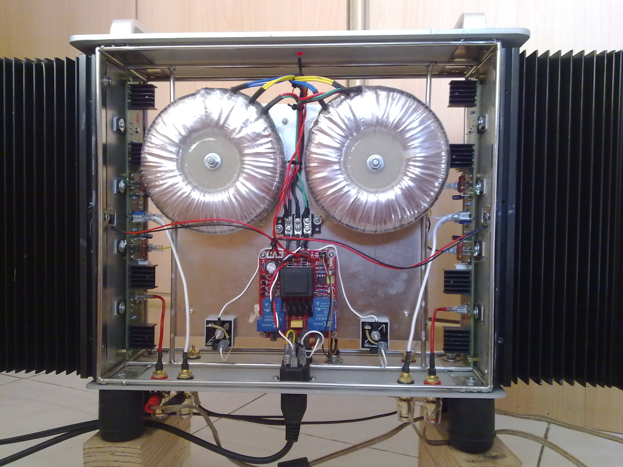

I completed my dual mono vertical box. Running successfully at source resistor voltage drop 300mV(0.6A bias) per device. Thanks again NP, all FM here and buzzforb for semiconductors.
Power Supply, mains section. I used softstart and thermal cutoff from bay.
Closeup each toroidal transformer is 300VA, 2X24V secondary.
Partition separation - 7mm gap between open end of transformer mounting bolt and side panel. 5-6mm gap for power caps and side panel.

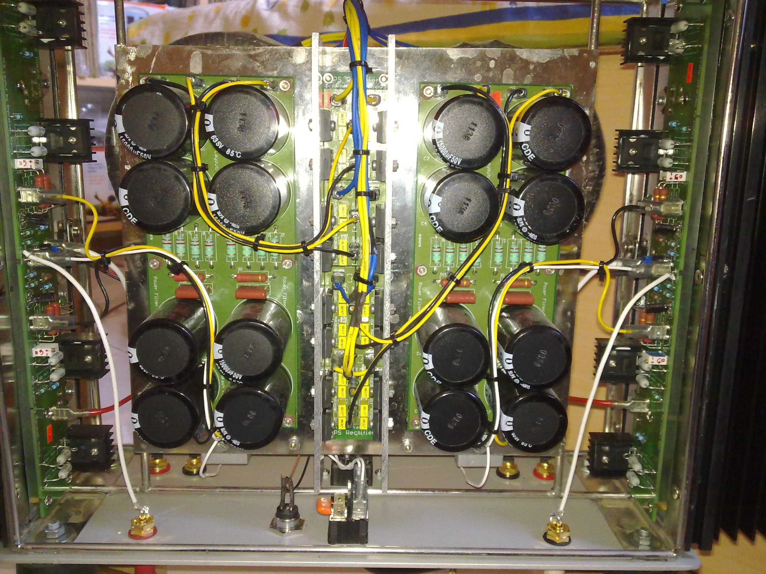

Other side of the partition, all power bank of DC voltages. I used 8 X 15000µF per channel.

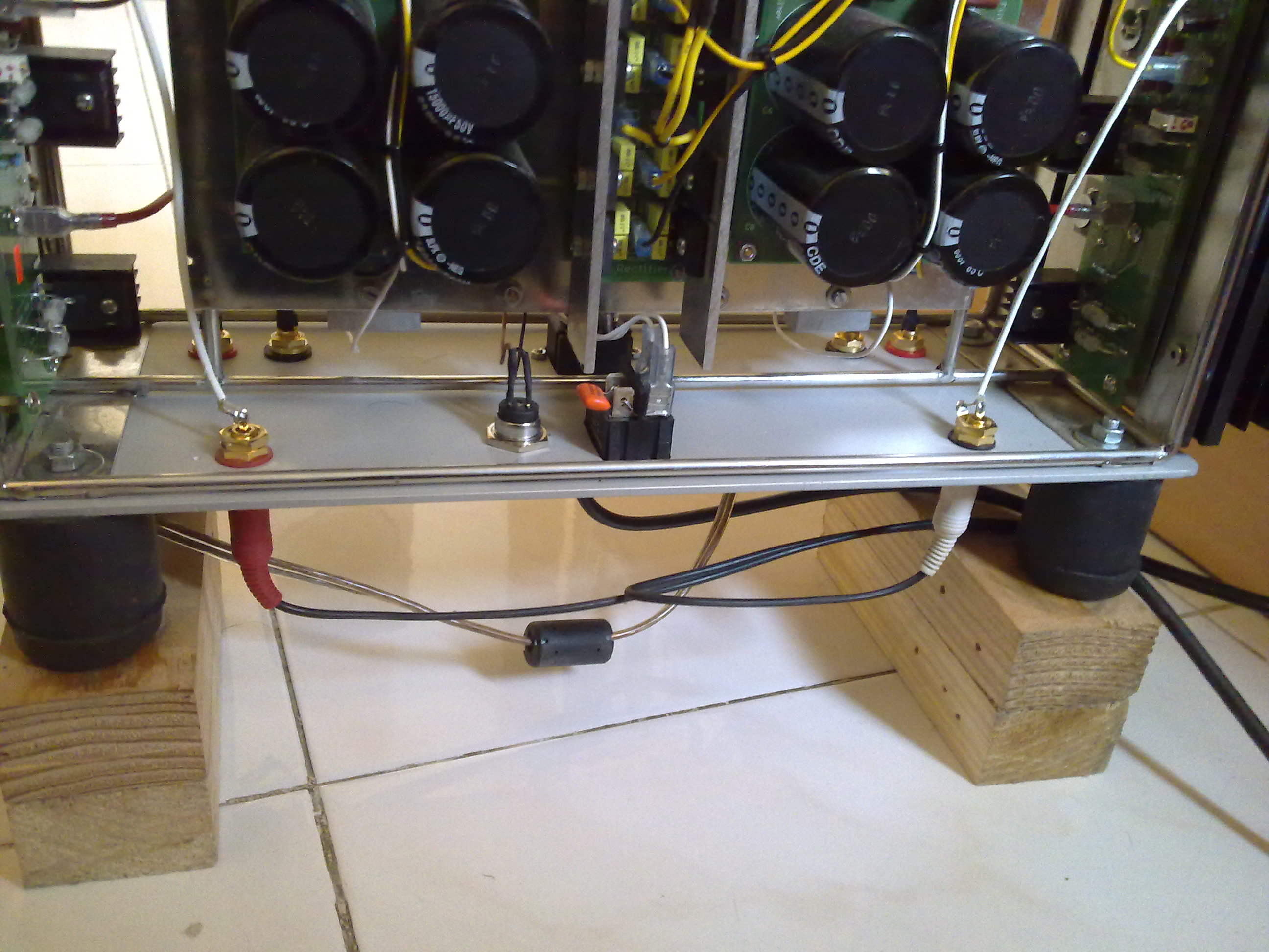

Closeup of power switch and reset switch for slow start. My amp does not power on automatically on mains supply reconnection. It needs push button trigger to switch on.

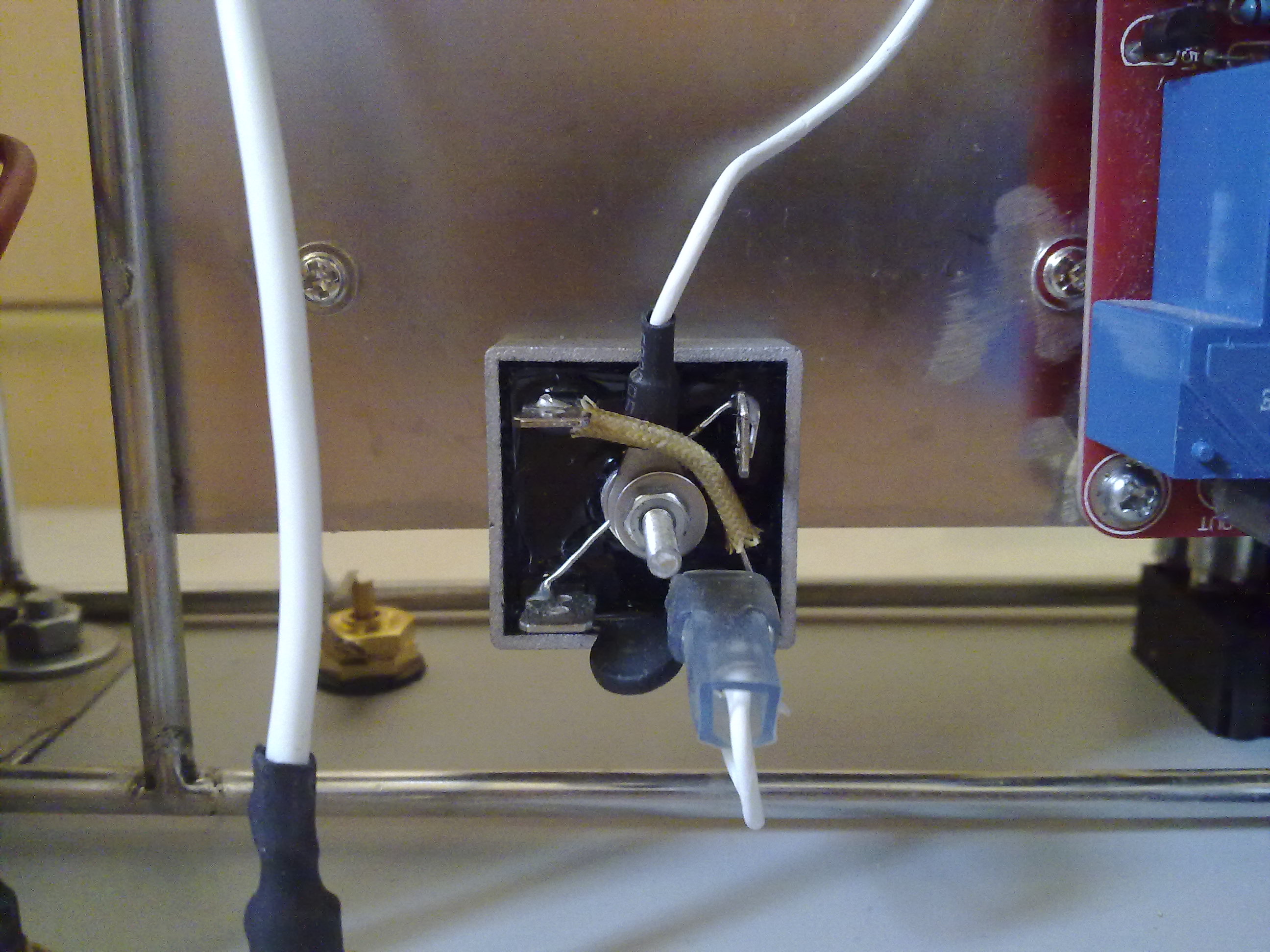

Closeup of mains earth ground isolator. Bridge connects mains ground to chassis at central mounting bolt and PS AGND comes from behind PCB at bottom.

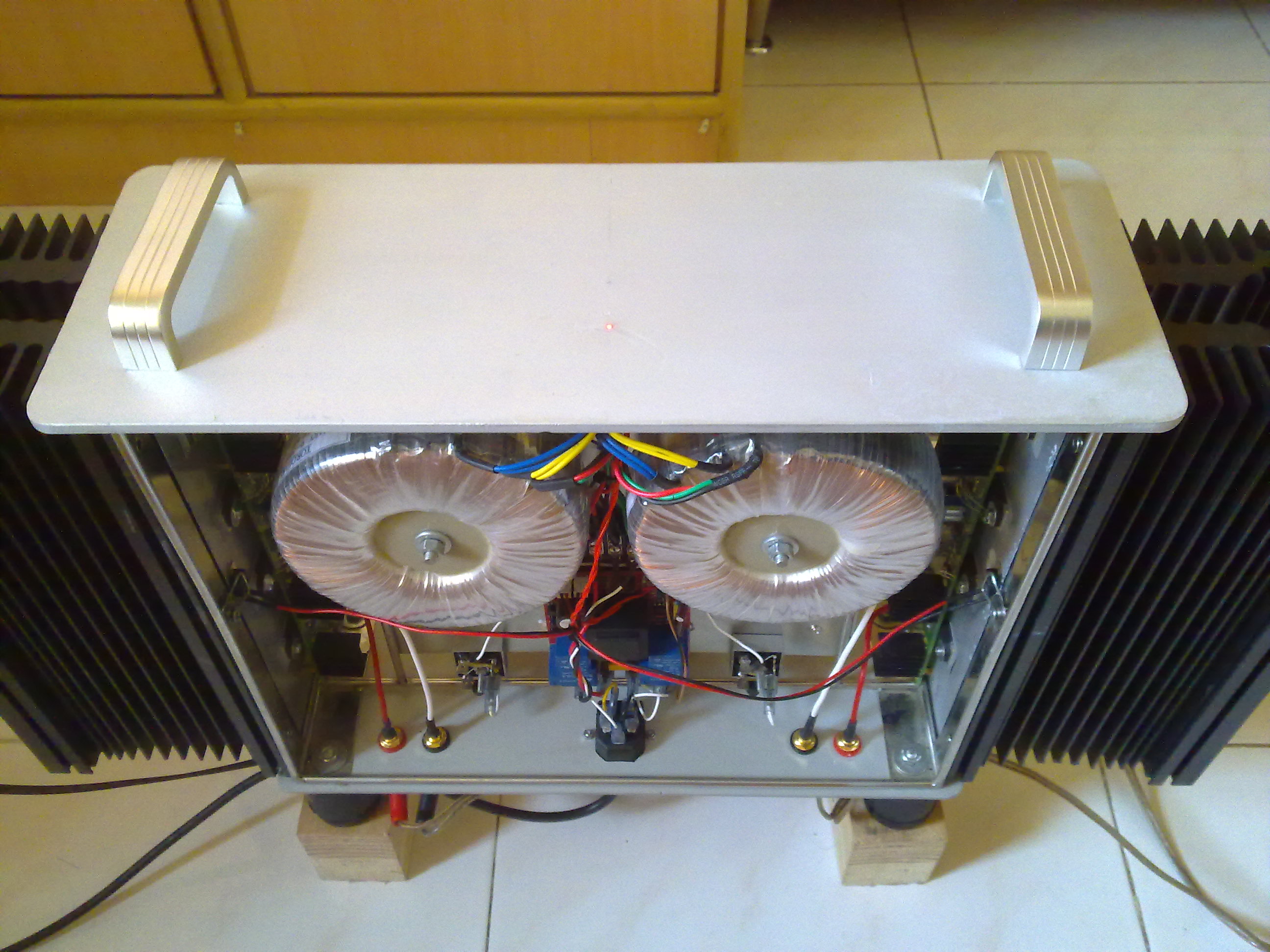

Aluminum handles fitted with M4 SS bolts. Indicator 3mm red LED into hole with 2mm opening in top and 3mm from behind on face plate. LED hole filled with transparent hard glue.
Side view of complete box.

that's Fugly!
mount lower and bottom plates (regularly looking as front and back ) via some spacers - to ensure some vertical air flow inside the case
that's Fugly!
Thanks ZM! Yes there is some gap (~3mm) between top and bottom plate along with side panels.
