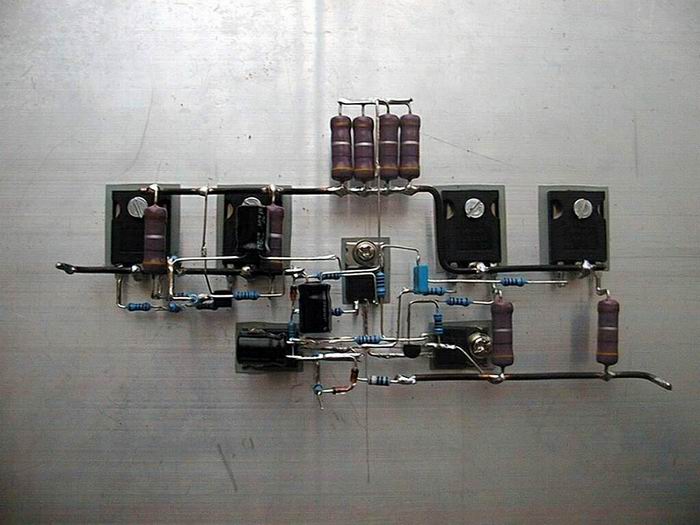

Not the problem at hand, but check this out - (Aleph 3)I have always wanted to do point to point but have always been scared and don't know how to even start such a project.
Quite possibly the coolest thing ever. 😀😀😀
More can be seen from this page - Milan's DIY audio pages - Aleph3 amplifier
OMG, that is very very cool!!! What a skill. True artistry. Wow, the amplifier is the piece of art, don't even hide it inside a case.

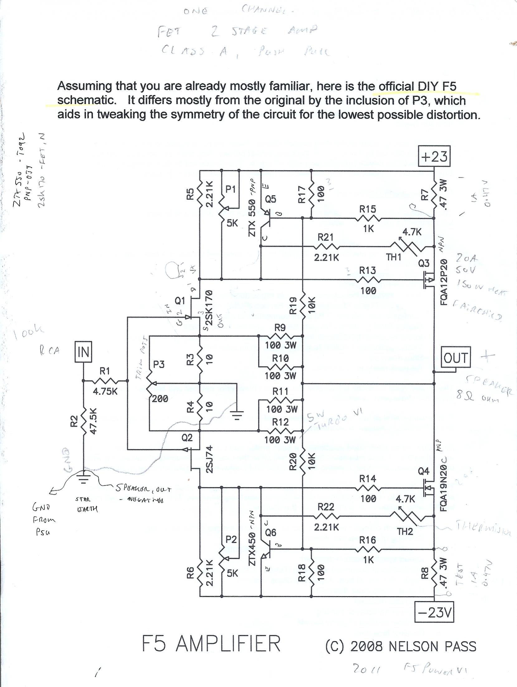

Diagram shows Q3, Gate and Source joined to thermistor, TH1

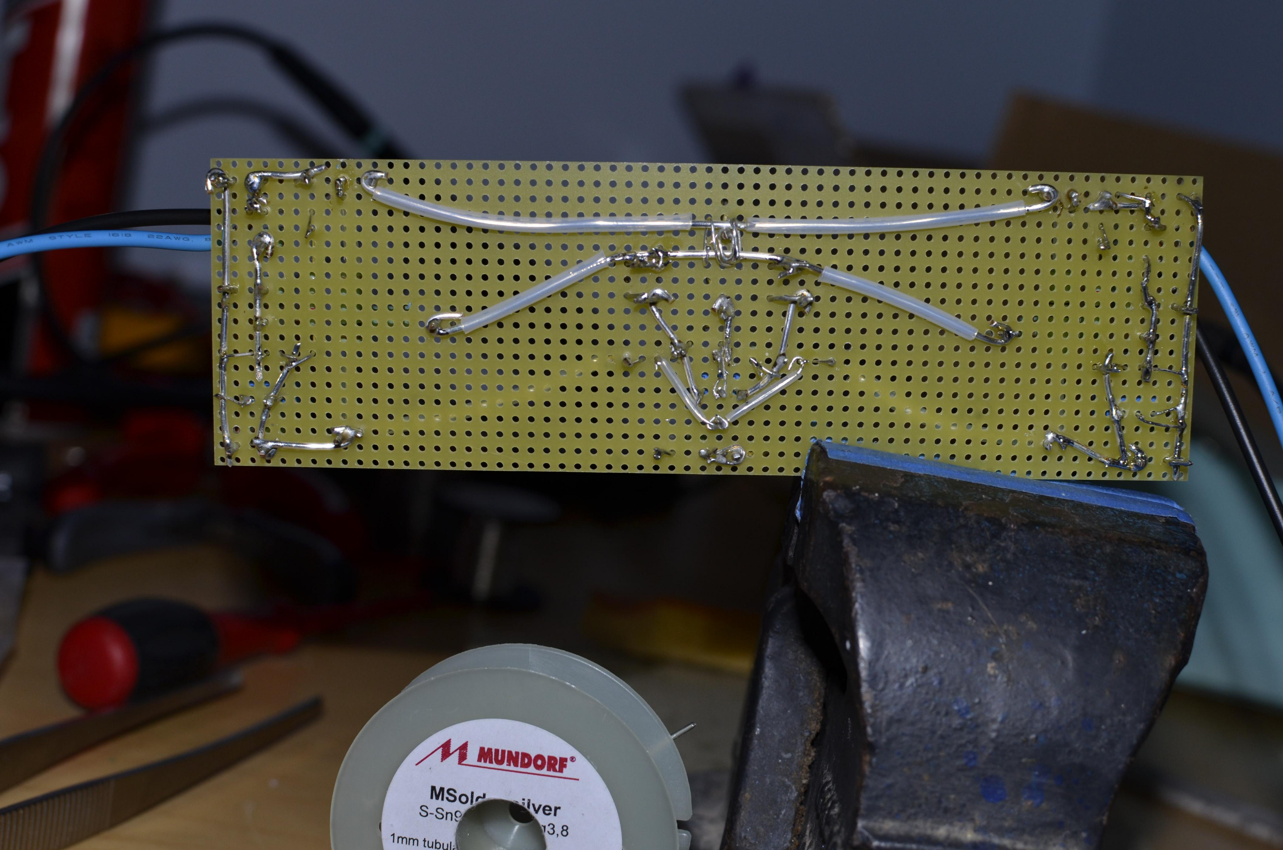

Now seeing the Aleph 3 picture (most impressed with soldering skills!) confirms I have wired it up correctly. picture shows my limited soldering skills.
Wire is 1.25mm silver plated copper.
Plan is now to solder the 3 pins/wires standing up to the jfets which are boldted already to the Conrad heatsinks

Hi Steve, if you are doing this point to point the *only* connection to the gate of the FET (Q3 OR Q4) is the gate resistor (R13 OR R14).
The source of the FET connects to the source resistor (R7/R8) which also serves as the sensing for thermal (TH1/2) and the main current limiters (R15/16).
Short-circuiting the gate and source will lead to output transistor forever staying in cut-off, and looking at your board indicates you have done just that. Also, one of the output devices has the gate and source flipped over. Not sure which one, but the pins on both the N-type and P-type are identical pinout!

Thank you for answering my question, I understand what I need to change on my circuit. Having now looked again at the Jfet data sheet I have realised I have misunderstood the symbol for a JFET.

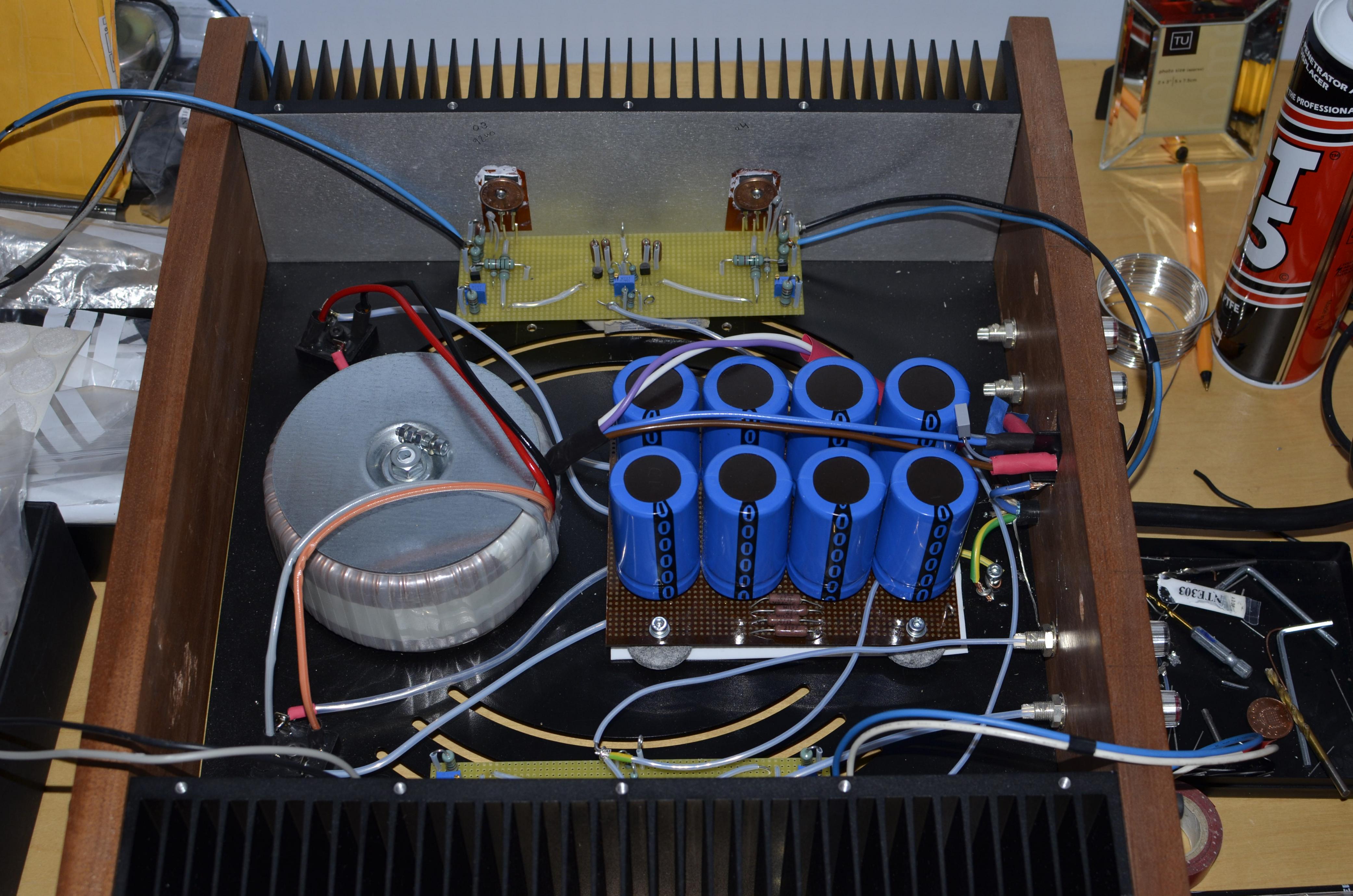

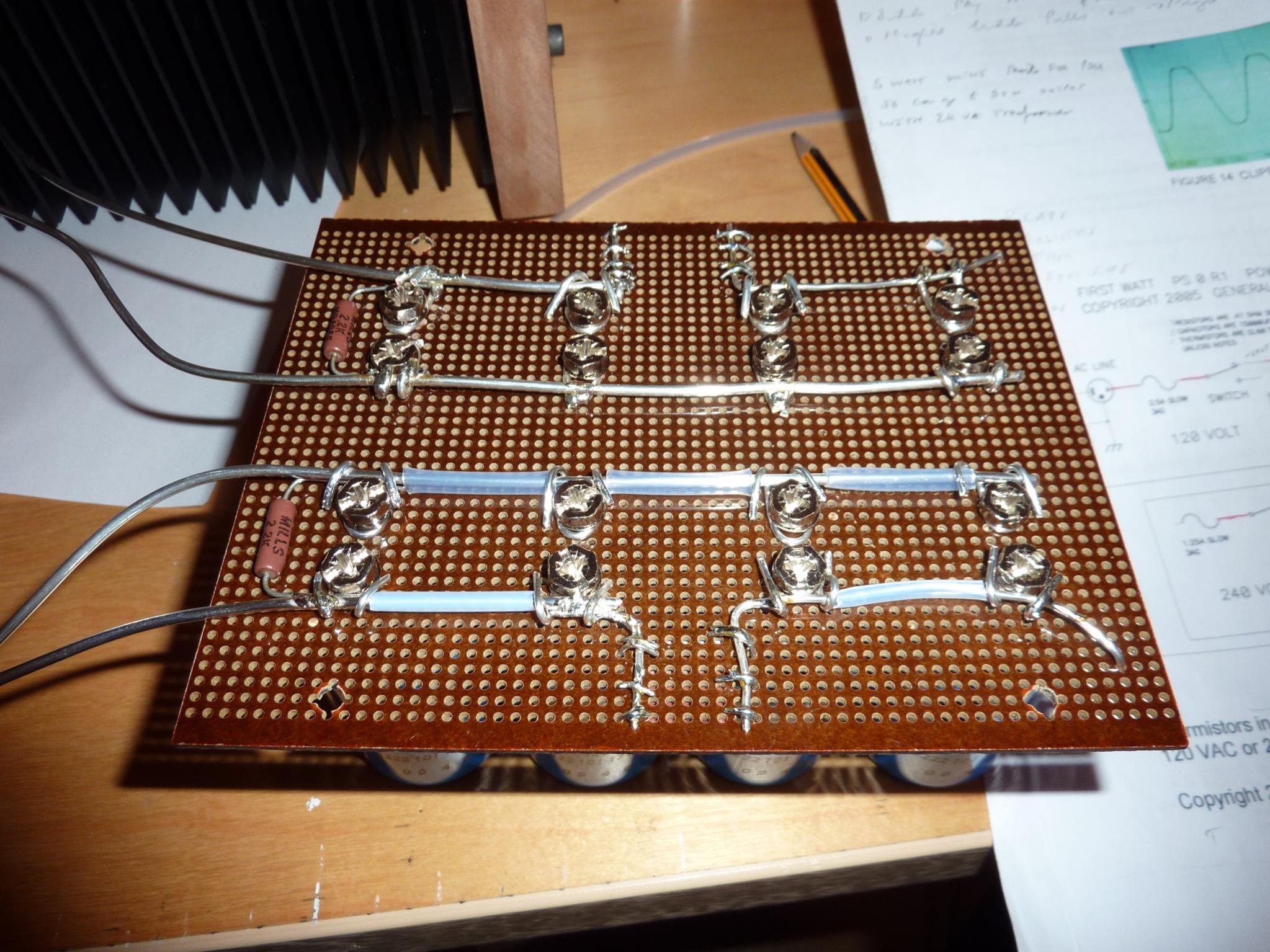

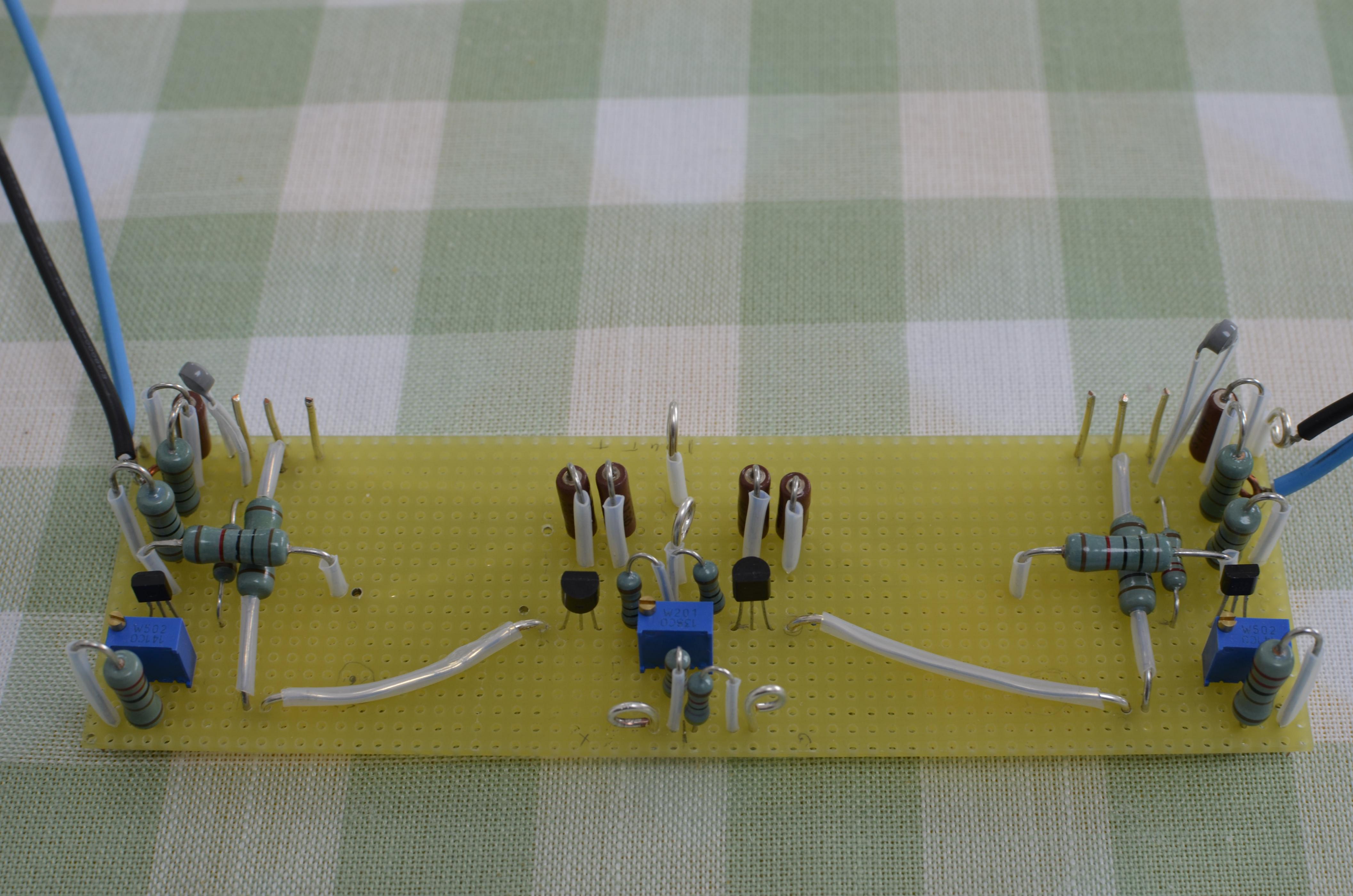

Have made the correction now to Jfet wiring. Pictures attached. Also inc a picture of the underside of the PSU. Have used 2.0mm silver-plated copper wire. The blue and black flex wires hanging of of the audio boards are for test purposes only.

Lovely Amp there!
