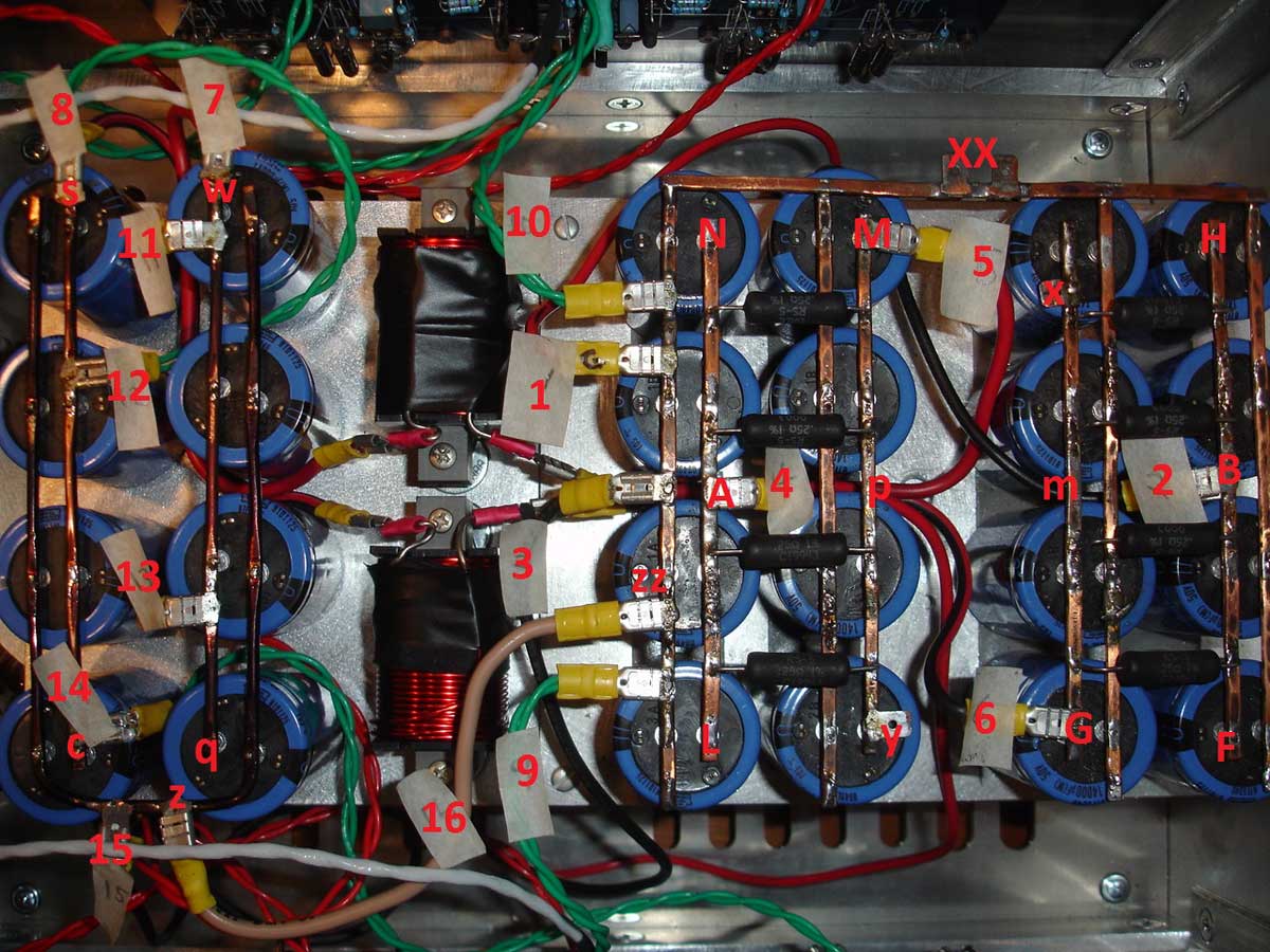

disconnect all wires
then :
+ side from first bridge connect to point marked XX
- side from first bridge connect to point F
- side from second bridge connect to point XX
+ side from second bridge connect to point L
+ input to first choke goes from point M
- input to second choke goes from point x
fat bridge from point XX to point 15+z
output end of first choke goes to point W
output end of second choke goes to point s
positive rail to both amp pcbs from point q
negative rail to both amp pcbs from point c
gnd rail to both amp pcbs from point 15+z
NTC to chassis from point 15+z
connect fat wire bridge between two main gnd points on channel's pcbs (left ch. pcb gnd pad - fat wire - right ch. pcb gnd pad )
each speaker gnd goes from own channels pcb gnd point
each RCA gnd goes to own channels pcb gnd point

Zen Mod I would like to thank you for wading through my messy ps wiring. Things were getting out of hand. The direction was just what I needed.While am thanking people I would also like to thank 6L6 as if I had not made light bulb cord I would have burned out fets as I had started with P1 and P2 in wrong direction also Buzz for his help and Audiosan for his jfet calculations and of couse Mr Pass.

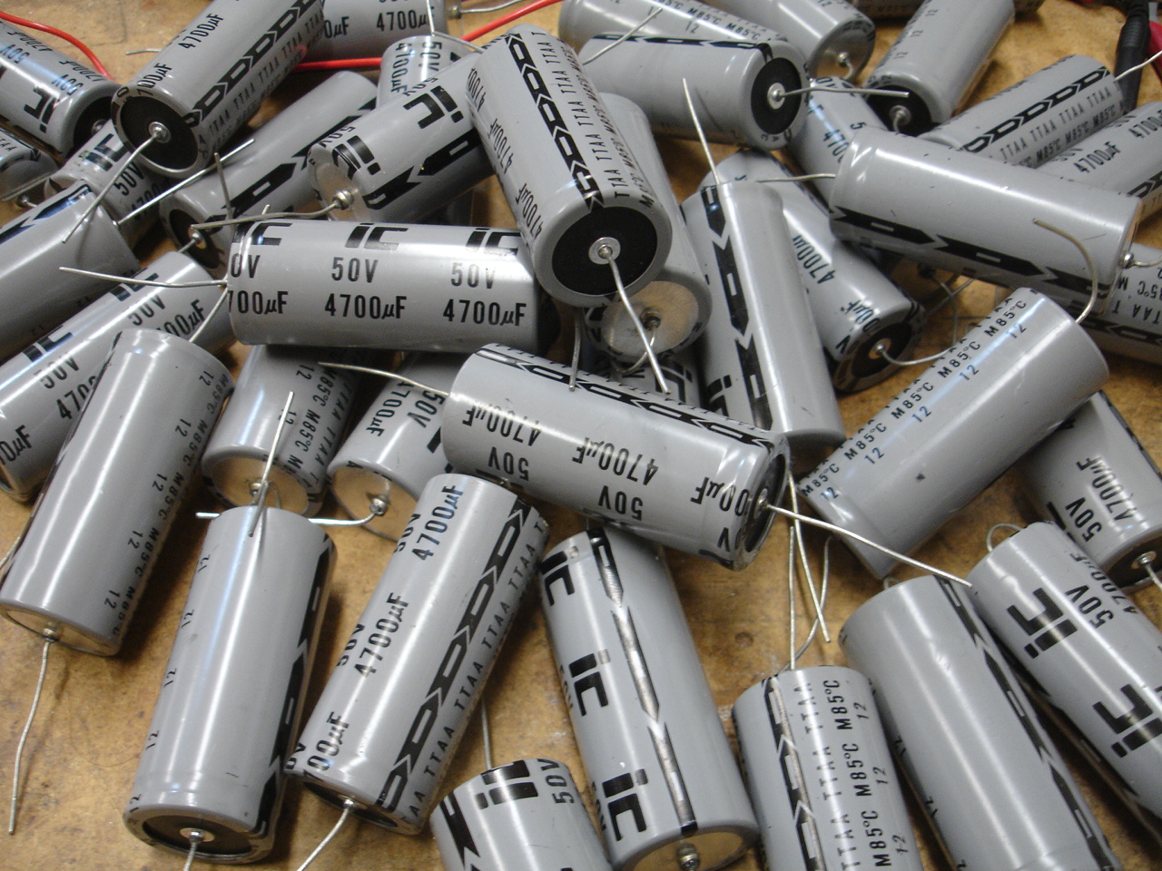

zoe said:I got these at the surplus store!
Very nice! I want to see how you wire them, I'm sure it will look great! What's next? Aleph? F6?
