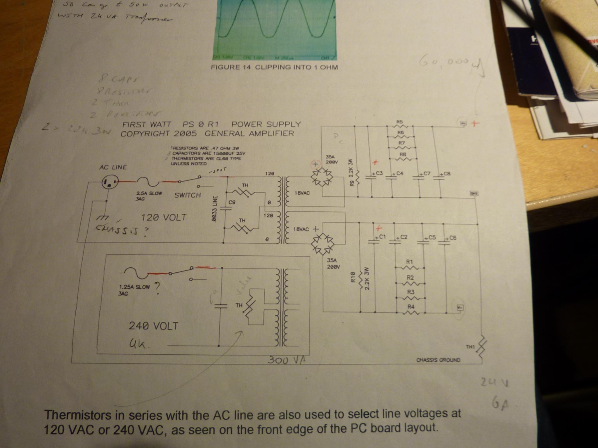

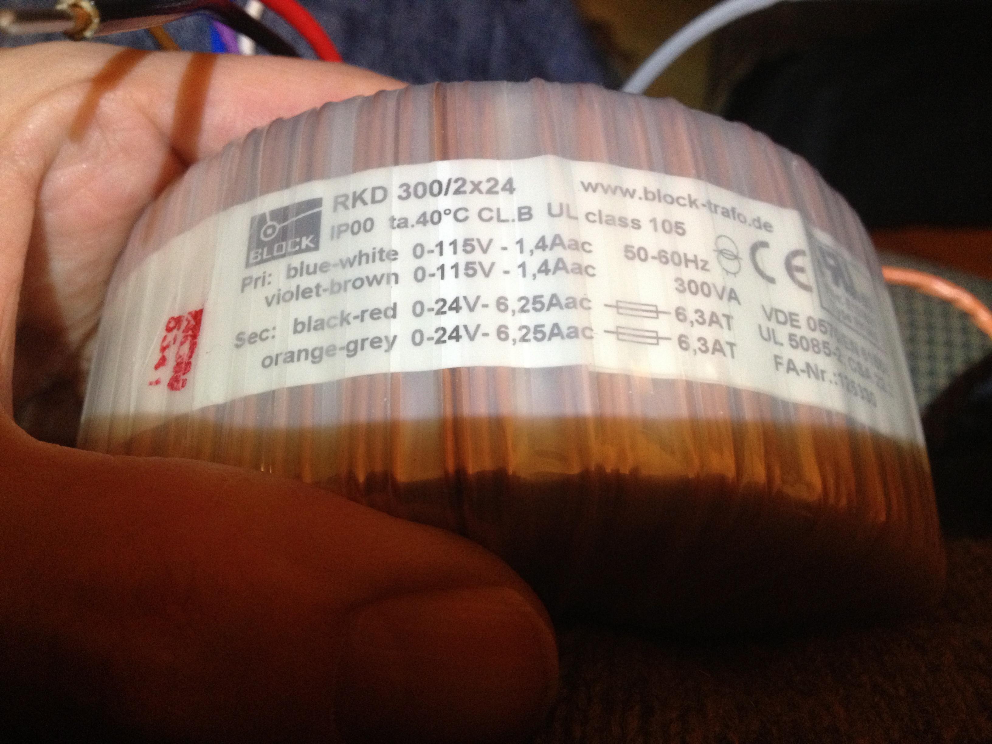

I have attached the schematic from firstwatt.com and a close up photo of my transformer
I have used the 240 V diagram as I live in the UK.
I have connected the blue and white together with the thermistor, this could be a mistake as they are shown as a pair on the transformer label, have I made a mistake? 😱
Is my second mistake that I wired up the earth from the mains power to the chassis when I should only have connected it to the CL60 thermistor?

I had my v2 running on 1A slow blow for months. The reason I wanted you to draw and not post pics is that it might help you find an error. If you draw while checking, you might just draw you mistake. Maybe you spot it, maybe we do, but it gives us something to check.

It is a mistake. For 220V, connect white and violet of the transformer to the thermistor and the other two to the power line through switch and fuse.
not sure but this schematic is for a standard F5.
The F5T is fed 32v after capacitor bank and should use a "beeefier supply".
If I recall, there was a rectifier bridge tied to ground.
See the schematic of the f5T power supply.

You have a toroidal 2X24V, is build an F5 Turbo V1 with a 300VA toroidal?
necplusultra - The F5T PSU as drawn by Nelson uses a single bridge, with the 'center tap' formed between the two windings as ground. That's how you use a single bridge in a bipolar supply.
There is nothing stopping one from using (in a F5Turbo) the dual bridge supply configuration as shown in the original F5 PSU. It can't hurt, and double bridges have some advantages.

Finally took closer look and read. Alniva is correct, you have your primary windings wrong. If you fixed that, all should be ok, hopefully.
Steve I would recommend making yourself a light bulb tester which puts the live through the bulb and so won't power up fully if you've made a mistake.Saved my a-- on a couple of occasions.

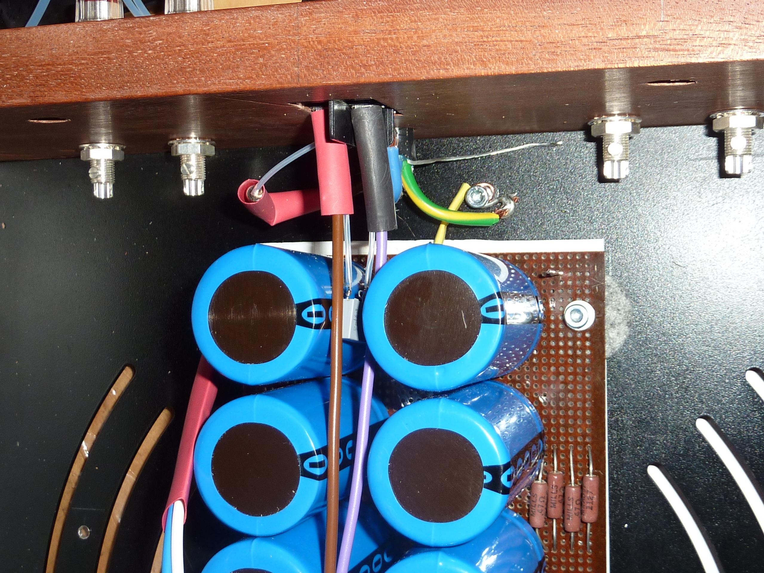

Thanks all for your recommendations! I have now changed the wiring configuration of the transformer as you suggested Anilva.
When I switch the power on the transformer hums as I would expect, however instead of getting the 32 v DC I'm after I have 70volts showing on my digital multimeter. Is this so high because there is no load?

I connected my meter to the plus terminal of C8 and the minus to the minus of C6. (Ref the standard F5, PSU schematic I posted yesterday)

You got exactly what you should. Connect black probe to centerpoint/ground(bottom of c8), and the other probe to either of the previous spots.

I tested as you suggested, wow it works +35 v either side.

With the black probe (common) attached to GND, and measuring with the red probe of your DMM, you should have positive 35VDC on the V+ and negative 35VDC on the V-
