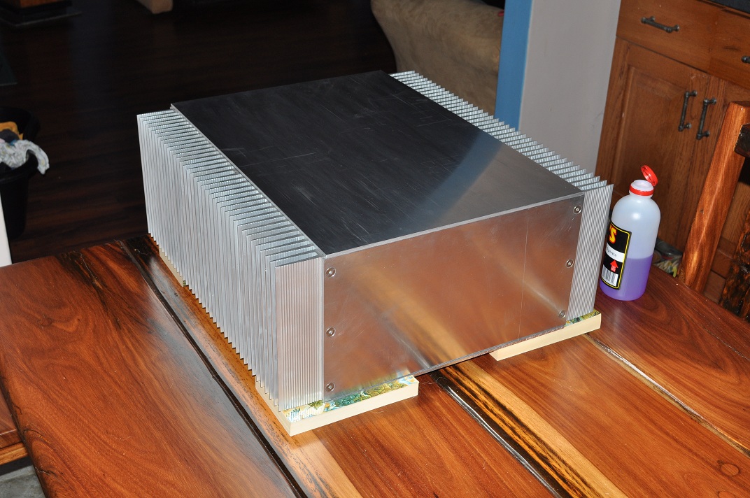

BTW, one should never underestimate the amount of work and cost involved in building a decent case for a Class A monster. Besides the cost in metal, it is the time as well as tooling costs if you have not got all the tools yet. I am doing the cases usually by hand as I love metalworking also (No CNC and milling by machines, just a Tablesaw, Drill and a bunch of files).
I bought a M6 Counterbore the other day sothat I can hide the heads of my capscrews, and it cost me a whopping R400 (about $50 US). Maybe I should import my tools also.
This is basically what I have done for my KSA50 clone (decorative front plate still missing and vent holes for top and bottom still needs to be drilled).
I am planning to do the same for each of my F5TV3 monoblocks.
