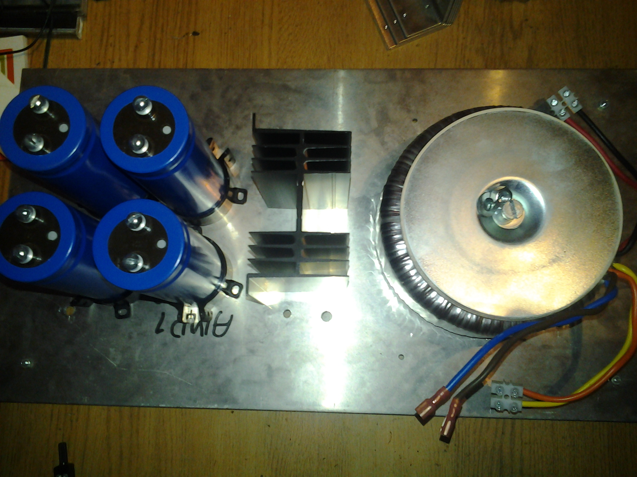

just started my F5 turbo V3 build. the PCB's i'm using is toecutter's prototype V3 boards. wich i cut in half(output boards that is) to get the heat spread well over my 2x10.080" profiles.
got the PSU layout ready to night. 1000VA 2x40V transformer 2x35A rectifier bridges(on there own sink). and 4x68.000uF caps. softstart will be modified hypex.
this is ofcourse monoblocks:)
