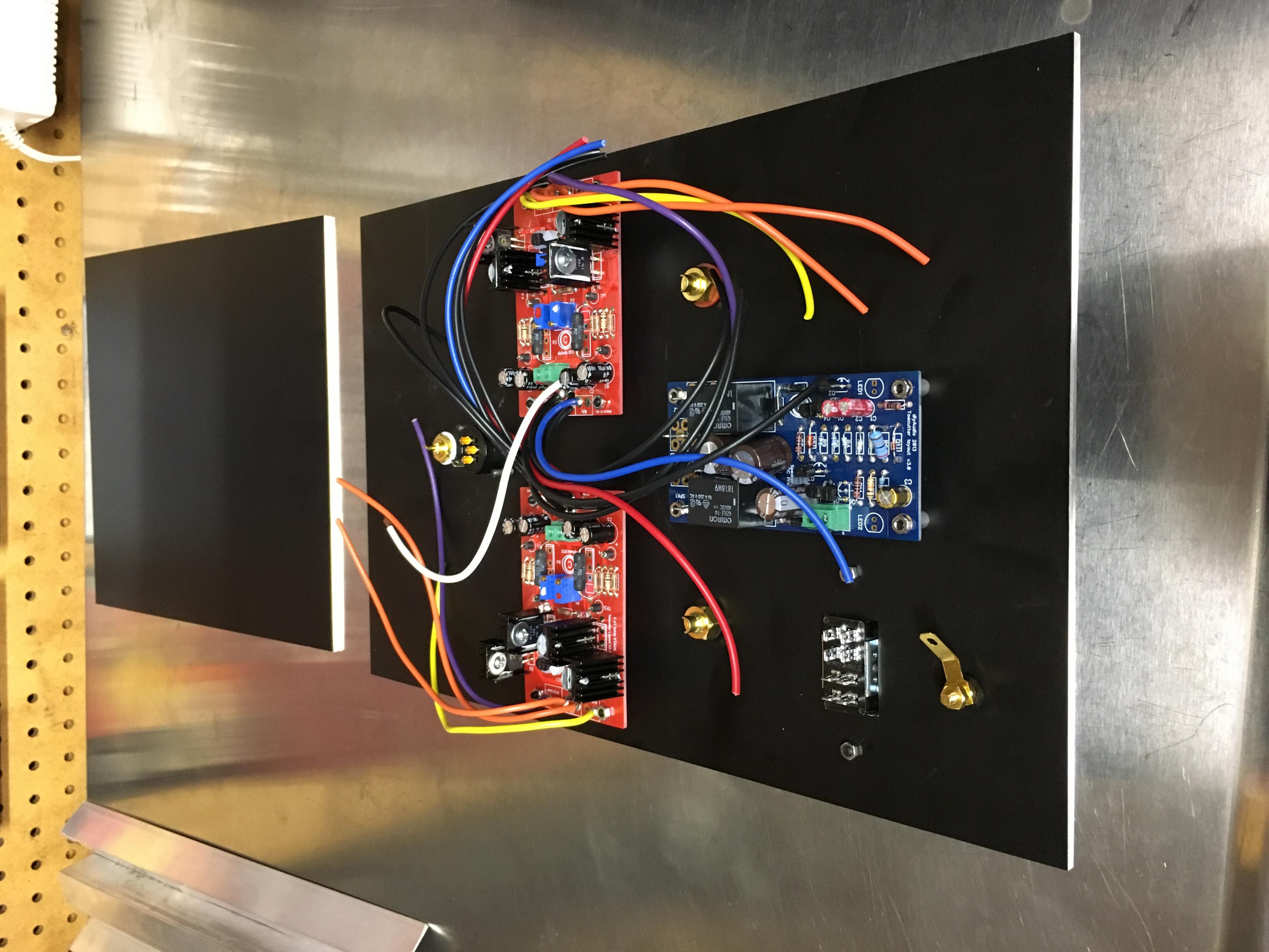

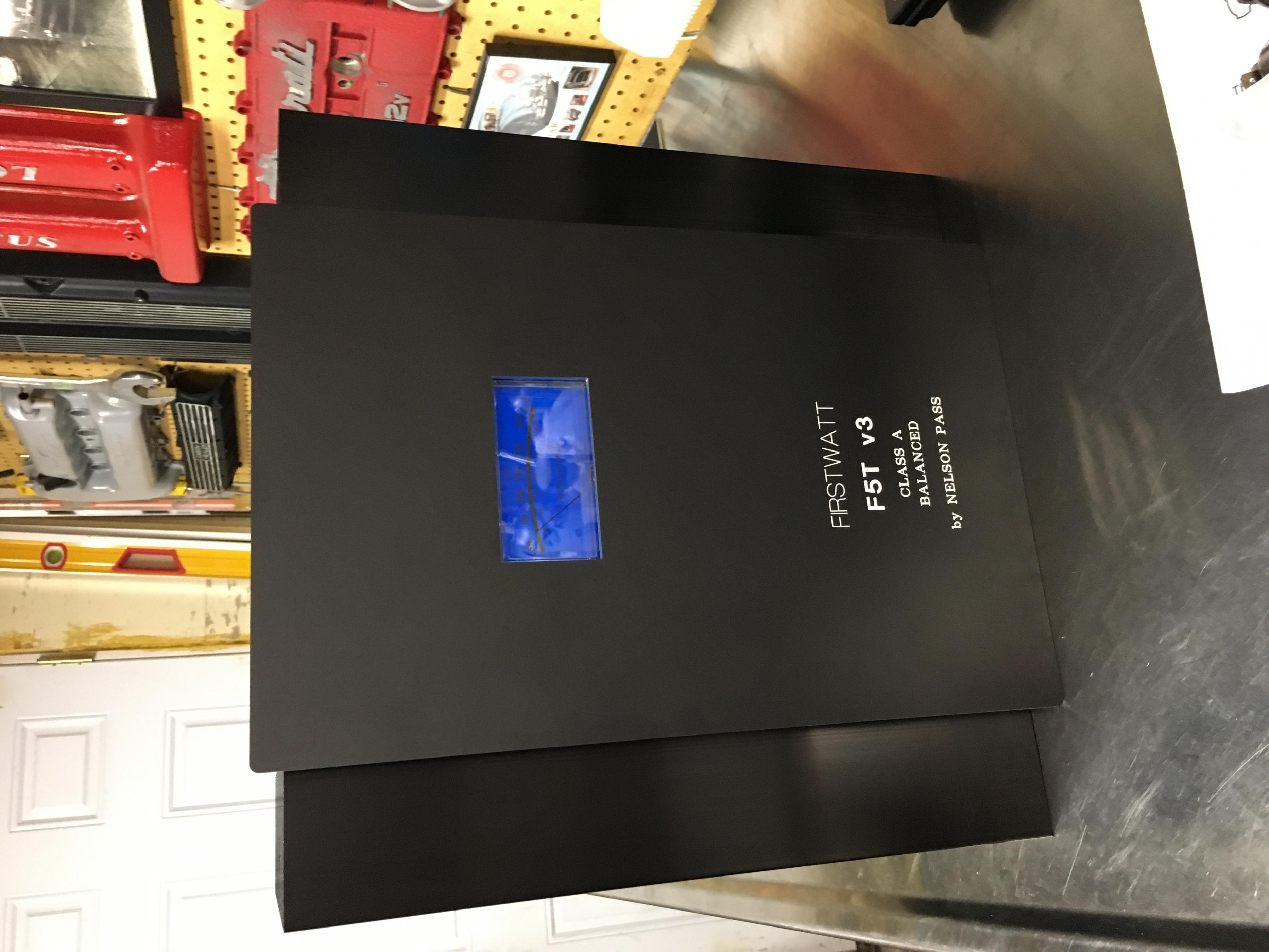

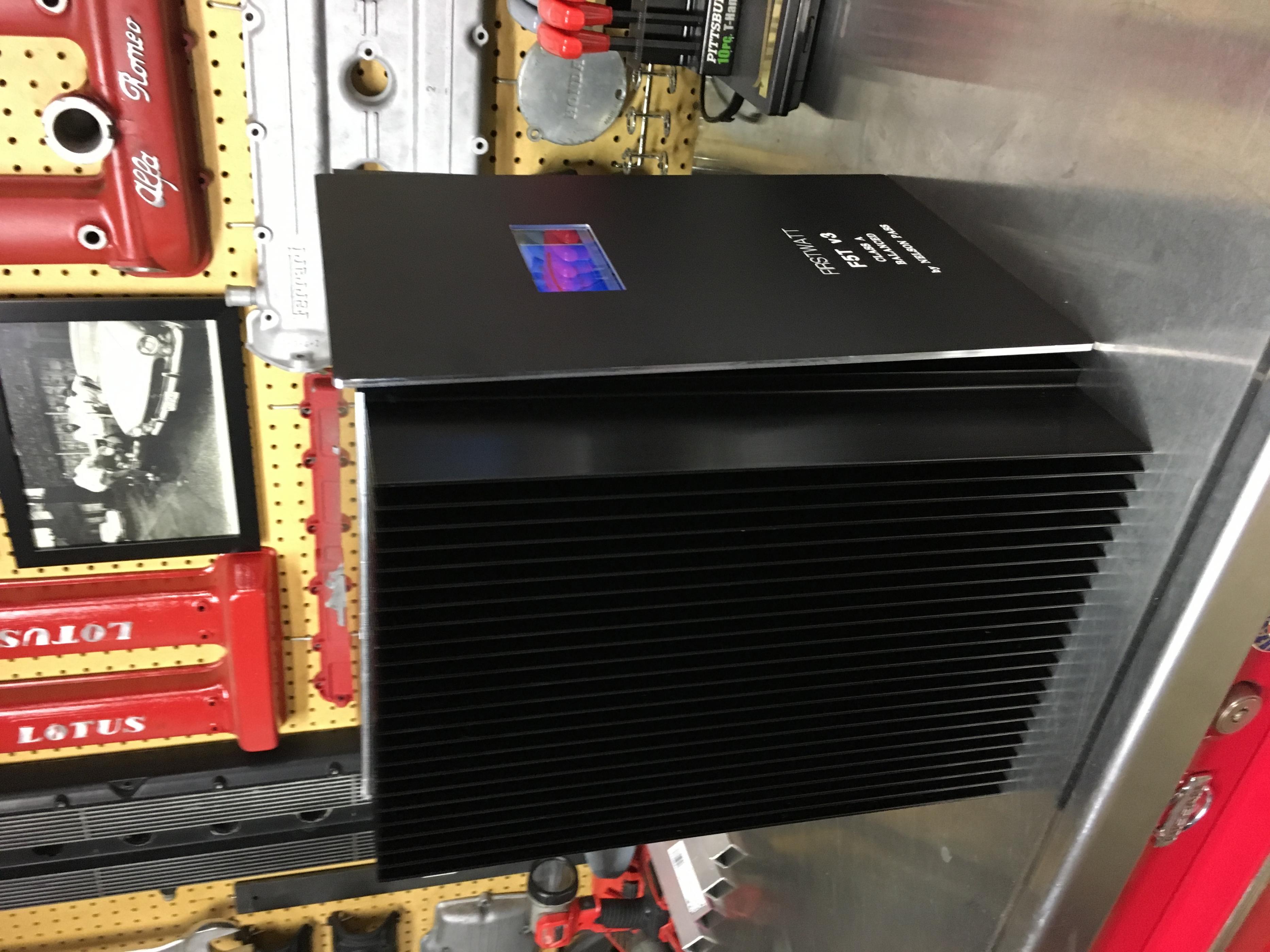

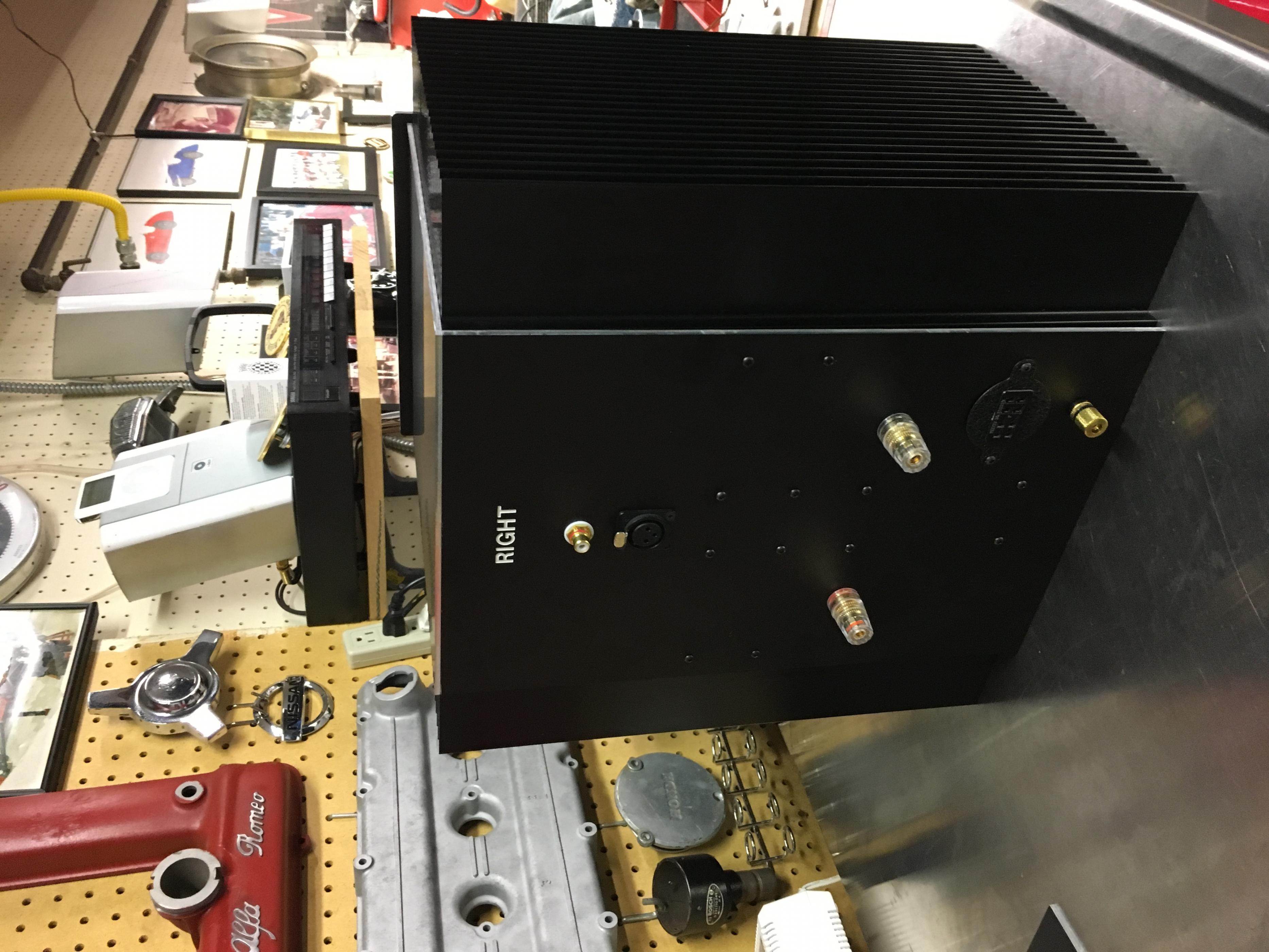

Progress on my F5T v3 balanced mono blocks. I have some metal work to add to the front panel above and below the VU meters and more drilling to do. The top and bottom panels need cooling holes yet.
The back panel has both input boards and the speaker protection board mounted on it. The second RC filter PC board needs a mounting platform to raise the board between the amp boards, about 6" tall. Considering all the holes I've been drilling, small welding job will be a welcome relief.
I still need VU meter drivers, I want to use drivers which use the amplifier output, not the input.

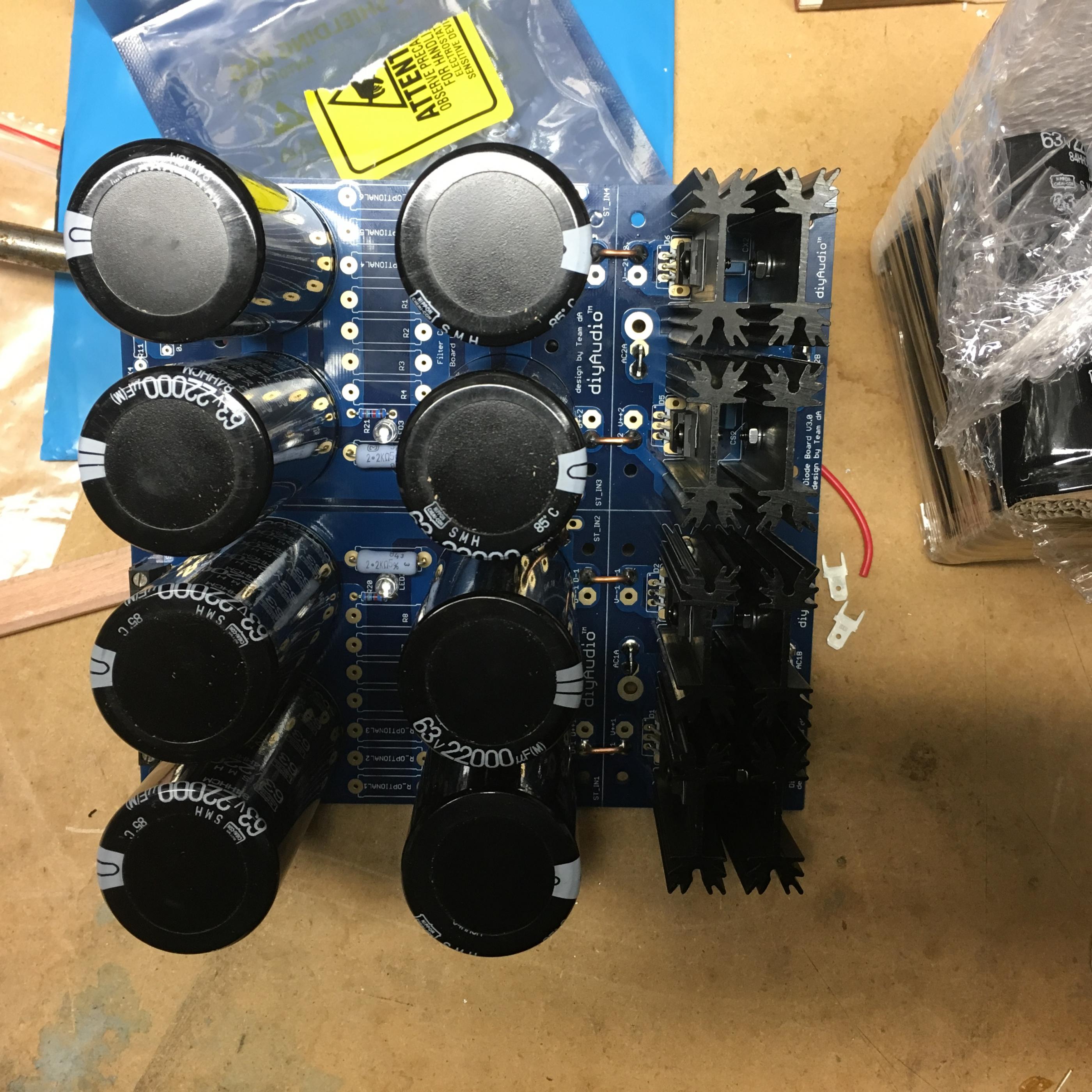

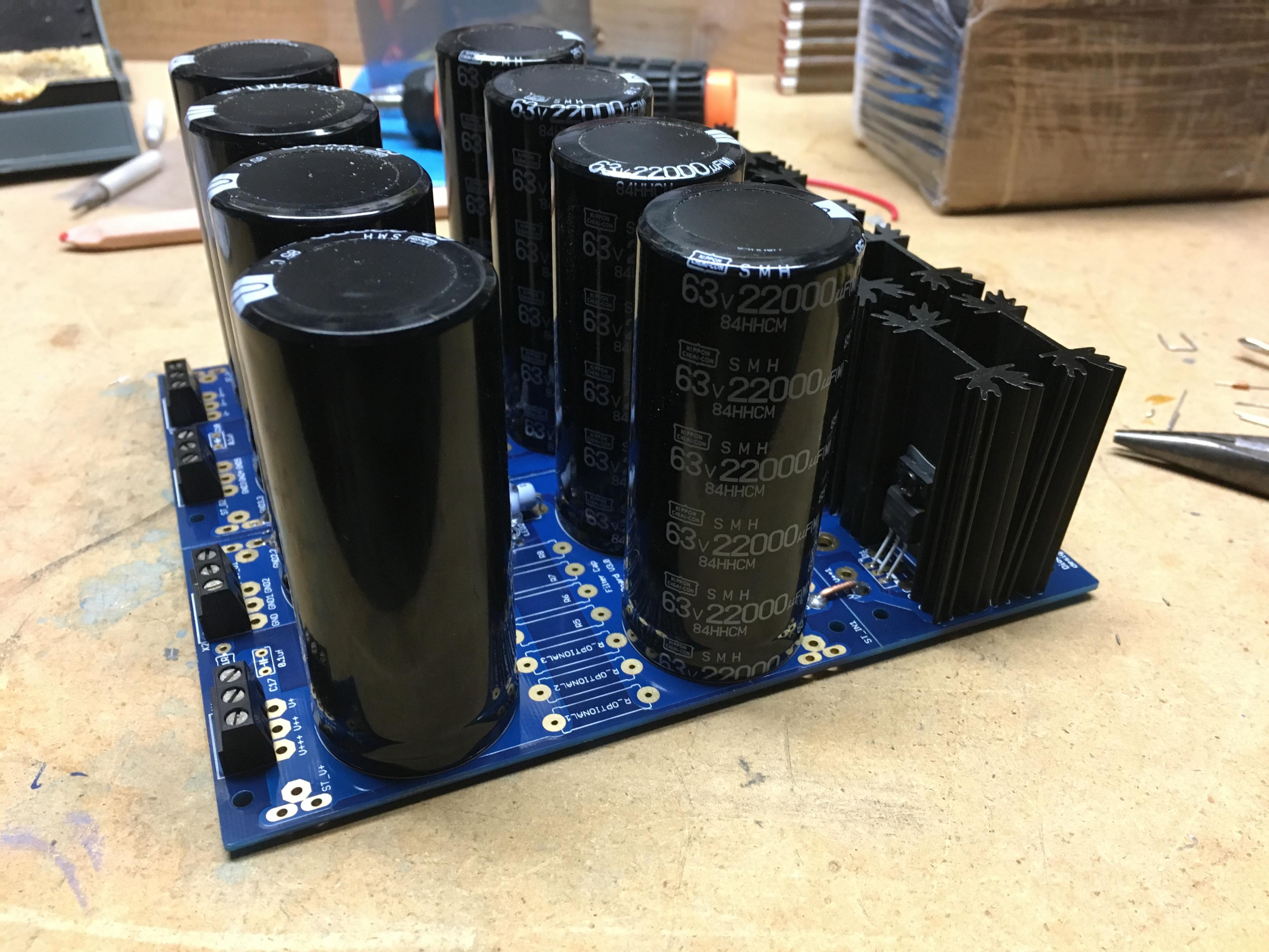

Joined 2018
Built and tested 2 PSUs for a pair of V3 Monos. I used temporary 0R47 resistors to test, chokes will go in the amp chassis.
Chassis and amp boards will come next. Also need to do some mosfet matching.
