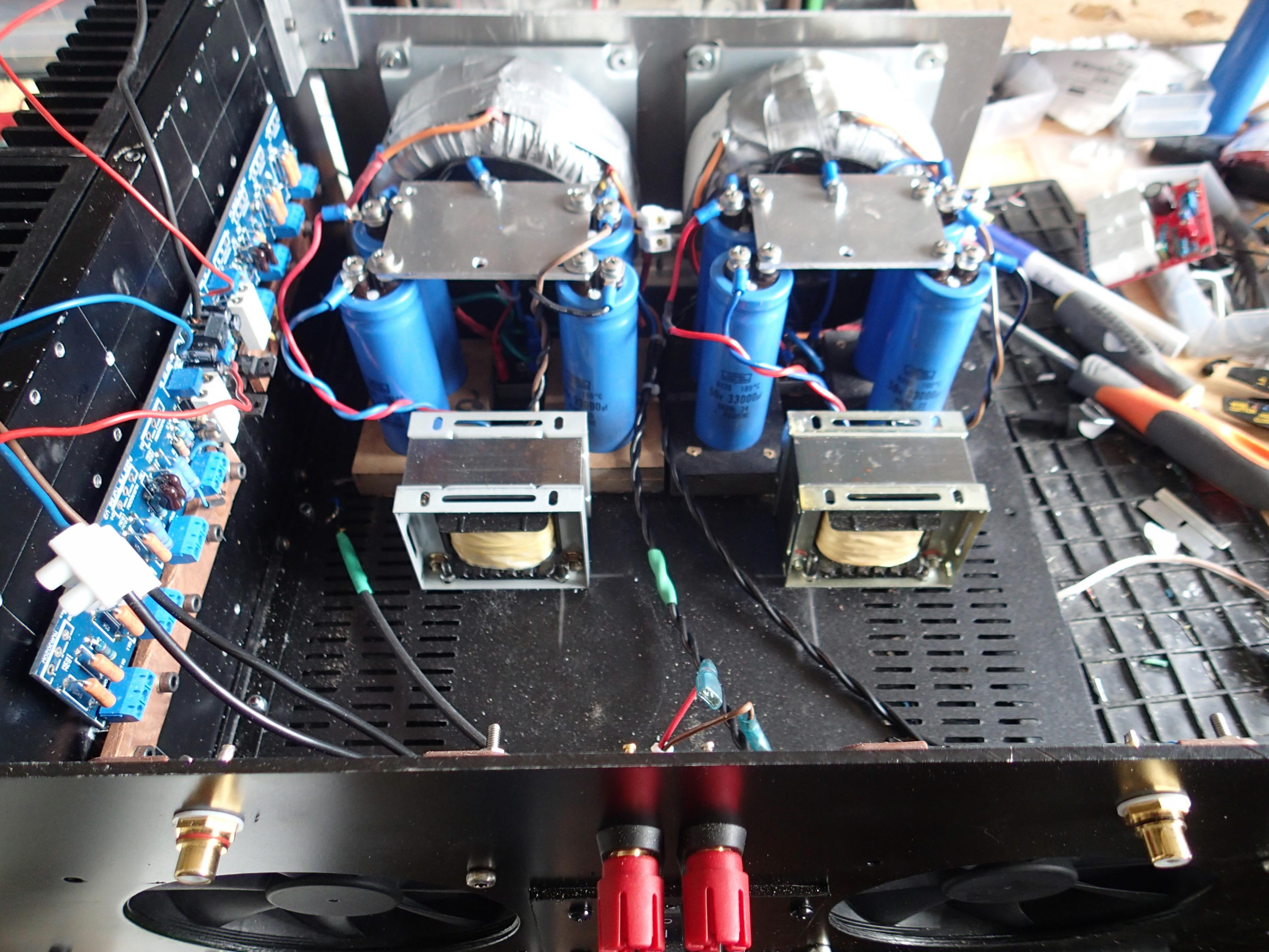

Yes similar but no bias whatsoever. Biggest problem is the way Pcb is mounted combined with PCB design. It is impossible for me to reach the points to measure the voltage over r 3 and r4. And again I only have +/- 32 Vdc in supply. Looks like a mess and enclosure is stupid to. Have to take everything out to reach the screws at the bottom into the heatsink. Think I will forget about this amp for some weeks.

That pic of all those cable joints tells me there is something wrong with the layout of the wiring.
EVERY circuit has a two wire connection,. The Flow of current from the Source and the Return of that current to the Source. Wire EVERY circuit as a two wire pair !!!!!!!!!!

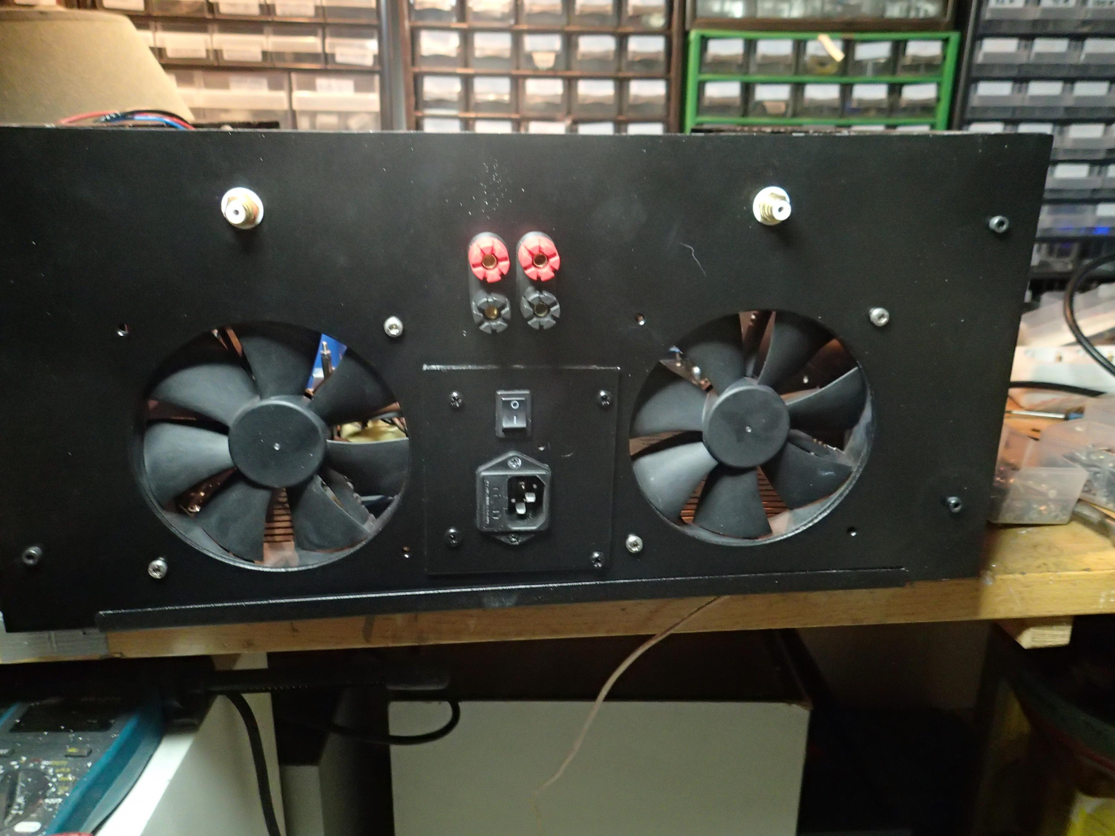

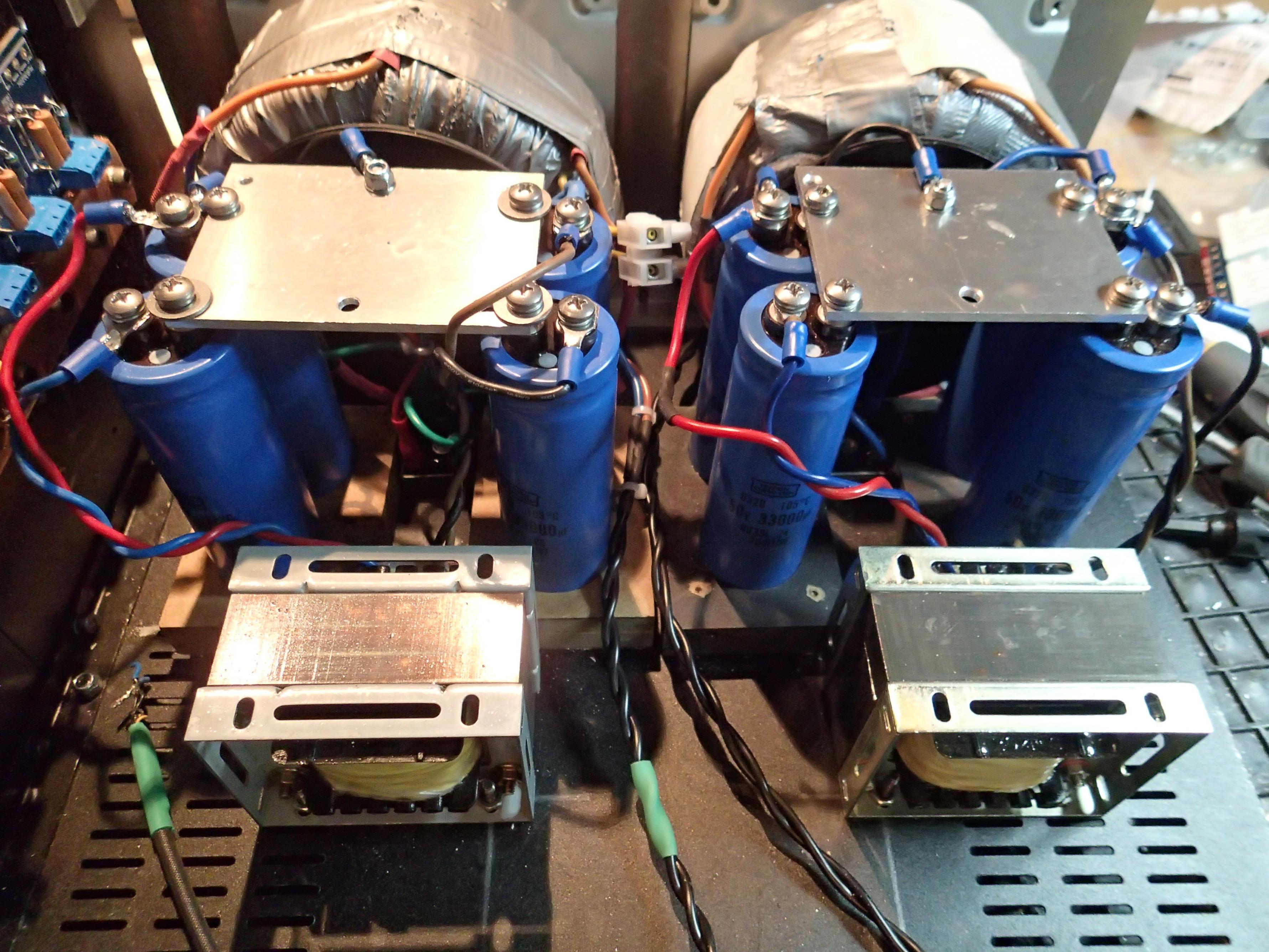

The PCB you use, Drossel, is taken from Jims Audio. There is a lot of builders that have bought Jims PCB for variation F5 builds. I have also built F5V3 Turbo with the same PCB as you do now, but with no problems. The PCB is ok with no faults as far as I can see. I do not use MUR diodes at all. Power is +/-42.5 V DC and bias is 2.4 A. PC blowers helps keeping the teperature inside the cabinet low. It does not influence much on the heatsinks temp. I bring you some photos.
