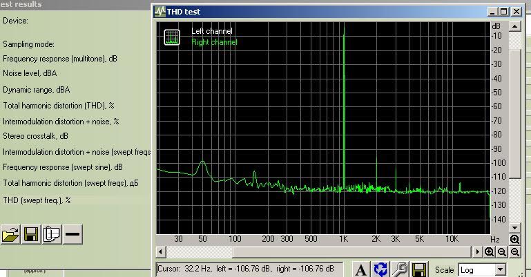

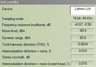

I've built a couple of these amps with switching power supplies. With off the shelf laptop adapters, as well as with commercial grade open frame modules. Neither were touted as low noise. I did replace the capacitors on both sides, mainly as precaution since I was running high continuous loads.
In both cases noise floor was below -110dB and flat through the audio spectrum. I could detect nothing in the measured or objective evaluation that would support the belief that linear supplies are vastly superior. You do give up a smidge of bass performance but arguably the lack of 50Hz noise helps the midrange and treble response.
When I'm not on the tablet I will post the RMAA FFT and results.
Here's a 4W -> 5ohm FFT and results of a version of the F5 powered from two $25 SMPS units in series, the only change to the supplies was the primary and secondary caps. The supplies are 24V/5A nominal and the adjuster is set for the maximum, or 27.5V.
The output from the SMPS is fed to a mini-CRC bank, the total capacitance is about 35kuF per rail. The bass seems slightly underdamped from when the amp is run off a linear supply. Bias current is about 1.2A per channel.
It sounds really, really good and I have no hesitation in using these kind of supplies for cost-conscious builds.

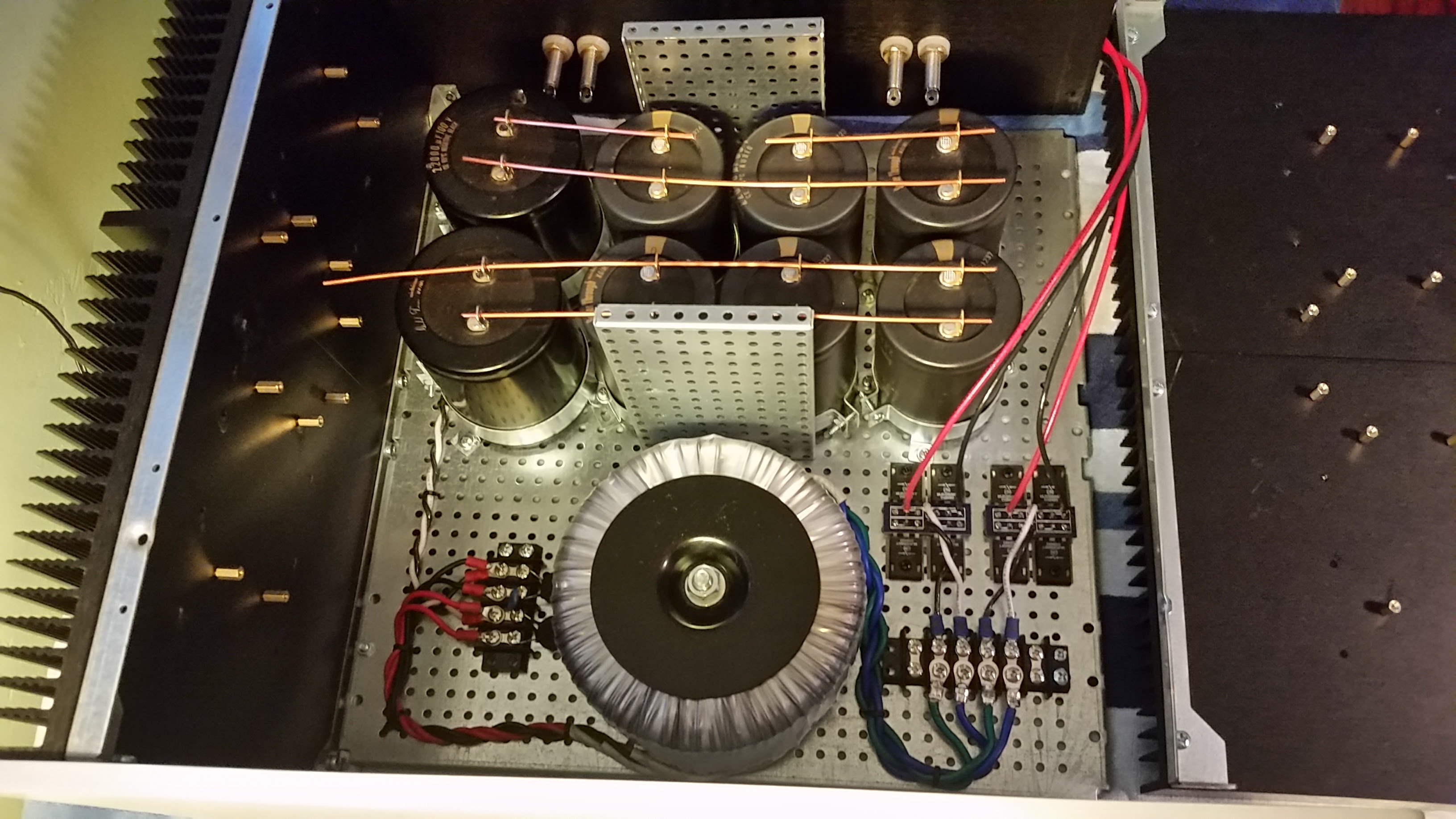

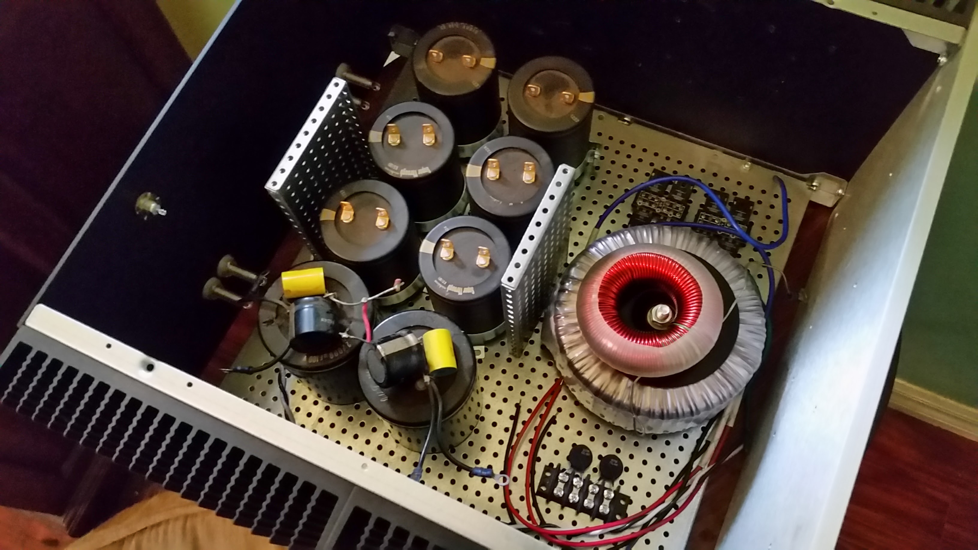

Finished my F5Tv2 build

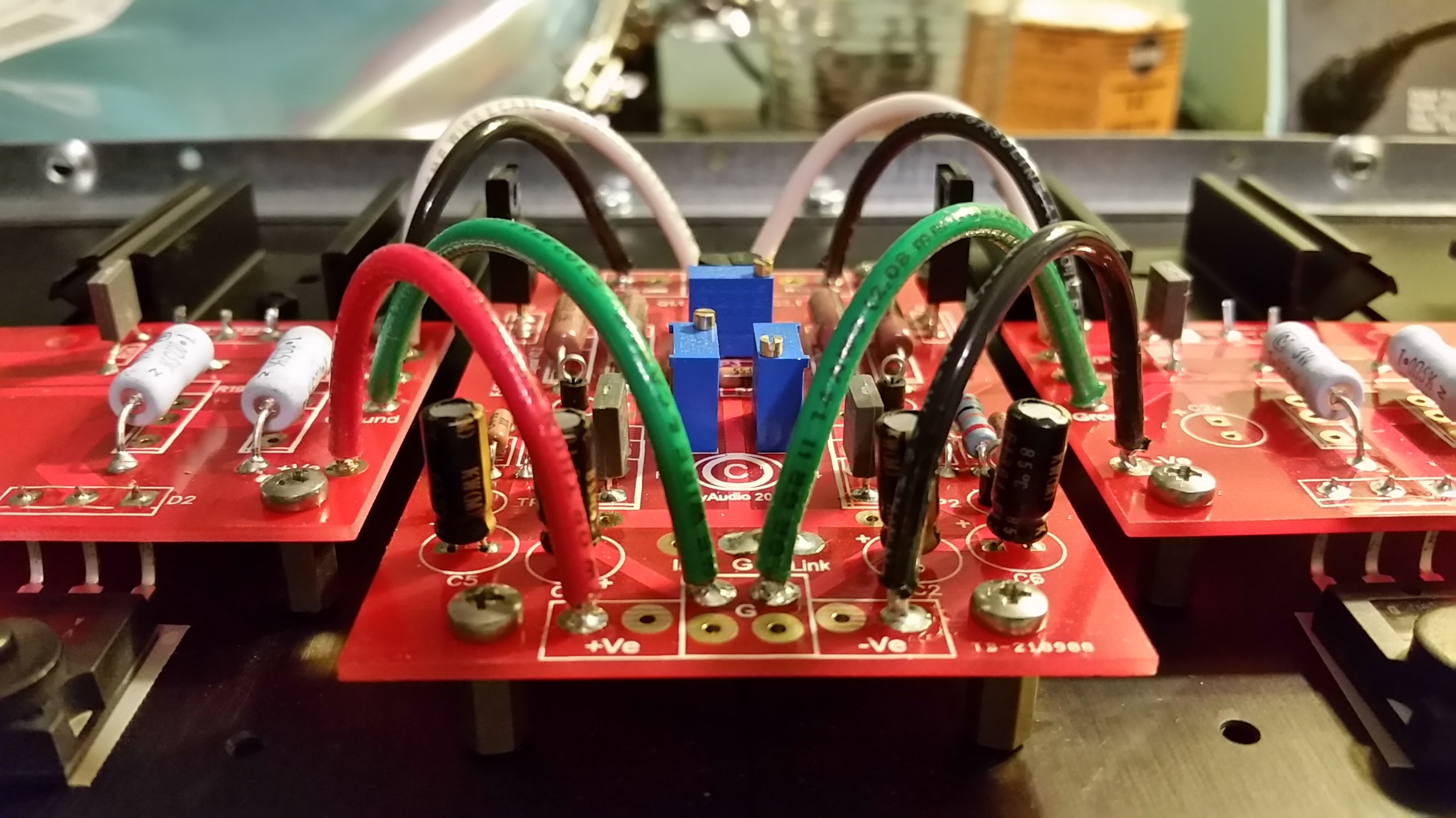

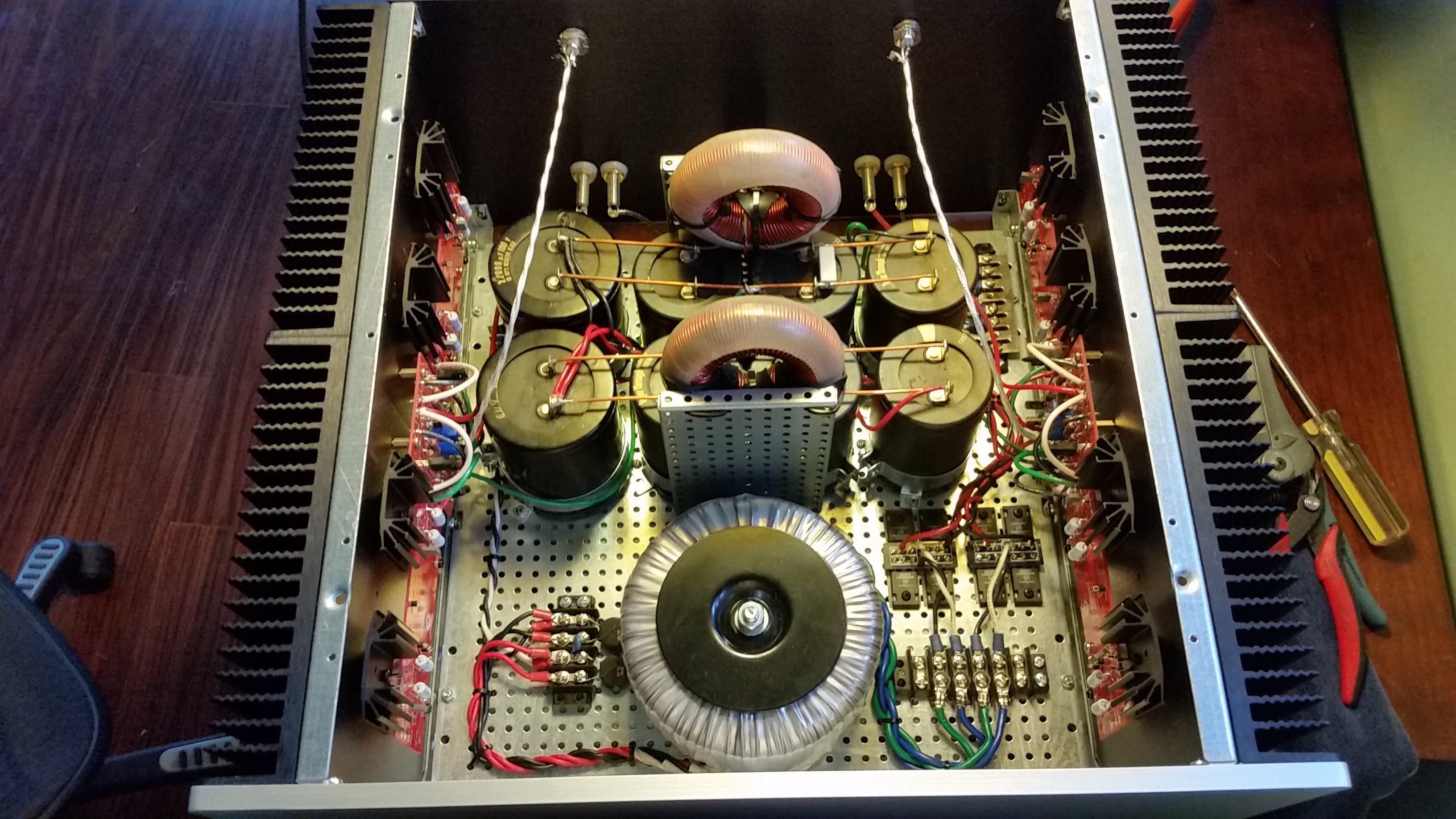

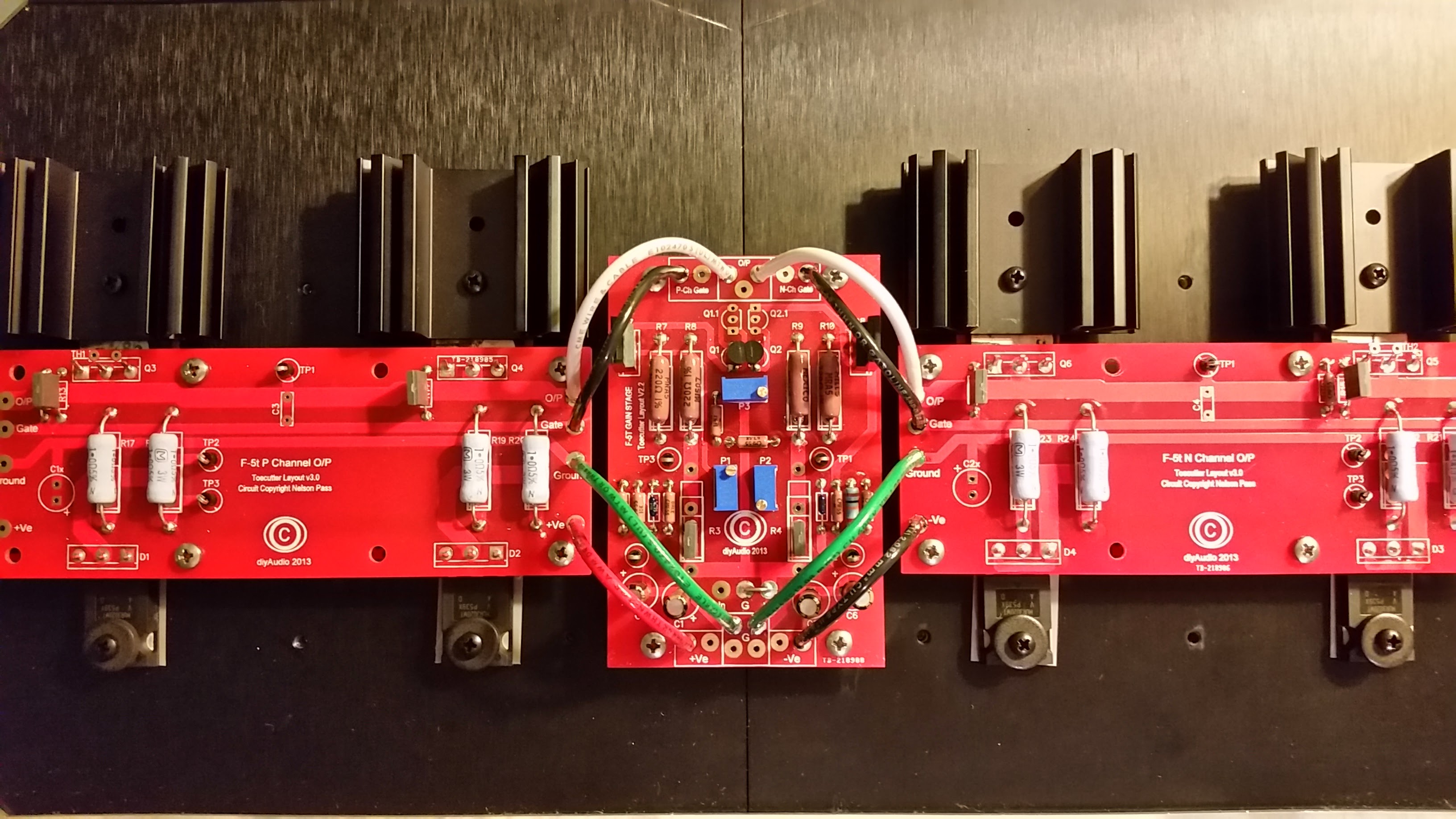

Here's a few pics of my finished build (hoping the attachment worked). Thanks to everyone who contributes on this thread. I read damn near every page of it before starting my build and learned a lot. Without all the help from these forums most of us would never even attempt a build like this!

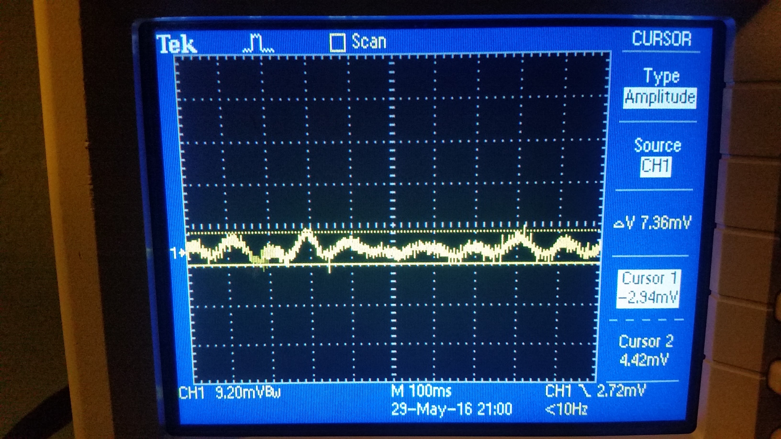

I used the deluxe 5U chasis and boards from the diyaudio store. For the power supply it's a CLC using an Antek 24V 600VA transformer, 6 x 22,000uF Nichicon KG 63V caps and two giant 22,000uF 100V caps (I had them laying around) and Jantzen 7mH iron core torroidal inductors. Rails are 30.7V and the ripple is around 7-8mv so I'm pretty happy. Having the inductors floating on top of the caps was kind of a hack, not really what I was hoping for but just couldn't find another place to put them without getting a custom mounting machined.
Front end Jfets are matched Toshibas cascoded per the F5v3 schematic. Outputs are matched (NNNNPPPP) Toshiba 2SK1530/2SJ201. The amp biased up without any hitch and voltage across source resisotrs on both channels are around 0.340mV with just a couple mV of DC on the output. It was actually barely even warm until I put the lid on the case, which made things heat up at least another 5-10C. I haven't got my thermocouple out but I'm guessing the sinks are around 50C. I used some cool little heatsinks on top of the FETs instead of washers, but inside the case I doubt they're doing much other than distrubiting pressure evenly to keep the FETs coupled to the big sinks.
It sounds great!! I'm driving some custom 6ohm 87db 3 ways with Raal tweeter, Accuton mids and Seas 12" woofer. The amp has no problem making them happy and can drive them far louder than I'll ever listen. I couldn't be any happier with the sound quality.
