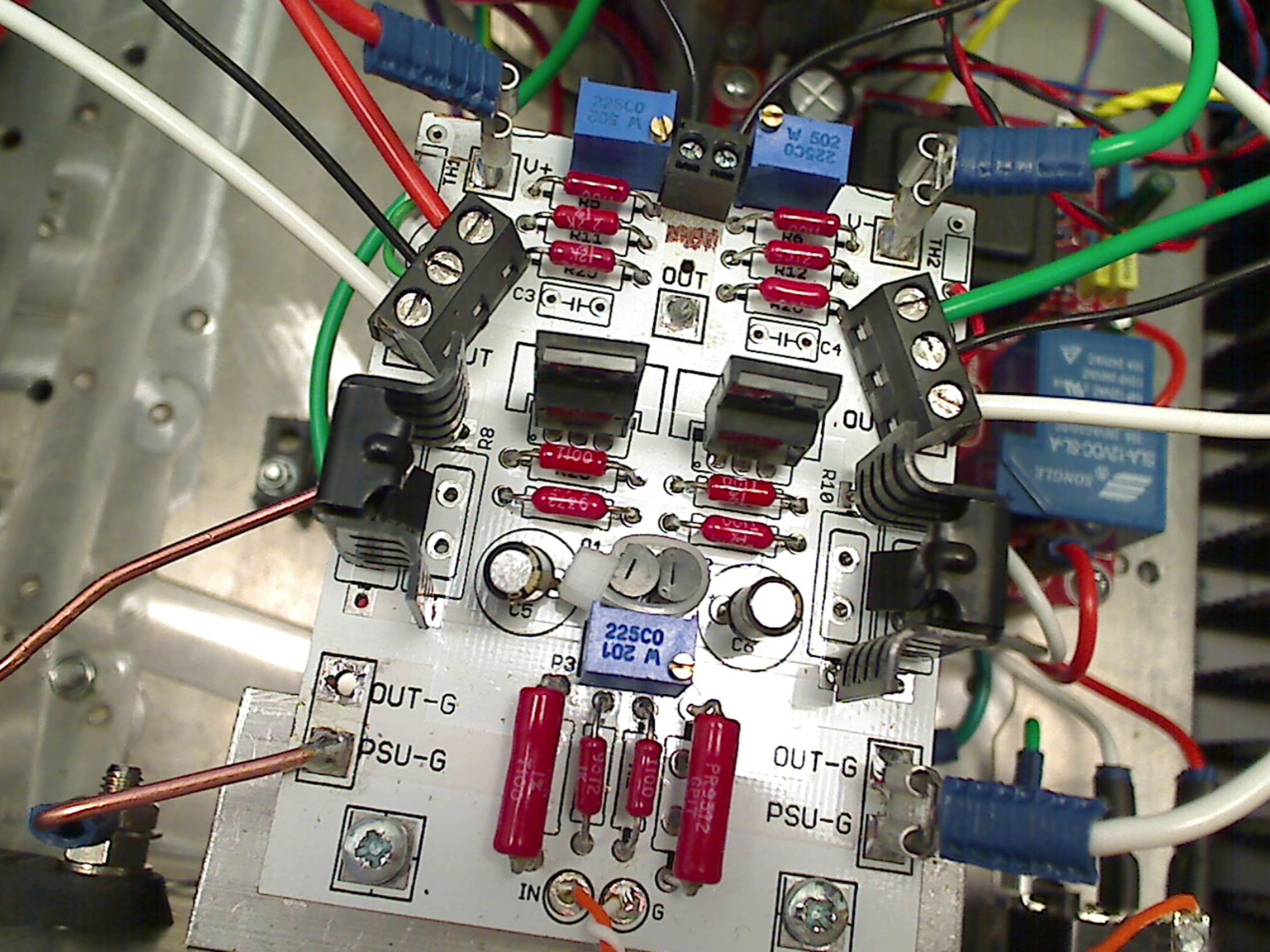

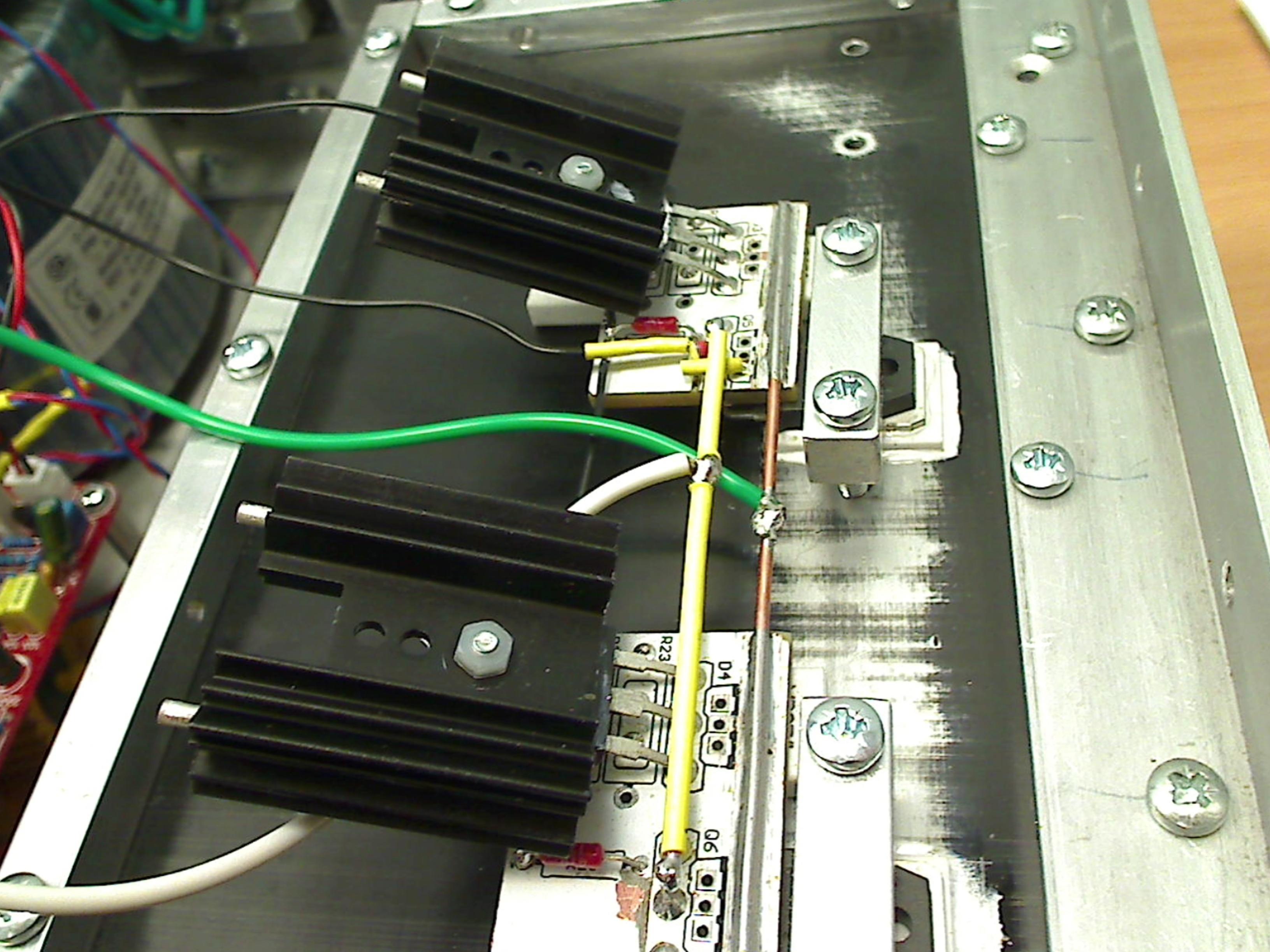

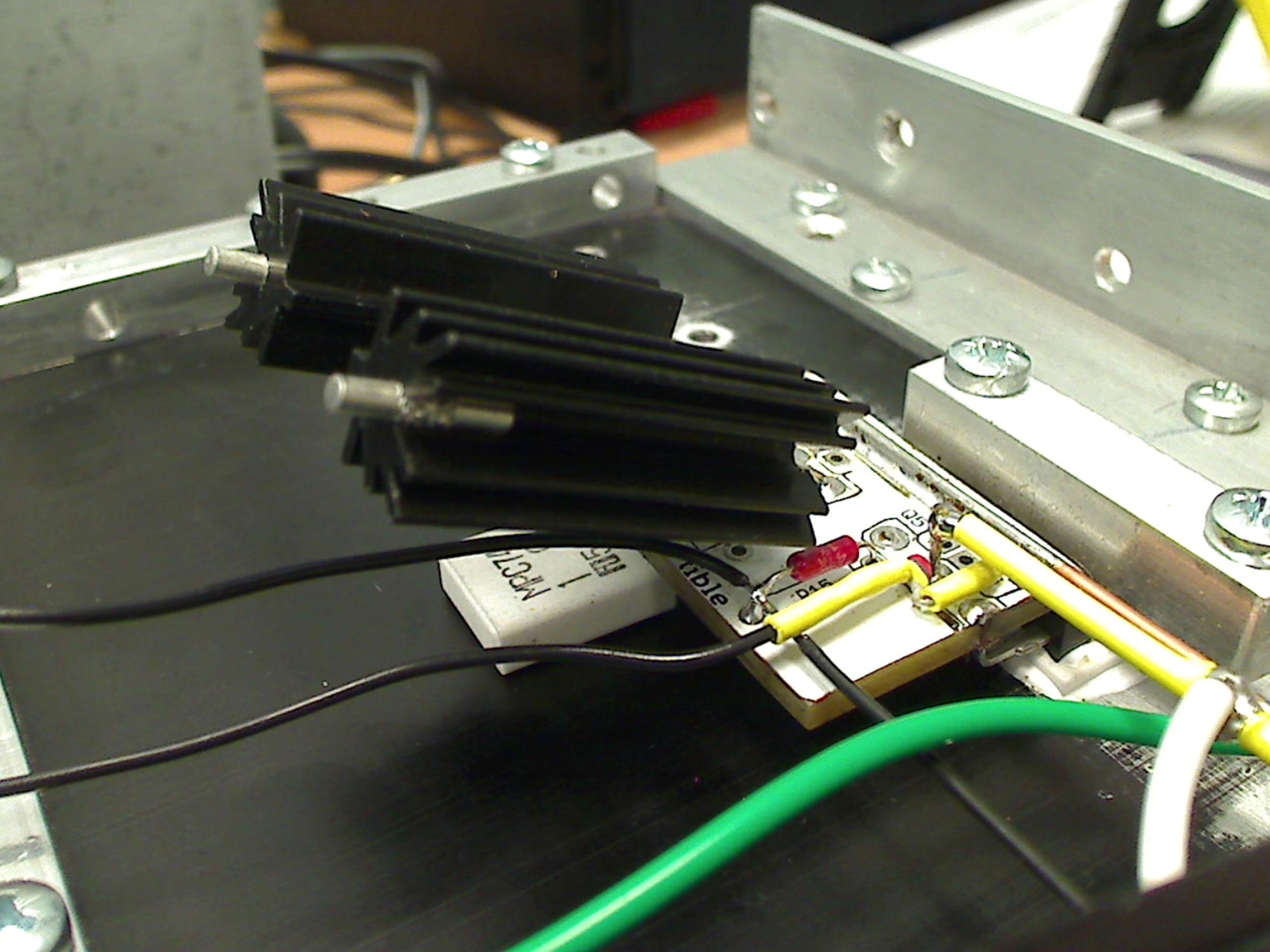

Some picks. Somehow I think they are not a great help 😀
Can anyone recognize the thick white PCBs? :rofl:
