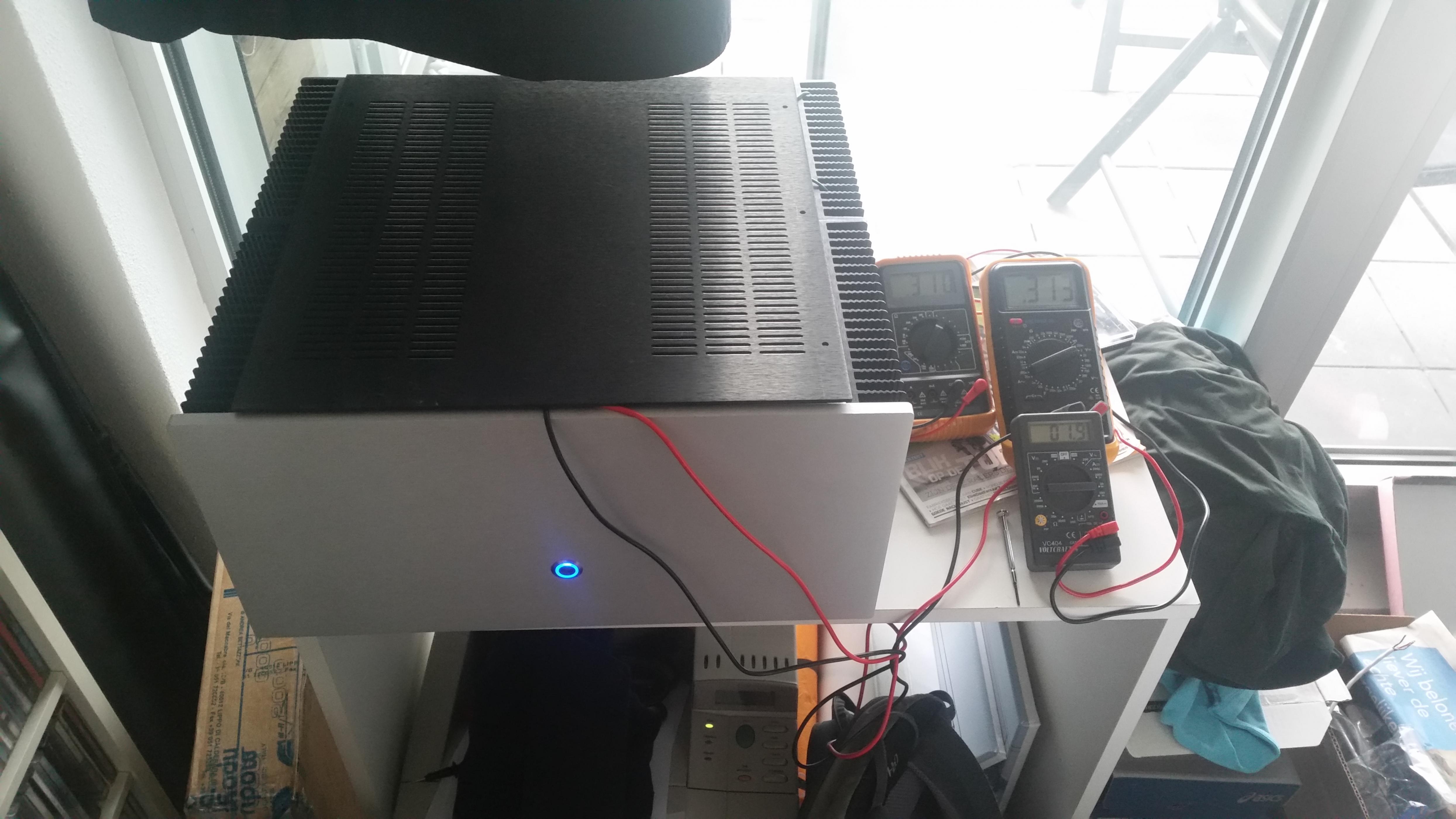

Finally,
F5 Turbo V2 is cooking!
For now Bias is set to .31 V and offset is fluctuating between -2 an +2 mV
the Right channel voltage difference over the Source resistor is .001 V however the Left Channel is .005 V difference. No Worries I think.
it's still possible to hold my hand on the heatsink without the urge to remove is after a minute or so, nice and cosy.
Amp is build in a 5U Deluxe using a 800VA transformer.

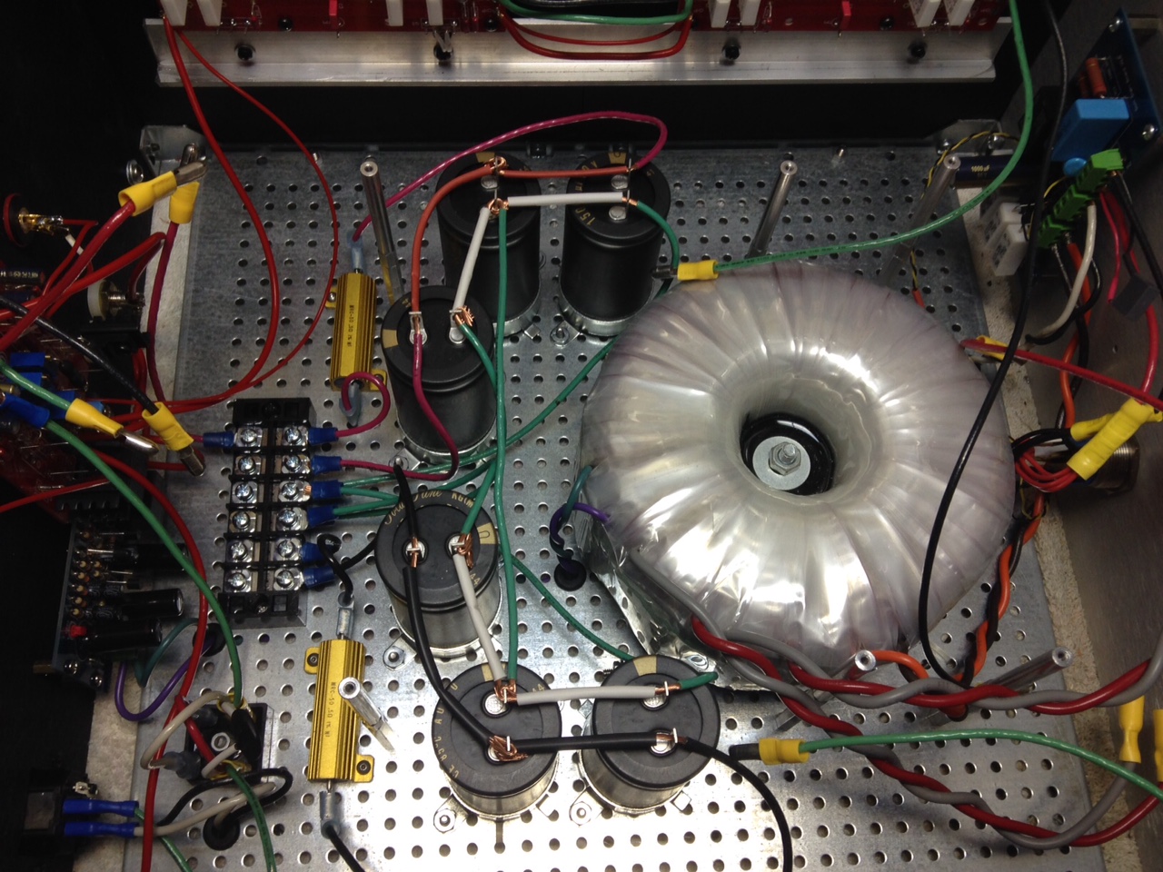

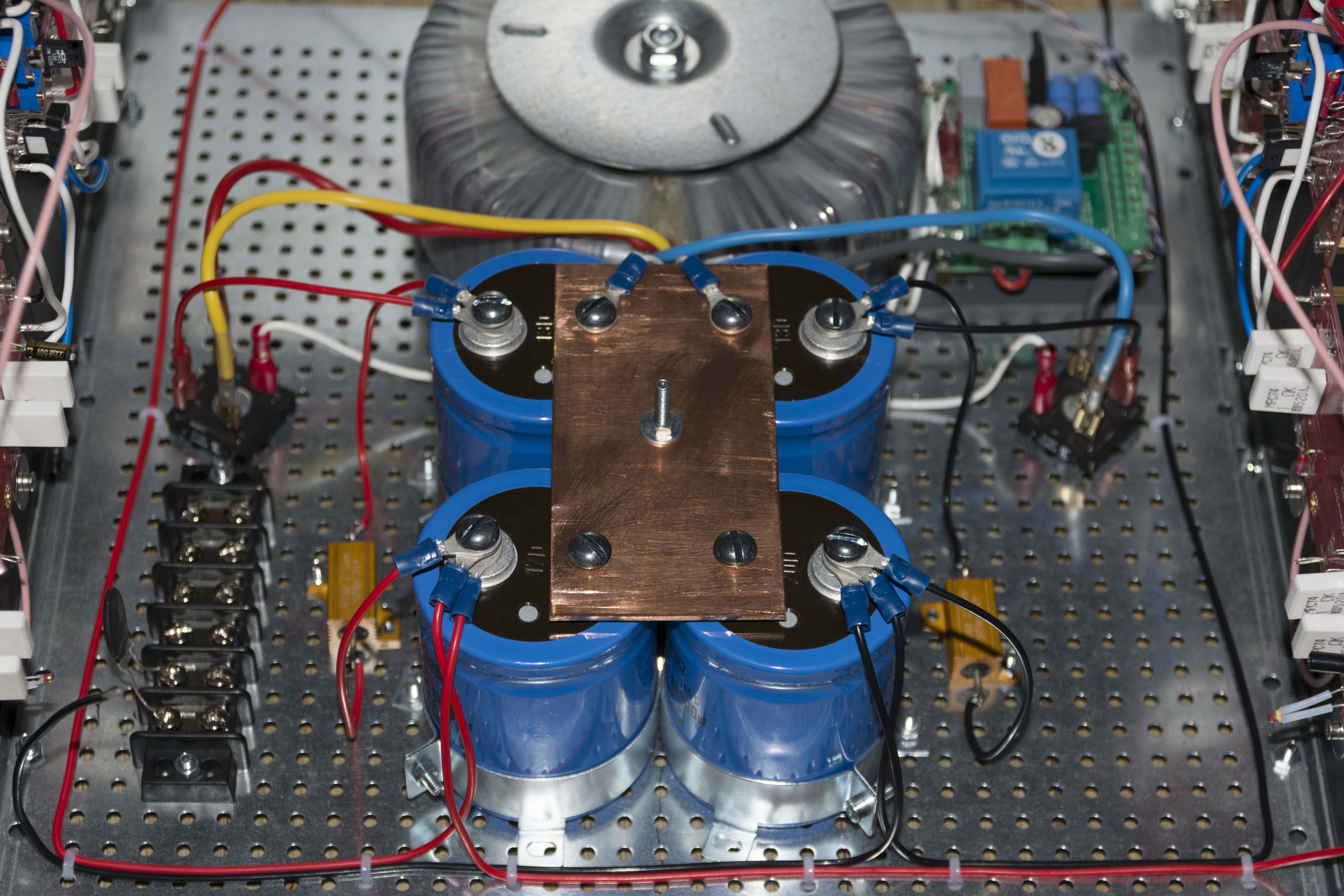

Folks:
As much as I have enjoyed my F5T V3 monoblocks over the past 15 months or so, I was a little disappointed that they lacked some of the authority and weight that the Aleph 1.2 monoblocks they replaced had in spades. I had hoped that fiddling with P3 would work, but that effort proved ill-fated (see http://www.diyaudio.com/forums/pass-labs/267431-f5-turbo-3-failure.html). Instead of gambling against the odds a second time, I spent part of this past weekend adding another 90,000 uF (and a 0.5R / 50 watt resistor) to the stock-sized power supply in each amp, bringing the total to 250,000 uF per monoblock. The power supply capacitors (twenty-two per amp) are all Nichicon KG. This won't come as a surprise to most of you, but the results are terrific -- there is no bloat, the amps still sound neutral, fast and dynamic and my V3s are more commanding and engaging than before. Highly recommended!

the Right channel voltage difference over the Source resistor is .001 V however the Left Channel is .005 V difference. No Worries I think. ................
The bias voltage is the Vgs of the output mosFET plus the V of the source resistor.
The Source resistor voltage, Vse, sets the output bias current.
The Vgs is set by the make up of the transistor. You have no control over that. It is what is comes as.
Difference between P & N Vgs is of no concern.
When you measure a small difference of Vse (after setting offset to zero), you are actually measuring a small difference in resistor value.
These resistors should be matched before assembly. I aim for <<1% error and preferably around 0.1% tolerance, so that measurements later have no doubt about what they mean.
Glad to hear that you got it sorted to your satisfaction.
Could you provide a bit of detail? How did you add to the original CRC config? More caps and a .5R resistor where?
Thanks. Nash

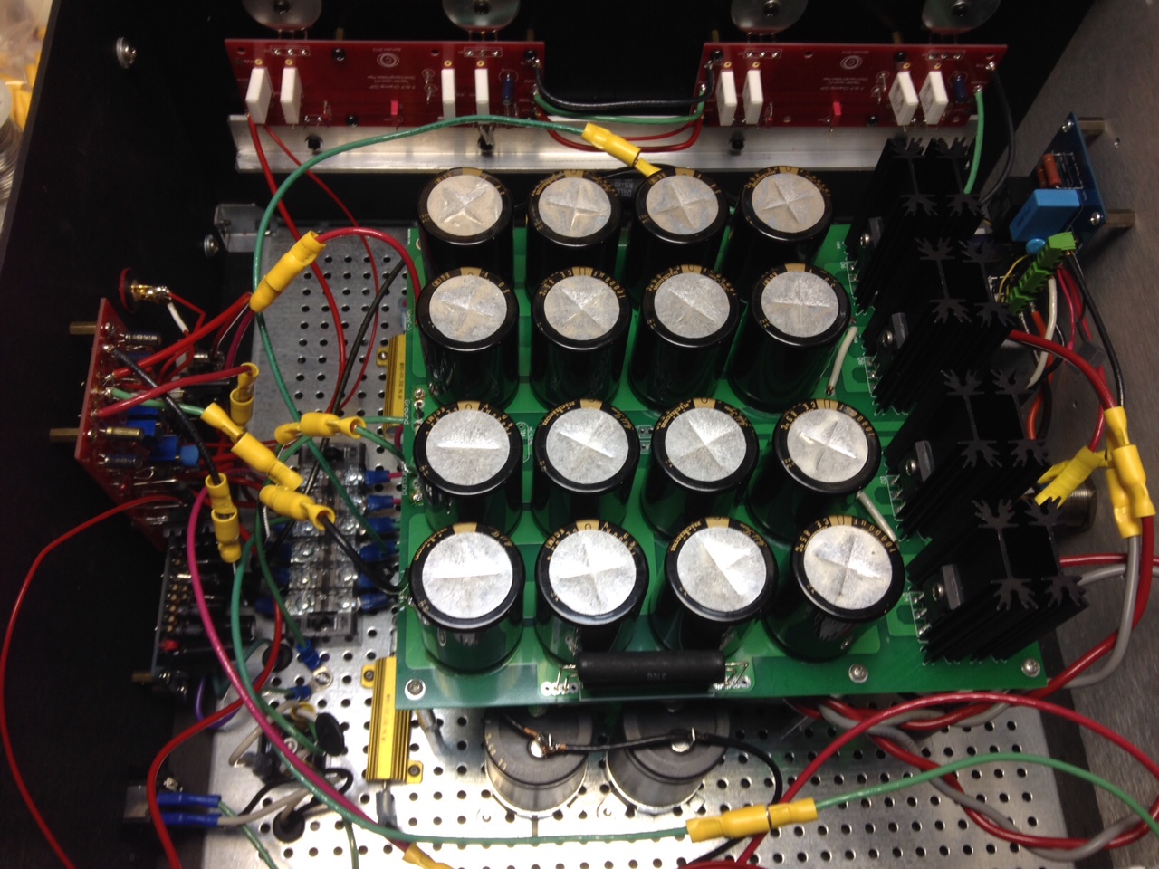

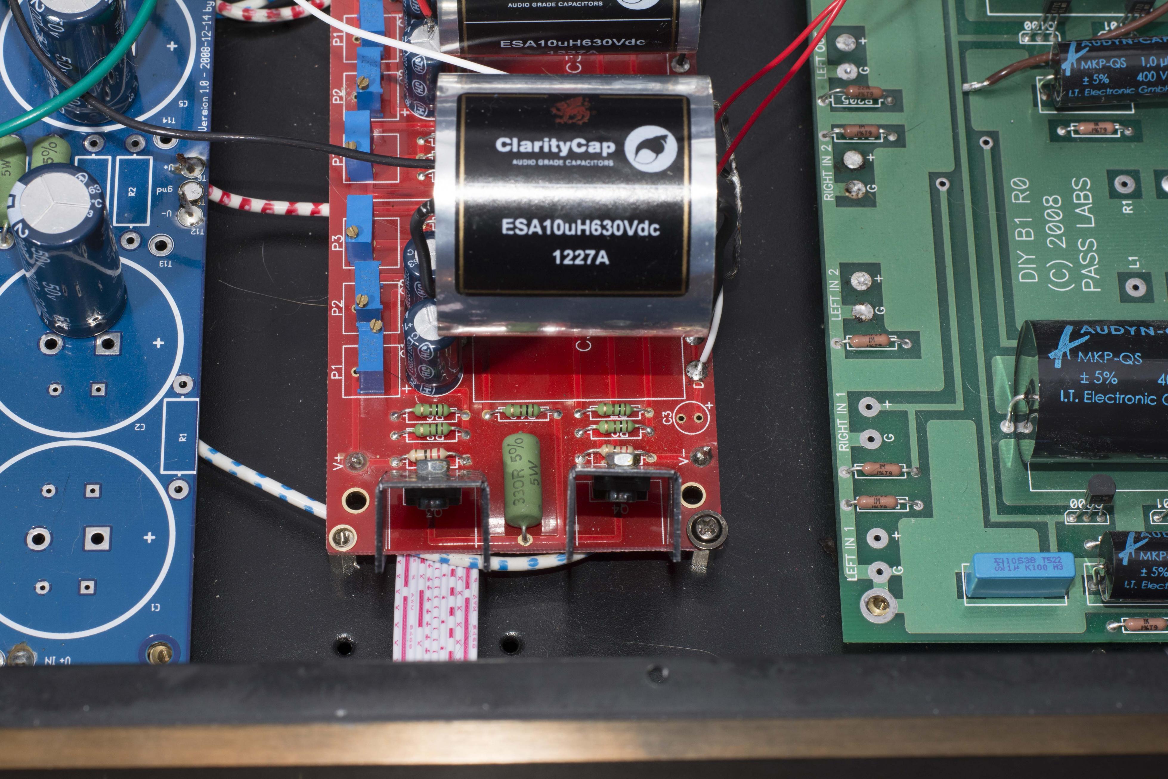

Nash:
I added a third stage to the power supply in each monoblock; see the first photo. The third stage consists of six 15,000 uF capacitors and a pair of 0.5R/50W resistors (which arguably weren't necessary). A six position terminal block was used to organize the connections going to the new third stage (from the existing power supply board) and to the F5T pcbs (from the third stage). I redirected the "output" from the existing power supply pcb (see the second photo) that had previously gone to the F5T pcbs to the first, third and fifth positions on the terminal block (the first position is at the top), which then fed the three capacitors on each rail of the third stage. The output from the final capacitors on each rail in the third stage go to the second, fourth and sixth positions on the terminal strip, and then on to the F5T pcbs.
I hope that makes sense. If not, I'd be happy to try it again.

Nash:
Scott
Thanks Scott. So you have a PSU that is CRC- CRC. Right?

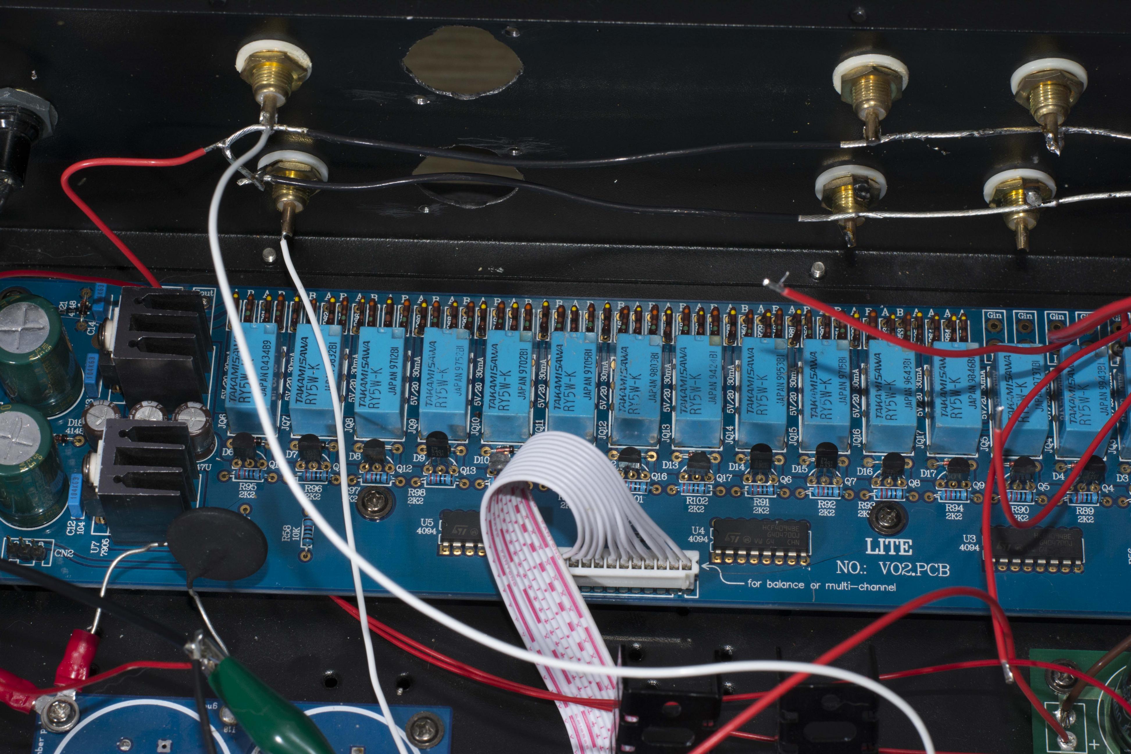

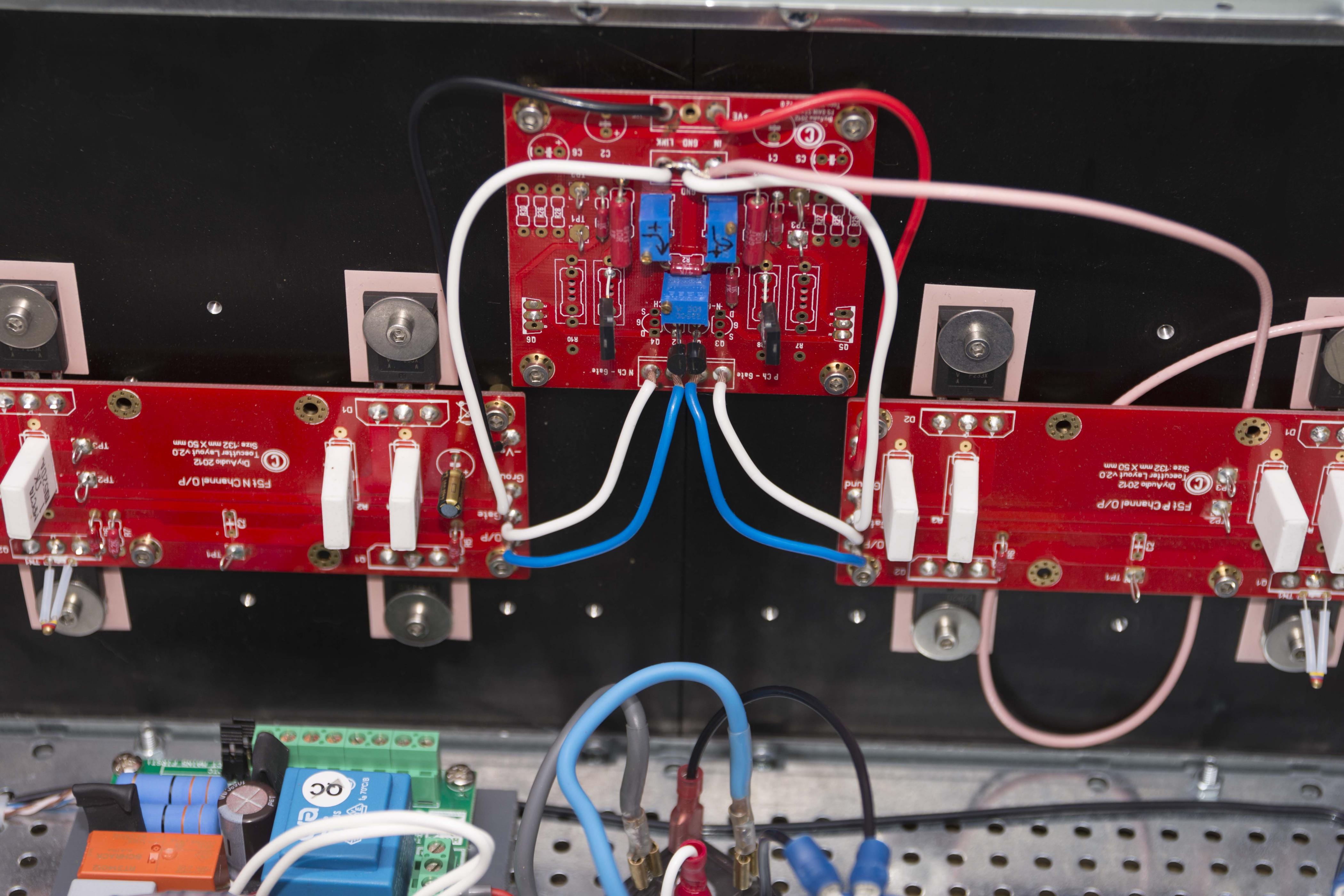

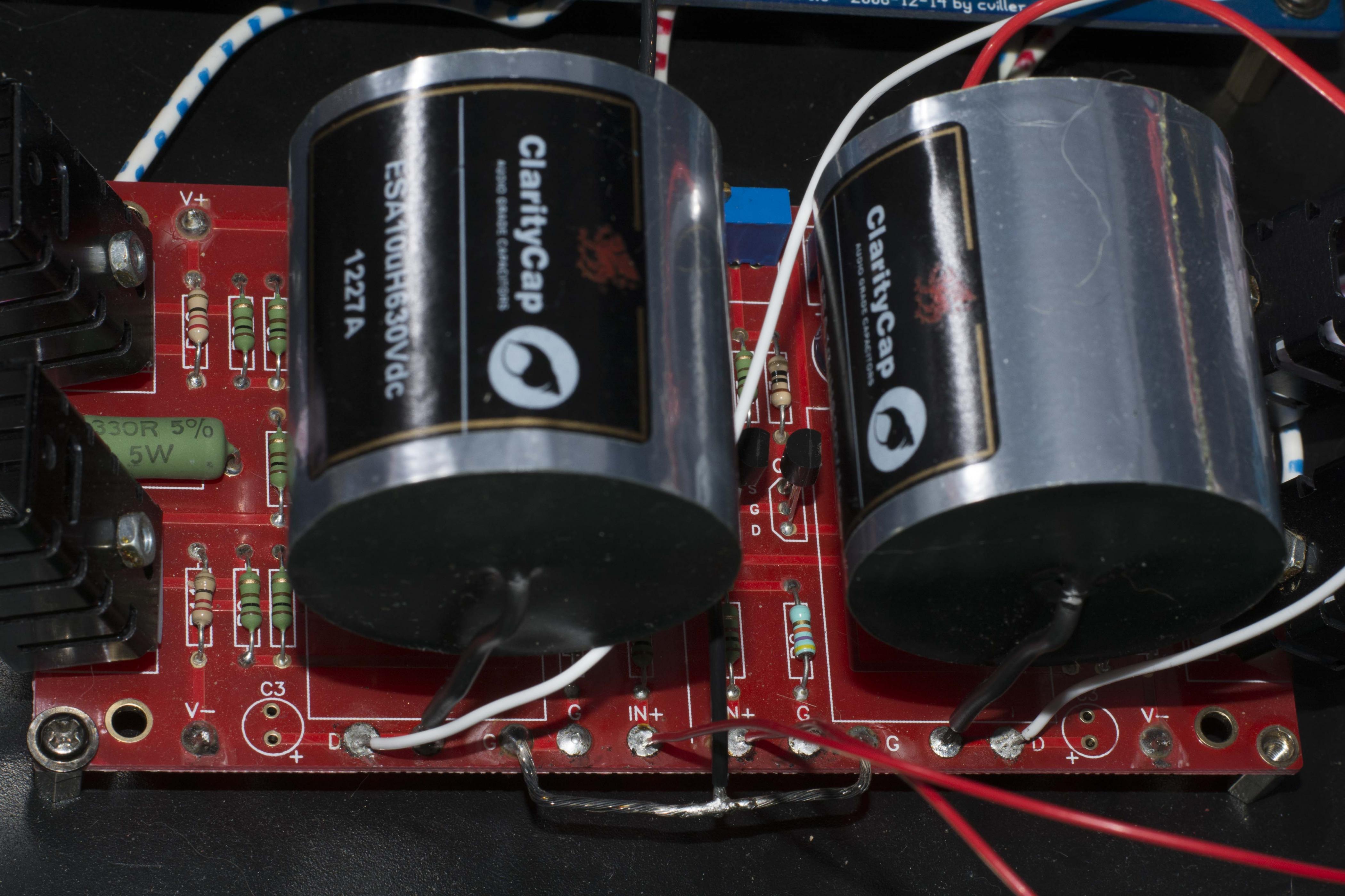

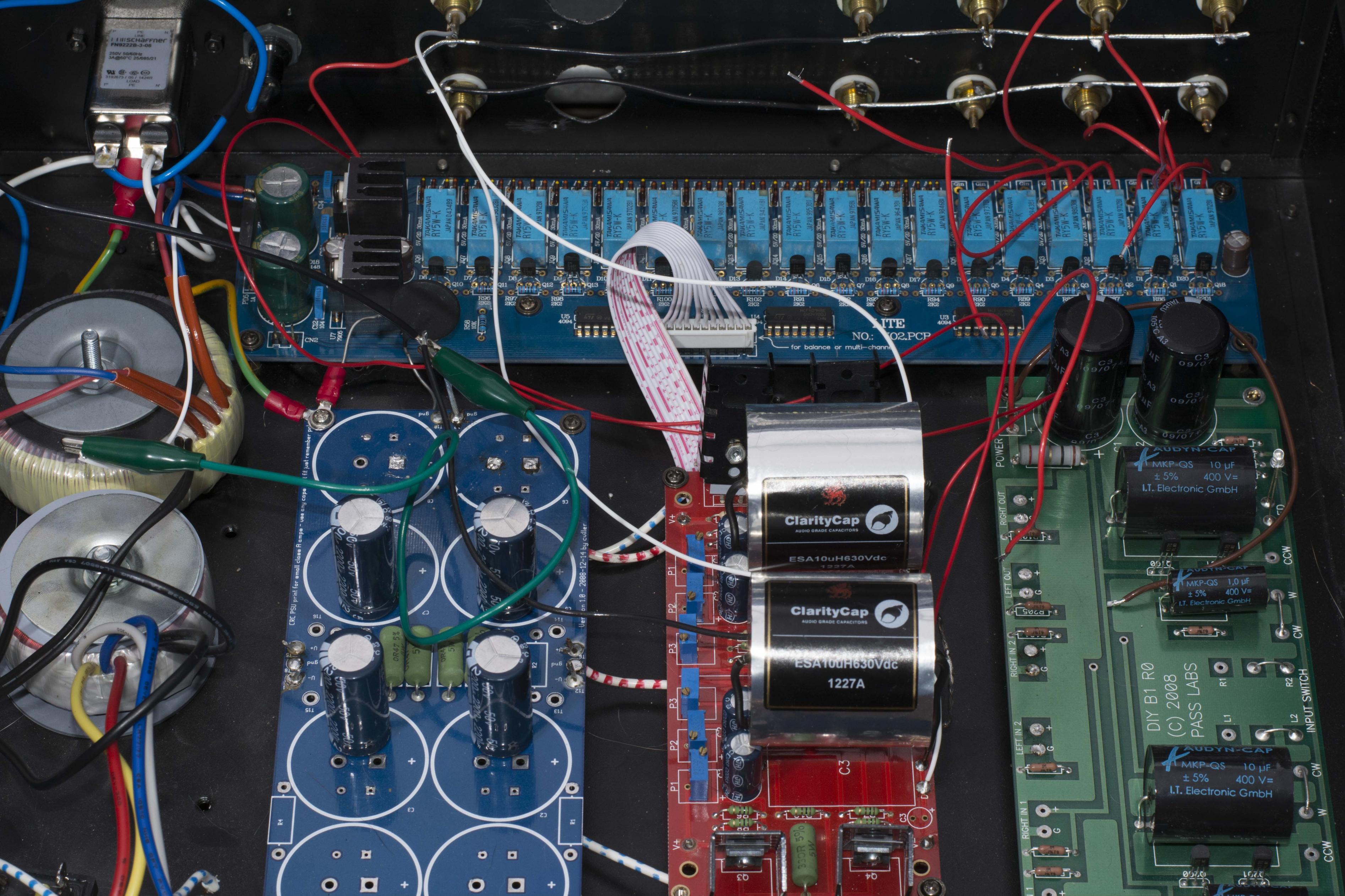

Hi All,
My F5 Turbo V2 is silent..... Speaker connected. although when my pre-amp is connected with the F5 it hums loud, there is also a little bit of sharpness in it.
I can not figure out where this hum comes from. The interconnects do not interfere, cables only connected at the power-amp gives no hum. I think it's a Ground-loop triggered by the Pre-amp. today I did tried several things.
My pre-amp is a BA3 FE stage powered by a Powersupply PCBv3 @24V. I made a star ground, and installed a relay volume controle.
BA3 is biased at 1V over R10-R11 and about 20mV DC (meaasusred before CAP en gnd) over R12 there is no DC
The B1 was in and I used this one also to check whether there is a Hum.... And it was..🙁
Since I was testing, I only connected the Main input and output. So try to look trough the Spagetti😉
All suggestions are welcome
