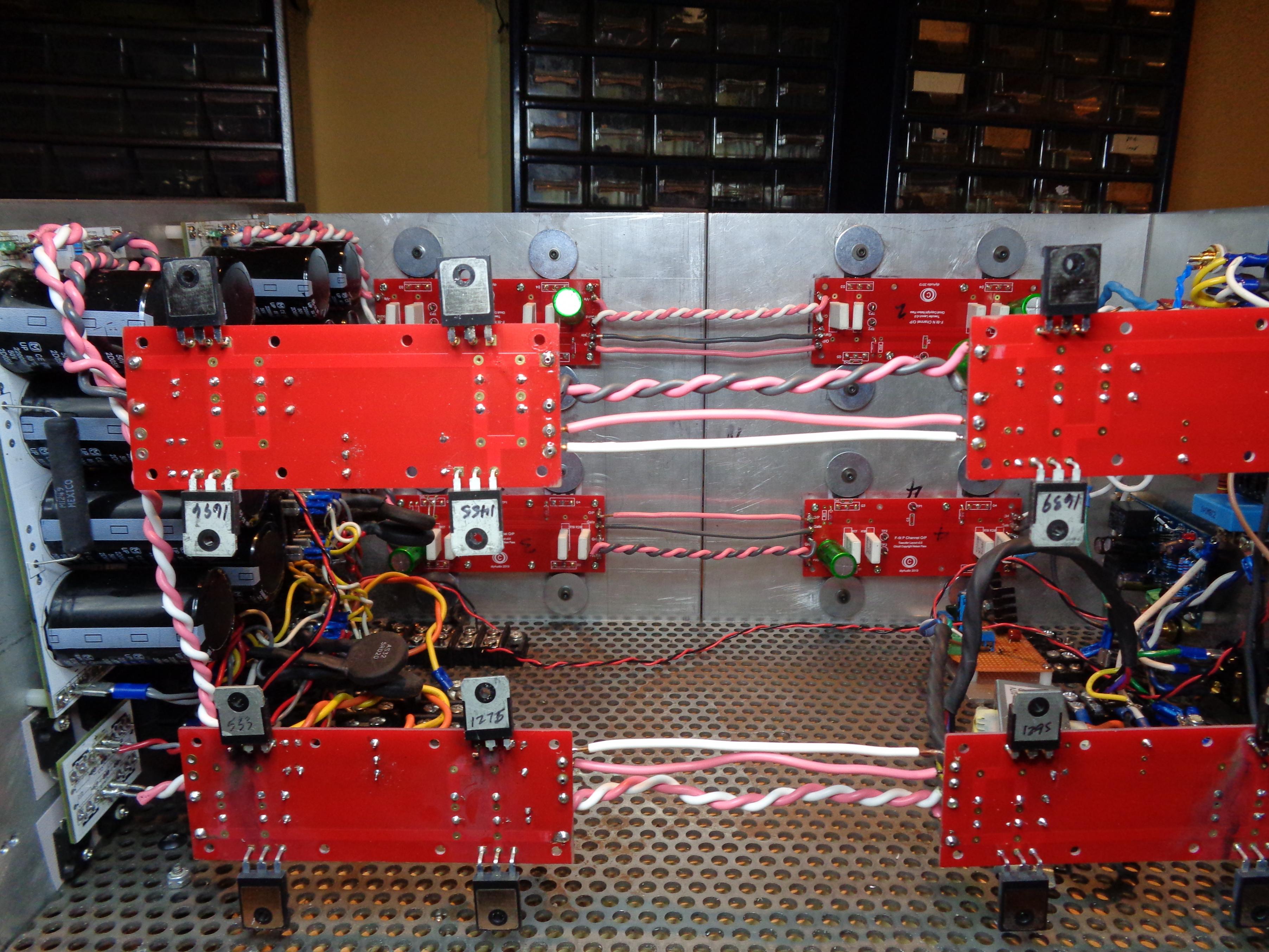

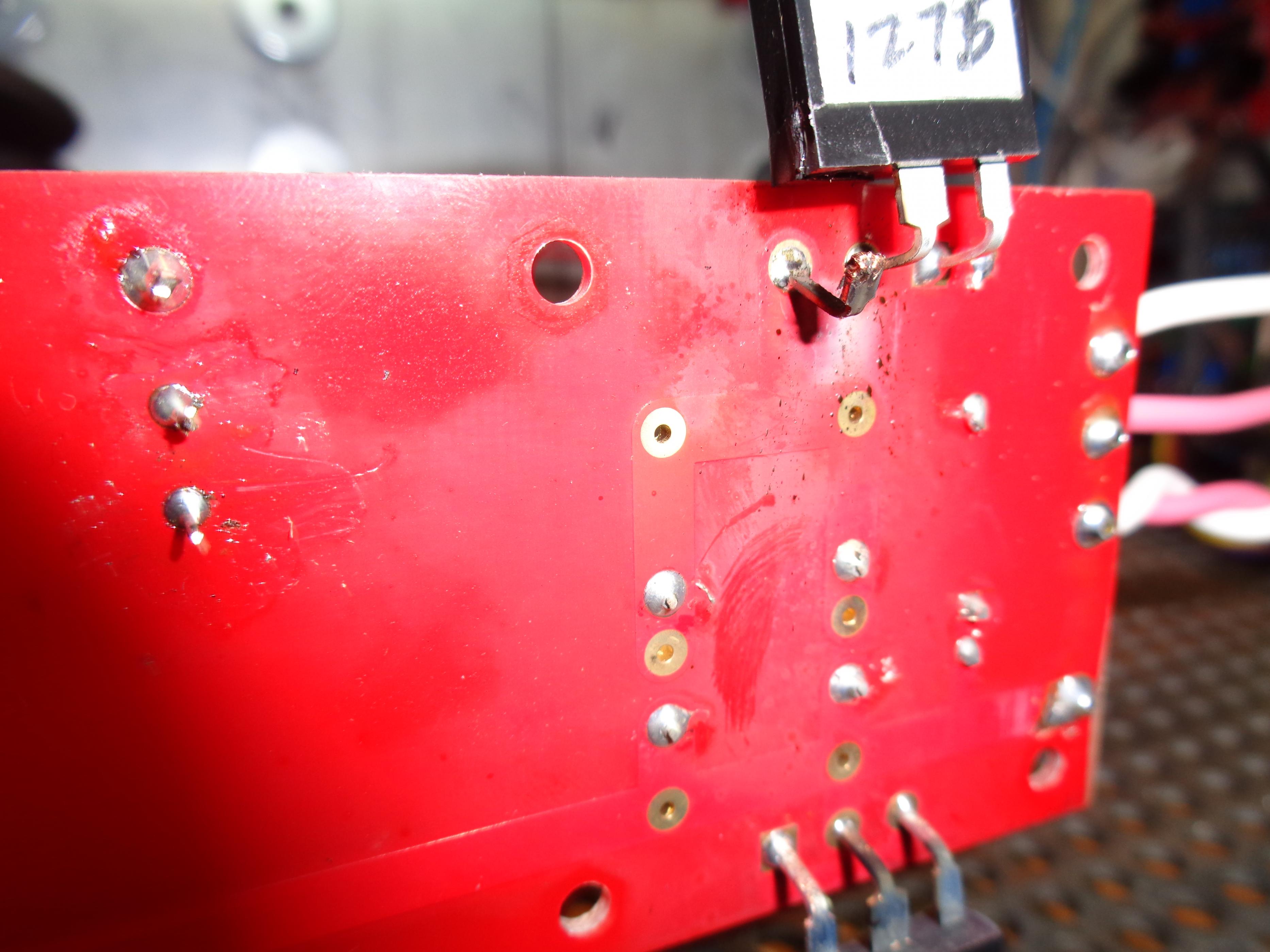

Here are some photos of the damage... do you think the keratherms are still ok? Fire came out of the MOSFETS on the lower board, and blasted the diodes below them.... The first pic shows three Mosfets were breathing fire. I'm pretty sure the fourth one is also toast.

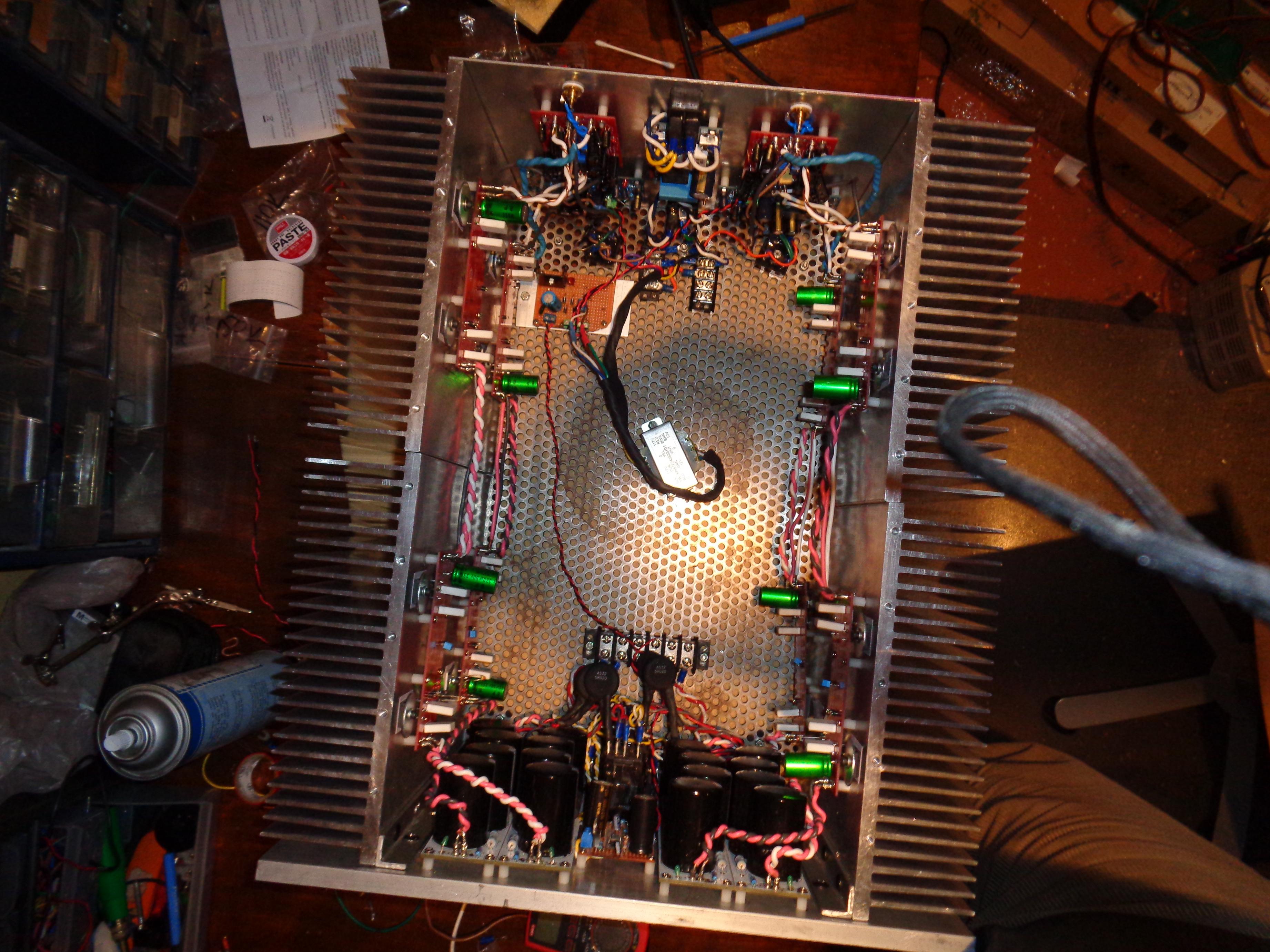

I believe that the right channel noise is caused by EMI from the open frame EI core auxilliary transformer. A shielded, encapsulated toroid is on it's way. I now have time to clean up the wiring.

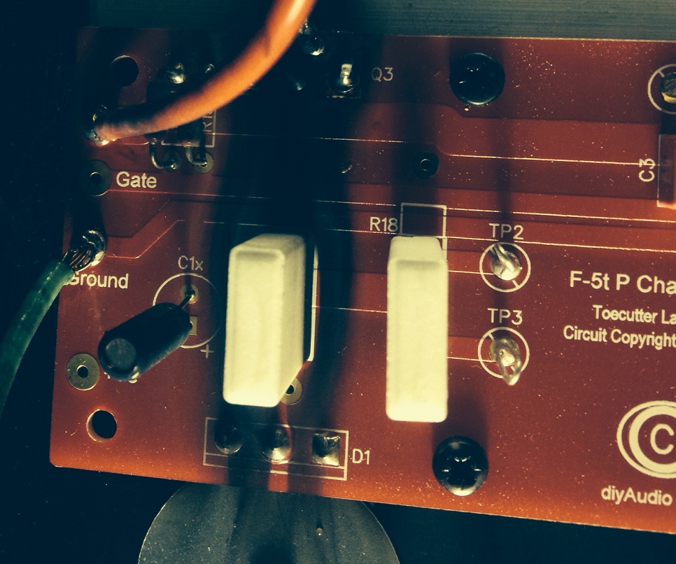

P3 DO have impact on bias and offset. Nelson Pass do mention fire extinguisher in the article. it's not to be funny 🙂 if bias is let to go over the point where the diodes starts cunducting, you have a bias runaway with burned outputs and a fire as a result.

I guess the rule is to not twist P3 wildly. If you must play with it, ensure that you are at least monitoring both N and P channel bias levels, and watch that the bias does not exceed 0.4 V on either channel. As I understand it, P3 can introduce an assymetric biasing, which changes the distortion spectrum. If you twist it enough, no doubt, all the bias current can go to one side - in my case the N-channel. P3 can also be used to match the N and P channel bias perfectly, which I believe is the lowest distortion position.

Also fried R15/R16 on both N channel boards, and R12. Probably the thermistor too, given it is in series with R12....
This is a really big repair job. Hopefully the furutech source resistors are OK. They don't look damaged.

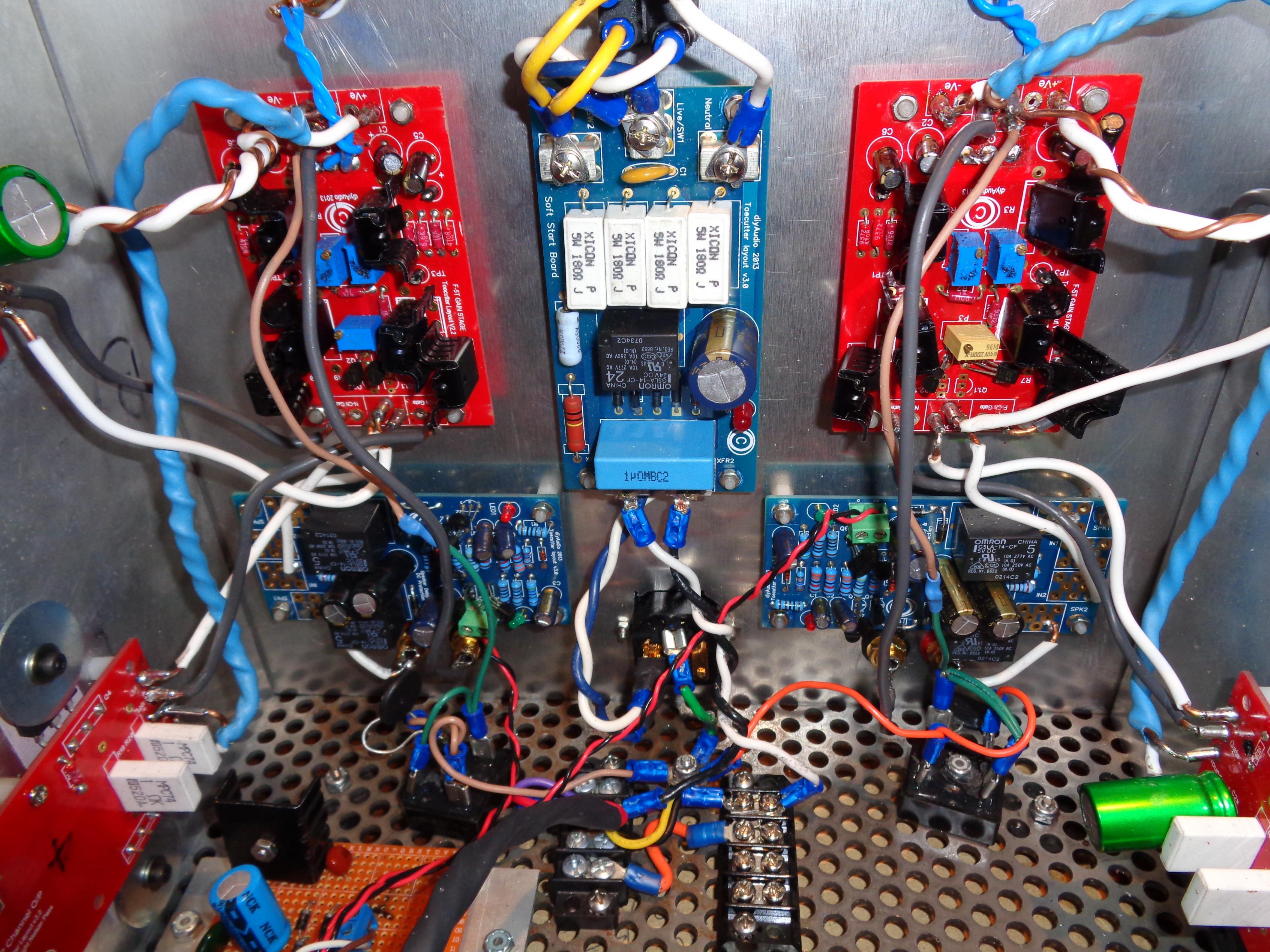

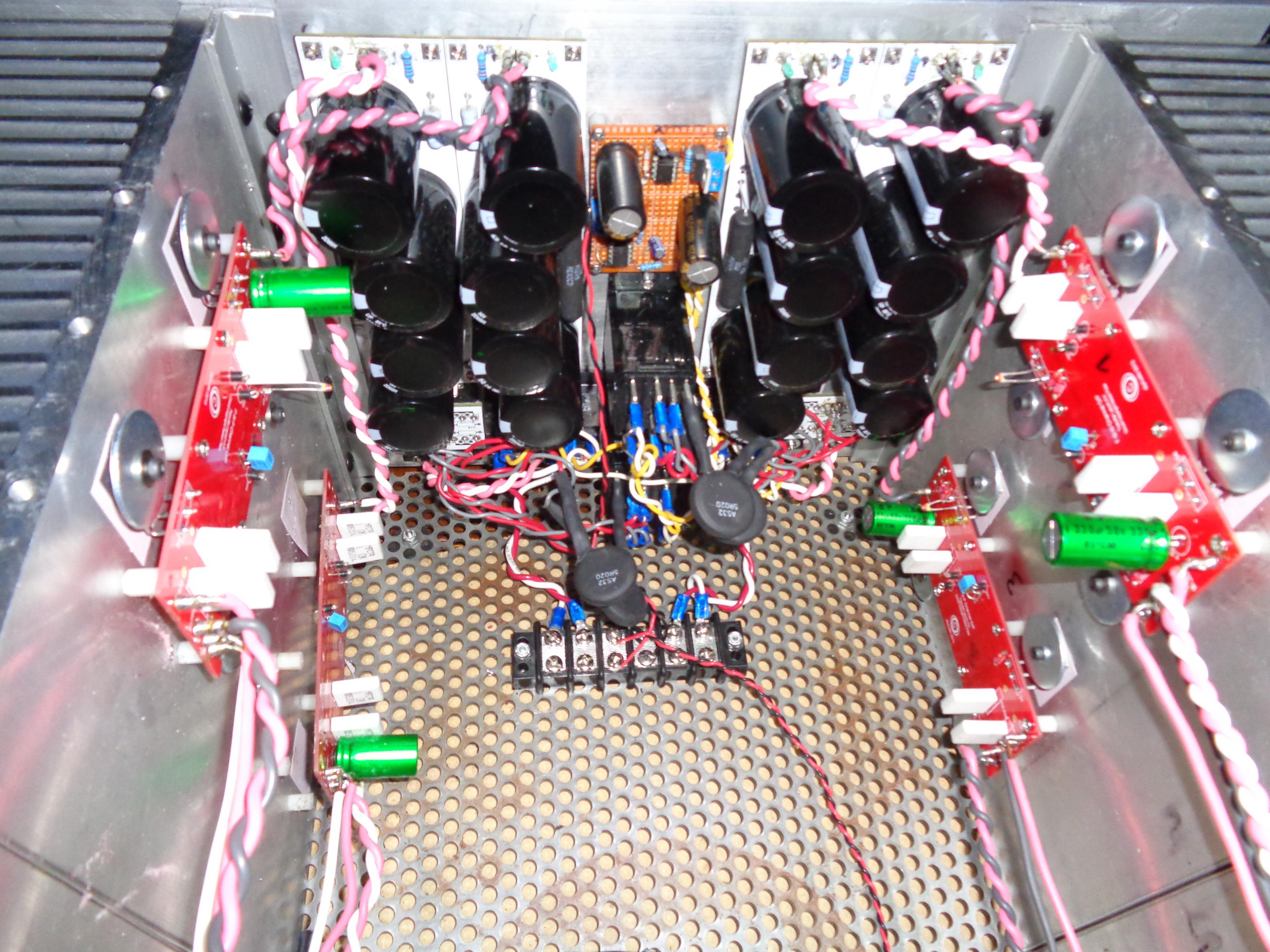

The big complex thing was the soft-start/slow charge circuit. LTspice helped make that work. The rest ought to be assembly issues -- ie, given that the right parts are installed in the right way, it should "just work". I was listening to it last week, but it was a bit noisy for my liking.
I suspect the aux transformer was putting noise into the circuit.
See photos here
You can see the corner of an open frame transformer at the right hand side of the photo, very near the audio circuit. I've bought a shielded,potted toroid, with the same VA and I hope to see that Friday or Monday.
If *that* does not work, there will be some bigger changes. I really just want to figure out what is wrong with the build. If I can do that, then, I will have learned something. If I abandon this now, and copy someone else's layout, I won't learn as much.
Attached are the photos of the case without the big toroid in it. The safety earth is beneath the IEC, and the ground loop breakers are attached there.
The two terminal strips in front of that allow the selection of secondary voltage.
The front contains the power supply caps, relays, slow charge circuit and rectifiers. One barrier strip is installed to enable the front panel to be removed if necessary.
