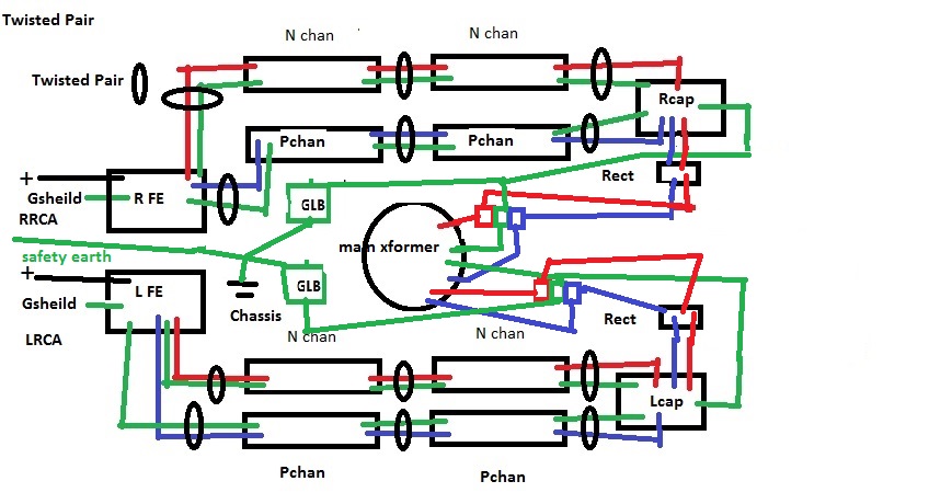

post3698 has no mention of the CONNECTION between the TWO interconnects into the Left and Right RCA input sockets.
Further there is no mention of the Main Audio Ground on either amplifier channel.
The drawing is incomplete.
Now read Joffe and you will SEE why the missing links are critical to understanding where the interference is getting in.

I am clearly misunderstanding the Main Audio Ground (MAG) concept. I thought the drawing in 3698 shows that the CT as MAG?
Here is a drawing of how it is actually configured at the moment. The drawing shows that the paralleled secondaries are now split into two parts.

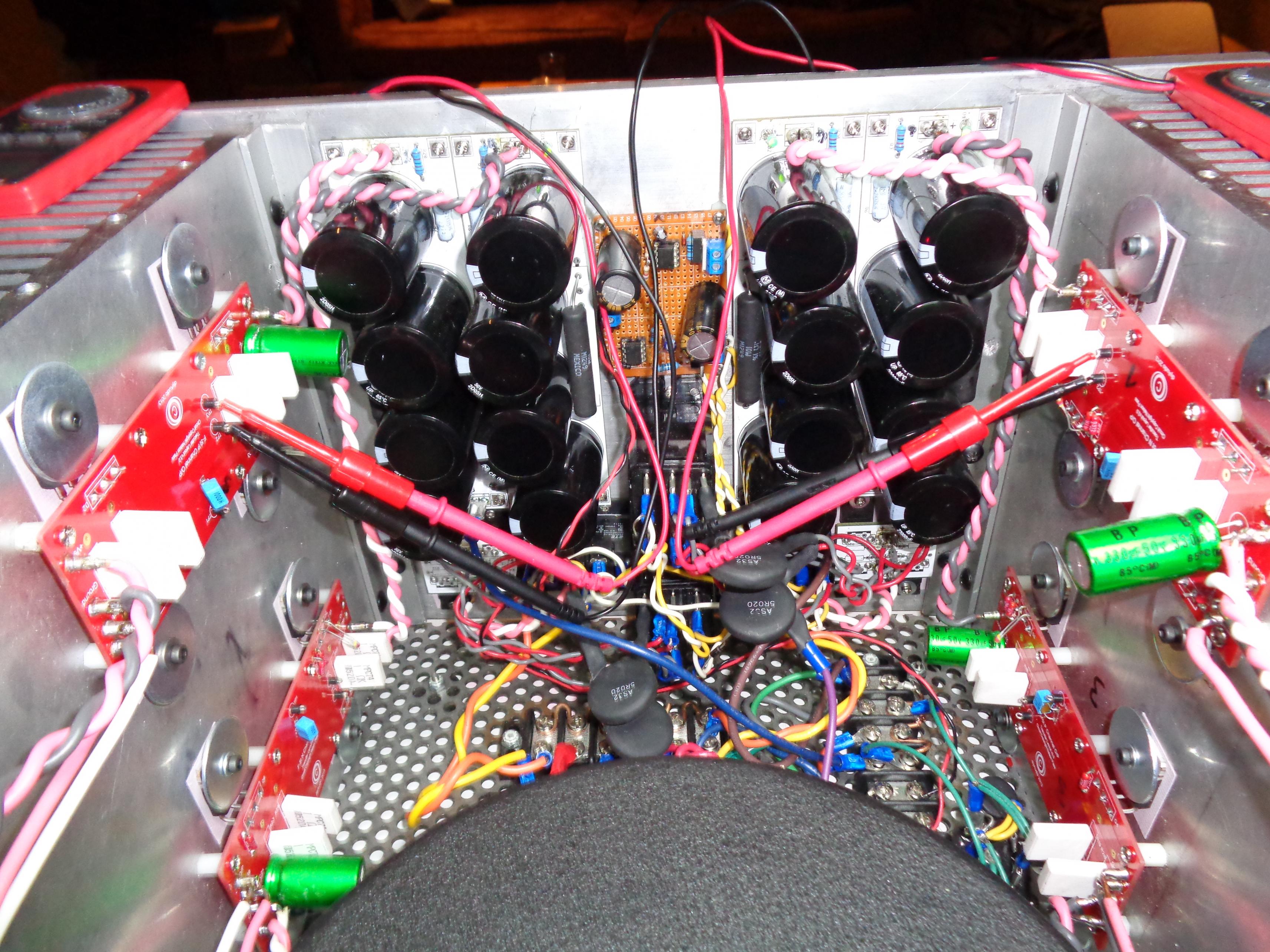

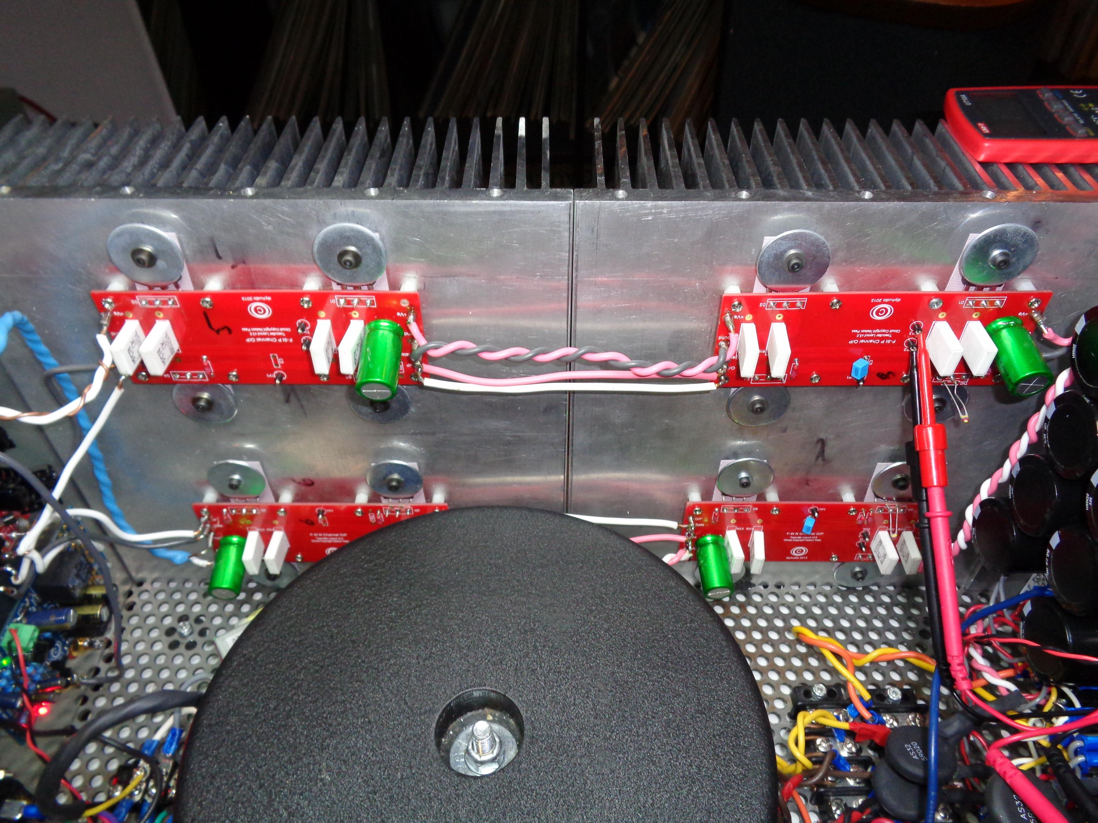

I think I found the issue. When I reconnected LCHAN, there was still no hum. When I reconnected RCHAN, there was a bit of hum but now, only from the RCHAN!
Examining more closely revealed that I had left the CT of the unused 5th secondary attached to the CTs of the other secondaries in RCHAN.
It is MUCH improved now.

I will try to explain...
Starting at the toroid in the centre, the green lines coming out of the toroid represent the center taps. They are connected to two barrier strips, each of which is represented by the three small squares red/green/blue squares.
The green lines to Lcap and Rcap ( left/right channel cap banks) are the power supply commons for each channel's cap bank. They are connected to the barrier strip, as is the Ground loop breaker (GLB).
The GLB is a CL-60 and a 35 A diode bridge. The +/- sides of the bridge are connected to the ground point on the barrier strip. The AC sides of the bridge are connected to the single safety earth connection at the chassis. This is connected directly to the IEC safety earth tab.
The blue lines at Rcap and Lcap are the positive rails, the red are negative. The symbol "rect" indicates the rectifier, one per channel.
LFE and RFE are the front end boards. The Gshield is an RCA shield, the black + represents the signal input.
Does this make more sense?

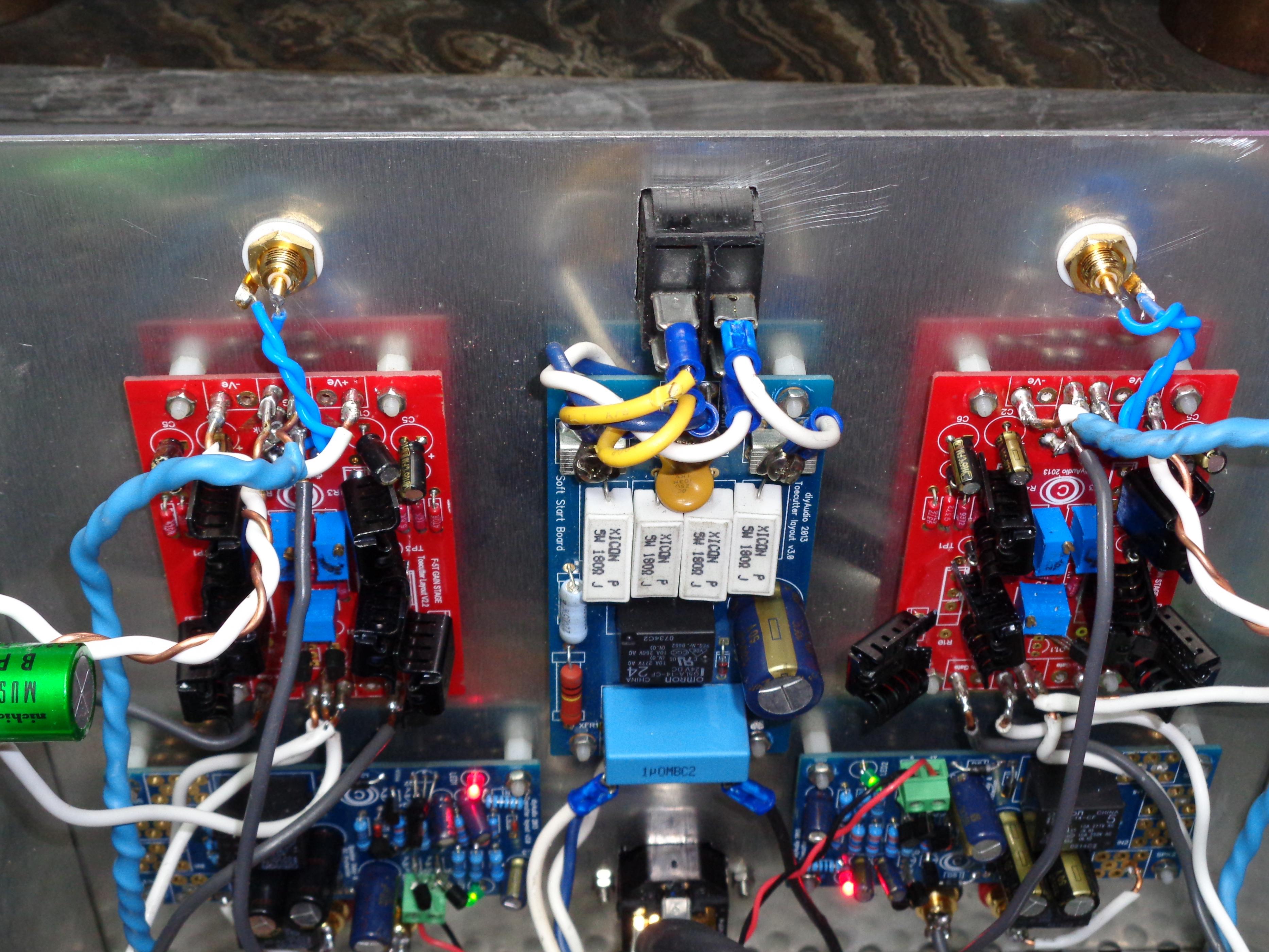

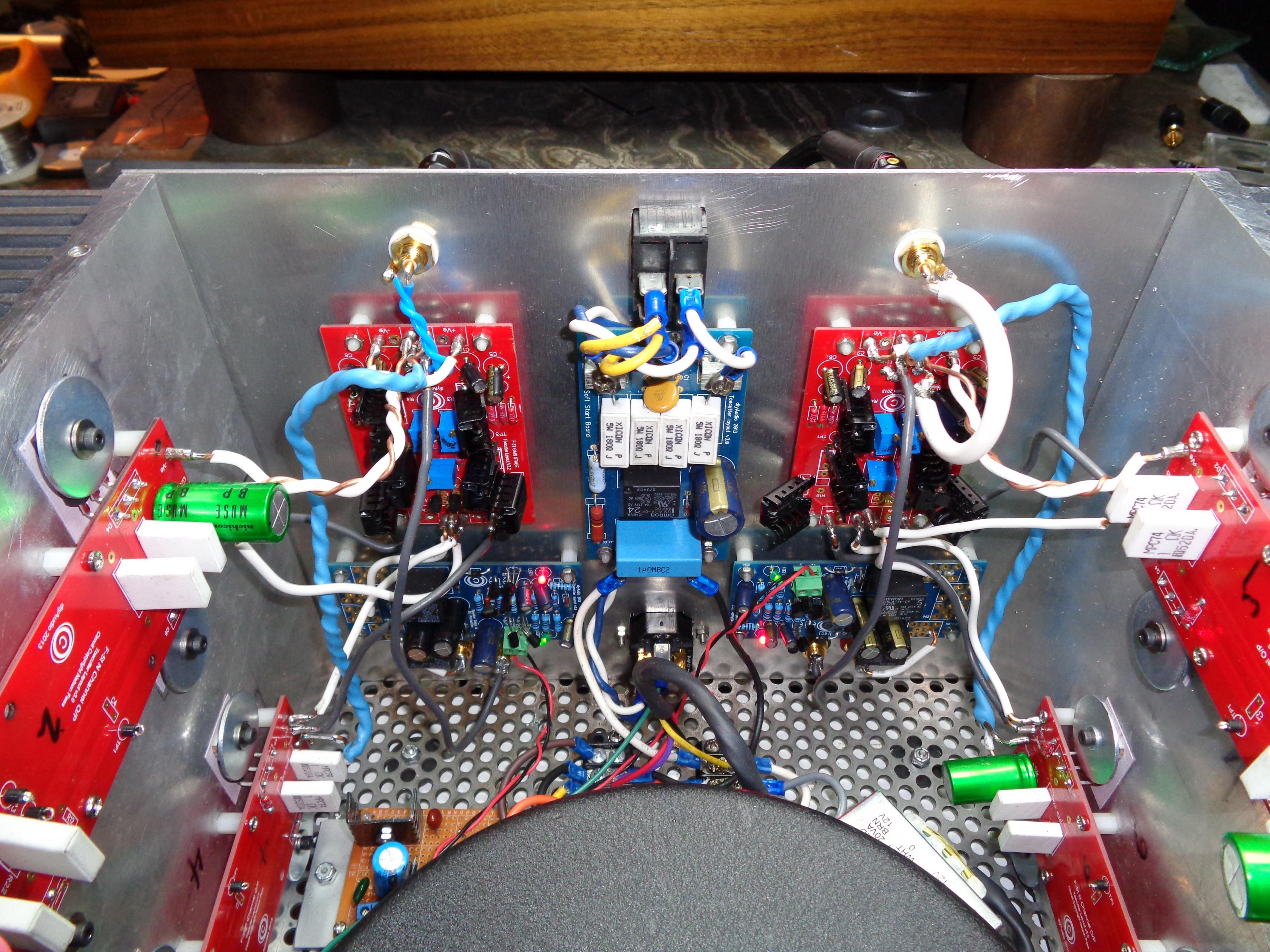

Thanks John. I think I have a clue of what is going on. I think perhaps doing what's in the photo is wrong -- the RCA input should be shielded.
What I noticed was that the blue heatshrink wrapped wiring on the Rchan was closer to the RCA than the Lchan. The caracteristic sound of the noise was different between the two channels. Bending that wire to the same distance away, changed the noise so that it was the same between the two channels.
I think that there is a ground loop created, but he resistors and NTCs reduce the noise a great deal, but without a shield, it can be induced in the circuit.
The Left and right sides of this back panel,from top to bottom, consist of RCA, FE board, Speaker protector, Speaker posts.
The center of the back panel, from top to bottom is Power switch, Soft start and IEC.

Discovery... both channels behave in exactly the same way. This is good. One was dropping out because the speaker cable was loose.
I changed the input wiring to a shielded cable, a quad star with one pair plus shield to RCA ground and one pair to RCA signal pin just to test. Was actually noisier than the twisted pair.
