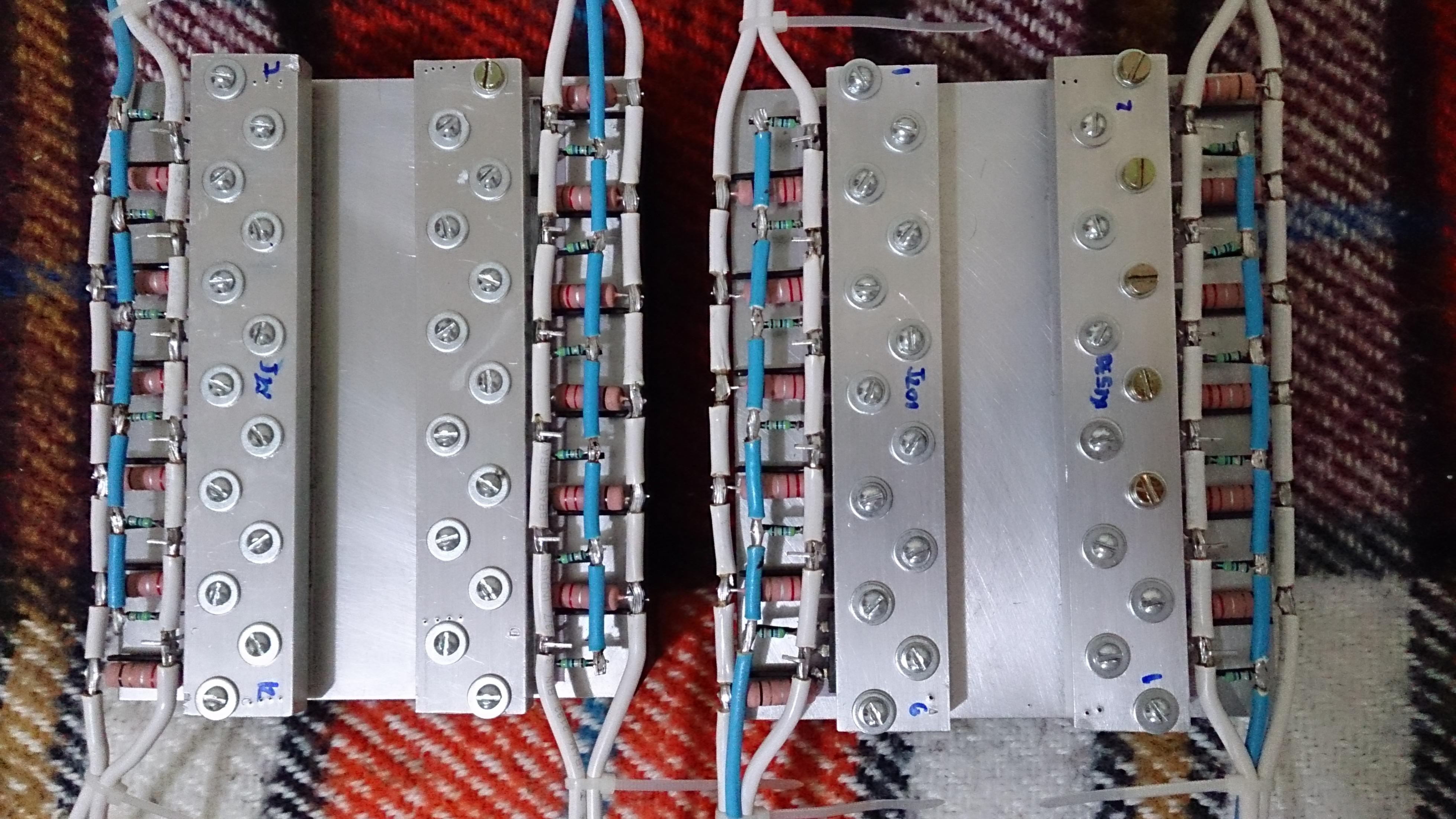

Hi all.
I'm testing how hot I can run my F5.
I went up to 18W/fet (a total of 12 per side) until now. The dissipator was measuring ~42c and the fet drain leg ~53c. I'm concerned because I thought Kerafol would give me a smaller temperature delta. I'm sure the fets are well fixed, besides the fact I'm using clamping bars and washers. Should I worry about this temperature difference?
Many thanks
Daniel

It's a bit high for Kerafol, but we don't know which Kerafol is used.
My experience is that with more pressure you can get a delta of 6 to 8 degrees...
It looks like grey Kerafol, probably softtherm 86/600. Datasheet for the .5mm pads says .2 C/W.

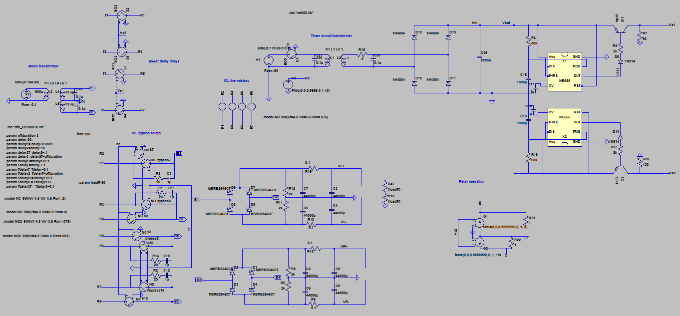

I am having some troubles....
I started the power supply today, with just two caps per board. I am using Tea Bag's power supply boards, and have a light bulb limiter in place. No amplifier circuitry is connected -- there is no load.
The secondaries on my transformer are centertapped, so I wired the boards in reverse -- the inputs are on the side with the +/- and ground connections. The ground is strapped together with the jumper that Tea Bag's boards provide. The center tap is connected to the power supply ground.
The diyaudio soft start board is being used. The 1.4 KVA transformer starts up perfectly ( it is originally 2.4 KVA, but it is wired to reduce secondary voltage).
I am using a set of 8 relays with 12 VDC coils to control the power supply. They are energized by two 555 timer circuits powered by an independent 9 VDC, 12 VA transformer.
The relays are operated in two steps. 4 of the relays are in one group parallel, they present a 35 ohm load to the timer board. They are Normally Open. These are used to switch power to the diode bridges. There are two diode bridges, one per channel.
The other 4 are also in parallel used to bypass the thermistors. They are changeover relays, with the thermistors connected to the normally closed contacts. One coil operates two relays.
Each relay has an IN914 diode across the coil, with the marking band connected to the +'ve output of the timer circuit.
When the bridges are not connected, the first 4 relays click in unison, and the timer circuit voltage outputs are at 9.3 VDC. Must operate is 9 VDC.
When the first four relays are connected the light bulb flickers as the relays click in and out, then the relays stop clicking and the lightbulb stays dark.
The rail voltages are OK, but the coil voltages drop to below 9 VDC -- about 8.8 VDC.
During this clicking, the light bulb is flashing. The mains voltage sags to about 60 VAC , and then rises back up to 114.3 VAC at which point, the relays stop clicking and the lightbulb stays off.
When the transformer is first powered on and no diode bridges/caps are connected, the voltage is a solid 122 VAC.
The timer circuit does not use a voltage regulator. It does use one 2200 uF cap and a TIP32C transistor per timer to drive the relay coils.
I don't know where to look.
I'm guessing that a 12VAC transformer would be better to power the timer circuit, but then it would need a 12V regulator as the unloaded voltage would exceed the max Vcc of the 555 timer.
Why shoud the mains drop so much and worse, stay low? There is no load here! If they are going to drop to 66 VAC with such little capacitance, there is no way that the relays will stay closed when the rest of the board is filled in.
Mains: 122.2 -> 114.3
Secondary: 33.8 -> 31.7
Rails: 0 -> 42.3
Capacitance: 22,000 uF on positive rail and 22,000 uF on negative rail per channel. There is a 2.2K bleeder resistor involved.
Diode bridges: mur3020, no snubbers.
In the attached drawing, only C7 C4 and C2 C9 are present.
Any help would be greatly appreciated!

Nope. Spoke too soon.
For some odd reason, with 4 caps per diode bridge ( 8 total ) the wall voltage goes to 114 VAC. It drops 3 VAC with each cap bank installed.
Is it possible that the caps were damaged? I mistakenly hit them with the voltage of the wrong polarity, but just for a minute or so. This drop in voltage leaves the relay controller outputting 8.8 and 8.9 VDC.... too low.
How is it possible for the wall voltage to drop 6-8 volts with no load?
