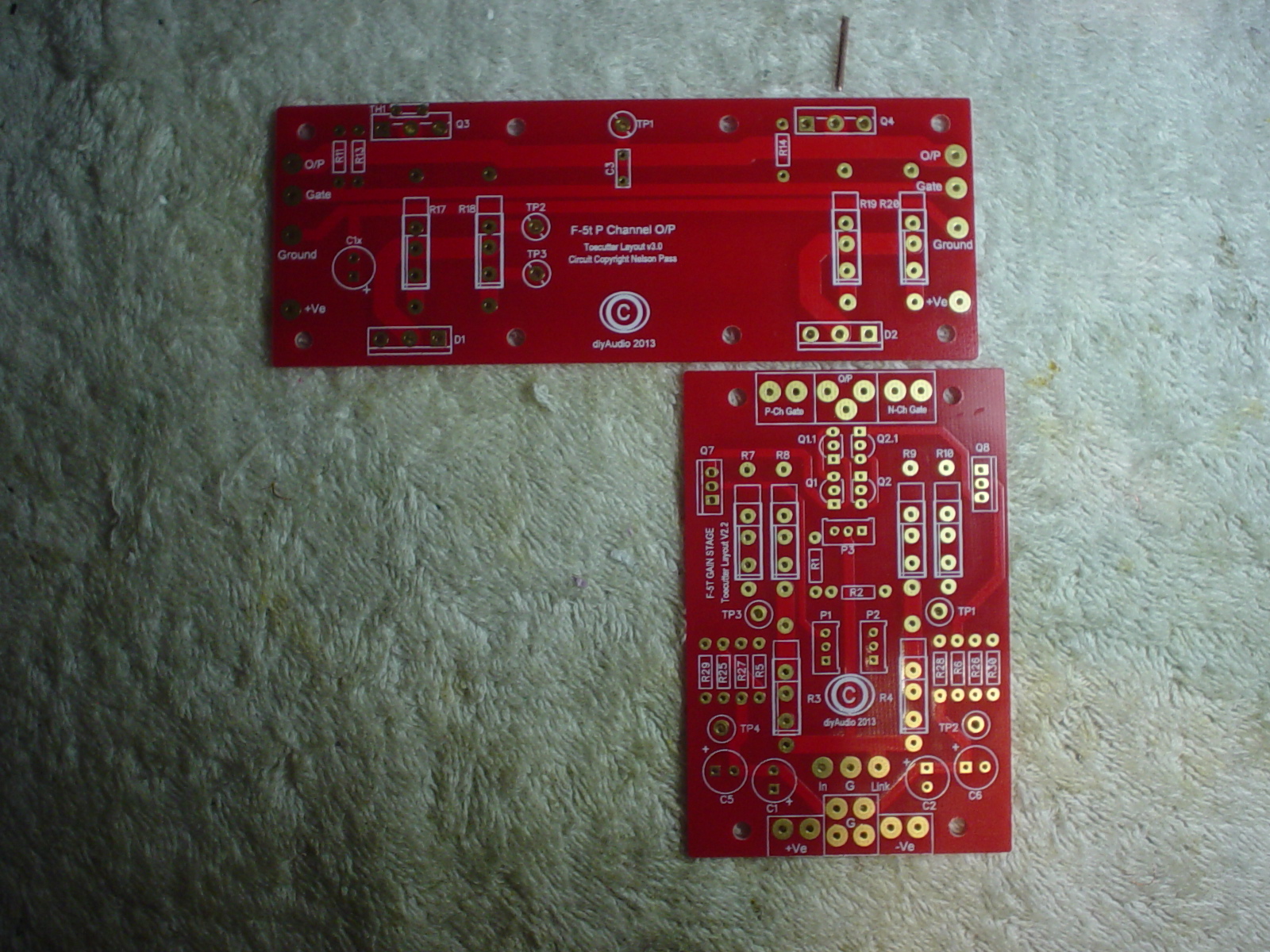

Problem with new version F5-T boards
I received my DIY store boards yesterday. These are the latest version.
I find that I can barely insert a 18AWG stranded wire into the V+, V_, G, O/P and Gate holes. Looks like they have drilled these holes smaller than on the previous version since both you and Dazed2 have reported that they fitted larger diameter wire thru them. The hole size is 1.2mm which is inadequately small. The wire holes are actually smaller than the Mosfet (Q4 in the pic) holes (1.6mm) and the test point holes. The small piece of wire in the pic is 14AWG solid wire for reference. This just fits in the Mosfet holes. Doesn't make sense to me.
To illustrate my point further, take a look at the store F-5 clone boards. The V+, V- and Output holes are larger than the Mosfet Q3, Q4 mounting holes and appear to be around 2.0mm. This is the way it should be.
Has anyone else received the latest version of the store boards and has the same issue? Are these boards defective?
Nash

Nash:
I suspect the hole sizes on the new F5T pcbs are the same as the version I used. To make a good connection using stranded 14 gauge wire, I cut away just enough of the strands to allow those that would fit through the holes to do so. The strands that were cut shorter were all cut to the same length, so they ended up "kissing" the top surface of the solder pad. I soldered the longer strands on the rear side of the pcb and added solder on the top side as well, so the shorter strands would be contained and connected to the solder pad.
Scott
Scott
Nash:
Scott
Scott,
If you look at pics of the older version and the latest you can clearly see the reduction in hole size. In the version I believe you used, you could easily get 16AWG stranded wire in and with some trimming a 14AWG stranded as you have done. If this is incorrect please let me know. What is the version # silkscreened on your boards? In the latest version you can just about get a 18AWG stranded in. That is the problem. Otherwise the boards look good.
Any luck sorting out the "thinness" in sound you complained about?
Nash (Southern NJ)
