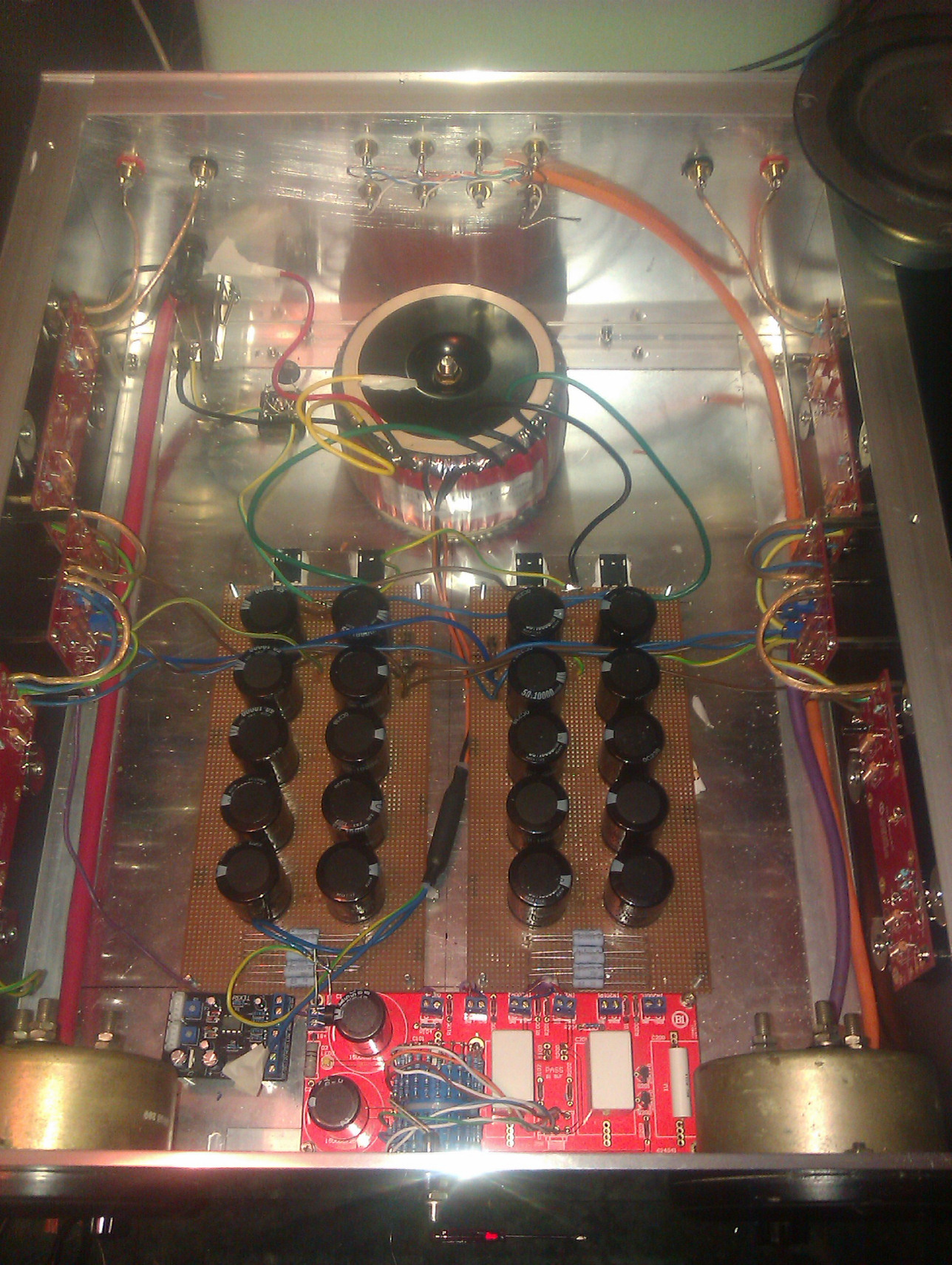

Your trafo; does it have center-tapped or separate secondaries? From the pic it looks like center-tapped, just want to make sure from you.
Also, your PSU boards: is it CRC? Because it looks weird since the R is on one side of the caps.
Another thing: your transformer looks a bit on the wee side. What is the VA rating?

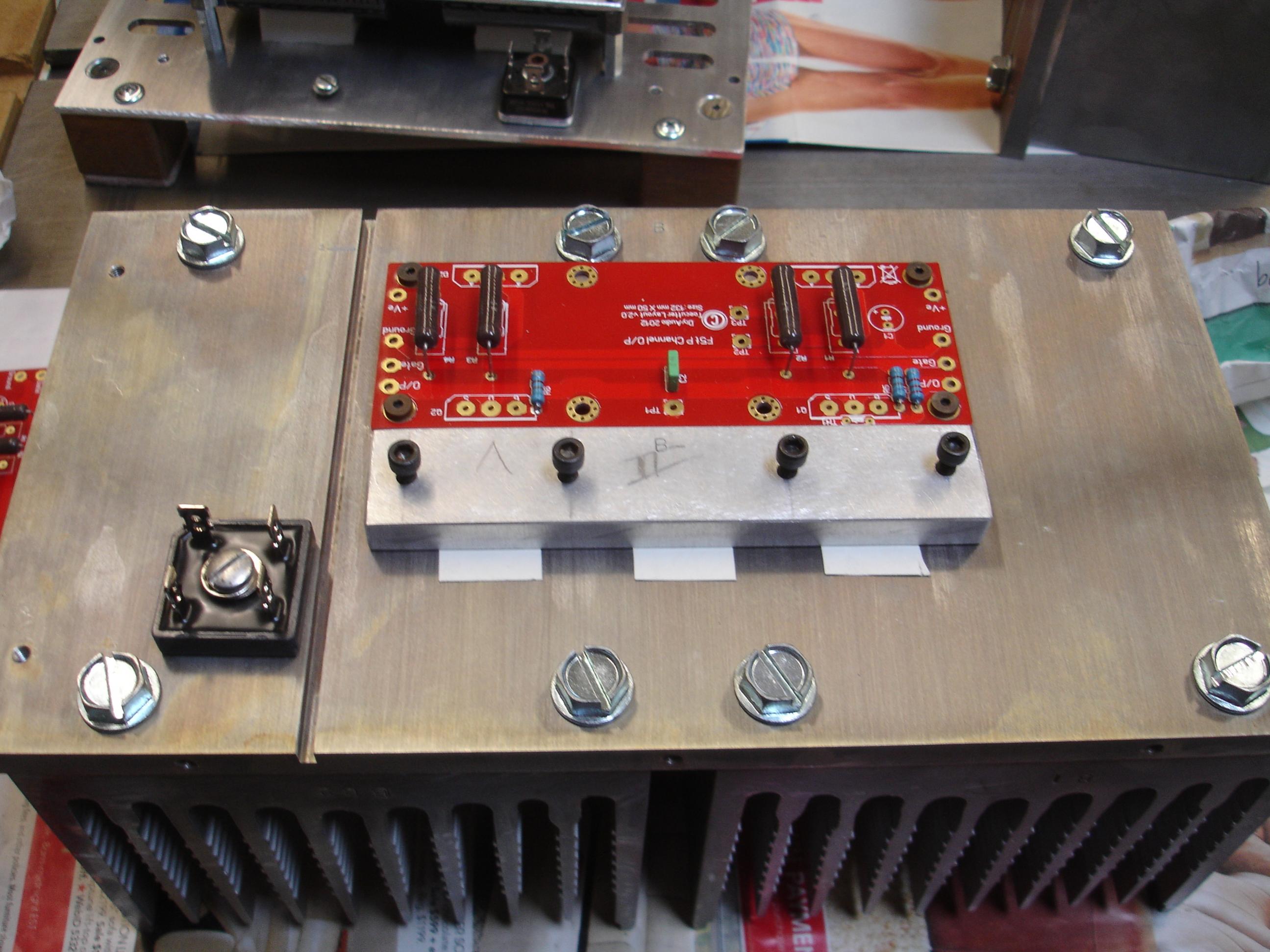

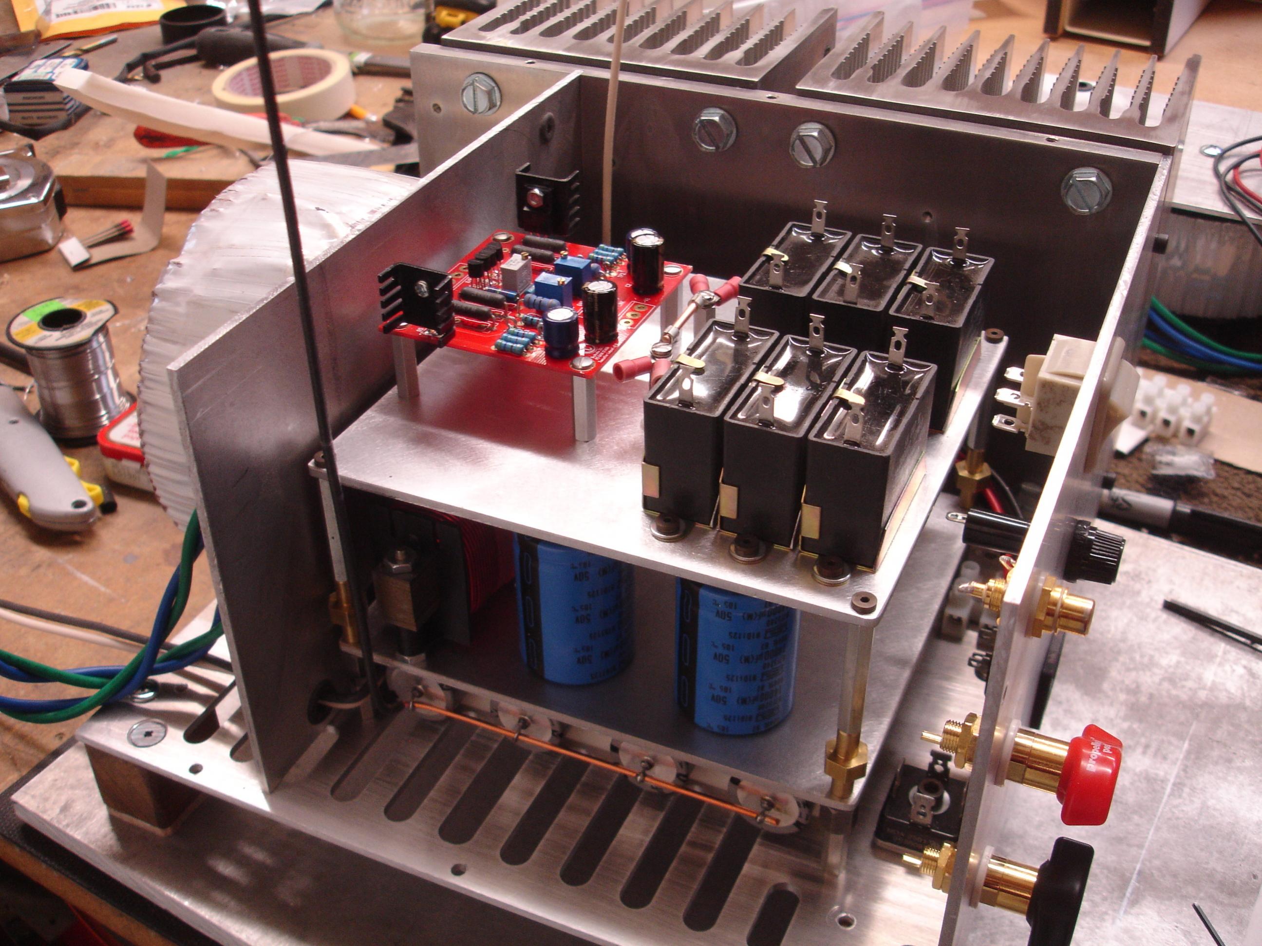

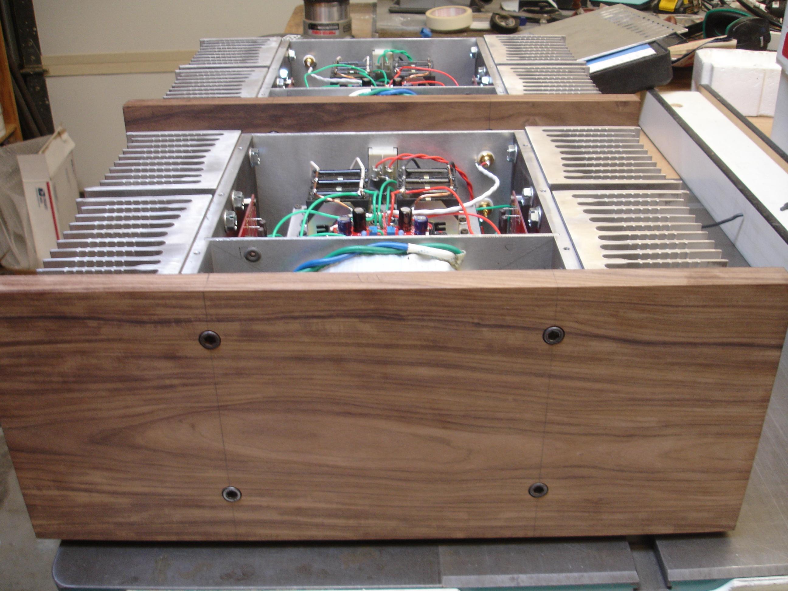

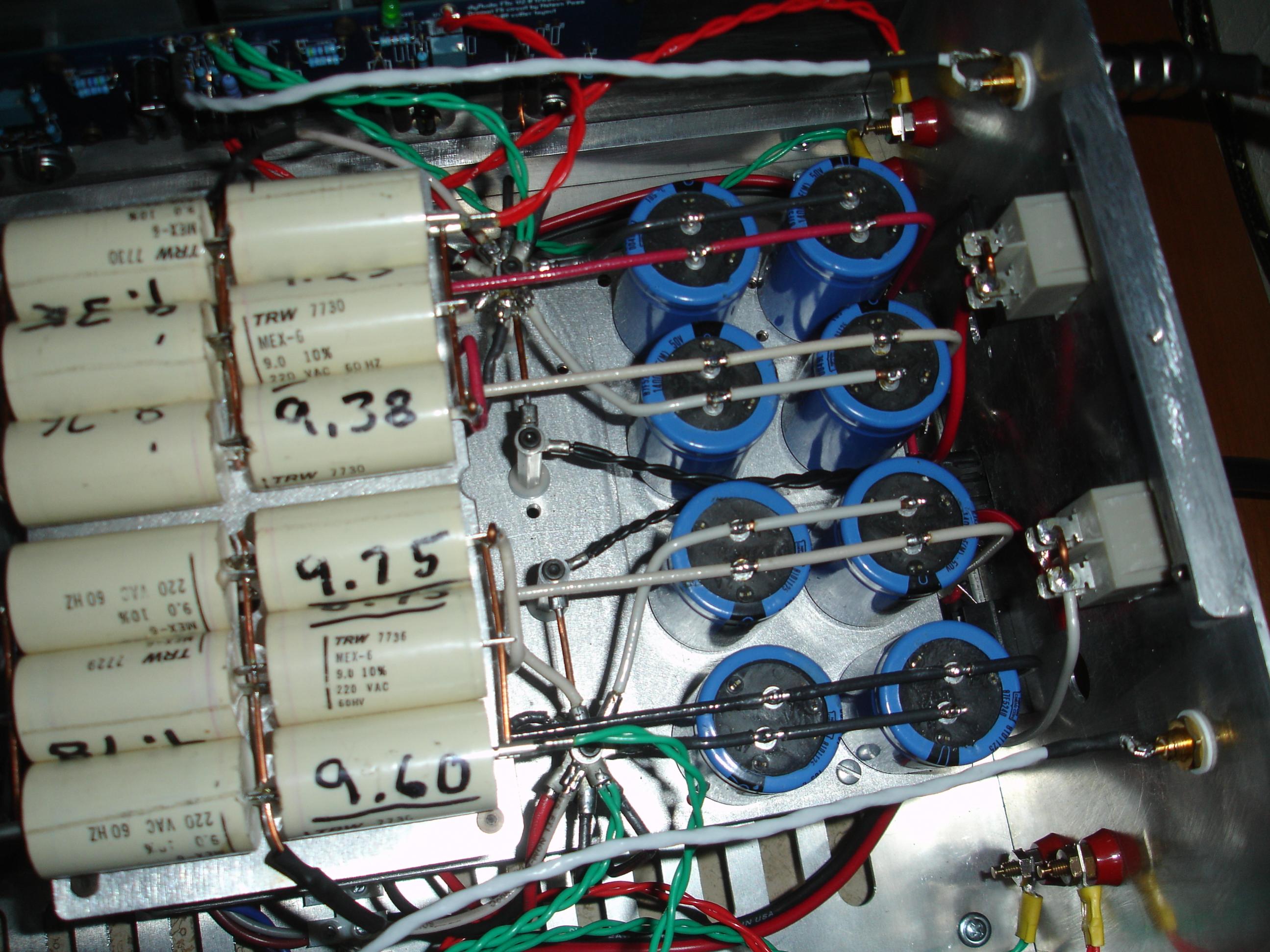

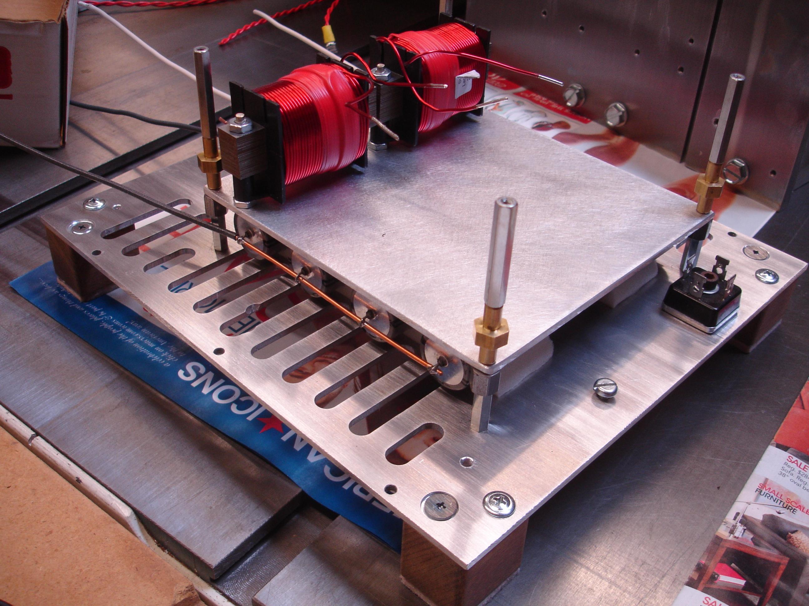

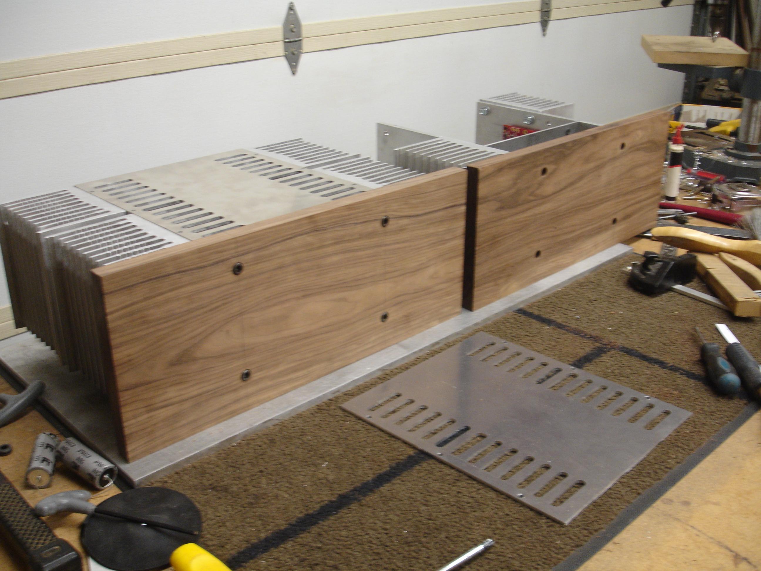

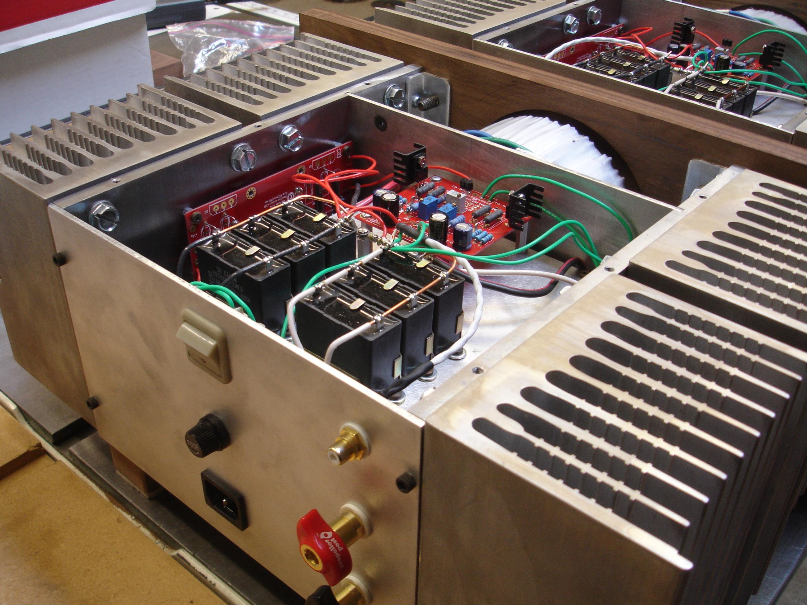

Last week I completed the F5T project that I have been working for a good friend.
After he heard my F5T he wanted one so I built him one. He wanted mono amps.
what a pain he is sometimes but as it worked out these turned out quit well as they are dead quiet. These are have Toshiba outputs biased at .6 mv over a 1/2 ohm Resistor. and run quit cool. I ran a wire from the lower caps before the inductors to the main ground and grounded the remaining caps at the same point along with all other grounds. I also reworked my amp (fairchild outputs) to a mono configuration and star ground here are some pix. I put the store boards upside down as this put the mosfets in a more appropriate place.My amp is now dead quiet too.
