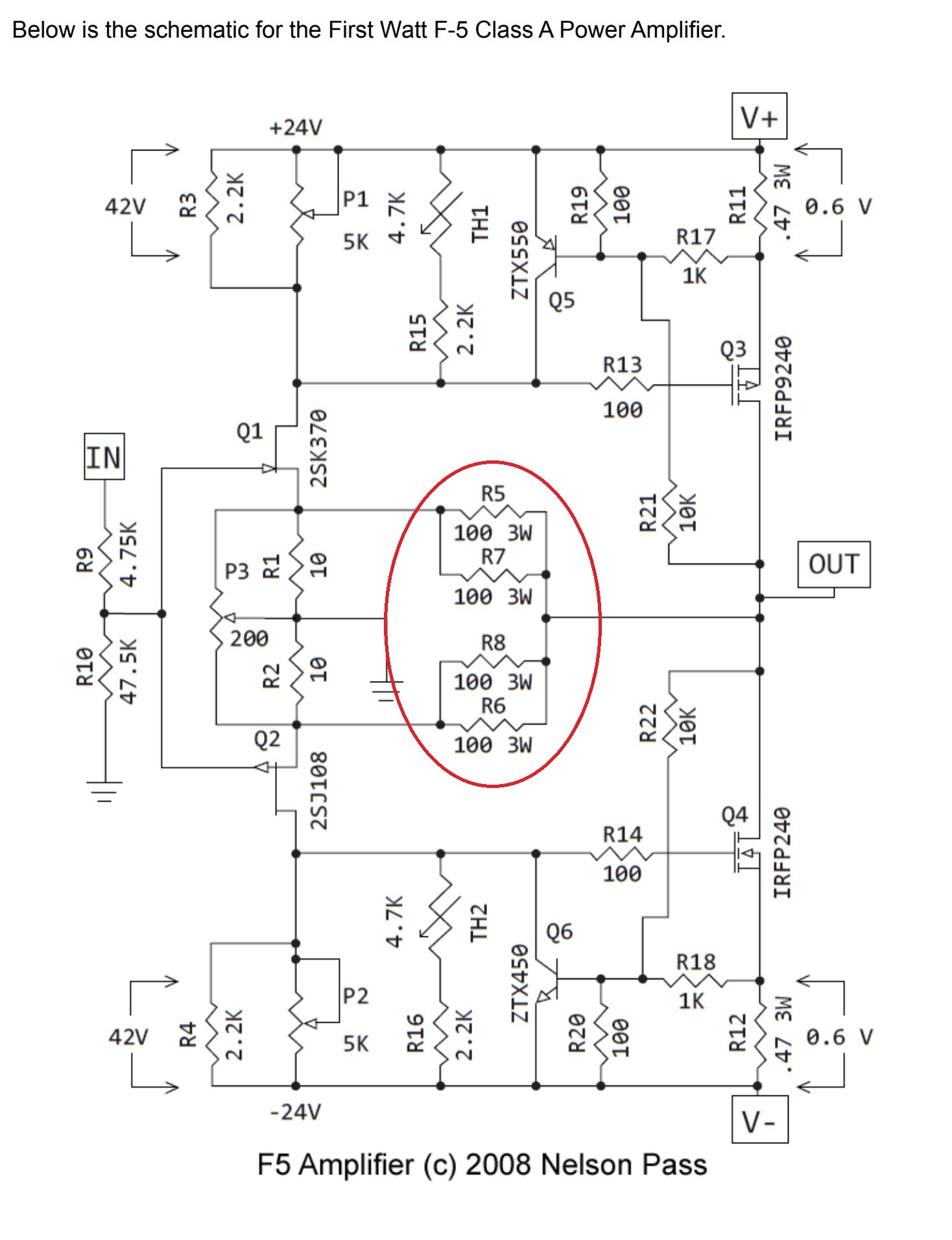

Again, Eh, Not that simple
I replaced all the semi conductors, (pull of two miniature eyelet at the J Fets, Fix it under a magnifying glass)
measured all the resistors accept the two 5W type. 😡😡😢😢
I mounted into the smaller test model set it up all DMM and no bias at all.
Again the same issue.
I pull it a part and now to found out one of the Fukushima R 0.22 5W resistor is open without any burned mark.
I will replace that soon let see, fingers cross.
It is a very simple, little amp giving me so much trouble!

PROBLEM solved, now I have bias, I set it up 900mA at 19V rail voltage. I will let it warm up an hour or so, so the bias settles down.
At least electrically working, later some listening tests.
Very likely all the removed semis are all good and this 5W resistor was the problem from the start.

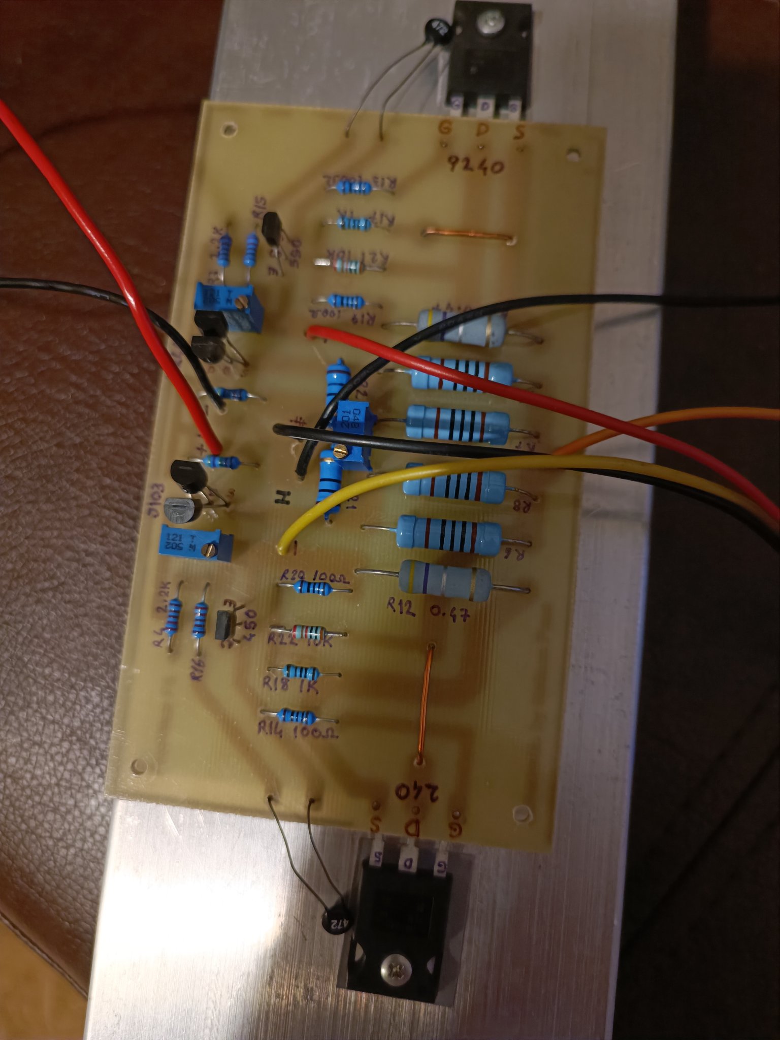

Hello,
I finished making it a long time ago but it was waiting due to jfet pairing.
I measured 0.65v on R11 and R12, but even if I reduce it to 0.4v on p1 and p2, they are still very hot. Right now I gave 19v for testing. I'm afraid it would burn if I used it for 24v testing.
I measured 0.6v from the speaker output at idle
Sorry for my english 🙂 Thank you for your help.

Short the inputs to your F5 and adjust P1/P2 so that the dc output (ie. the dc offset) is as close to zero as you can. Doesn't matter if the voltages across R11 and R12 aren't quite equal. The important thing is for an bias current level, you always want the DC offset to be close to zero. Anything less than 50mV in magnitude is acceptable, though the lower the better.
What voltages do you see across the resistors R5/R6/R7/R8?
After sorting out any voltage offset, a temperature reading of the resistors would be a logical next step.
Hello again,
I reset p1 and p2 by turning them counterclockwise. I tried to adjust p1 and p2 by watching R11 and R12 and I saw that my voltage fell below 18 volts. I stopped the adjustment. I decided to install another 25v power circuit for healthy adjustment.
It showed R11 0.25v and R12 0.20v. I was going to continue adjusting where I left off. At that moment, a smell spread in the room, I immediately pulled the power plug, it smells like a burnt resistor, but nothing can be seen in the image for now.
I need to do detailed research 🙁

If voltage drop across R11 and R12 are low (low output mosfet current) and yet the power supply voltage sagged, the current must have taken a different route, perhaps through the input jfets.
You mentioned that you had doubled the jfets, and the amplifier board does not look like the diyAudio pcb. So the jfet circuit needs to be checked and the pcb needs to be checked to be sure that it conforms to the schematic. The schematic for the modified jfet circuit needs to be checked too.
As for the power supply current draw, the voltage across R5/R7, R6/R8 that Dennis asked for and also the voltage across R1 and R2 would tell if too much current is going through the jfet circuit.
As Ben mentioned, please verify the PCB design vs the schematics.
A couple of points: Please check that the output mosfets are electrically well insulated from the heatsink. I can see a silpad on the lower mosfet but the for upper one (lebelled 9240) it isn't very clear. Also I cannot see any standoffs holding up the board so please check that there is adequate spacing between the PCB and the heatsink, and that no component might be accidentally touching the heatsink. Please ensure also the mosfets are well tighted. BTW, it's often recommended that a metal washer be placed between the screw and the mosfet.
For a quick check of the insulation of the heatsink to mosfet, you can measure the resistance between the drain pin (centre pin) and the heatsink. They should not show any connection (infinite resistance)
Can you share the details of your power supplies? Are they able to give +/- 25V volts (or so) without a load?
