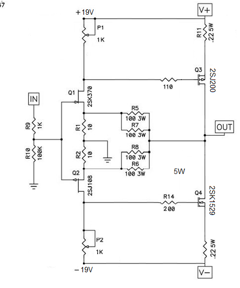

Today I hocked up an F5 with Toshiba power mosfets and 2SK170BL & 2SJ74BL based on Zen Mod circuit.
I used 0.22 5W power resistors instead of 0.1 10W, that what I had at hand. (??) Zen should I change those?

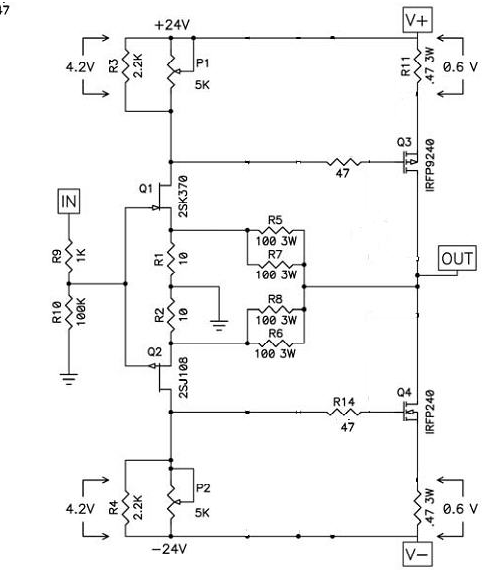

Sorry Zen I do not find you Shematics. It is similar to this but a bit different. had 0.1 10W resistors.
I Just see that schematic 1 or 2 days a go. The F5m.

I re-draw the circuit just as it is now.
Unfortunately I forget to save yours and the one I posted previously just was close to that but not equal.

One channel (the same was tested previously with lower voltage and with a smaller heatsink) up and biased.
After 1.5 hours later it settle the bias is 1.04 A at 27 VDC rail voltage.
One side connected to the PS only.
After the bias stabilized I thought time to set up the other channel.
Unfortunately it blew the 5A fuse, I used a bigger 8A.
The bias only was like 90 mA for some reason and after a half minute or so the feedback resistors got very warm, started to smoke.
I tried one more time if I adjust the trimmers (I can) but the smoke is there unfortunately. I have to disconnect that channel and check that closely. Maybe change all the semiconductors so on.
Unfortunately I'am not setup with a scope but hard to think about scope when the smoke slowly comes from the feedback resistors.
At both channel both of the trimmers were set up to the same value!
Something fishy there.

When I tried to use the trimmers only one is working, slowly I increased (turn off, adjust and turn back on) the bias to 230mA. After even that trimmer stopped and now I got 0 mA bias.
I removed that side (channel) check everything with a jewelry magnifier all soldering intact, all resistors are good.
Very likely semiconductor(s) faulty.
If I can guess it is the JFet because I got some bias.
Trimmers were measured and both and good.
So I will start replacing all the semiconductors (have some extra at home).
