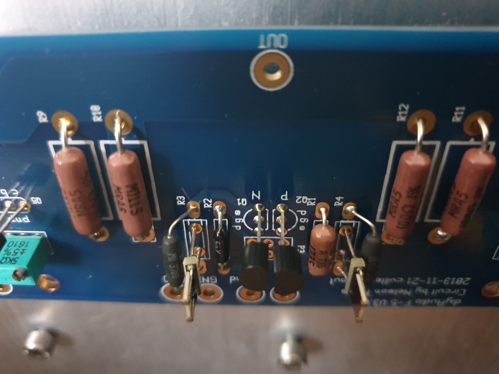

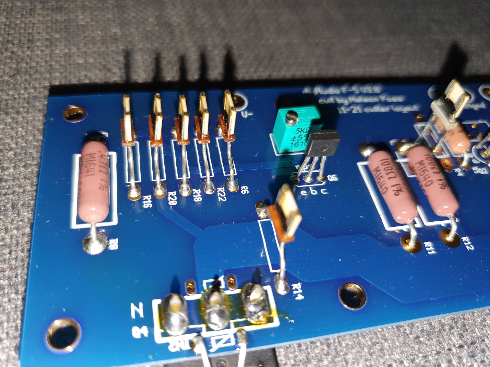

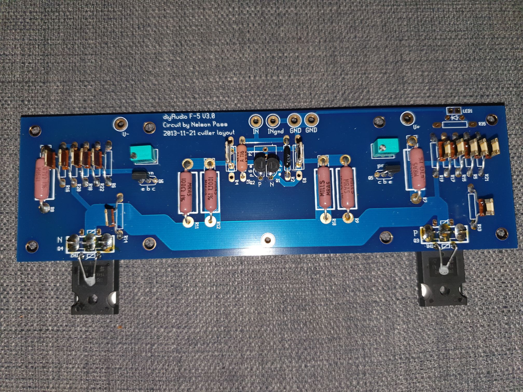

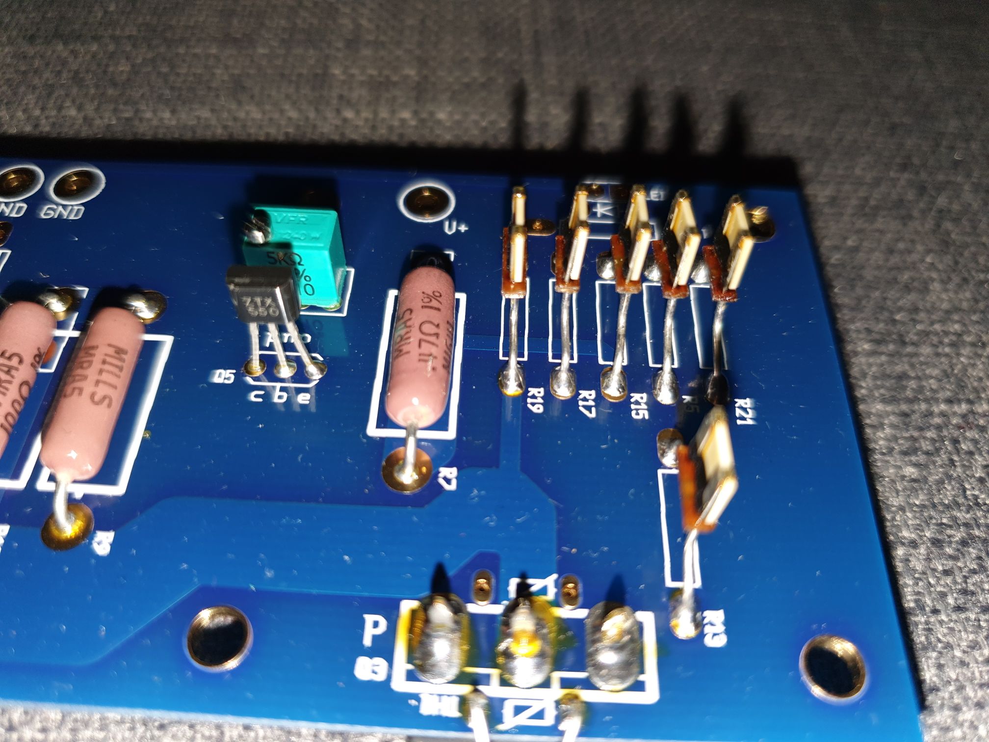

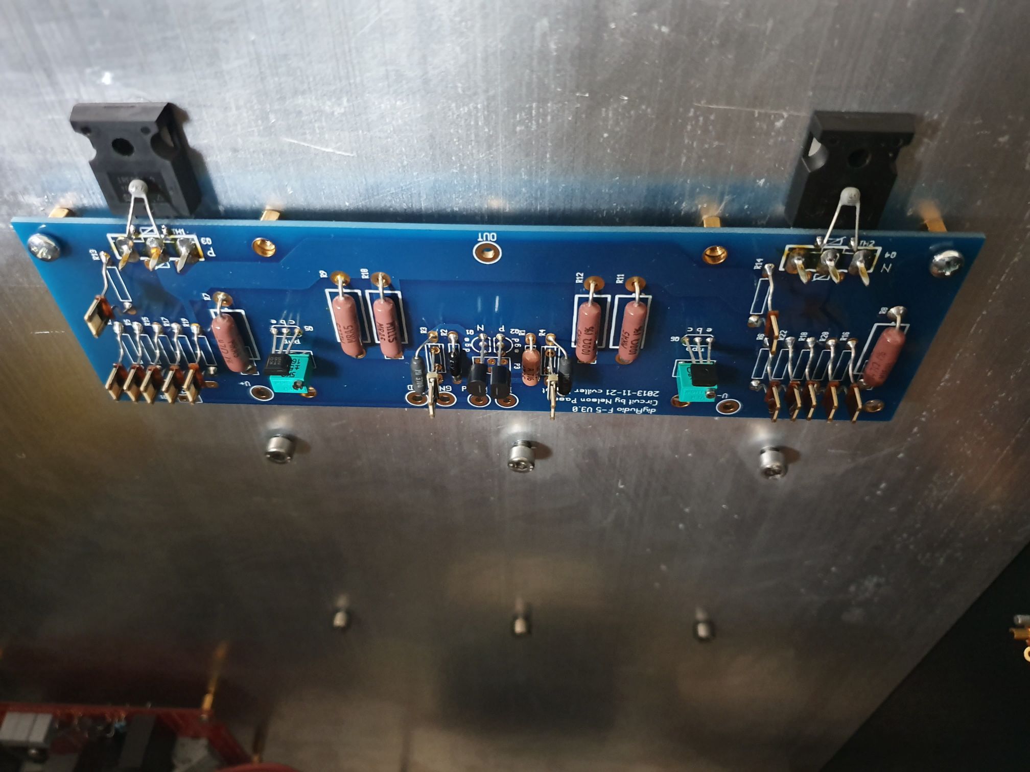

Due to i quit my job Finally i have a time to complete my f5 amplifier. Yesterday i completed soldering and i have few questions and need help. I have v3 board btw. Please see attached pictures.
1. Do i have to solder led and led resistor or can i keep it as blank.
2. Is it fine to use 0.4w rated chardof zfoil 10ohm resistor for r3 and r4. Or i need to desolder and solder minimum 1watt.
3. Q1 N-Channel JFET Input 2SK170
Q2 P-Channel JFET Input 2SJ74
Did i soldered their direction wrong? Currently flat faces touching but i guess round faces should touch?

1) You don't need the LED
2) OK as you have it
3) Looks good. The faces don't have to touch.
The 10 ohm resistor has to handle quite a lot of power. With a 0.4W resistor you want to keep peak dissipation below about 200mW.
Actual possible Pd of part at 20Vp output is exactly 1 watt. Desired rating is therefore about 2W (at 50% Pd the case of the resistor will be between 80 and 100C, and high temperatures shorten part life).
This means with allowable max of 200mW you can have about 9Vp on output, or just about five watts of usable output power. Still enough for a high sensitivity speaker system, but you'll burn that resistor if you push the amp harder.
I've had to repair some DIY implementations that originally used a 1/4w Dale resistor in that position - every single one of them were burnt to a crisp in less than a year. The output MOSFETs and JFETs were toasted, and one poor fellow burned out his woofer coils as well.
The BOM I have recommends 1W for these, and checking mine I have 1/2W in my build. There's no noticeable scorching on them but I ordered some 2W replacements to be safe.

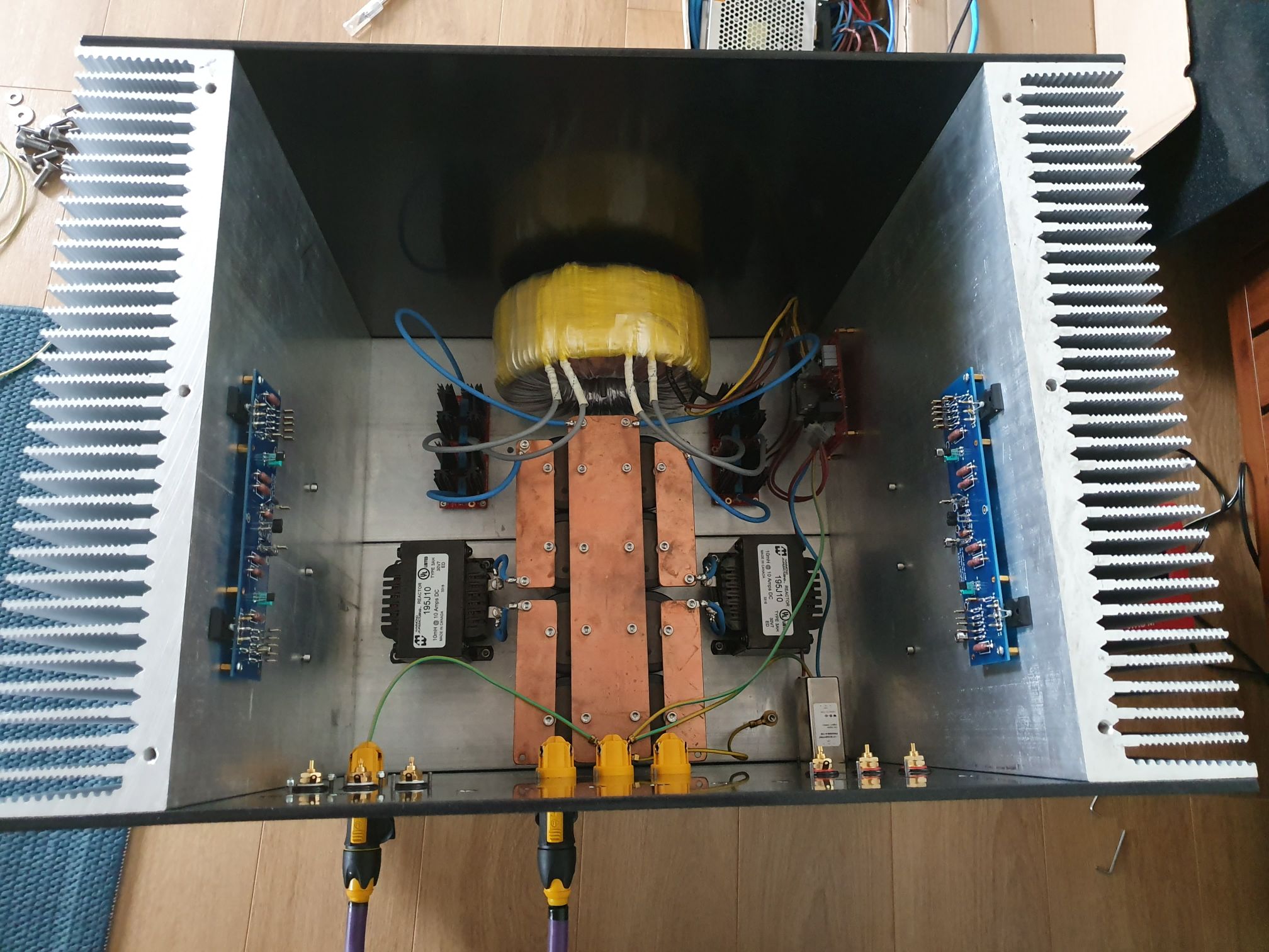

Wow thanks for fast response guys.
I add 1watt ones into free slots as addition.

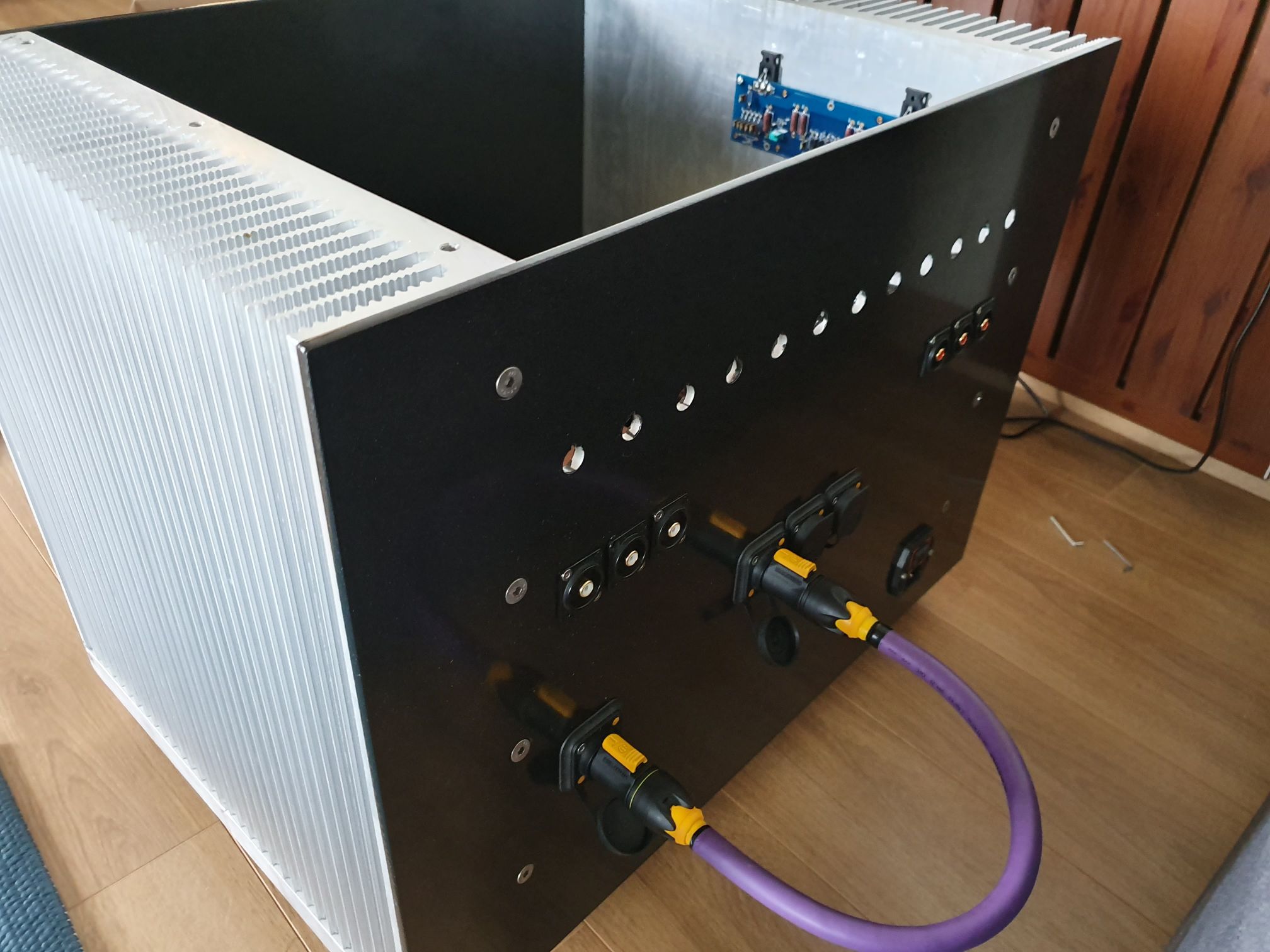

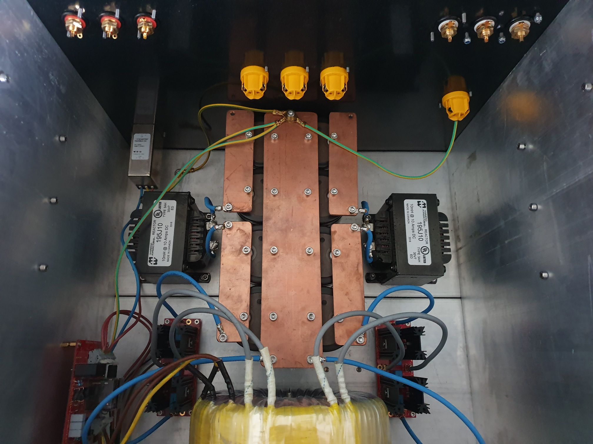

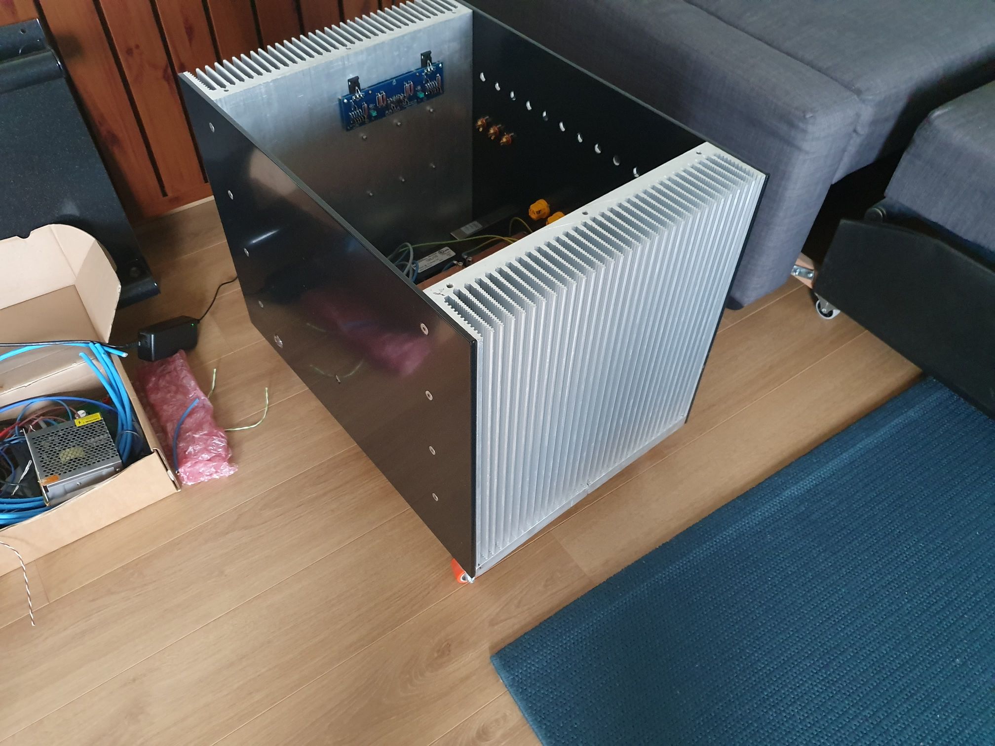

I am planning to put 3 different amplifier in same case so f5 is the first one jhl 2003 will be second (which is ready) and third one i did not decided yet.
I make a fast progress and completed power soft start + CLC. side today. If i have enough time i will complated low voltage cabling tomorrow.
I appreciated if have any comments to improve it.

The parallel ones you have added changes the circuit, ie two 10R in parallel gives 5R resulting in different gain.

Potstip used them in CLC F5. See his pictures.
These can be used on F5 Turbo, or another First Watt type amp.

Adding 10R in parallel at R4 and R3 will result in 5R combined and also the wattage rating will be the same as the lowest rated resistor...so, take out the Z foils at R4 and R3.
Also, you have used your Z foils mostly on the current limiting portion of the amplifier...nothing wrong with that but those resistors will never impact audio quality unless the current limiting activates, which won't sound good anyways.
Critical resistor positions are R1, R3/R4, R13/14 (you have Z foils here) and feedback and source resistors which need 3 watt resistors, so no z foils there.
I was told that low value resistors don't have much impact on the sound quality. Using Z-foils may have no real benefit in this circuit.

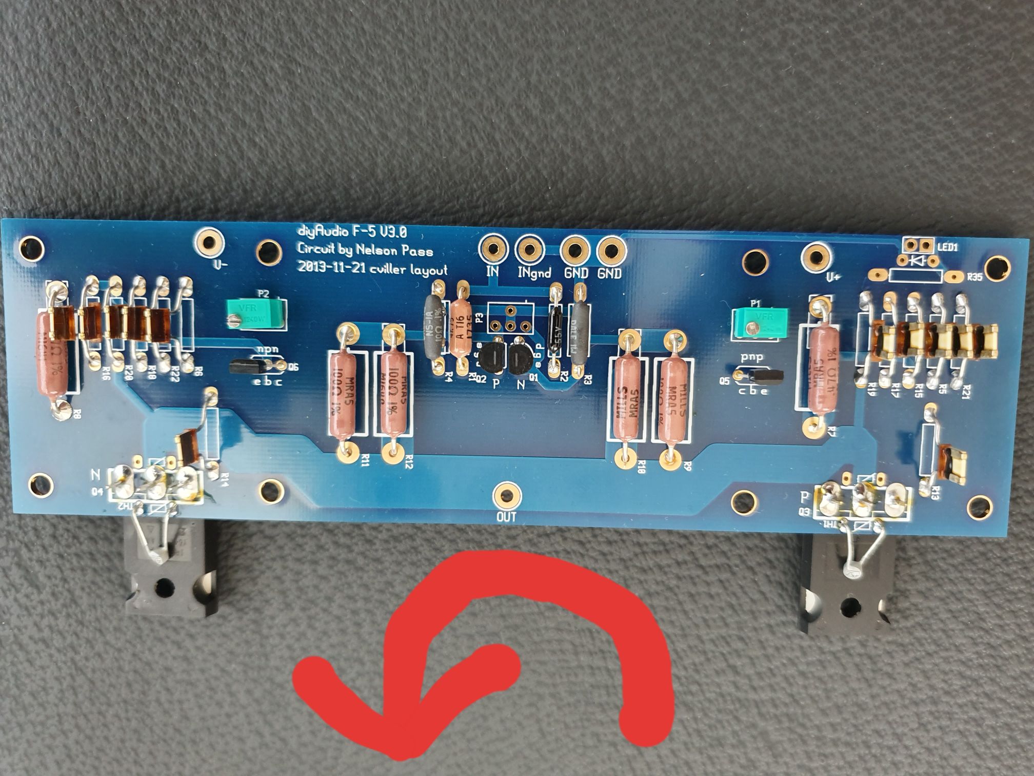

I am planing to bias it today. Bias procedure starts with.
"Please make absolutely sure that all variable resistors P1 and P2 are turned fully counter-clockwise."
But direction is chande depends on which side you look the board. The one that i showed on the picture is correct?
No idea which direction is correct. So what you can do is simply
adjust P1 and P2 so that the measured resistances across R5 and R6
are close to zero.
