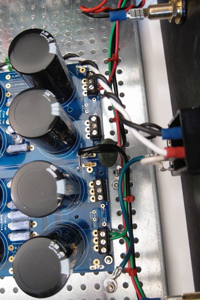

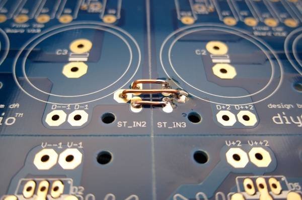

I see the differences on psu PCB . Photos from guide View attachment 733449View attachment 733450
That jumper is in place, it's the black wire on the left.
Bias voltage is a little out of balance, it's .664v and .665v on one channel, .684 and .685 on the other not warmed up. Offset is 1.4mv and 6.7mv.

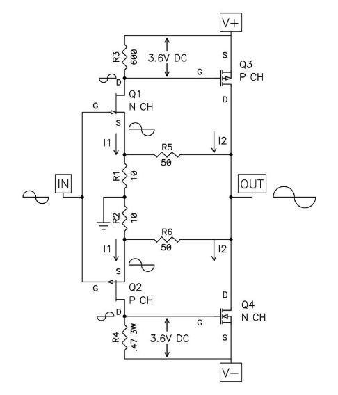

Yes and no. Without potentiometers front he rails to the Jfets, you'll have no way to set operating points and offset. That simplified schematic is only a few parts simpler than the real circuit... might as well make the F5 and use a smaller PSU for your target power output.
