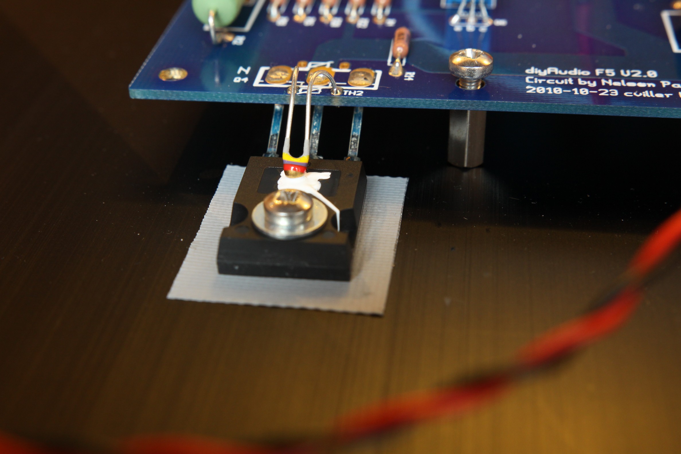

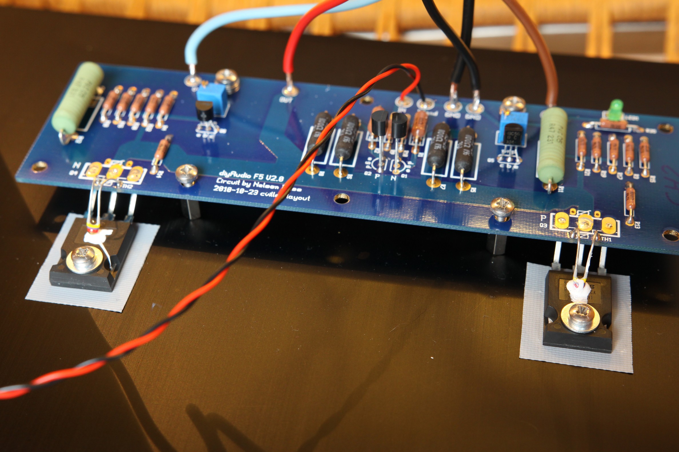

I took some pictures today. They're attatched to this massage.
I tested to reduce the bias to 1A, but it's just the same...

NTCs looks fine ....
what Idss are JFets , and where you bought them ?
what's measured resistance across NTCs , cold , in situ (on pcb) ?

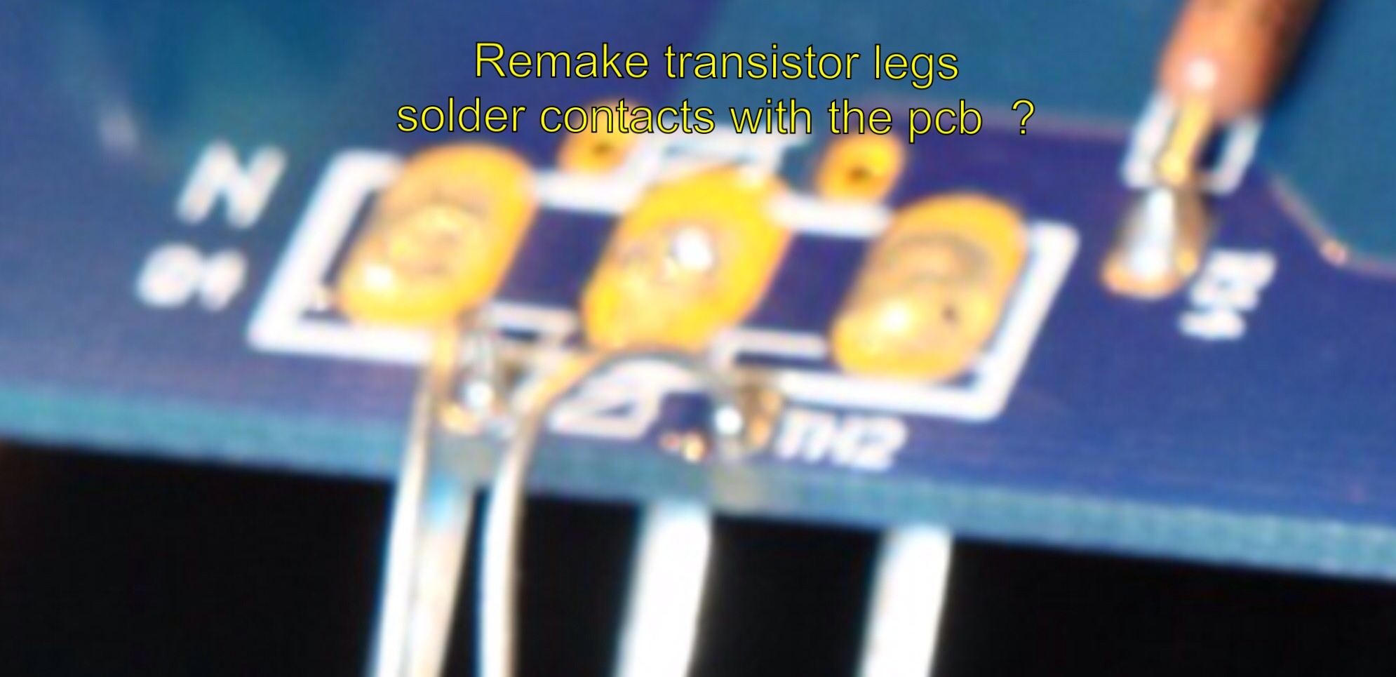

Hi Skroiss....but it's just the same...
Maybe verify and remake if need all solder contacts 🙂
6L6 build guide are the best to see solder quality work.

JFETs are selected to ~6mA. I bought them from an germen distributor (Reichelt Elektronik) years ago. 6mA because I got only 2SK170 BL and 2SJ74 GR. I selected them to ~6mA (P-channel is 5.8mA and N-channel is 6.8mA). But close selection should'nt be necessary in this application.
NTC's resistance in situ is ~1.6k Ohm ... Is it in the expected range?
Hi Skroiss
Greetings
Hi soundhappy,
I learned how to solder professionally. Soldering does'nt look beautiful on the Mos-Fets, but all solder contacts are fine (on the whole board). I drilled the heatsinks against the UMS and the Siliconix IRFP240/IRFP9240 seams to have shorter lags. Therefore creativity was needed😉

1K6 looks too much , with JFets current in range of 5-6mA
1K6x6mA - that gives 9V of initial voltage
even with just 5mA , that's 8V at hand , to brutally open output mosfets
what combo of trimpot-fixed resistors you have there ?
