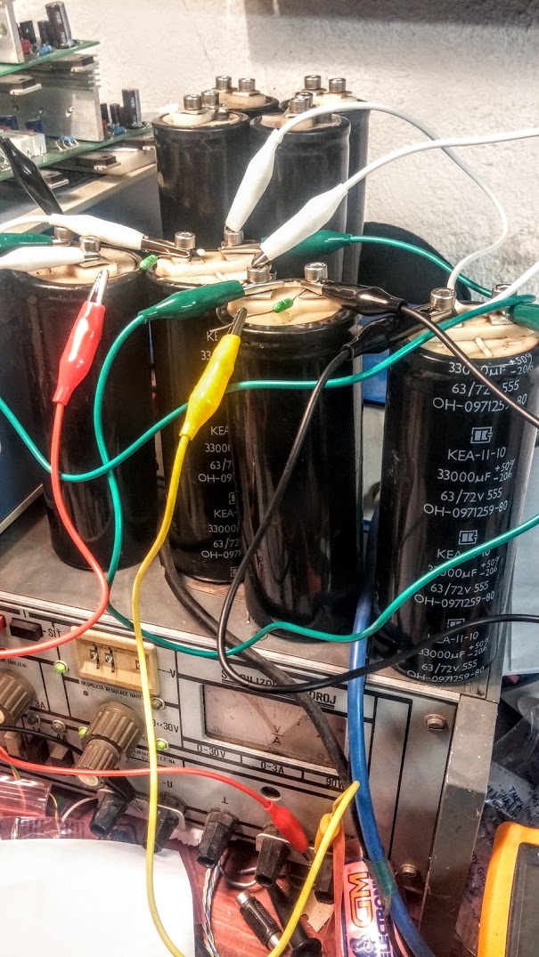

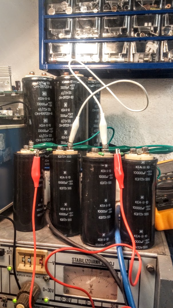

i built F5 not long ago in a standard CRC configuration and was thinking of extending PSU by turning it into CRCLC since i have both inductors (2.2mH EI cored transformers) and caps lying around.
Some people i know suggest however that if i can't hear a slightest hum with my 95db speakers it's better if i simply add another row of caps after the PSU, placing them closer to the amps. This will both reduce ripple slightly and benefit amps with more of that last C in PSU which could sometimes improve dynamics/bass as i am told...
So if anyone tried various PSUs with F5 - is adding 4 inductors to get additional LC worth the effort? Or is it mosly the added C i'll hear the most (if)?
Right now i have dual mono 15000-0.1R-22000 /rail (74000uF per channel). Standard F5 at 26V, 1.4A. Under 200mV of ripple.
