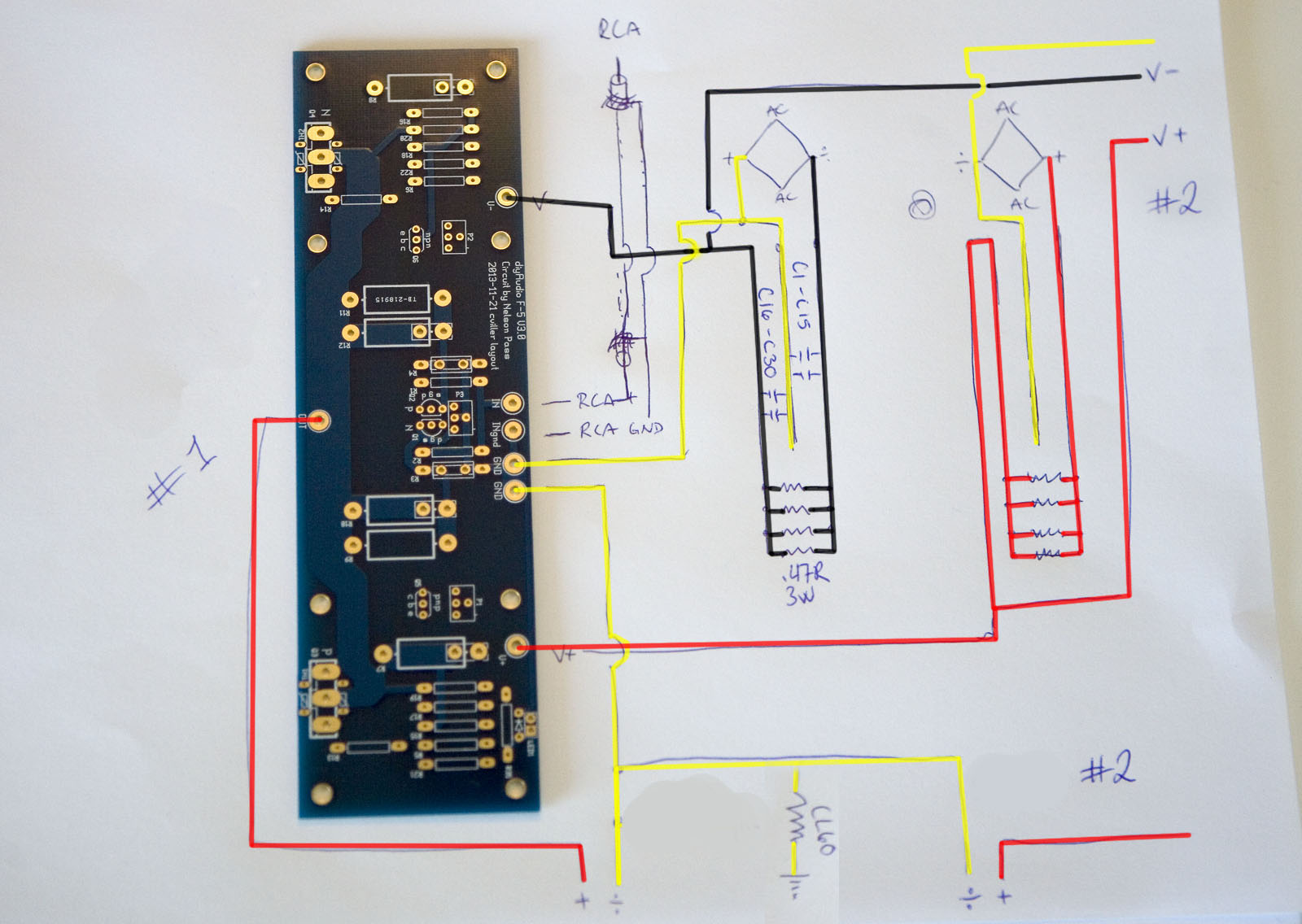

I have highlighted the MAG in yellow shown on the attached image. Hope this is more understandable. If its dubious let me know! 🙂

Are the yellow 0V of + and - psu boards connected? Drawing does not show it and suggests that channel 2 has speaker - connected to gnd of channel 1.

The voltages and the drawing both look suspect.
The two rectifiers are not shown as being joined together to create the ground at all. To have a split rail supply You need a common point, it seems that this is not present in your drawing.
Can you confirm this?
Also, look at the F5 manual and use the exact same nodes for voltage readings. Replace the voltages with you actual measurements and then we can see the issue.
You may need to dial up the bias pots a bit on the non-working channel to get some measurements...
Not directly to each other, I believe they are connected via PCB GND/speaker negative terminals.
Rectifier #1 0V is connected to PCB 1 GND
Rectifier #2 0V is connected to PCB 2 GND
GND of PCB 1 connect to speaker negative terminal 1
GND of PCB 2 connect to speaker negative terminal 2
Negative terminal 1 & 2 are brigded and terminated to chassis gnd after the CL60 thermistor.
If 0V on rectifier 1 & 2 was directly connected would it not create a ground loop if the rest of the wiring was kept intact?
I initially missed your reply, my apologies.
I have made a new drawing showing the current wiring configuration.
I believe the common PSU point is made where the two speaker negative terminals bridge, sharing a CL60 connected to chassis GND. If this is a poor way to achieve Audio GND let me know.
Both boards read 52,4V (under no load, both channels off) over their V+/V- terminals. Both boards have played music. In other words the PSU works and have GND? Yet I have 3x 2SK170's that are blown and likely a 4th after one board went to zero when cooking a week ago. (all 2SJ74 prior to this checks OK)
It occured to me that the current bridged negative outlets could cause trouble if one side goes bad, inserting voltage over negative outlet on the good side?

PSU power to PCB:
the return current from one PCB does not follow the route of the Flow current.
The three wires of the dual polarity power supply must arrive as a close coupled (or twisted) triplet and then connected to the PCB solder pads.
PCB to Speaker:
The two wires of the Flow and Return from PCB to the speaker must be a close coupled (or twisted) pair.
Then repeat this wiring arrangement for the other channel.
When you do the triplet to BOTH PCBs you will find that the Zero Volts provides the near zero ohms connection between the two channels. This is your first and compulsory PCB to PCB ground link.
There must not be any other near zero ohms ground links between the channels.
The inputs will have a remote link between the Sources signal grounds. Use D.Joffe solution of inserting a resistance to attenuate the loop current below audibility.
Your diagram does not follow that !

PSU power to PCB:
1 - The three wires of the dual polarity power supply must arrive as a close coupled (or twisted) triplet and then connected to the PCB solder pads.
2 - PCB to Speaker:
3 - Then repeat this wiring arrangement for the other channel.
4 -Your diagram does not follow that !

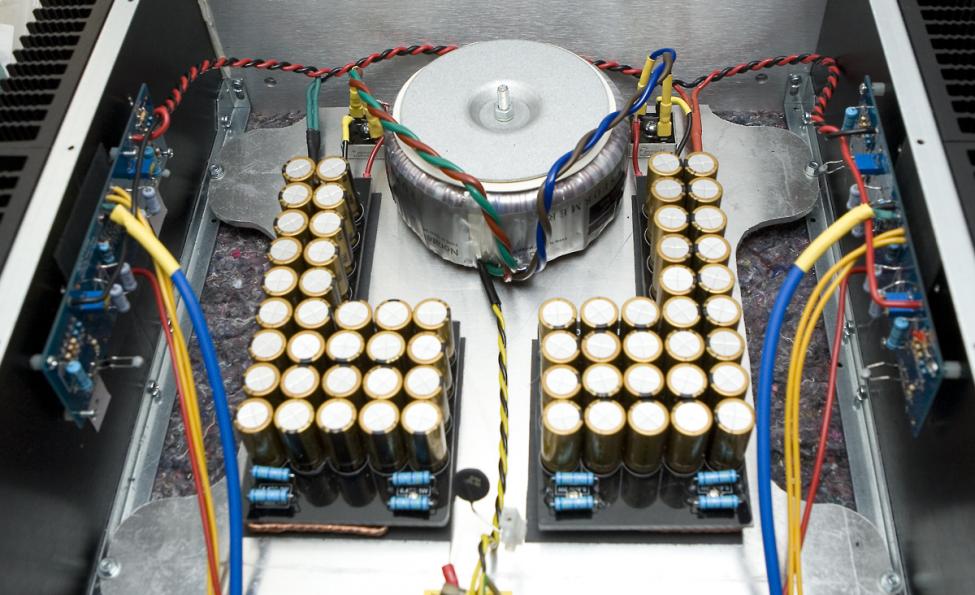

1-3 : The attached image show the internals, the PSU 0V is not showing twisted in this image but it is, following the PSU V+/V- wires.
4 - So I would be much better off eliminating the bridge between negative outlet and rather join 0V directly between the two cap banks? And connect with Chassis GND using a CL60 in series?
All the speaker current is running through the PCB, not good practice, high current pulses can damage the track.
The two rectifiers each feed a bank of capacitors, the farthest 'end' capacitor on each bank should be linked together to create the common ground point (yellow connections on your drawing), this common ground is where the speakers return should be connected, the ground connection from the amp PCB's are also connected here, plus the CL60 link to chassis earth; connect the input ground to the PCB.
