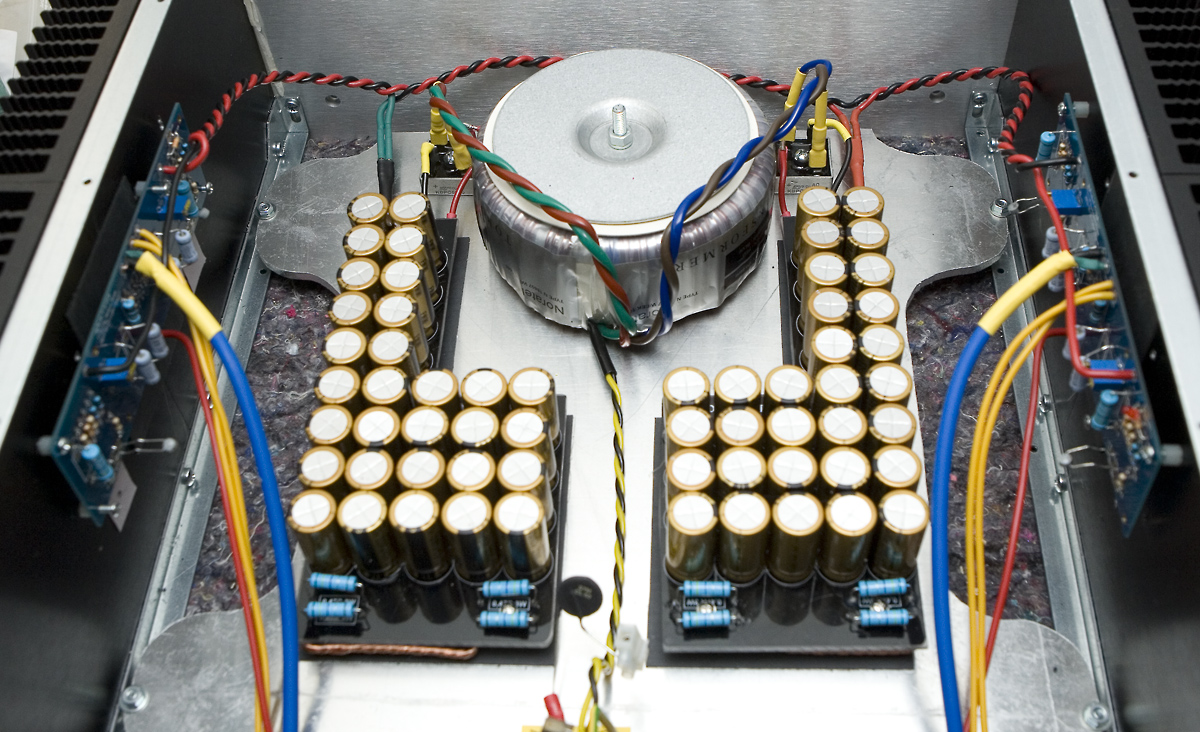

Mine is built as a stereo amp with one toroid.

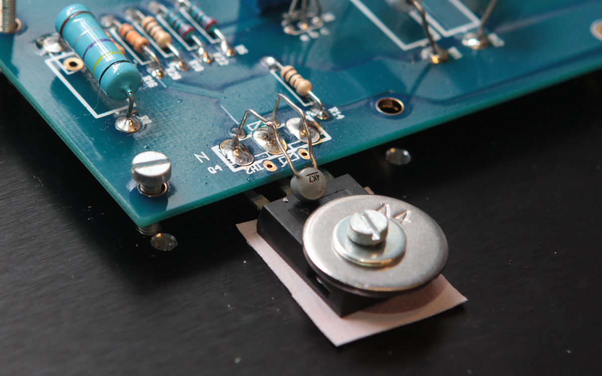

Could this problem be due to bad / discontinuous thermal contact of the thermistor(s) with the mosfet after the first thermal cycle?
Beyond my knowledge, but I know many build without those thermistors and safety circuit altogether without problem...unless there outputs get shorted! I've always included them myself...

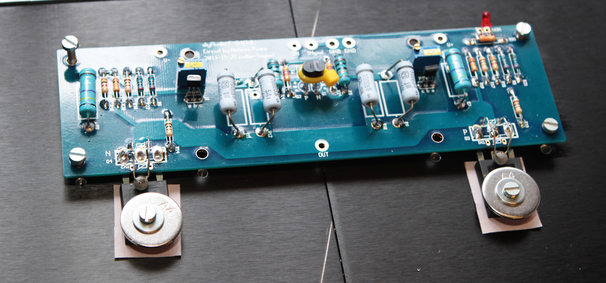

Long story short:
First time both sides biased easily enough, both sides played music. Both channels went suddenly pop as in immediate change from playing music to outputting a strong hum. Not super loud or anything but far from modest. This hum would be present with only the F5 connected, no inputs or anything (it was quiet prior)
Both Q1 (2SK170) was toast, no other damaged components found.
Second time, both channels repopulated with new and genuine Q1-Q6 using Harris IRFP´s for Q3-4.
First channel biased nicely, second was troublesome and at one stage R3 smoked and Q1 was confirmed dead during autopsy. Both played music prior (ruling out wrong placement of parts)
3rd time, dead channel repaired with new R3 and Q1. Intial bias went smoothly and numbers were fine, brought up to same bias level as the good side.
Good side was reconnected (have always biased the amps individually)
Both amps fired up fine, bias identical (0.575V) with offset=0 over both outputs
Previous bad amp was now cold after left to cook for an hr, bias read=0 and offset 0,030-something mV, and fluctuating +/- 25 or so mV.
Thermistors (TH) are in place and in direct contact with the mosfets.

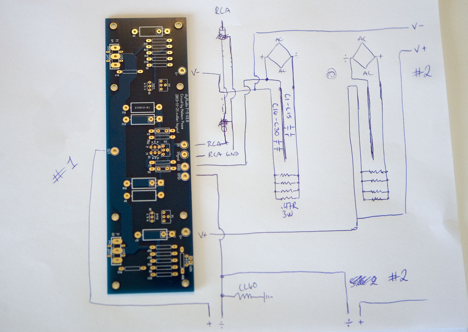

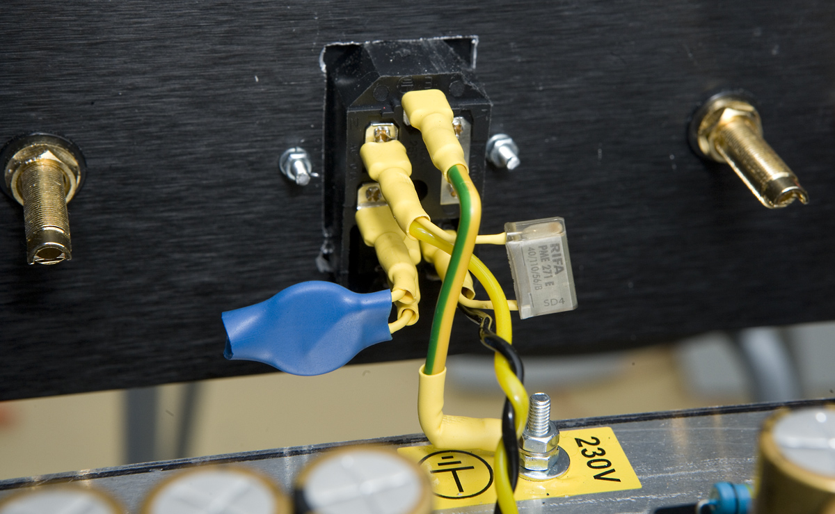

Both negative speaker outputs share connection to chassis GND with a CL60 in series. Both negative terminals are connected to Audio GND1. Audio GND2 is connected to rectifier.

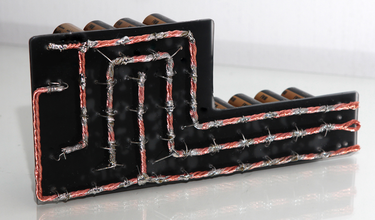

Could the DC off the cap bank be insufficiently stable/excessive ripple? I use CRC as per Pass schematic. At no load the PSU provide +/-26,2V and with one amp running its down to 49,something measured over the V+/V- input.
I do not expect "you" to fix this, I hope to be able to sort this out and learn more in the process. But I am on the deep end as far as know-how is concerned so any input/thoughts are appreciated 🙂
Next step at my end is to remove Q1 and test it. In parallel I will probably start fresh with a new board/new components.
Pic of build found below.

Both negative speaker outputs share connection to chassis GND with a CL60 in series. Both negative terminals are connected to Audio GND1. Audio GND2 is connected to rectifier......
clarify
it need to be :
-I'm having audio gnd after the rectifiers,
- negative speaker outputs are connected to respective channel pcb gnd,
-channel pcb gnd is connected to main gnd,
-main gnd is connected to chassis (safety earth-ed) through CL60
