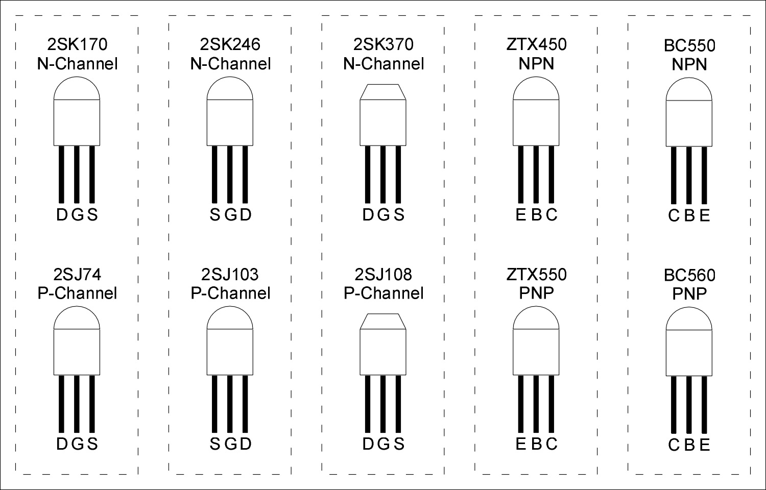

zetex450/550 replacements ?
Hi F5 Builders
I got some BC550 C / 560 C pairs..can i use them for replacements in F5,insted of the zetex450/550 pair ?

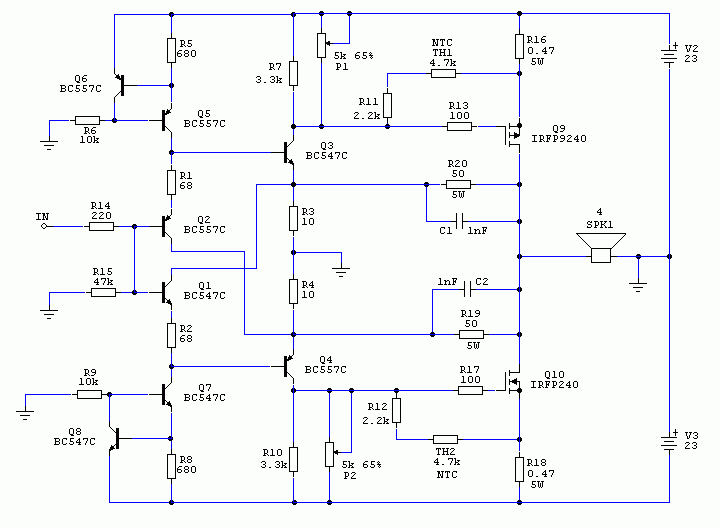

Anyone know a modern replacement for the 2SK170 and 2SJ74?
for the other transistors im using IRFP9240 and IRFP240, is this okay for the MOSFETS?
I can't seem to find any replacement JFETS

Matched K170/J74 will be available in the store soon.

So there isn't anything else I can buy to replace the JFETs?
It's almost comical to realize that many vacuum tube types have superior availability to these JFETs. Ditto for some medium power lateral MOSFETs - Renesas discontinued the 2SJ76/2SK213 types years ago, and there is no really decent substitute for them.

Sure there is - few cheap BJTs will do the job and won't sound worse than JFETs.So there isn't anything else I can buy to replace the JFETs?
Actually, JFETs are replaced by Q3,Q4 (running at 4.5mA). Q1,Q2 make strictly neutral buffer that polarizes Q3,Q4.
Q5-8 make constant current sources for the input stage.
No need to deprive yourself of a good amp for such a trivial reason - lack of JFETs...
