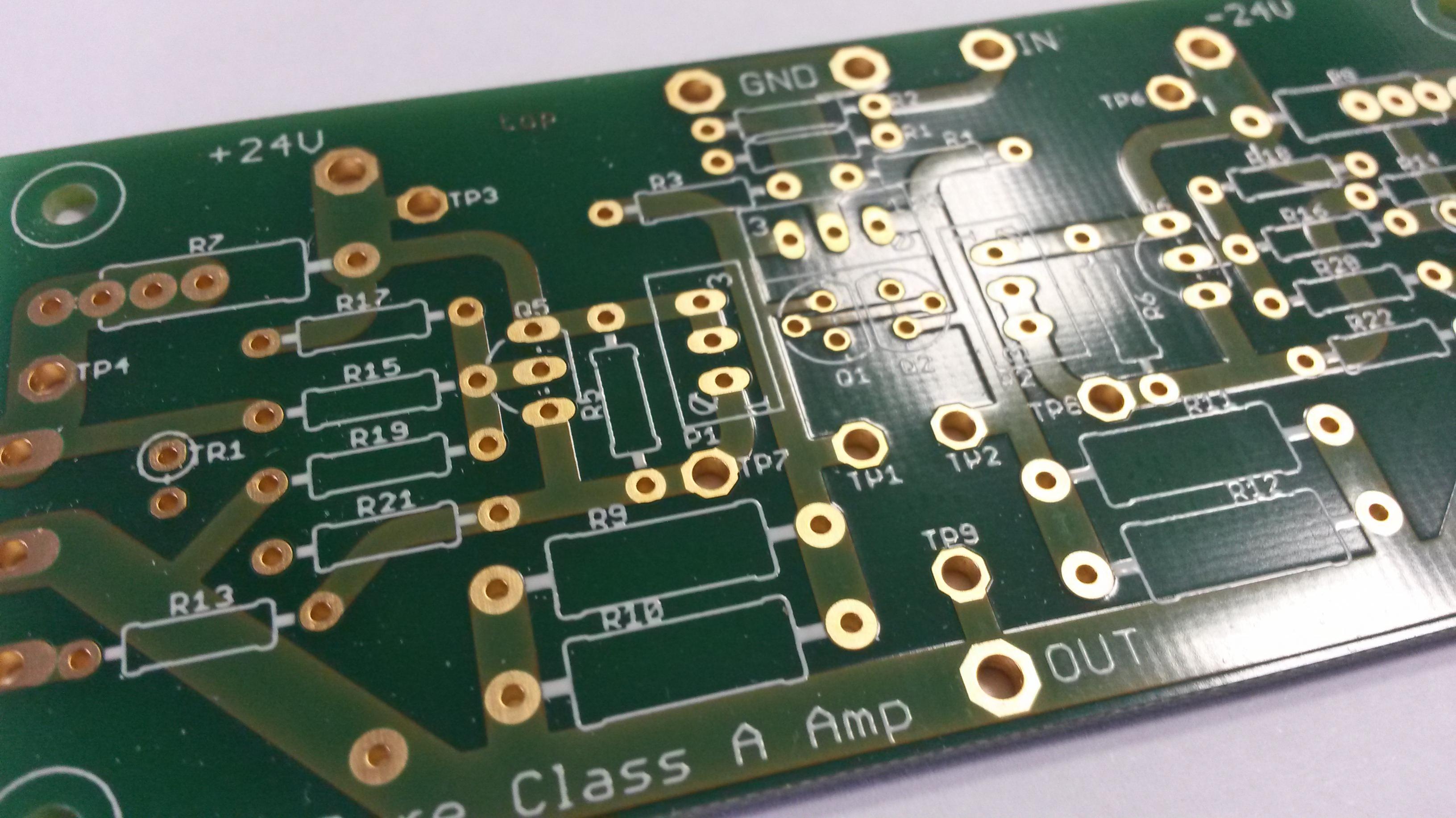

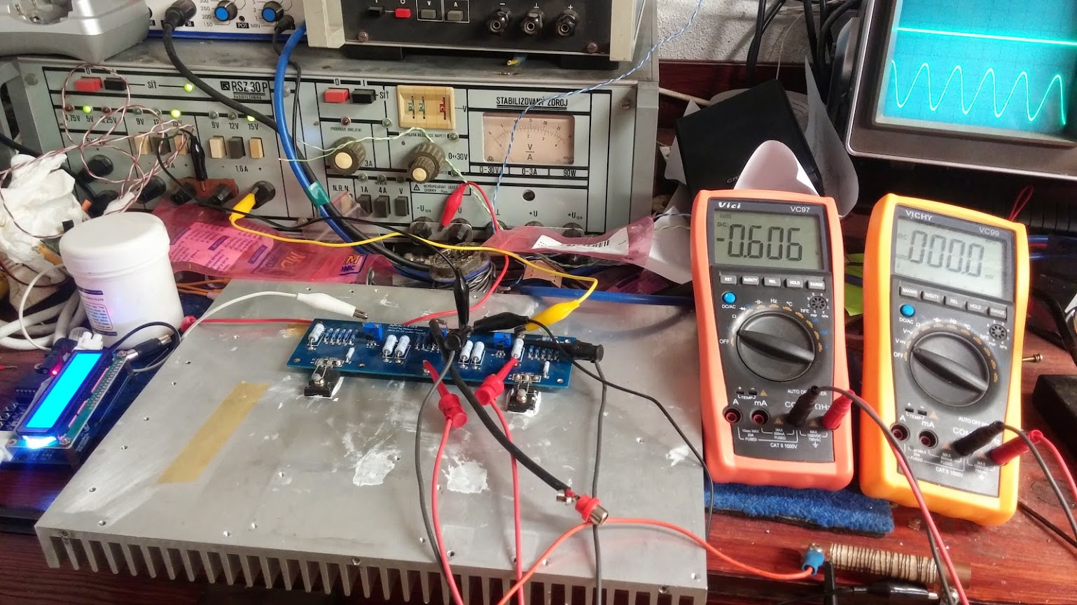

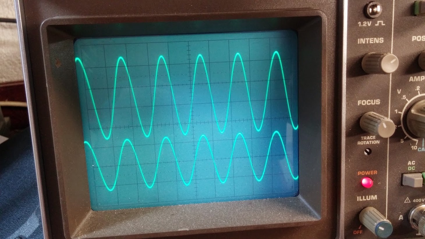

I finally returned to the construction F5.. temporary with no proper PSU...looks good... it working properly :)

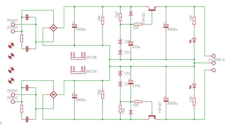

Hi, I have a question. I was wondering if this PSU would work for a standard F5 build. Until now I have had a CRC unregulated PSU running, it works nice and all, but I wanted to tinker a little bit more.
I have found the schematic in a zen article by NP but he used mosfets instead of the darlingtons. In LTSpice the schematic works great, almost no difference in ripple to my CRC which uses almost 10x as much capacitance.
The two SK129 are 63mm ones with 4.5K/W, which in normal operation (until class AB) means about 35K above ambient, or in huge overload configuration about 40K above ambient.

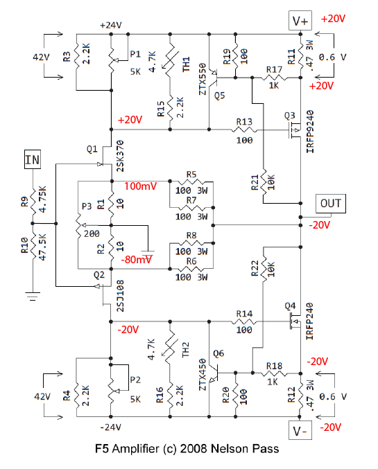

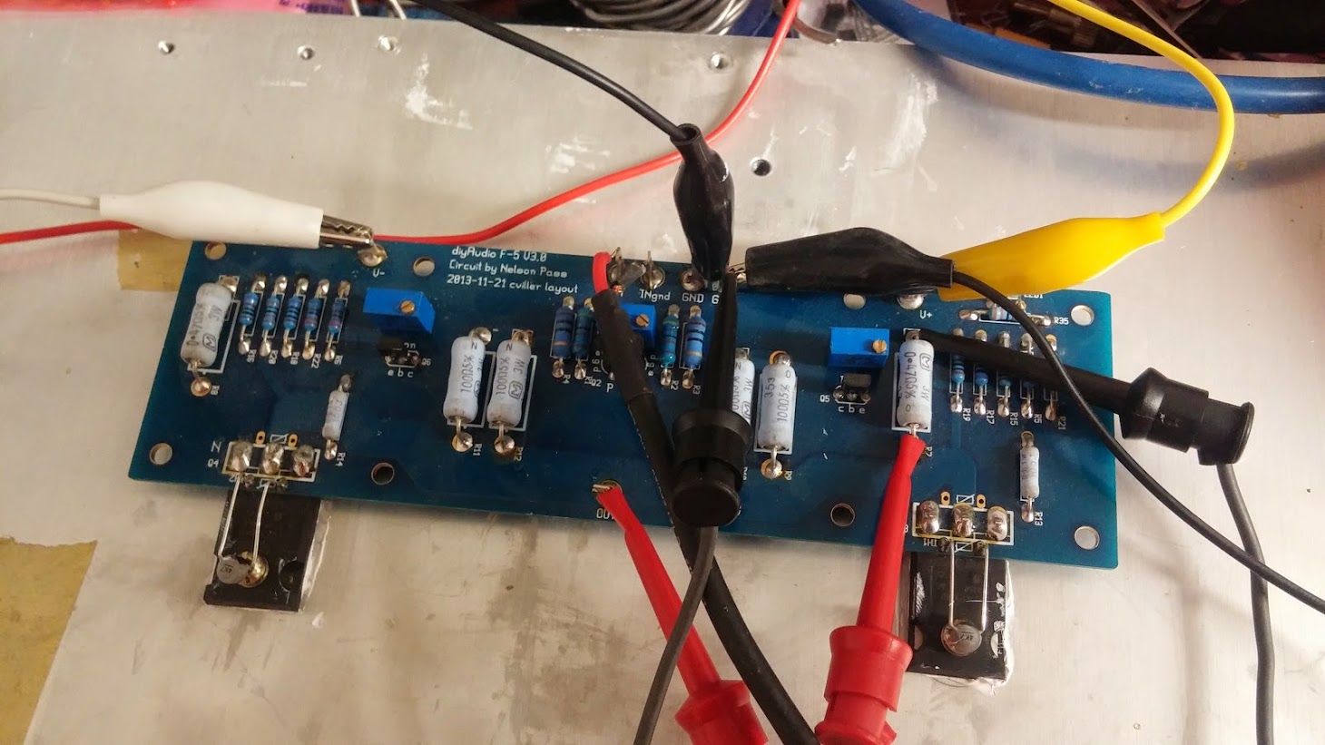

Hi all, I suspect to have a problem with my F5. After having checked the potentiometers I connected the three DMM and started it through a dim bulb tester. The voltage across the two 0.47R resistors is 0 but at the output I measure, relative to ground, a negative voltage equal to the negative supply (around -19 V with the dim bulb tester). This happens on both channels.
Is it normal to have such offset at the beginning of the bias adjustment?
Thanks!
I made some more measures on one of the channels. Values are in the picture. The reduced supply voltage is due to the dim bulb tester. If I remove it, fuse blows.
I'm really a beginner in electronics but I would focus on the N channel mosfets. Right?
I will make some pictures as soon as I get back to the workbench.
