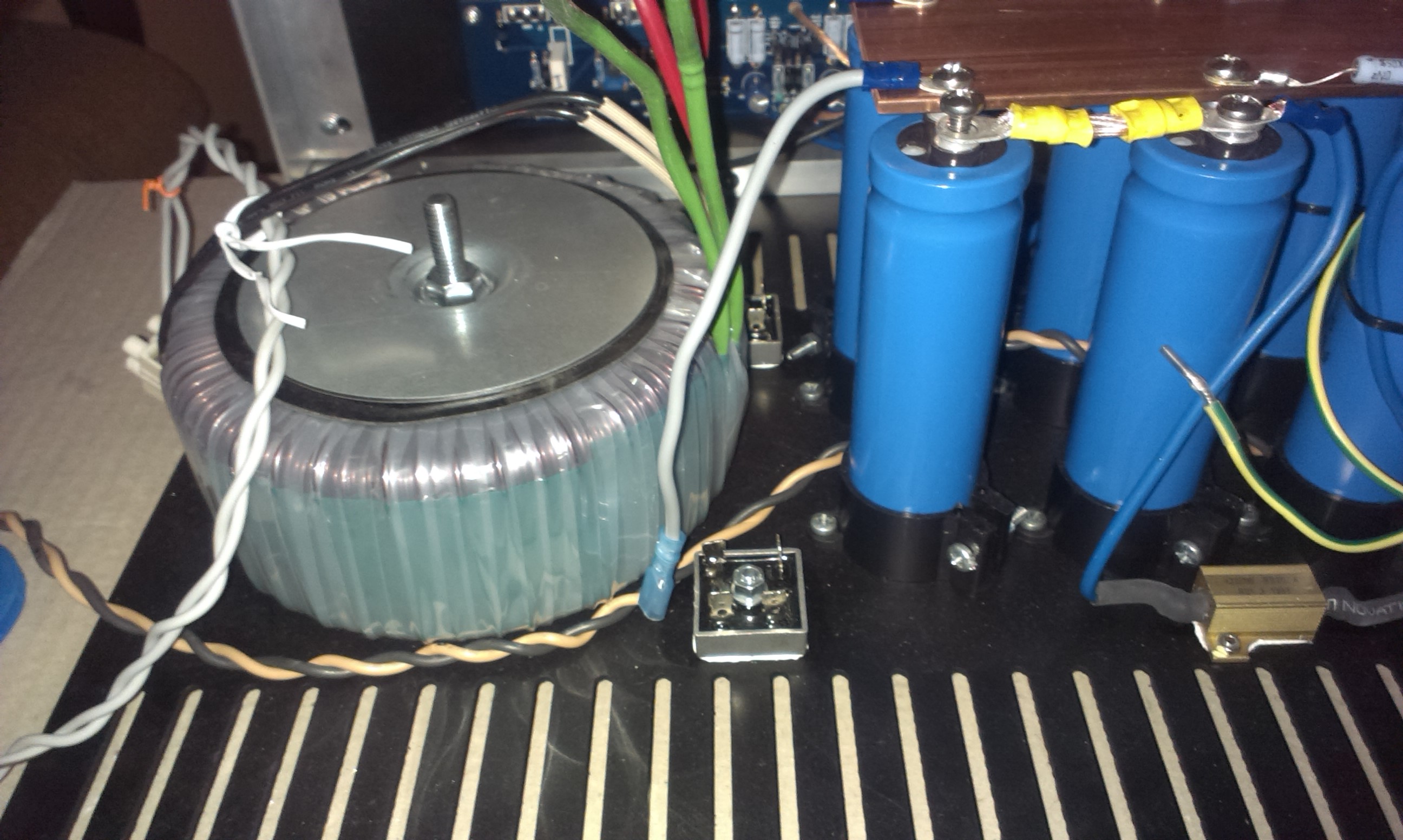

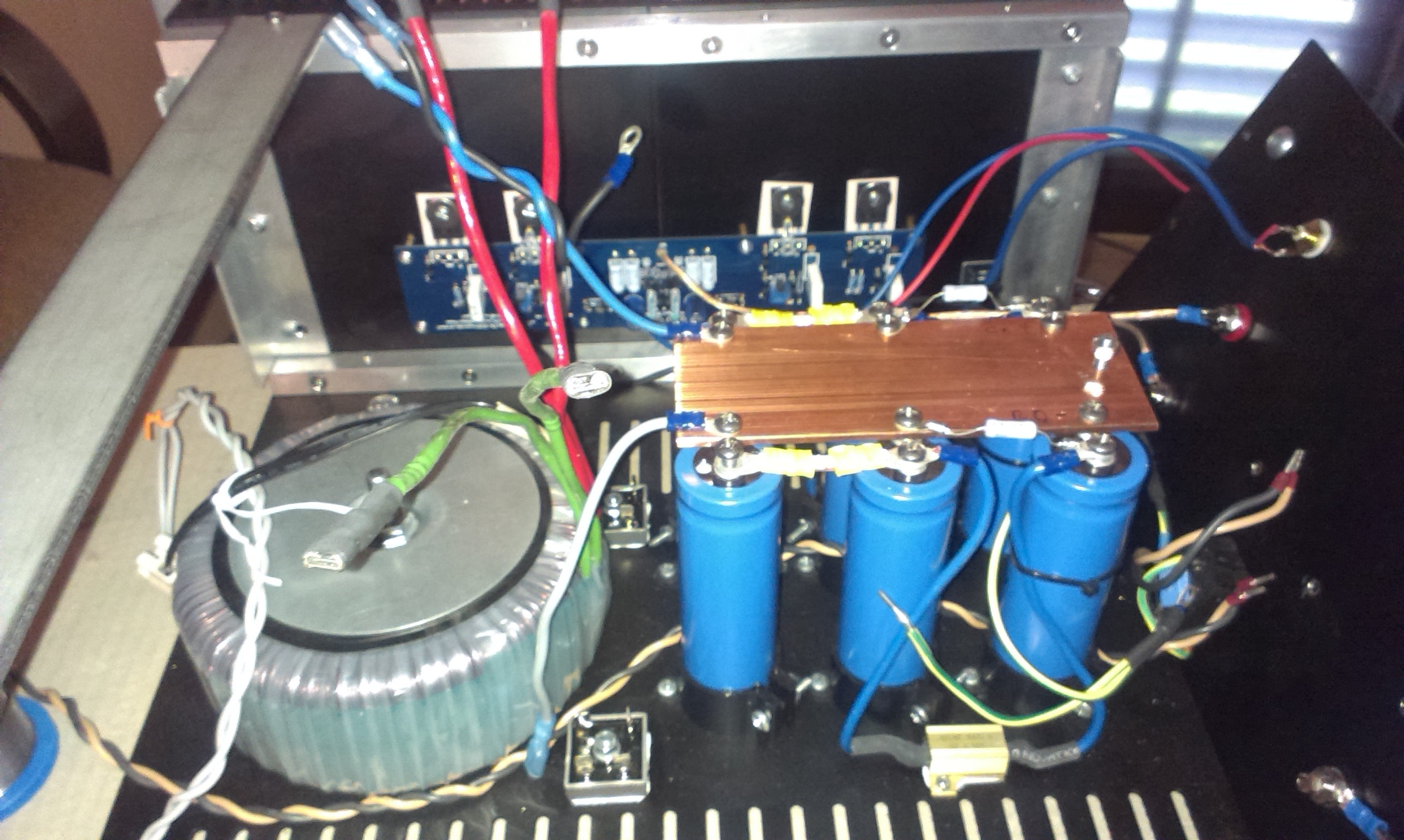

I have a problem my 50A bridges are in short circuit, I do`nt knew why, Any idea?
The amp worked for 5 to 6hours, i have biased the amp to 1,9A the borads are cascoded two pairs at 32+32VDC.
Caps are from apex jr should be ok. how to check them?
just check them with ohmmeter for short
if they're open circ (after some time , needed that ohmmeter feed them fully) , they're most probably good
